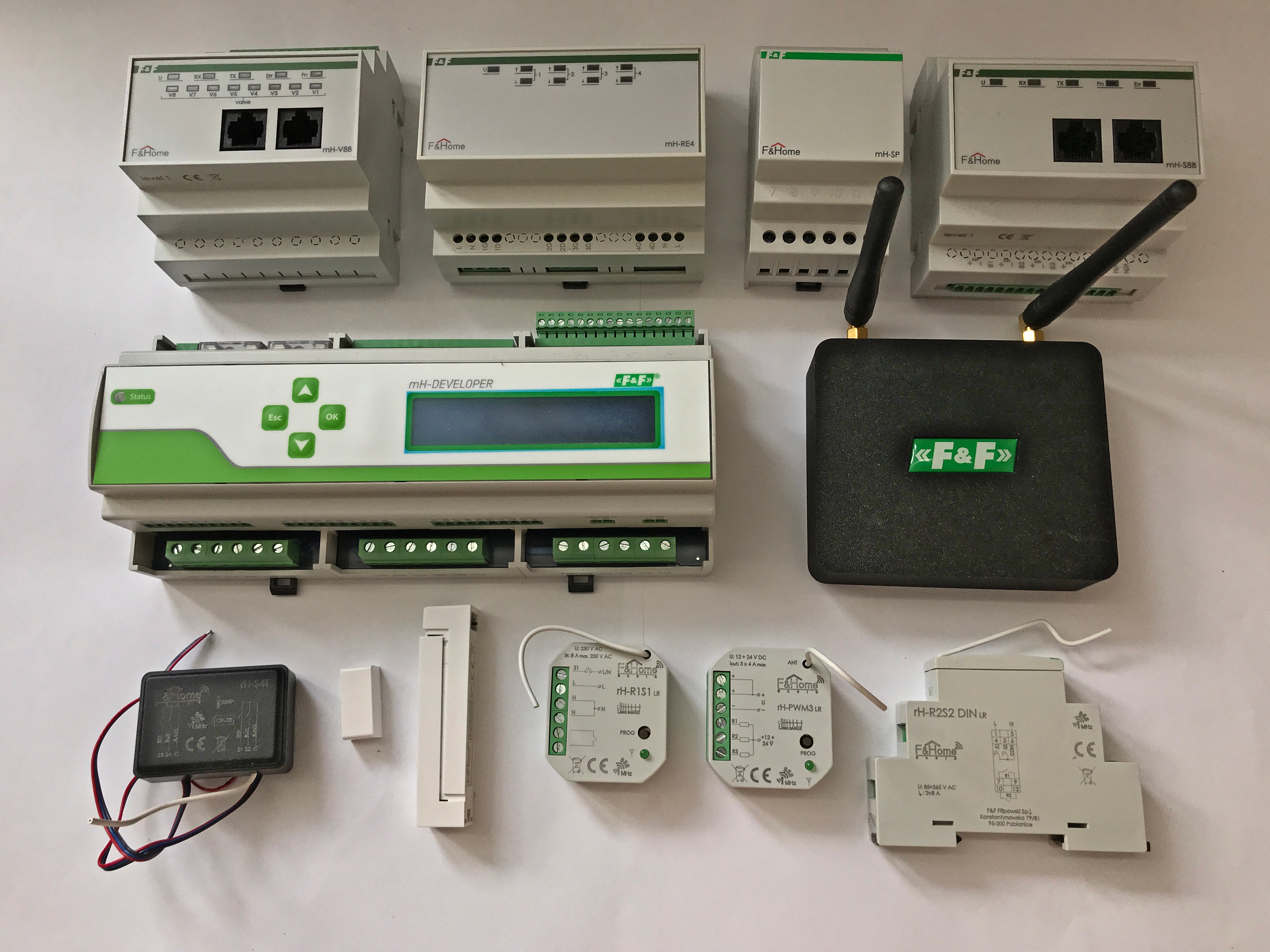

A set of F&F home automation devices including control modules, a central unit, relays, and communication modules. .
F&Home is a fully customisable, Polish home automation system offering unified integration of wired and wireless solutions. Automation in F&Home is created using a comprehensive, visual system based on Node-Red and control from phones is via the Fox app, also compatible with Wi-Fi-based solutions.
In this topic, I will show this system in practice. This will essentially be the first part of an adventure with a smart home solution from F&F and in this topic I will present:
- some of F&Home's wired and wireless devices

Wireless part of the F&Home system is based on a central unit and expansion modules. Additional systems can be connected to the unit via various buses, such as (depending on the server) CAN, ModBus, LAN. Expansion modules can be added gradually as the system grows, allowing the system to be adapted to each household.
Four building automation modules with RJ45 ports and screw terminals on top. .
The Wireless part of the system is based on proprietary F&F technology based on proprietary radio receivers/transmitters operating in the 868MHz band. This solution uses dual radios mounted in the servers and very effective radios described as LR, or Long Range (long range, up to 350 metres).
F&F home automation DIN rail modules, front and side views. .
Three F&F smart home control modules with connectors and antenna wires, designed for flush mounting. .
The image shows a motion sensor and an electronic module with wires. .
The heart of the F&Home system is the central unit, supported units include the rH-SERWER-DIN2, DESKTOP2 and DEVELOPER models. This presentation will be based on the mH-DEVELOPER.
