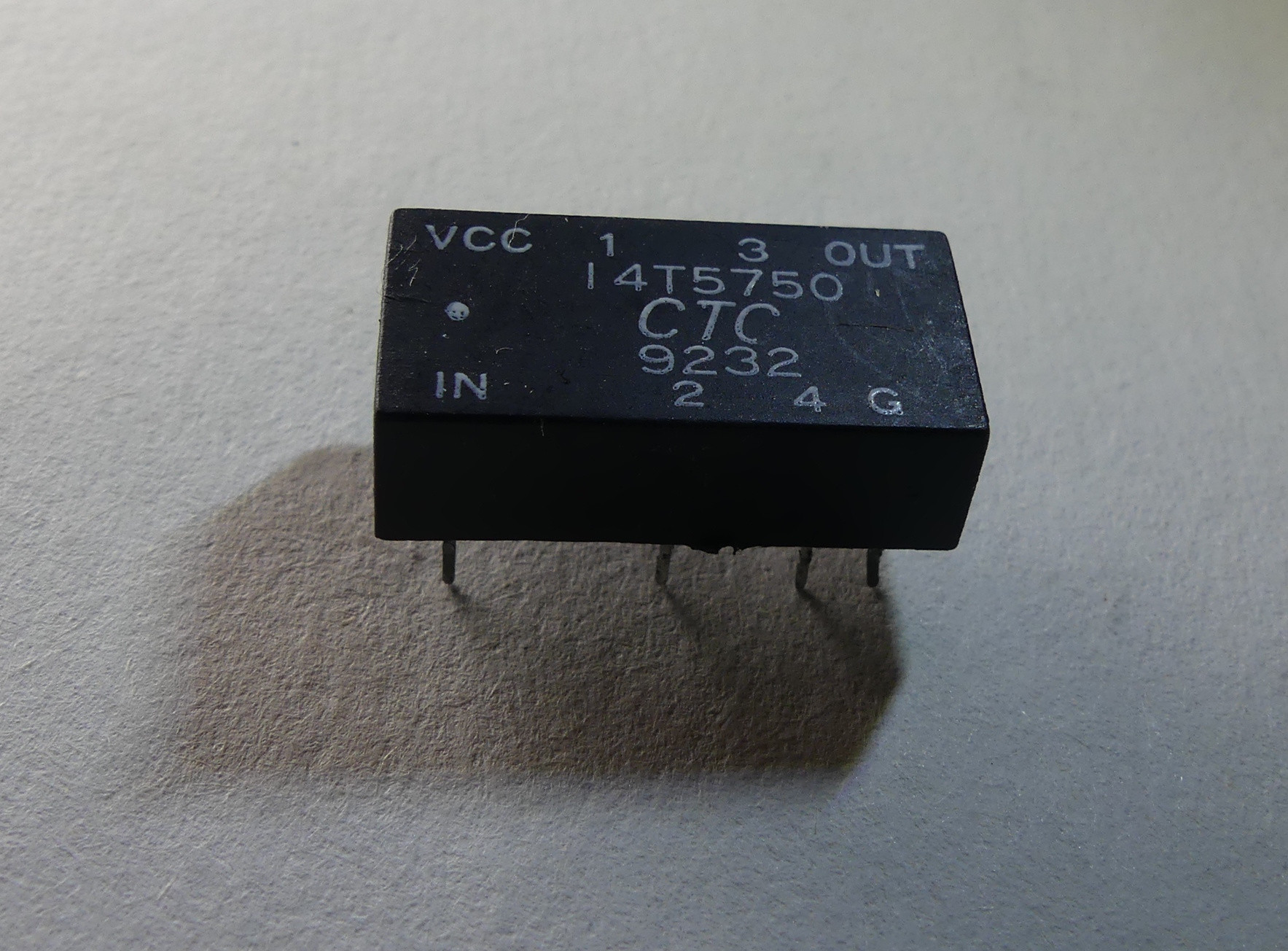

When I visited an electronics colleague recently, he surprised me by putting a small object on the table and asked what the electronic component could be. The component was working on a board in digital circuits. On the casing you will see the markings VCC, GND and OUT. You might suspect that this is some sort of quartz generator, such as DS32KHz or higher frequency generators such as TCXO . Also visible on the chassis is the designation of an input, perhaps controlling the operation of the circuit, and several outputs marked with consecutive numbers.
Do you know what this electronic component is used for?
I was wrongly betting that it was a quartz generator. On old computer motherboards I often saw several generators with different frequencies, usually enclosed in a metal case. Apparently PLL circuits were not used then and it was easier to use several generators with different frequencies.
Black integrated circuit labeled “14T5750 CTC 9232” with four pins below
After typing the symbol 14T5750 into google, it was possible to find descriptions of 286 motherboards where this component was used:

Managed to find a pdf describing the parameters of this component:
http://www.datasheet.hk/view_download.php?id=1695449&file=0349%5C14t5750_2726584.pdf
It turns out that the manufacturer supplied more models of this component: 14T5750 14HT5750 14HT5125 14HT5251 14HT5500 14T5451 14T5500
The riddle is explained by the contents of the pdf:
Technical diagram and specifications for Allen Avionics 14-pin DIL device
Diagram and delay specification tables of 14T delay line component
This is a delay line! The circuit is powered by 5V, has an output and several 'taps' with different delays to the input signal. What could such a delay line have been used for on the motherboard of a computer with a 286 processor? I suspect that it was a way of distributing timing signals, with a specific offset/delay of the signal edges. Such an offset may have had applications, for example, in controlling RAM operation. If board schematics with such a line were available, perhaps something could be confirmed.
Let's see if the line still works. We supply the circuit with 5V -> current consumption about 17mA. We apply a 100KHz signal to the input and the current consumption increases to about 32mA. It appears that the embedded circuitry in the line is working.

The offset is approximately 76ns according to the parameters in the description.
