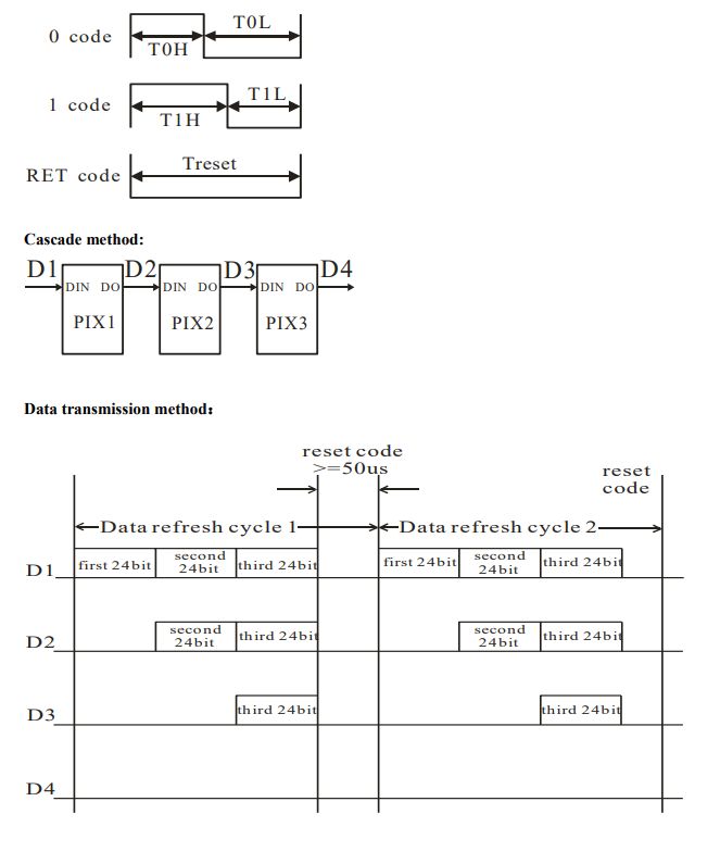

    The WS2812 is an individually addressable, colour LED that combines an RGB LED and a controller in a single housing. This allows each module to be controlled independently, enabling the creation of lighting effects, animations and dynamic colour changes in LED strips, arrays or DIY projects. The WS2812 uses a single-line protocol for data transfer, allowing multiple LEDs to be easily connected in series with minimal wiring. The way it works is that the WS2812s are connected in series - the DOUT input of one is connected to the DIN of the other, and their controllers themselves cleverly pass on the signal, taking only their colour described by three bytes.
    Data transmission and cascade connection diagram for WS2812 LEDs

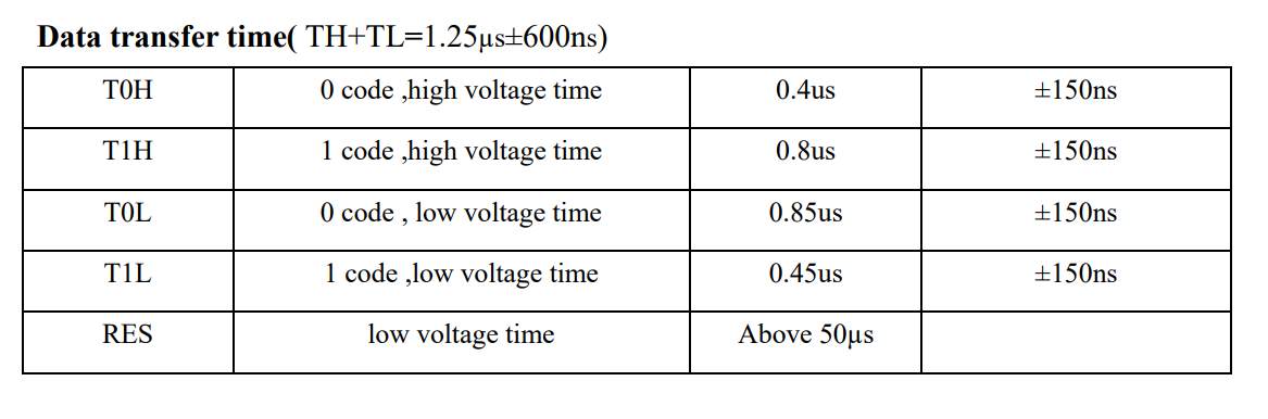

    The bytes are encoded as a high state - low state pair, where the timing of a given state must meet a specification.
    Data transfer timing table for WS2812 LED, showing TH and TL durations.
    According to the table - we must be able to generate T0H (0.4 us) and T1H (0.8 us) times with a margin of error of up to 0.15 us (in practice slightly more).

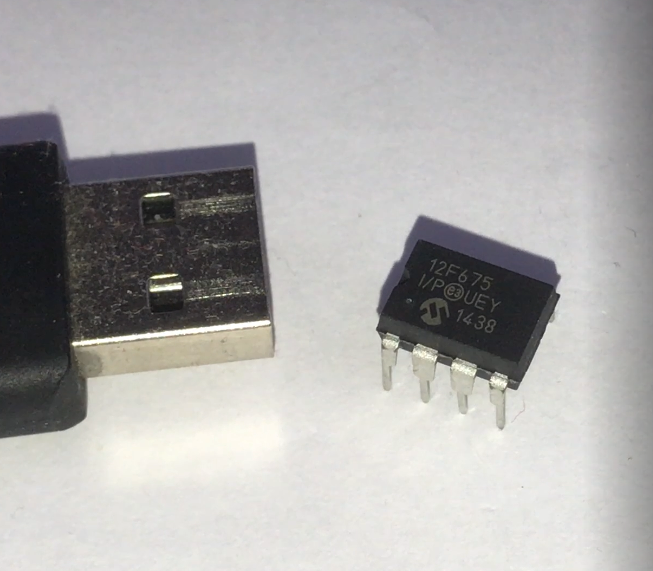

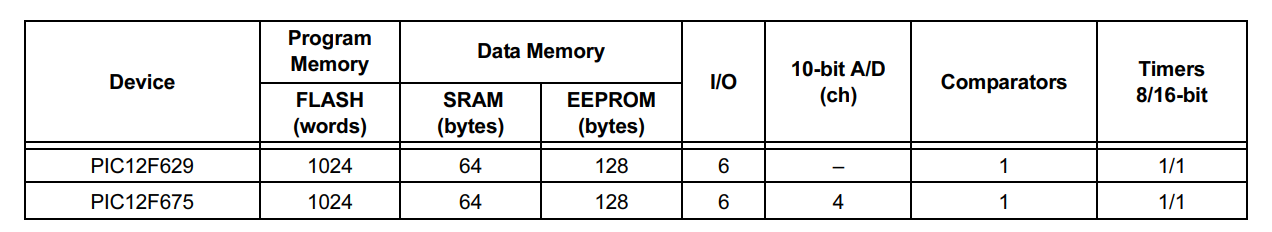

    The first PIC that caught my eye was the PIC12F675, lying right next to the eponymous PIC12F683. However, it had even less RAM, at a mere 64 bytes:
    Comparison of PIC12F629 and PIC12F675 microcontroller specifications

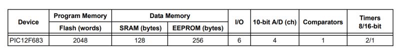

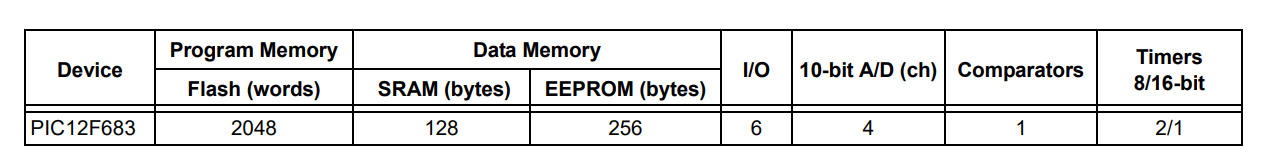

    I then compared the notes and decided that the PIC12F683 was the better option after all:
    Specification table of the PIC12F683 microcontroller
    It's a tiny 8-bit MCU in a DIP8 enclosure, but it's more likely to be enough here?
    USB connector next to a PIC12F675 DIP8 microcontroller on a white background

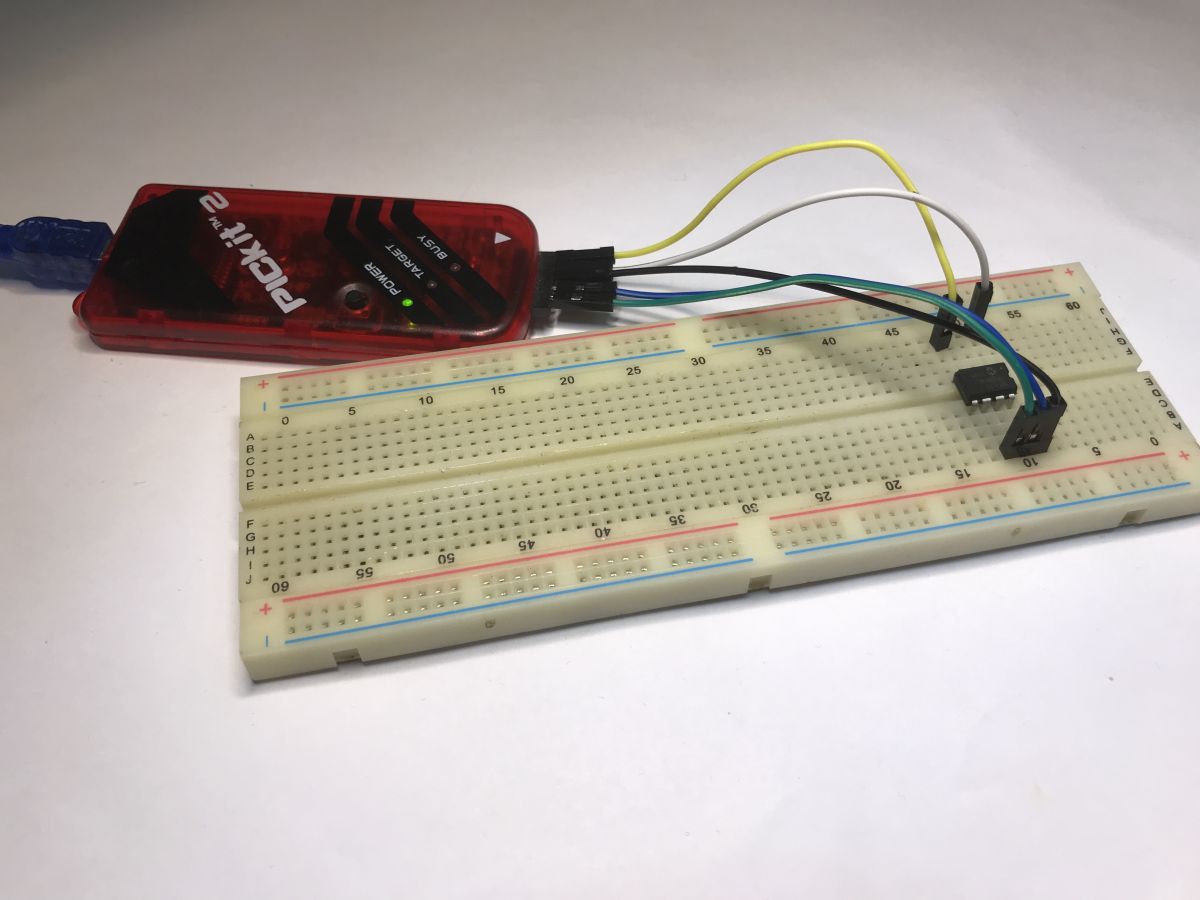

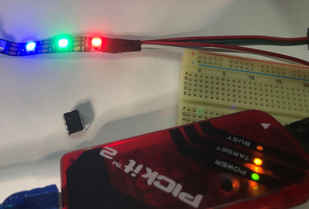

    To start with, I got the PIC up and running. PICKIT2 sees it without external components:
    Breadboard with connected PICKIT2 programmer and DIP8 microcontroller
    For the PIC to work, however, you need a 10 kΩ resistor on the MCLR (pull up to the power supply) and you also need to give a 100 nF decoupling capacitor between power supply and ground.

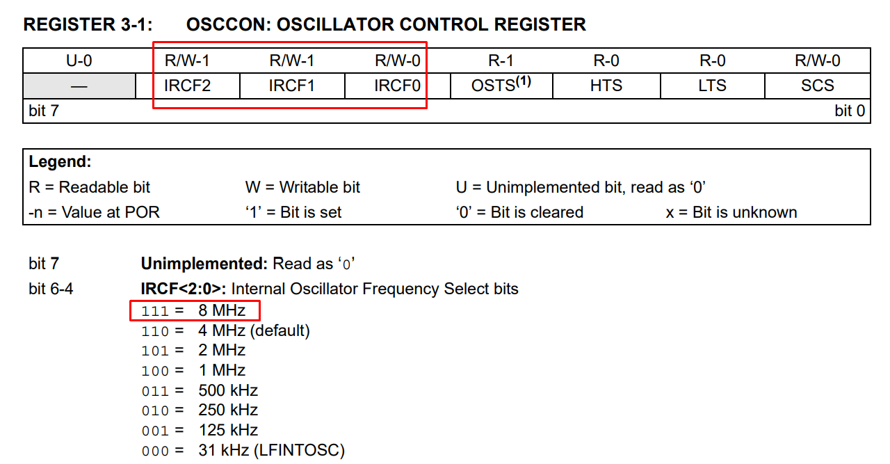

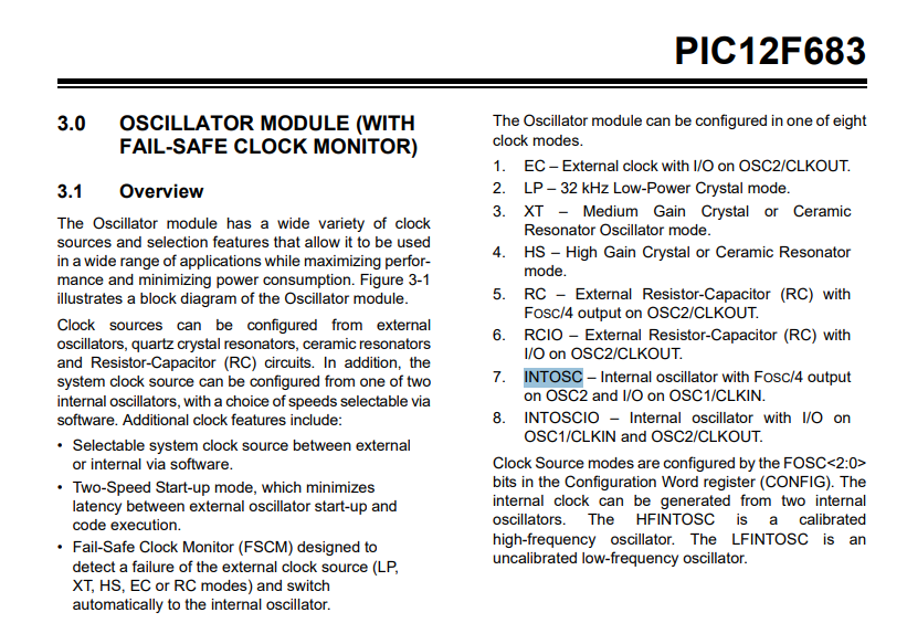

    I started by trying the built-in oscillator - 8 MHz, faster is not possible. This is set in the OSCCON register:
    OSCCON register table from PIC12F683 datasheet showing oscillator frequency settings

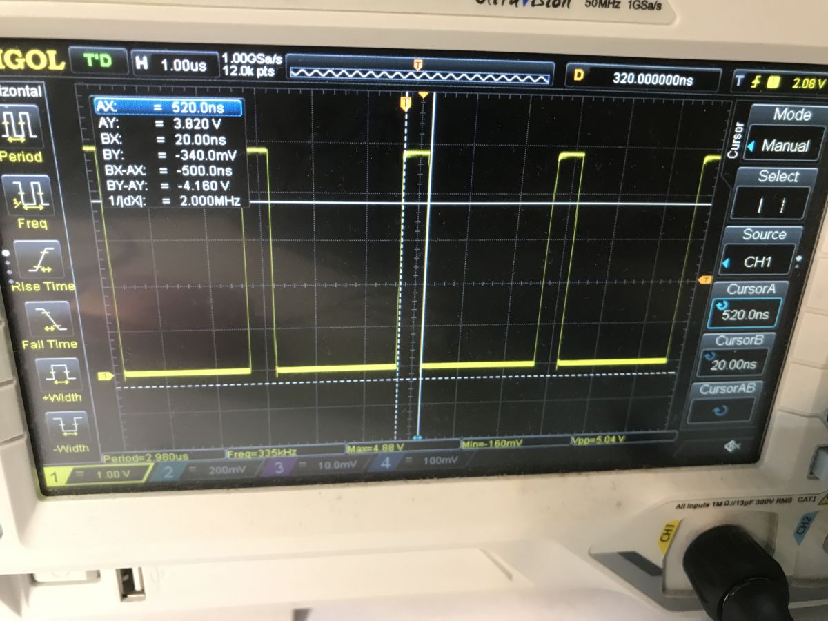

    I wanted to illustrate how long it takes to do the GPIO state setting. This can of course be counted (from the Fosc/4 formula), but it is worthwhile to verify the result anyway. Example code:
    Code: C / C++
    We are interested here in the timing of the high state, because after the low state there is still a jump to the start of the loop, and this is also an instruction:
    Oscilloscope waveform showing a 520 ns pulse measured on Rigol screen
    It comes out 500 ns... and we need 400 ns - 800 ns, a bit low.

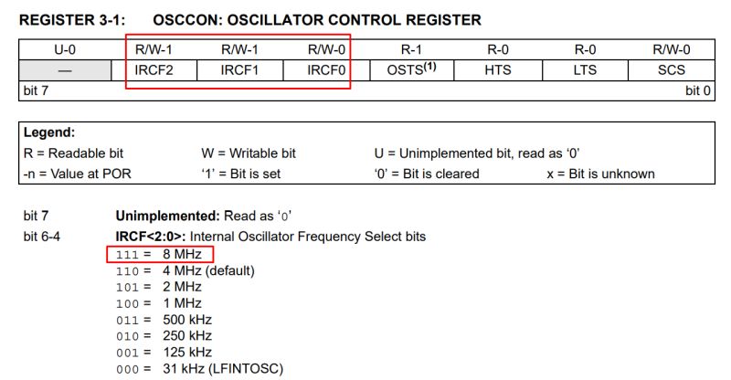

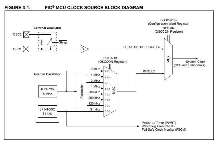

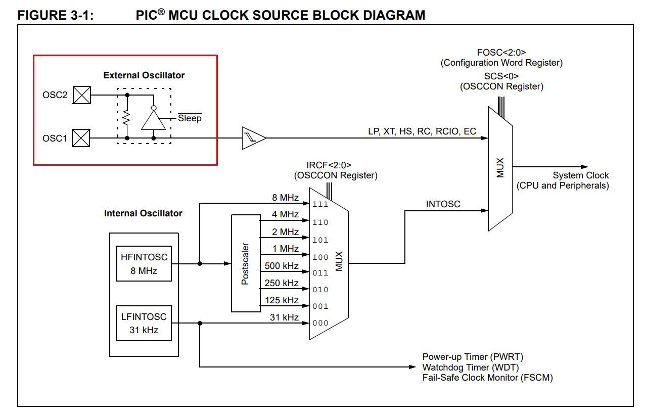

    Migrating to an external oscillator
    8 MHz is rather too slow. You need to switch to an external oscillator:
    Clock source block diagram of a PIC microcontroller with external oscillator highlighted

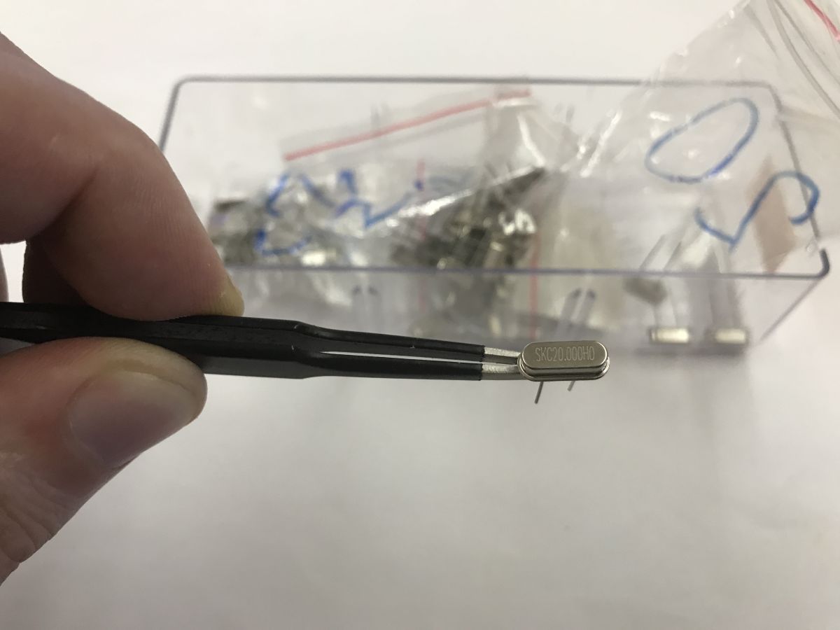

    I have just such a 20 MHz one:
    20 MHz quartz resonator held with tweezers, background box with other components

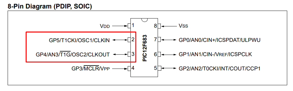

    All you need to do is connect it on the right pins:
    Pin diagram of PIC12F683 microcontroller in 8-pin PDIP/SOIC package

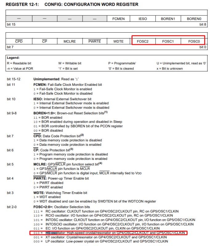

    You also need to enable it in the configuration word.
    Configuration word register of PIC12F with FOSC field highlighted in red

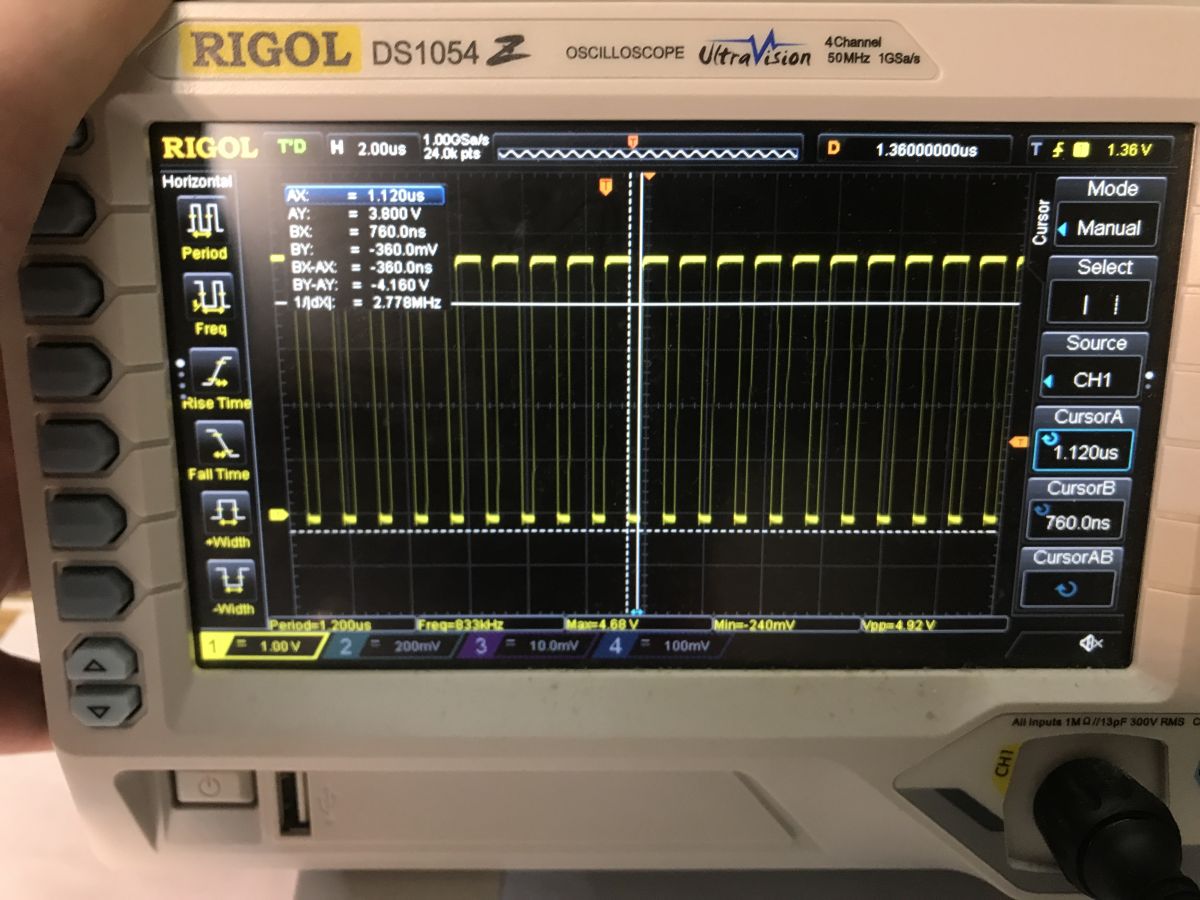

    New code - we are testing:
    Code: C / C++
    We are interested here in the timing of the low state, as there is still a spike after the high state:
    Rigol DS1054Z oscilloscope screen showing square wave data signal for LED
    It is better, 360 ns some, maybe less.

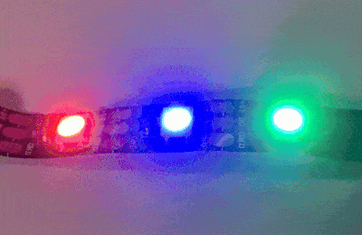

    I then connected the LED strip to the chosen GPIO. Both the PIC and WS2812 run on 5 V, so no power supply problems. The LED strip has a separate data, power and ground line, so you don't have to worry about the current capacity of the PIC pin.
    Effect:
    WS2812 LED strip glowing in three colors with Pickit 2 programmer and DIP IC on white surface
    It appears to work, that the times obtained are within the WS2812 tolerances, but are we sure?
    Pseudo-animation - colour swapping
    To verify the operation, I prepared the simplest animation - a colour swap. Two arrays of data displayed with a gap so that you can see the change.
    Code: C / C++
    It appears that the transfer works reliably enough and alternates the two sets of colours displayed. No data is lost:

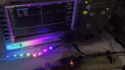

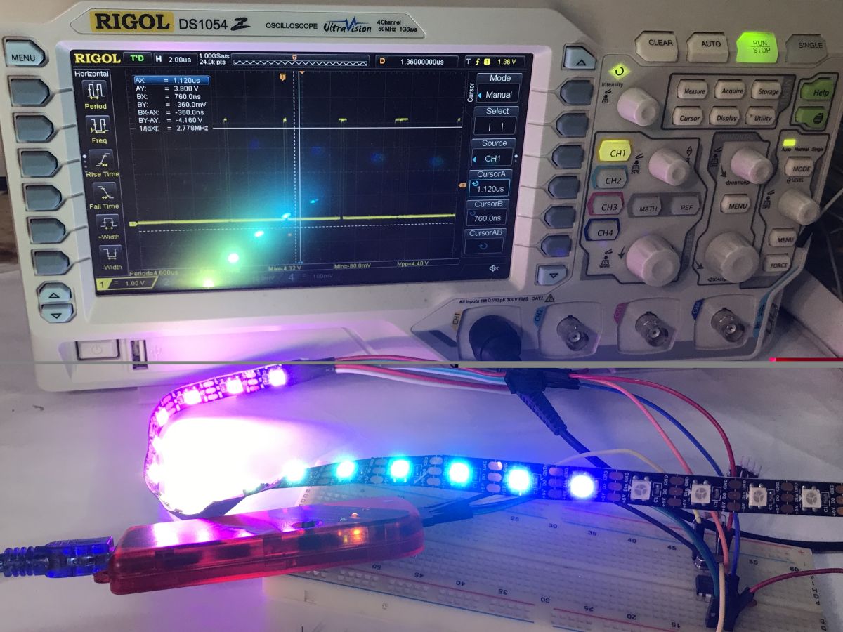

    The effect works, but there is one problem:
    Colorful WS2812 LEDs driven by microcontroller, oscilloscope in background

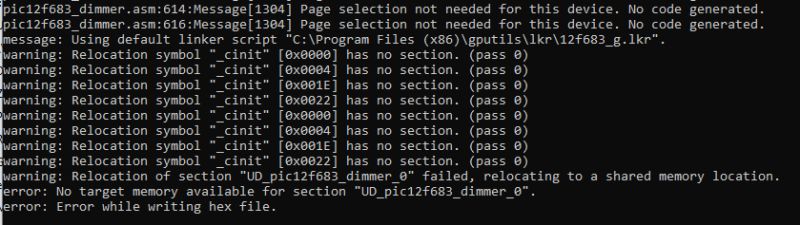

    No more pixels can be added because there is not enough RAM.
    Compilation error log for PIC12F683 showing relocation and memory allocation issues

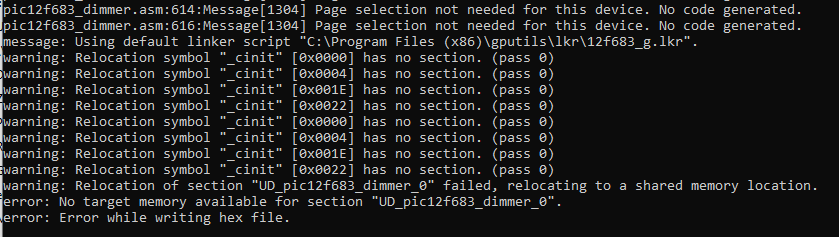

    Optimisations and limitations
    I've tried various approaches, but even switching to dynamically counted values doesn't change much either - SDCC needs memory for them too, as it creates helper functions for them when the operation is not supported by the processor:
    warning: Relocation symbol "_cinit" [0x0022] has no section. (pass 0)
    warning: Relocation of section "UDL__moduint_0" failed, relocating to a shared memory location.
    error: No target memory available for section "UDL__moduint_0".
    error: Error while writing hex file.
    warning: Relocation of section "IDD_idata_0" failed, relocating to a shared memory location.
    error: No target memory available for section "IDD_idata_0".
    warning: Relocation of section "UDL__mulint_0" failed, relocating to a shared memory location.
    error: No target memory available for section "UDL__mulint_0".
    For best performance this would need to be written in assembler and limited to types that fit in registers, maybe then a bit more bytes could be racked up.

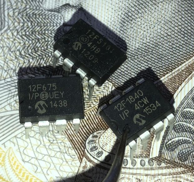

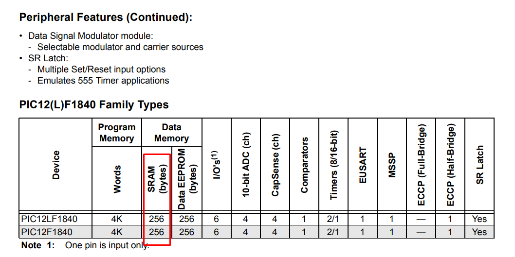

    Ew. You can cheat the fun slightly, as I still found such a PIC:
    Three Microchip PIC microcontrollers on currency pattern, 12F1840 pointed by tweezers
    PIC12F1840
    Specification table of PIC12F1840 and PIC12LF1840 MCUs with 256-byte SRAM highlighted
    But again, I tested once, and my PICKIT2 doesn't seem to want to recognise it, despite the new Device File. I'd have to dust off the PICKIT3, I have one too, just where.

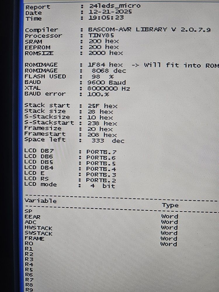

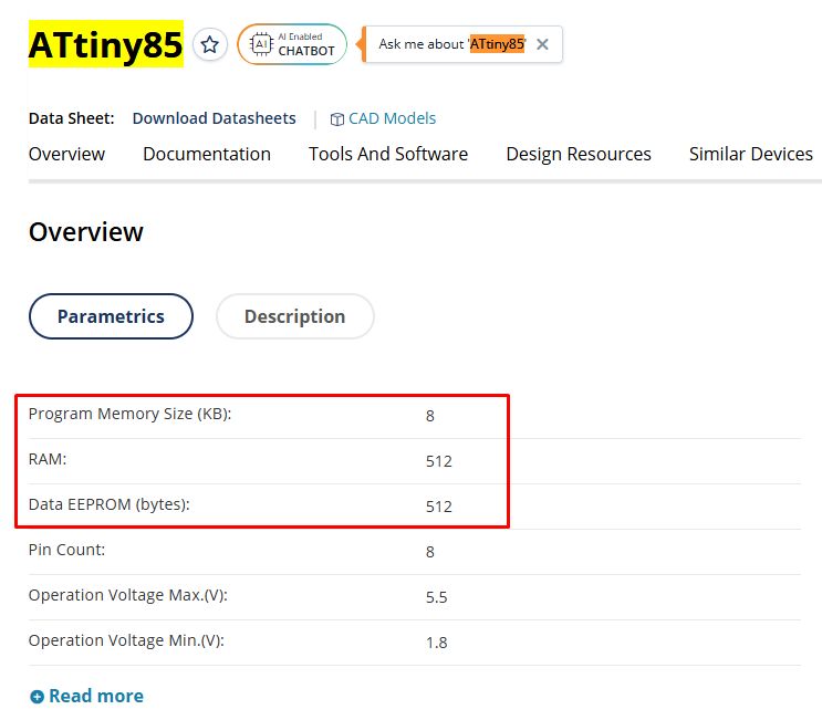

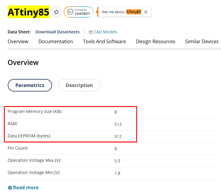

    512 bytes of RAM the author had:
    ATtiny85 microcontroller specs with 512 bytes of RAM and 8 KB program memory
  • 8-pin AVR drove 24 WS2812 LEDs
    #8 21786133
    Andrzej_Tomaszewski
    Posts: 270
    Rate: 338
    Hi!
    When I saw this circle with 24 WSs I was immediately reminded of how I managed to "figure out" these pixels in a BASCOM AVR environment almost 10 years ago. The main idea was to use an 8-leg uC and an internal 8MHz RC oscillator. I remember to this day my joy when I managed to light each diode in the circle with the colour I wanted, statically, without any animation yet. Later that evening I already did some animations. And this is my prototype at the time, ehh it was a fun time ;)
  • 4 MHz is enough for simple GPIO toggling

  • ATtiny85 chosen for more program memory and simple WS2812 bit-banging
    #12 21786358
    Andrzej_Tomaszewski
    Posts: 270
    Rate: 338
    Yes, but this number of bytes of RAM is in my case just an unnecessary addition because I wanted to have as much program memory as possible in an 8-legged uC in order to fit as many effects as possible in a chip with as few legs as possible using the internal RC oscillator. This is why the ATTINY85 fell into place. In my designs, the data to send to the WSs is an array of RAM. The number of bytes is the number of WSs x3 i.e. for a caster with 24 WSs it is 24x3 i.e. an array of 72 bytes. Creating effects are operations on the array. Each time the data in the array is changed, the data from the array is sent to the caster. One such send is one frame of animation. The sending of data to the WSs is handled by a sub-procedure that I wrote in the form of an ASM insert. It analyses each bit and byte of the array and sets the state of any uC pin for the required time. No uC peripherals are needed. I don't think it can be any simpler.

    And do you know how much of that RAM your program ultimately used?
    Here is the compilation report.
    Screenshot of BASCOM-AVR compile report showing memory usage and variable definitions
    Cd details of the variables used.
    Screenshot of compilation report showing variable names, types, and memory addresses.
    At the bottom starting with WS2812DATA (the aforementioned 72 byte array) are the declarations of my variables. I could still dispense with a few of them as part of the optimisation, but then this large area of available SRAM makes me a bit lazy :)

    That RAM would go along with my estimate.... thanks for posting the screenshots.

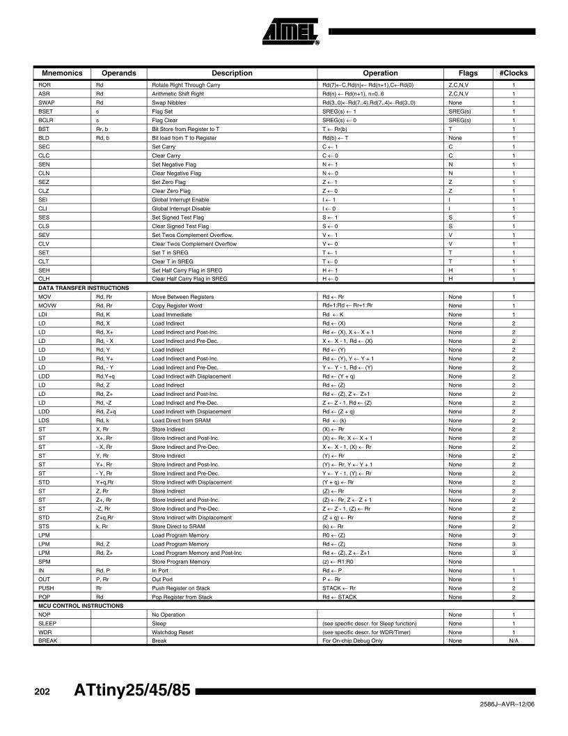

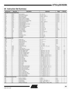

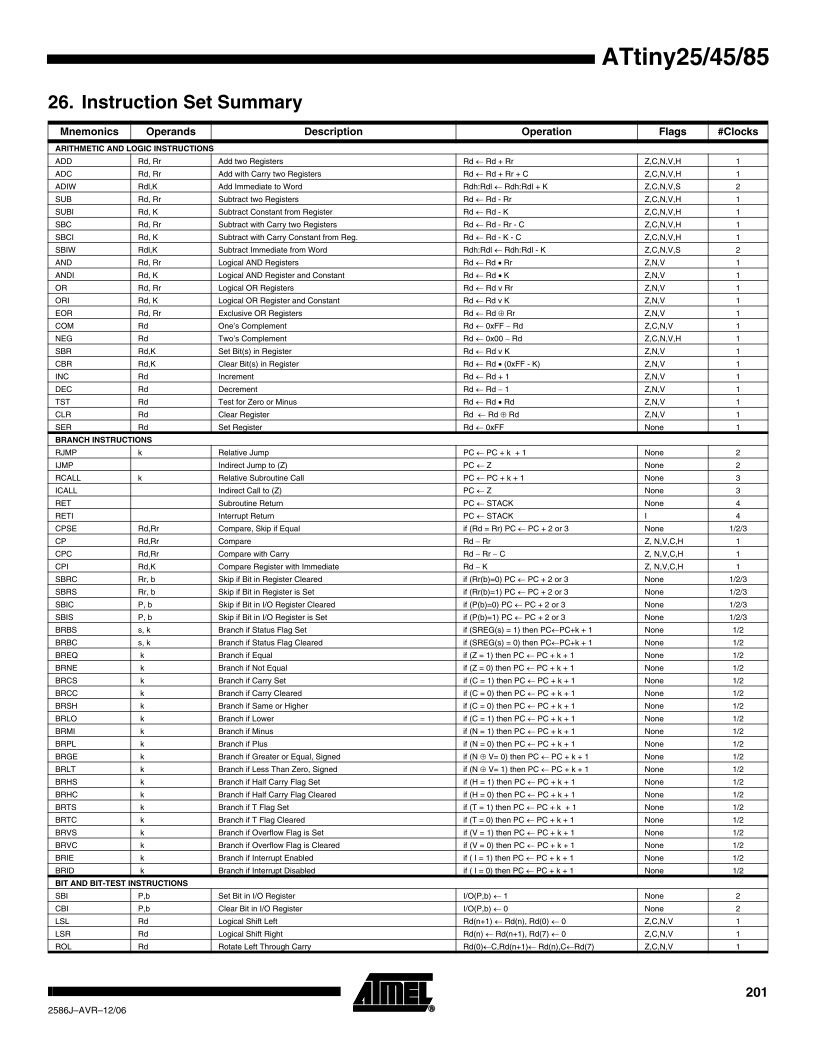

    Please find below a piece of documentation with instructions for the ATTINY85 in ASM plus durations. Most instructions take 1 or two cycles, much less often 3 or 4 cycles. Conditional instructions may take 1 or 2 cycles depending on the result of the check, i.e. condition met or not met. Isn't there sometimes a clock frequency prescaler programmable via fusebits in the PIC? Because the Fosc/4 is a bit of a waste....
    Instruction set summary for ATtiny25/45/85 with clock cycle counts
    Assembly instruction table for ATtiny25/45/85 with descriptions, flags, and clock cycles.
  • PIC12F683 offers only internal oscillator frequency selection
    #22 21787560
    Posts: 14648
    Help: 655
    Rate: 12660
    There are not many options on the PIC12F683. You can only select the frequency of the internal oscillator (31 kHz to 8 MHz) or switch to a different oscillator mode:
    Table of oscillator operating modes for PIC12F683 microcontroller
    PIC microcontroller clock source block diagram with oscillators and multiplexer
    On the other hand, I once created a separate topic about clock settings on the PIC18F2550:
    Tutorial PIC18F2550 + SDCC - Part 3 - Oscillator settings, clock, PLL

    Well, I must admit that it looks strange. Looking at the schematic of the PIC's structure, it is enough to write values into the appropriate registers (controlling the MUXes) to allow the clock signal to be sent further without splitting.
  • PIC12F lacks PLL and cannot do this
    #25 21787589
    Posts: 14648
    Help: 655
    Rate: 12660

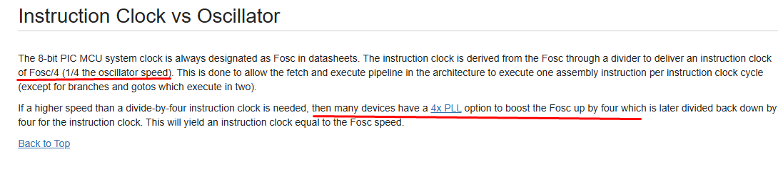

    @kulmar at me the video works, cool effect, what MCU? Why single colour? That's a rather far more difficult task than what we're discussing in this topic. I would rather implement this by sending continuous low resolution screenshots from the PC to the MCU controlling the LEDs, although it might also be possible to do it based on PAL or VGA.
    @Andrzej_Tomaszewski but note that even in this diagram the System Clock arrow comes out, and the Instruction Clock is System Clock / 4
    Text explaining the difference between instruction clock and oscillator in PIC MCUs
    https://developerhelp.microchip.com/xwiki/bin...products/mcu-mpu/8bit-pic/oscillator-options/
    The PIC12F does not have a PLL. In my opinion you will not do anything.
