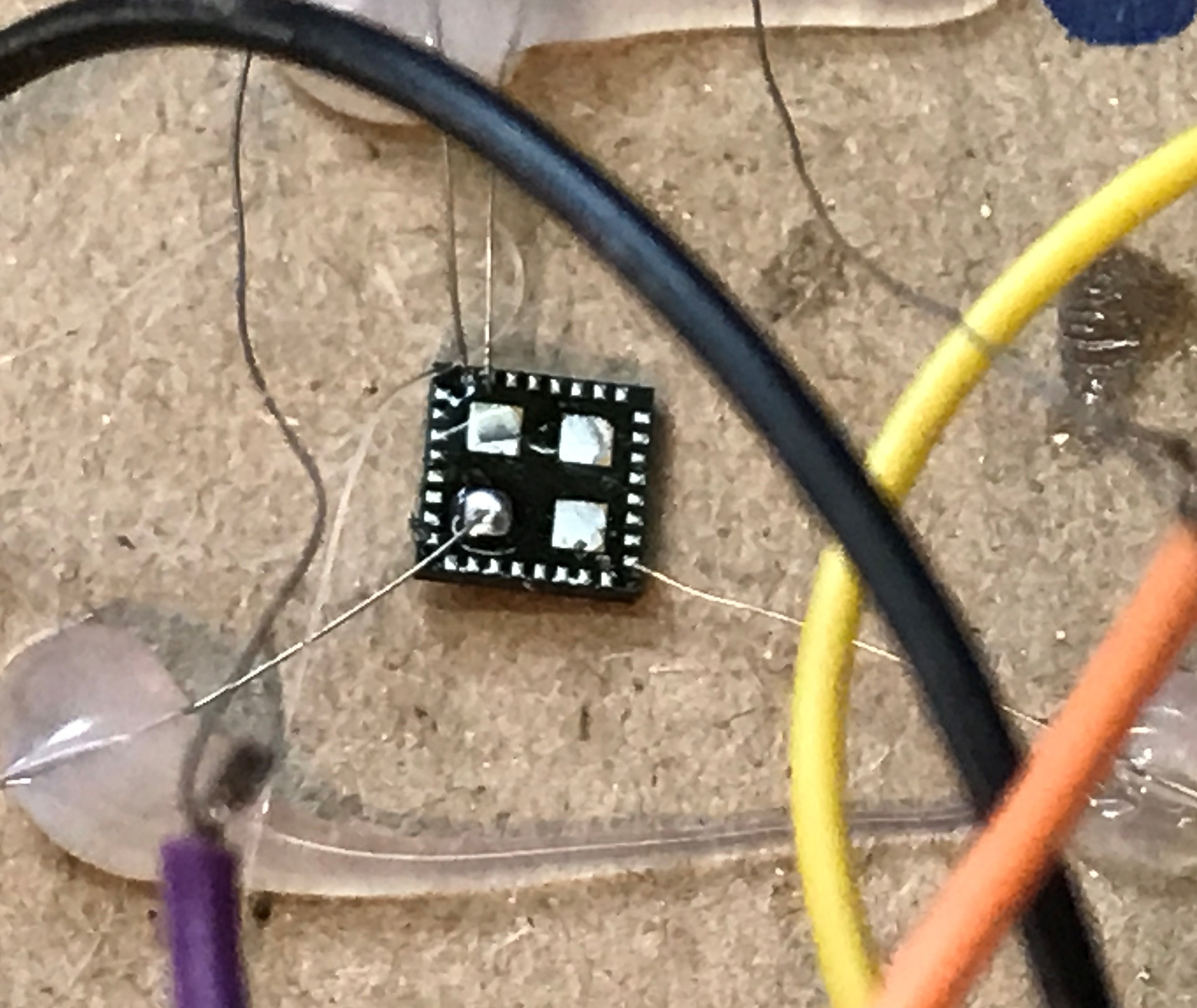

This way we have the module soldered out. I necessarily advise against soldering thick wires to it - it is easy for it to tear off the pad, I have already been through this, I broke one circuit myself this way. It is better to make a stand, e.g. from a cardboard box, mark the first pin and then fix the wires to the stand (e.g. with hot glue) and solder to them:
T34 chip mounted on cardboard with thin wires soldered to its sides
You can also buy a QFN breakout board with a compatible number of pins and raster. I didn't have one on hand myself, but my method works too - I even took a souvenir photo while reading the Flash memory:
T34 chip on cardboard with soldered wires, flashing tool software visible on screen
Another copy - another risky method, but again, wires to not break the pads:

piotr_go 31 Oct 2025 13:08
LGA not QFN. [Read more]
Mastertech 31 Oct 2025 13:37
Well, I don't know. To hook up to ground and plus you will probably find somewhere on the pcb. The question is whether the Rx and Tx go somewhere on the pcb so you can catch them, you need to look closely... [Read more]
p.kaczmarek2 31 Oct 2025 13:58
Precisely the problem is that one of the UART lines is not led anywhere. That's why I gave pictures with the circuit soldered out: https://obrazki.elektroda.pl/2238398900_1761915314_bigthumb.jpg ... [Read more]

And that's what I saw, but about that I had doubts because I know that T34s come in two versions - with pads accessible from the side and without. Although I guess that document from NXP what I gave a... [Read more]

p.kaczmarek2 31 Oct 2025 18:23
I will try this way, but I do not foresee any further programming. That's what the remote update option (OTA) is for, to avoid soldering wires twice. @piotr_go thanks for pointing it out, I have changed... [Read more]
