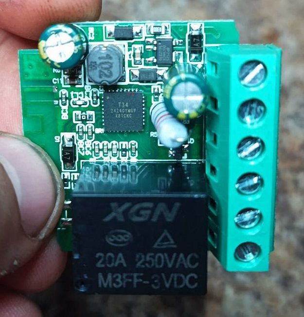

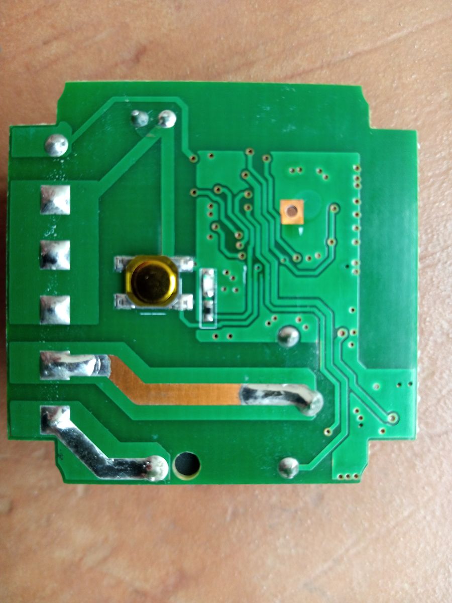

    woessner
    This is for another Mini Smart Switch,
    this time with a T34 AKA BK7231N
    I did not read this forum thus I did not know about Tuya-Cloudcutter and thus flashed it the difficult way.
    Please try Tuya-Cloudcutter first!!
    Open Mini Smart Switch showing internal electronics and cover with external markings. The image shows the interior of a Mini Smart Switch with a visible relay and electronic components on a circuit board. PCB with electronic components and connected USB chip on a wooden surface.
    The LED is on 6
    The Switch input is on 14
    The Relay is on 15
    The Button on 24

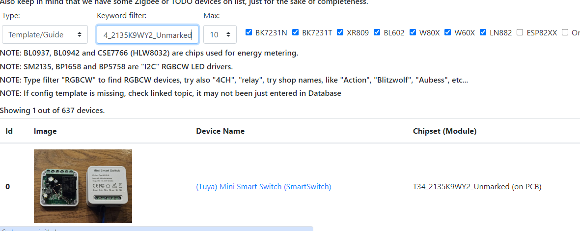

    Thanks for sharing! Your template is now live on our devices list:
    Web interface showing a list of devices with a mini Smart Switch.
    See: https://openbekeniot.github.io/webapp/devicesList.html
    Good job with flashing it. Nice way of repurposing unused button pads. I hope it won't be too hard for other our readers as well. I'm worried to see more and more T34 devices around, Hopefully they won't totally replace easily-flashable CB2S/CB3S/etc modules.

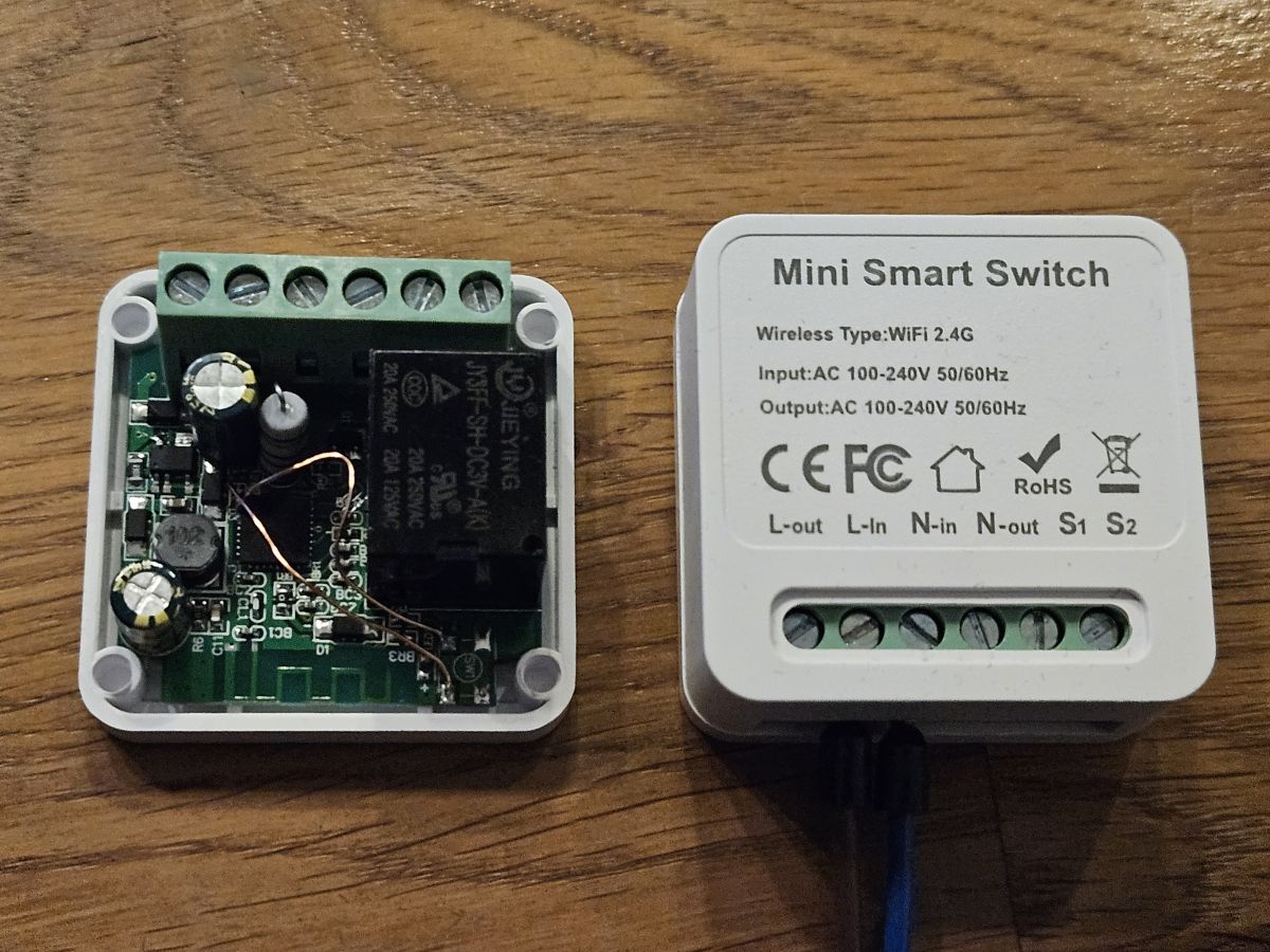

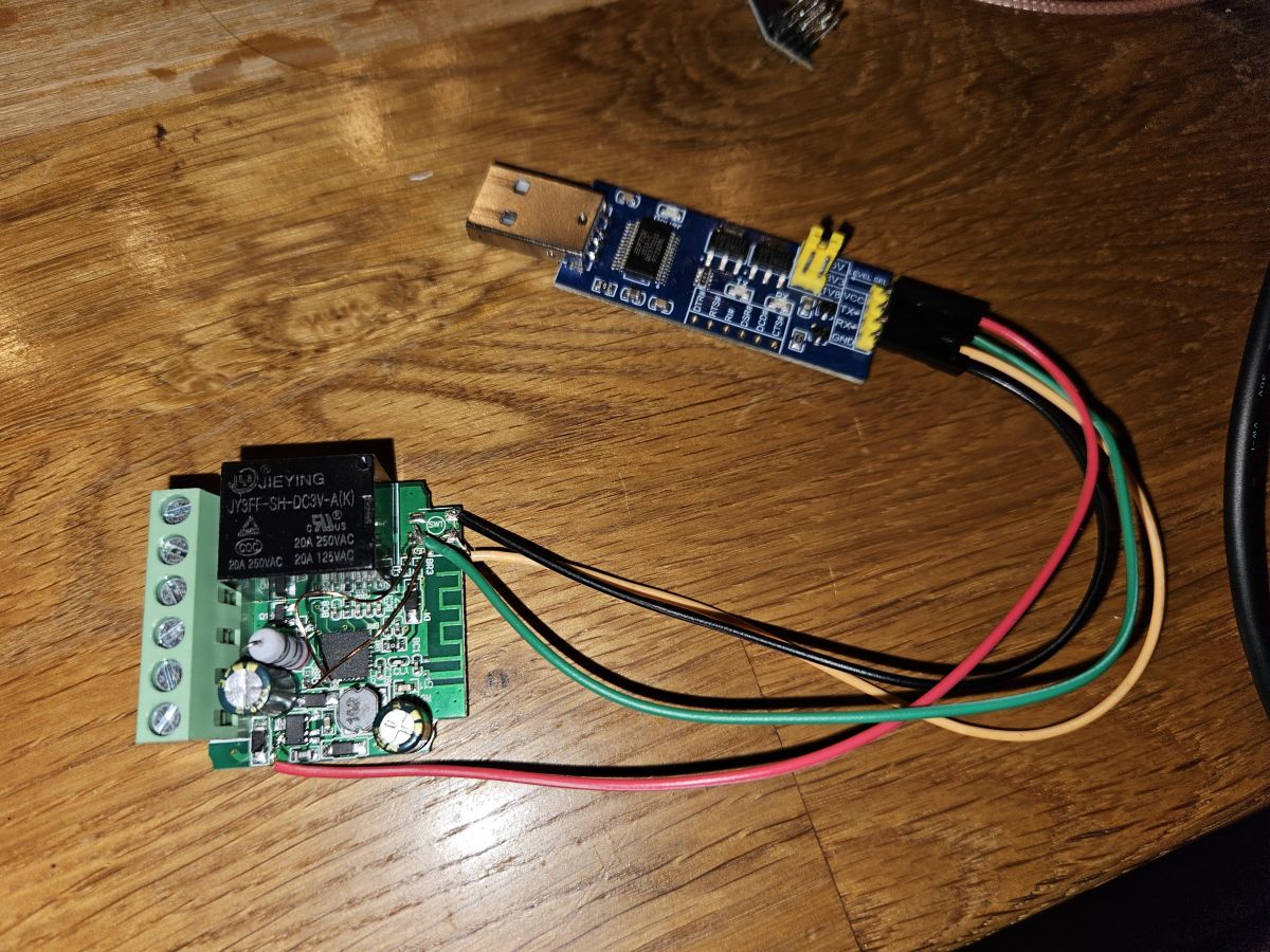

    It goes like this. I would like to use uart but after soldering in the theoretical uart pins i don't have communication.
    Printed circuit board with electronic components, including an XGN relay.
    I tried with the pins marked in red.
    Custom T34 adapter for BK7231N flashing

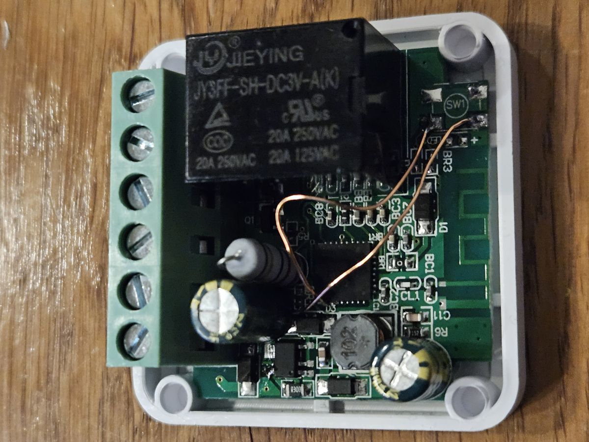

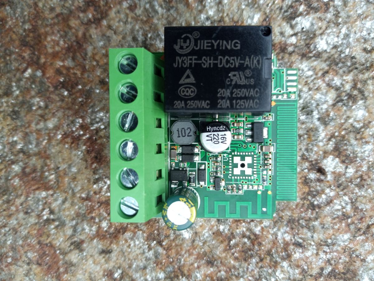

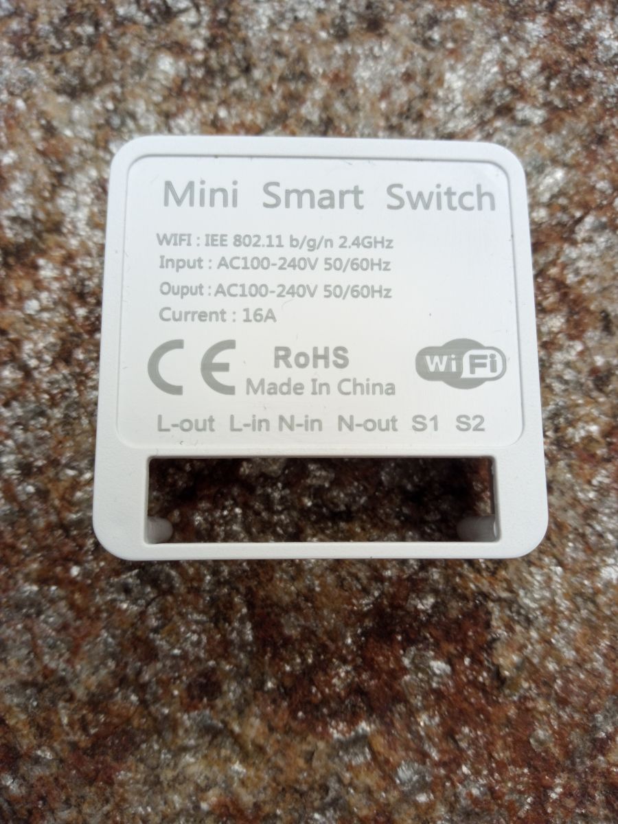

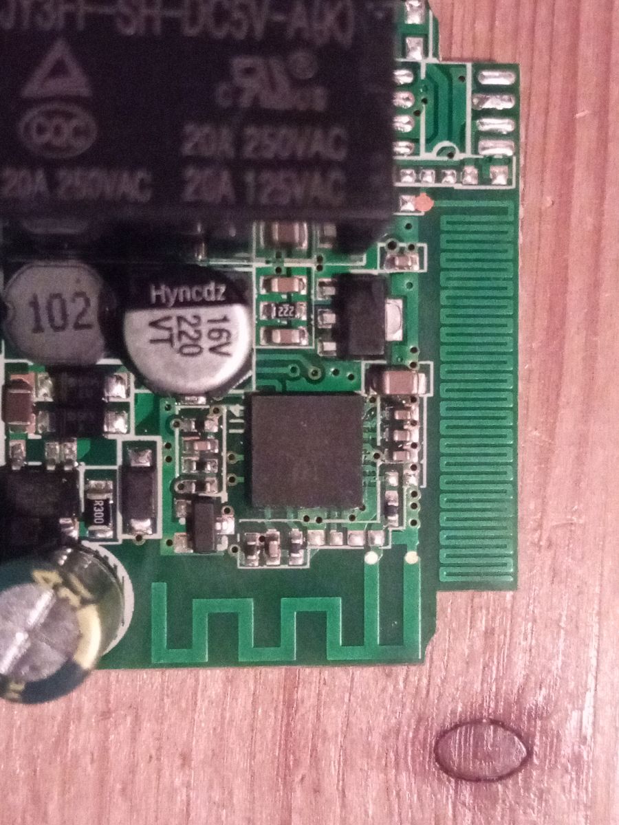

    bought some of these so called 'Mini Smart Switches' from our favorite Chinese marketplace, For incredible 2.59€ per piece.
    Tuya Smart Switch 16A WiFi module with technical specs and customer ratings
    Mini Smart Switch housing showing technical specifications and connector labels
    again a new variant of this device. At least I've not seen such on this forum.
    Unfortunately with a T34 directly mounted on the board. Even with all of our beloved flash signals exposed somewhere on the board.
    Electronic module with relay, capacitors, and PCB antenna on wooden surface
    Green printed circuit board with visible traces and solder points
    Except TX. Holy crap no way to grab this pin except removing the whole chip :-(
    Relay module with electronic components on stone background

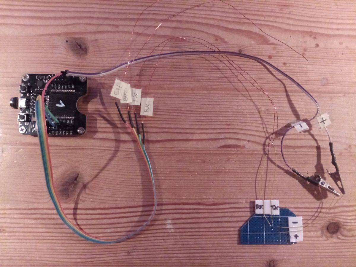

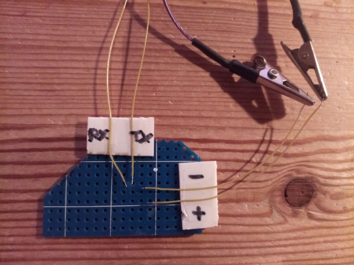

    for easier future use I handcrafted a small T34 flash adapter for my favorite USB ESP32 in circuit flash tool:
    Flashing yet another Mini Smart Switch with a T34, aka BK7231N chip
    my working OBK config is like this:
      "vendor": "Tuya",
      "bDetailed": "0",
      "chip": "BK7231N",
      "board": "TODO",
      "flags": "64",
      "keywords": [
        "TODO",
        "TODO",
        "TODO"
      "pins": {
        "8": "WifiLED;0",
        "10": "TglChanOnTgl;1",
        "23": "Btn;1",
        "26": "Rel;1"
      "command": "powersave 1",
      "image": "https://obrazki.elektroda.pl/1476559000_1759204894.jpg",
      "wiki": "https://www.elektroda.com/rtvforum/viewtopic.php?p=21705064#21705064"

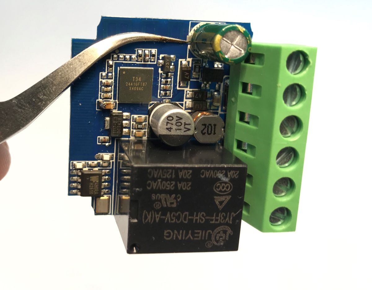

    #8 21714162
    Posts: 14755
    Rate: 12881
    I got the same as @sp4rk1e
    Electronic relay module with capacitors, ICs and terminal block
    https://github.com/openshwprojects/FlashDumps/commit/e6cc71df46ccbea39cd0eeee83b349599e2dc65e

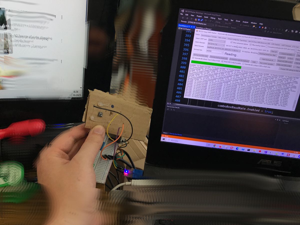

    It wasn't that bad:
    Person holding a cardboard-mounted sensor connected to a breadboard and laptop
    but I probably should buy this:
    Green PCB adapter QFN32/QFN40 to DIP32/DIP40 with labeled pins and central chip pad.

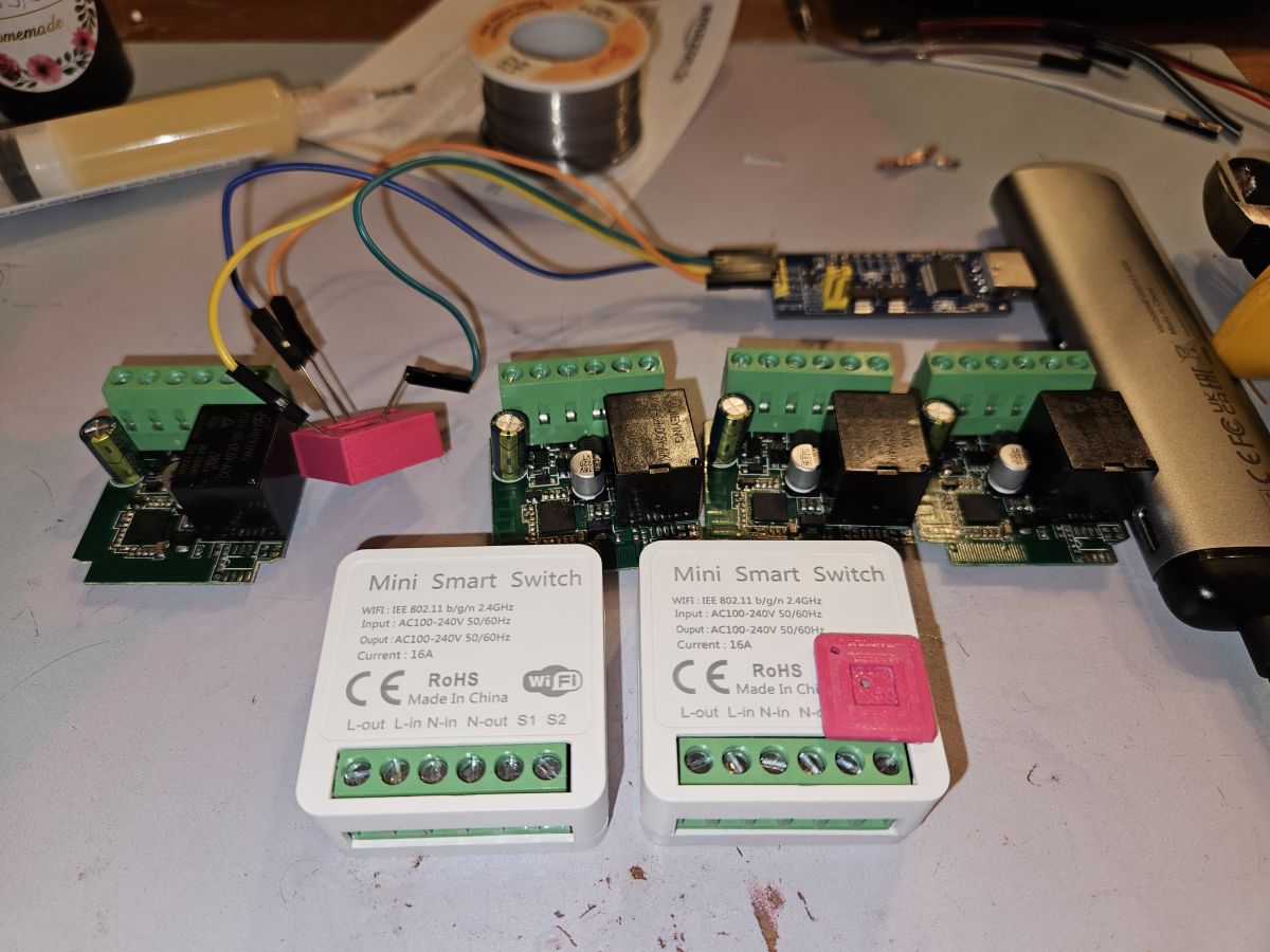

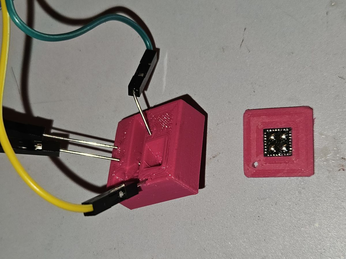

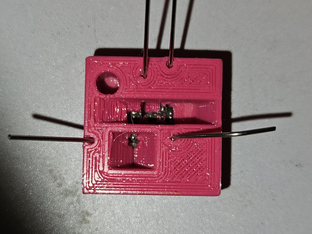

    #11 21732349
    woessner
    I bought six of them because it was quite easy to flash them last time but now I had the chips where the pins could not be accessed from the side :-(
    Hand-soldering tiny wires to the chip was a nightmare, though, but I did that on one of them and successfully flashed the firmware.
    Doing that on the five remaining ones --> no way!
    Thus I printed a jig to hold the chip.
    That worked amazingly!
    Thus I have to share the CAD files for that.
    Pink 3D-printed holder with a chip and thin soldered wires on sides
    Pink 3D-printed chip holder with connected wires and a separate chip module
    Set of Mini Smart Switch modules and circuit boards on a workbench
    PS: The LED is on 8
    Button on 10
    and Relay on 26
    Please find attached STL and Inventor files. If you need a different CAD file format, just send me a PM.
    • T34_Tuya.zip (679.06 KB) You must be logged in to download this attachment.
  • #12 21732366
    Posts: 14755
    Rate: 12881
    Interesting, I didn't think about such approach.
    CAD files could be useful, zip them and attach, or I can help if it's not working for you. Nice design.
  • 3D-printed jig worked with leaded solder pads
    #13 21732443
    woessner
    >>21732366
    Zip files worked!
    The print is accurate enough to give a good alignment, and on some of them I had to press down a bit on the 3D print to get a good contact with the needle tips, but other than that, no problem.
    I did add a bit of leaded solder on the chip pads before putting them in the jig; that might have helped a bit with the contact too, and I had to do that anyway to reflow them after programming.
