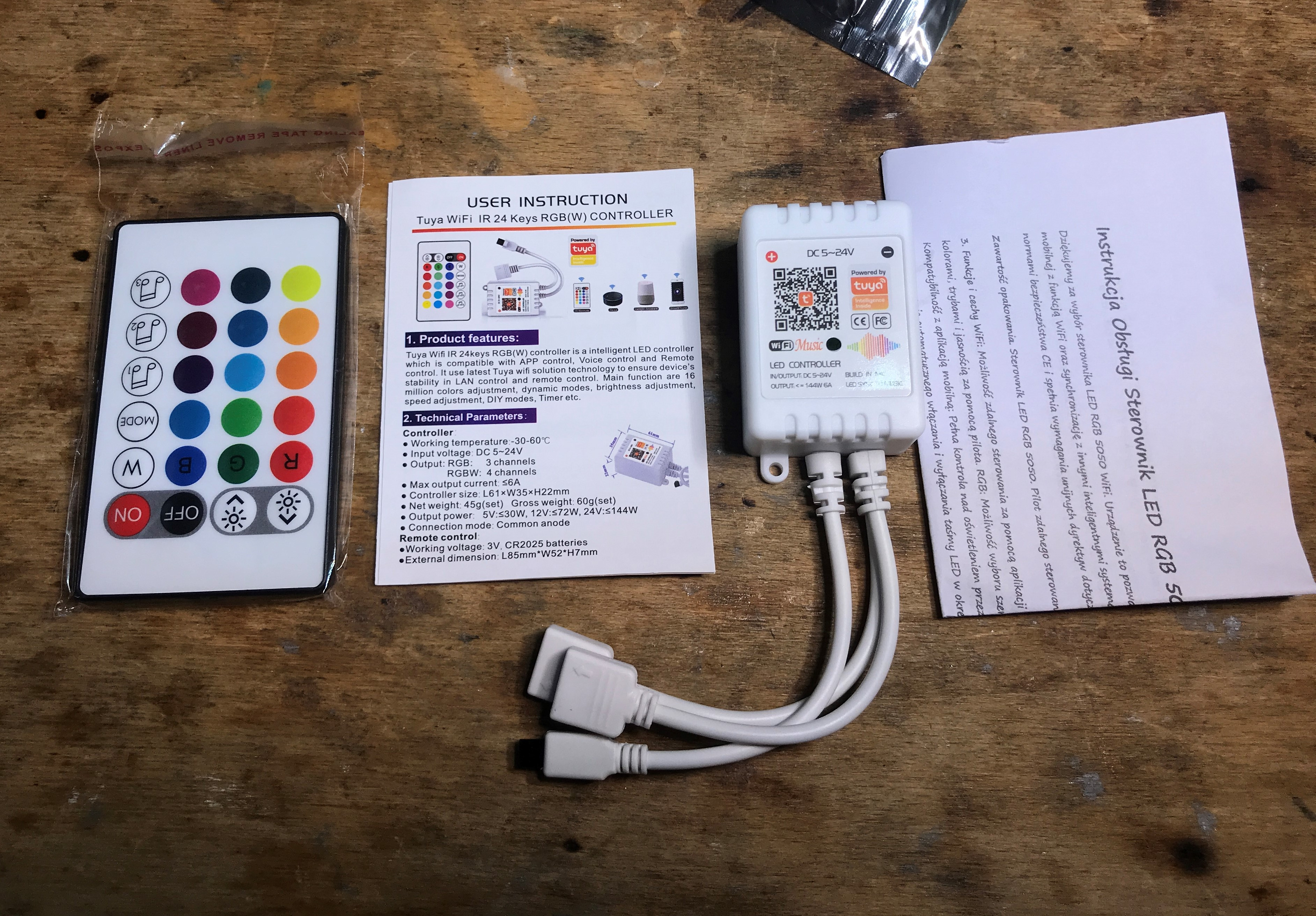

Tuya LED controller kit with IR remote and instruction manual on a wooden surface
The OP-WF-A3 is a three-channel RGB LED colour strip controller offering control in two ways - via Wi-Fi from the Tuya app, or via the included remote control. Here I'll show the inside of it, then I'll change its software so that it can be programmed a bit like an Arduino, and finally I'll show the decoding of the remote control codes and their handling in the new firmware.
RGB LED control set: IR and Bluetooth controller, 44-button remote, mobile app
We bought the kit for PLN50 - it doesn't include the tape and power supply. The controller works with RGB tape from the factory, but after my modification it will be freely configurable - it will be able, for example, to handle also CCT tape (white temperatures) or several separate white tapes.
