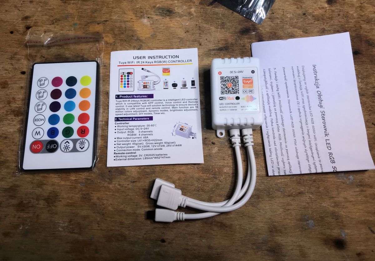

    The OP-WF-A3 is a three-channel RGB LED colour strip controller offering control in two ways - via Wi-Fi from the Tuya app, or via the included remote control. Here I'll show the inside of it, then I'll change its software so that it can be programmed a bit like an Arduino, and finally I'll show the decoding of the remote control codes and their handling in the new firmware.
    RGB LED control set: IR and Bluetooth controller, 44-button remote, mobile app

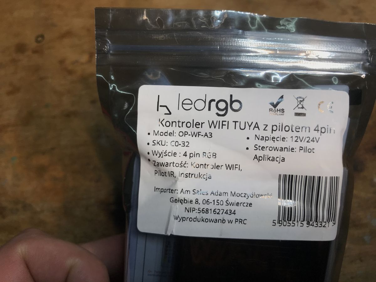

    We bought the kit for PLN50 - it doesn't include the tape and power supply. The controller works with RGB tape from the factory, but after my modification it will be freely configurable - it will be able, for example, to handle also CCT tape (white temperatures) or several separate white tapes.
    LED controller OP-WF-A3 packaging with label showing model and specifications

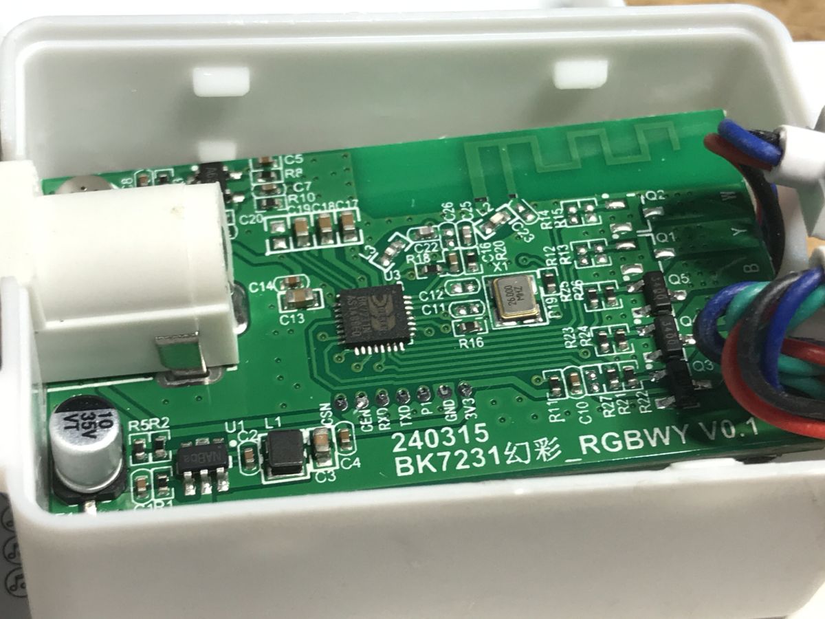

    Interior of OP-WF-A3

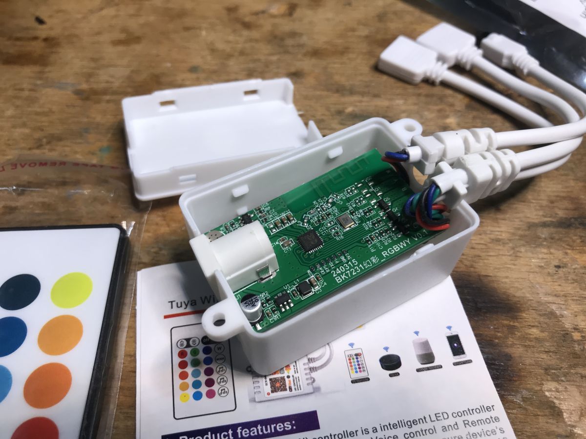

    Lift the cover, it's on a latch. There are no screws.

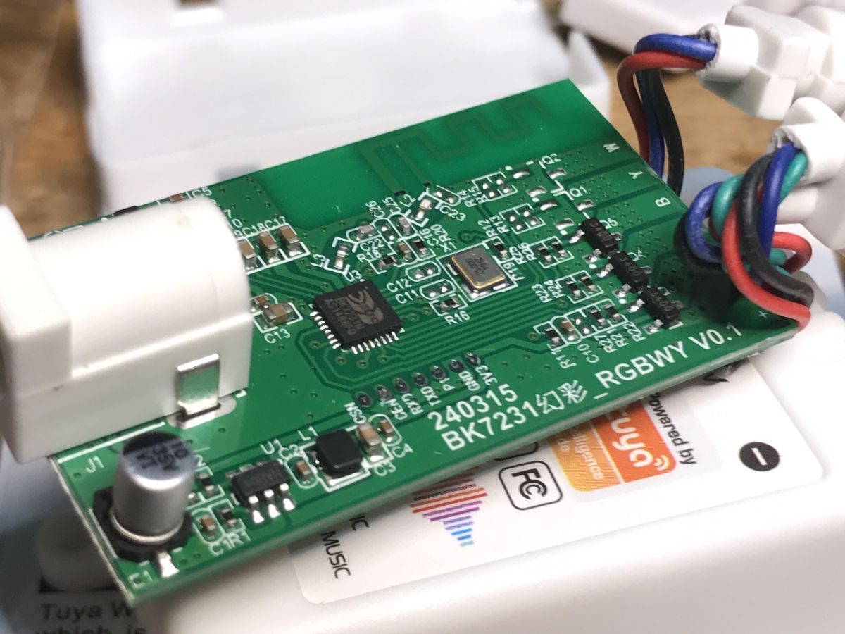

    OP-WF-A3 RGB LED controller with open case and visible BK7231N PCB

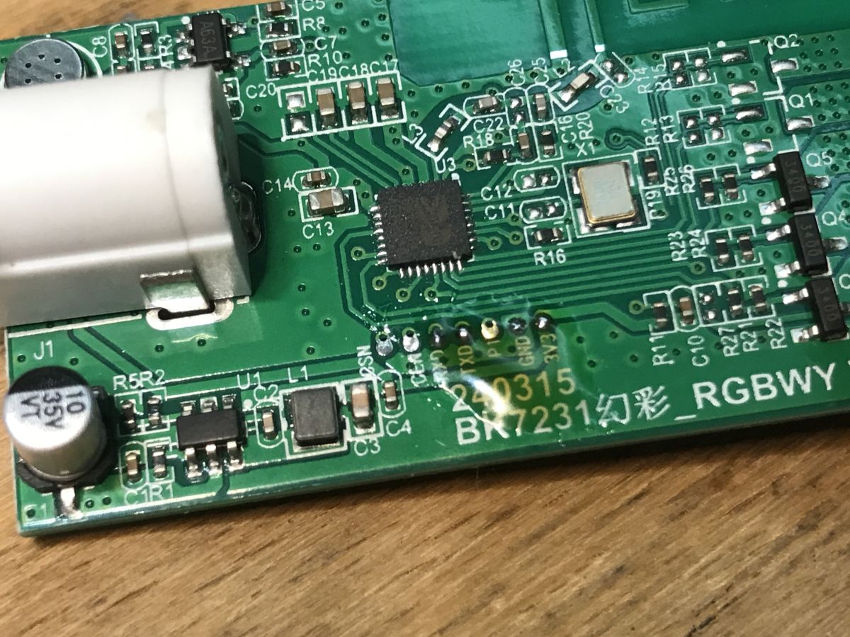

    PCB designation: 240315 (date? 15 03 2024?) BK7231 RGBWY V0.1.
    Interior view of OP-WF-A3 LED controller PCB with BK7231N chip and labeled components
    BK7231N is directly on the PCB. There is no separate Wi-Fi module. The antenna from the Wi-Fi is also in the form of a track on the PCB. In the power section there is an inverter to reduce the voltage. There is room for 5 transistors on the board, so theoretically there could be an RGB + CCT strip, but only 3 of them are manned. Next to the circuit there are signals for programming it on the pads.
    Close-up of OP-WF-A3 LED controller PCB with BK7231N chip

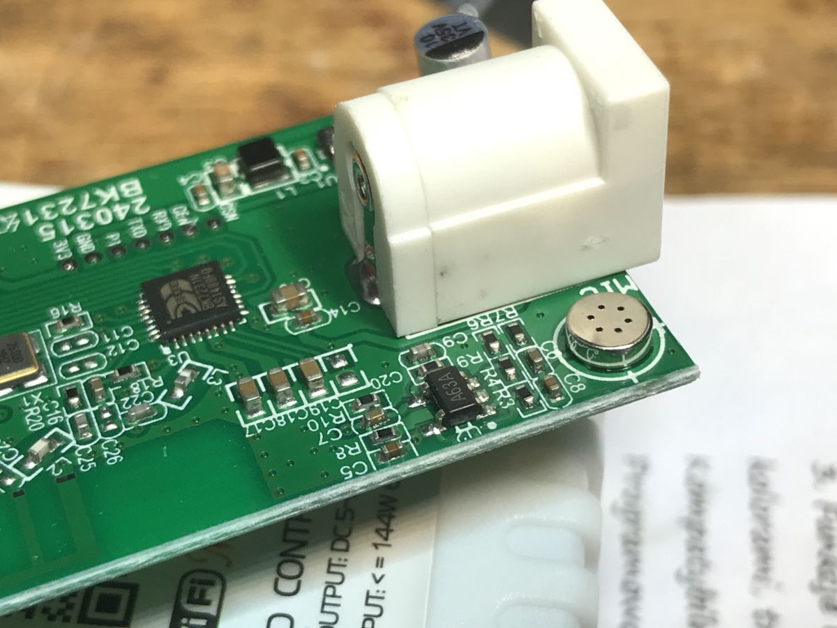

    On the other side we still have the microphone with amplifier:
    Close-up of OP-WF-A3 controller PCB showing microphone and integrated circuits

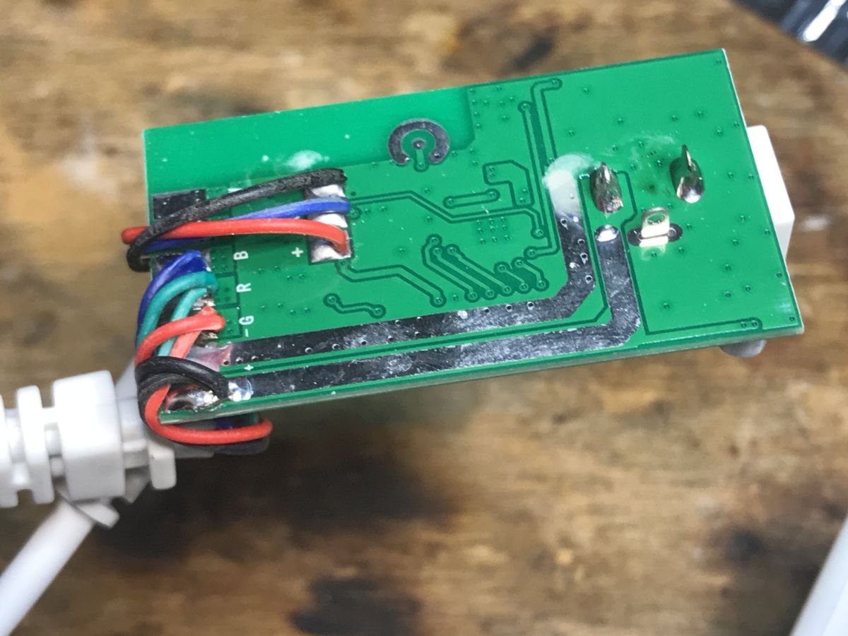

    Still left is the underside of the PCB - the tracks for the higher current are thickened and tinned:
    Bottom side of RGB controller PCB with thickened power traces
    Programming OP-WF-A3

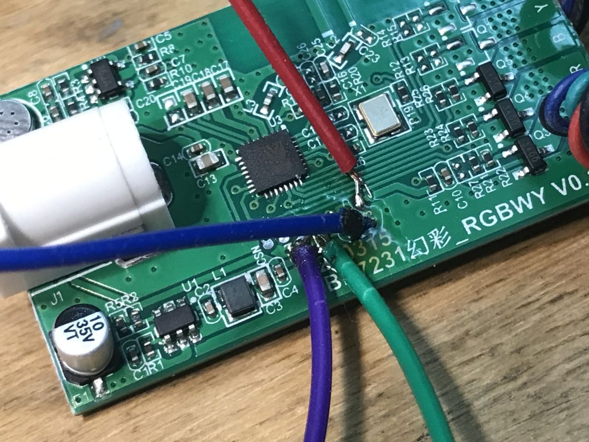

    You will need a USB to UART converter. Here we have everything outputted to the pads. These need to be whittled down first:
    Close-up of the OP-WF-A3 controller PCB labeled BK7231 with SMD components
    Then we solder the wires:
    Close-up of LED controller PCB with soldered wires for programming
    We upload the OBK:

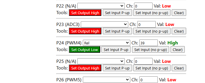

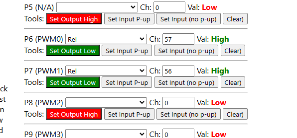

    The PWM pins can be found using GPIO Doctor:
    GPIODoctor in OpenBeken - a convenient way to learn about GPIO roles in an IoT device
    OpenBeken GPIO interface with PWM channel settings and control buttons GPIO interface section with pin settings from P22 to P26 on OP-WF-A3 controller

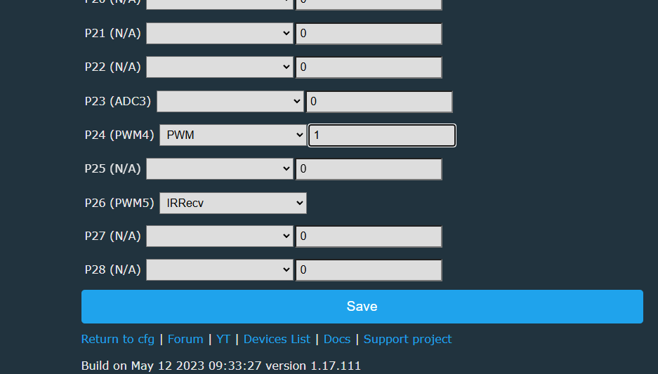

    You have to trace the path to the IR receiver yourself - but I have already done that for you, it is on pin P26:
    Screenshot of OpenBeken GPIO config, P24 set to PWM and P26 to IRRecv

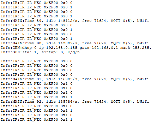

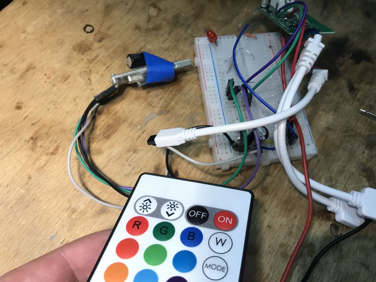

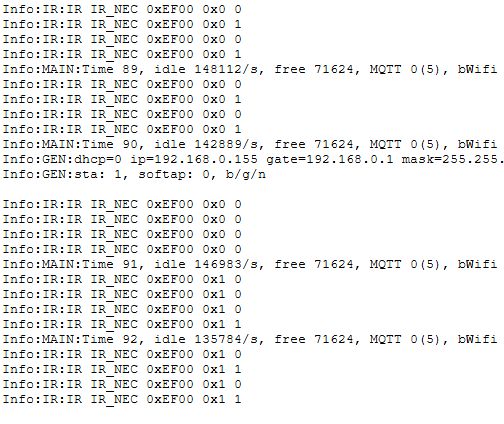

    We have to manually examine the IR signals - we restart the device after setting the IRRecv role and look in the log. We point the remote at the receiver and press the buttons. We look at what is being received.
    IR remote and OP-WF-A3 LED controller connected to a breadboard with wires
    On and off button:
    Device logs showing received IR codes in NEC format during LED controller operation
    The buttons are NEC standard. Codes 0x02 and 0x03 are responsible for switching on/off.

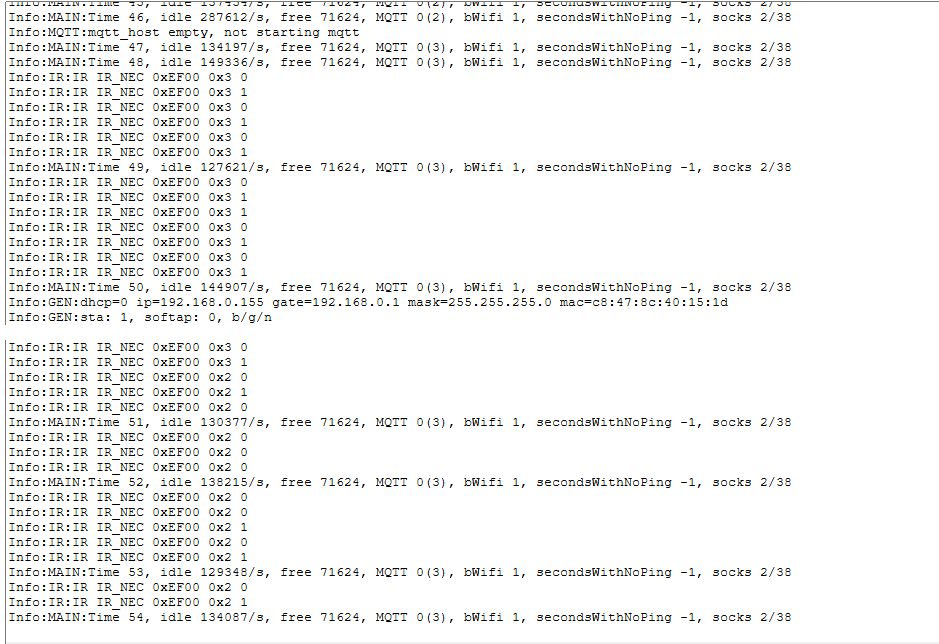

    Similarly, the brightness control:
    IR decoding logs from remote control using NEC format in OBK firmware
    In this way, we learn their codes and can then match OBK commands to them, as for example in the material on the BK7238:

    What is the microphone on this board used for? Control in time with the music, a modern colourophone of sorts?
  • #3 21764458
    Posts: 14622
    Help: 655
    Rate: 12638
    Yes, this is for this Music mode. It is connected via the amplifier to pin P23, which is the ADC. I've presented several times on the forum how such bars react to music and the feedback was that the effect is quite poor, but it's not my place to judge that.
    E.g. here are the recordings:
