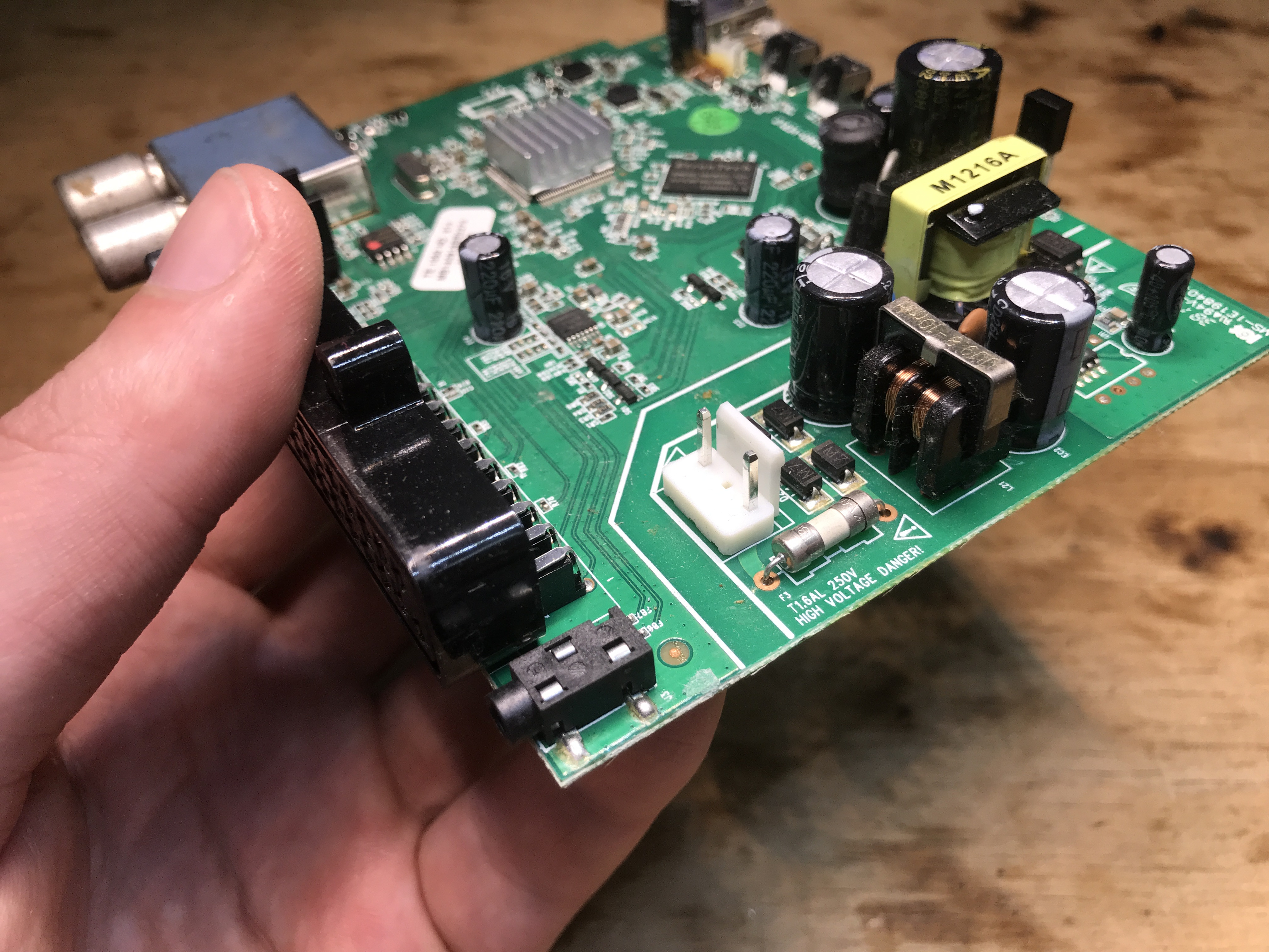

I invite you to another analysis of an older terrestrial TV receiver. In this topic I'll show its interior, view its board with a thermal camera, download the contents of its Flash memory and try to decode the partitions there myself in my own C++ program. At the end I will present the SDK I found, which may fit under this tuner.

There is a single PCB inside, not even a split for a separate power supply. There is also no display, so you can't use the parts to build a clock.
DVB tuner PCB with electronic components and M1216A transformer
The board consists of two sections - the 'hot', primary side of the power supply, and the 'cold', low-voltage side. Most of the components are surface mounted.
Close-up of PCB with power supply components and TV tuner connectors
The power supply is built quite well, there is even a filter against interference emissions, a fuse, a proper capacitor connecting the primary and secondary side.
Close-up of TNY176DG chip and power supply parts on a green PCB
The power supply is based on the TNY176DG in a surface-mount version. There is also space on the board for its through-hole counterpart.

On the secondary side you can see a classic - the "programmable Zener diode" TL431, it provides the reference voltage and takes part in the feedback loop of the power supply. Changing its resistors can change the output voltage to some extent.
Close-up of power supply components on TE 1050 HD tuner PCB
The CPU sections can now be viewed. The board is signed as MC6379-M3801-VER1.0:
Close-up of MC6379-M3801-VER1.0 tuner PCB with electronic components visible
The power supply typically gives 5 V, so lower voltages for RAM and CPU are generated by additional inverters:
Close-up of SMD components and power inductor on a green PCB from TE 1050 HD tuner
The program holds the Flash memory - 25Q32BSIG (4 MB):
Close-up of 25Q32BSIG Flash memory chip on TE 1050 HD tuner PCB
Close-up of EtronTech chip on the PCB of TE 1050 HD tuner
EM6GC16EWXD-12H is a DDR3 DRAM , 64M x 16 bit.
Close-up of M3801 chip on green PCB with various SMD components around it
The CPU itself appears to be an M3801 ALI. This agrees with the device data sheet.
