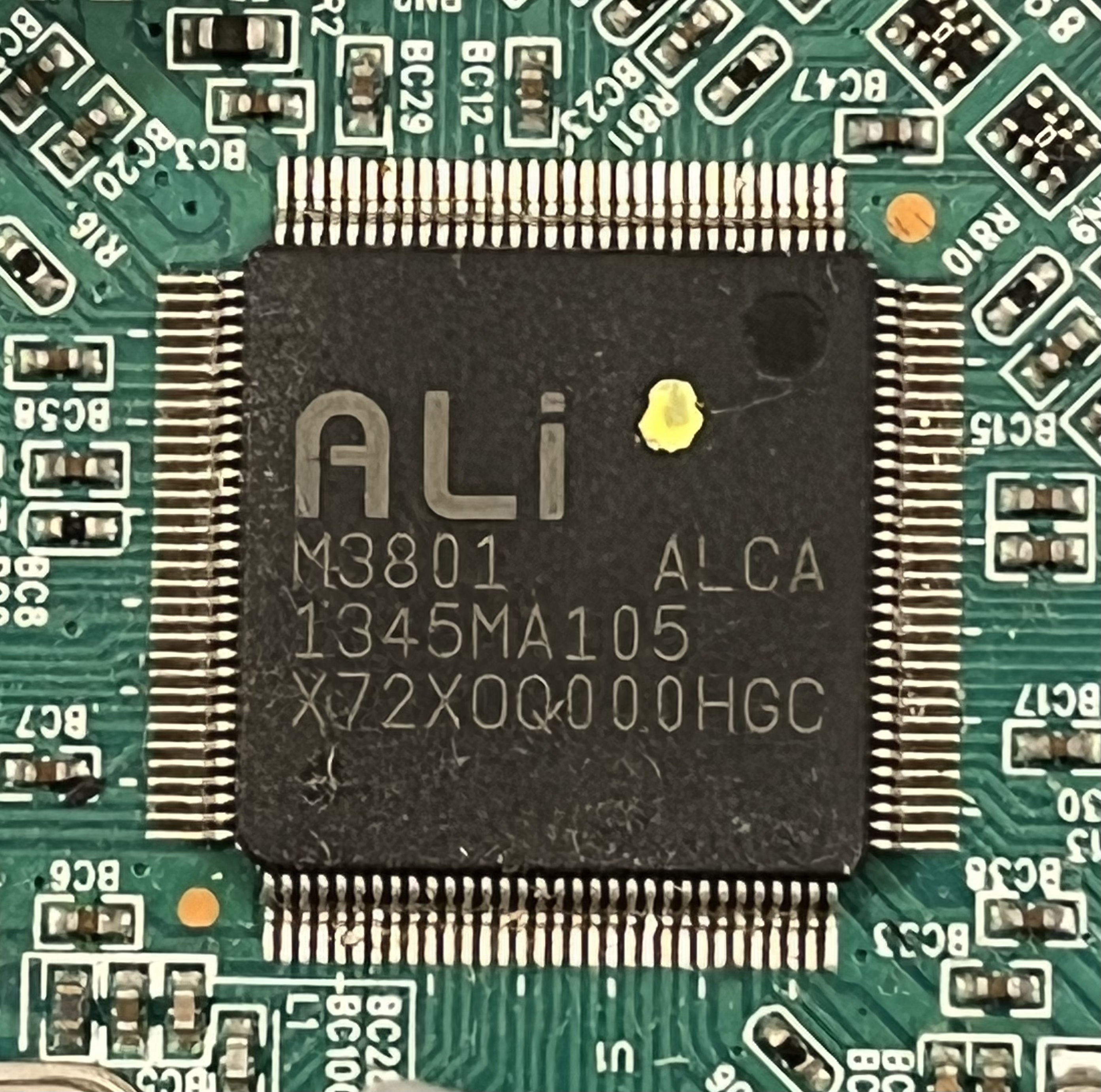

I will show here the first attempts and a simple "Hello world" for the ALI M3801 processor on the example of an old Comsat TE 1050 HD tuner based on the project ali_sdk from GitHub. I will then try to add new functionality to it - GPIO support. The project shown here is not a full Linux SDK, but on the contrary, it is a minimalist demo built from scratch to which most of the functionality has yet to be added.

The ALI M3801 is based on the MIPS architecture. I compile the firmware on Ubuntu, according to the readme from the demo author ( michal4132 ):

I have ALI M3801 and I received 0x3811, but maybe it is some internal revision of the chip.
