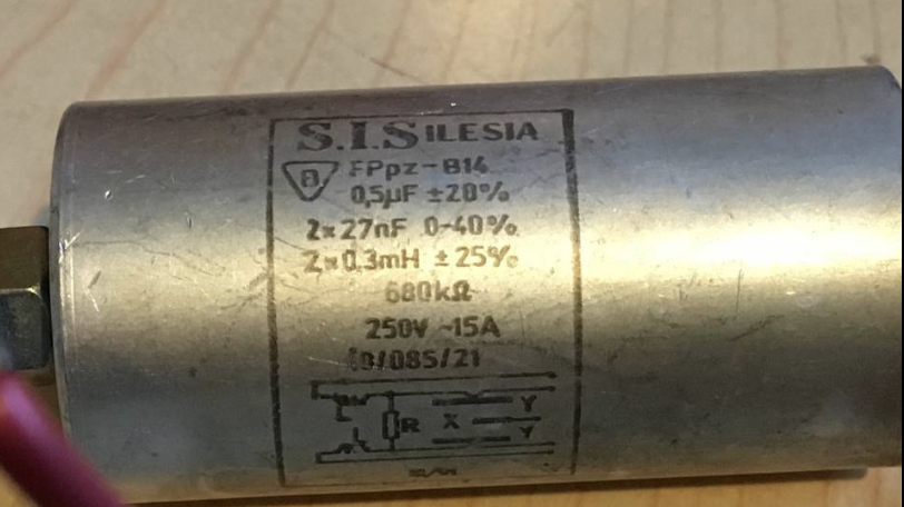

  • Polish measurement equipment often uses Silesia mains filters and notorious RIFA paper capacitors that fail after decades.
  • The filter topology uses an input choke for common-mode noise, two Y capacitors to earth, and an X capacitor across L and N for differential noise.
  • In HP digital oscilloscopes from the 1990s, these capacitors were built into filters integrated into the socket and switch.
  • Cracked resin lets moisture in, the capacitors leak, and the filter can explode, swell, or spray tar inside the unit.
  • Repairs usually mean replacing them with film or polypropylene capacitors such as WIMA or Wurth Electronics, or removing the filter entirely.
Metal enclosure of S.I.S Silesia EMI filter with printed electrical specifications
In Polish measurement equipment it is common to find filters manufactured by Silesia . The diagram on the chassis allows discussion of each part of this filter - the purpose of the choke at the input is to suppress common mode interference ( common-mode interference ), that is, interference that occurs simultaneously on the L and N wires relative to PE. Two capacitors of type Y form a low impedance path to earth for high frequency currents. The capacitor type X is intended to suppress differential interference ( differential-mode ), i.e. that which occurs between the L and N conductors. It acts as a shunt for high-frequency currents, allowing them to flow past the receiver (the rest of the device).
What are the problems with them?
These filters were built using paper capacitors. The filter housing was filled with tar and the whole thing was sealed with epoxy resin. After years, this resin often cracks and moisture gets inside. The capacitors get leakage, so several things can happen. It usually ended up that when plugged in, the filter explodes with a big bang or slowly expands, pelting the inside of the unit with tar. The repair is to remove the filter, which can be replaced with a modern factory design made with film capacitors, or it can simply be cut out, reckoning with a higher level of interference. The tar can be easily removed with either extraction petrol or WD-40.

ArturAVS 09 Dec 2025 10:11
What do you see as the problem? These were the elements then, and these were used. Every filter from the factory has a data sheet with the most important parameters to help you choose a replacement. [Read more]
filipcichowskidev 09 Dec 2025 11:32
The problem I see is that someone could be electrocuted by such a faulty filter. Such components were used then, but today we have 2025 and better capacitors. Let me give you an example from work: we... [Read more]
ArturAVS 09 Dec 2025 11:41
And what did you expect from such a vintage piece of equipment? That each component would hold its parameters for 50 years? So before measurements, they had to be upgraded to modern components. They... [Read more]

filipcichowskidev 09 Dec 2025 12:36
I see that this has not resonated. No standard that I know of allows 10 mA to flow between PE and L. This is already a noticeable current flow. A healthy person should be fine if such a current flows... [Read more]

filipcichowskidev 11 Dec 2025 11:58
Regulations and standards aside, let's both agree that if we have a leakage of 10 mA, that's a problem that needs to be fixed? [Read more]
ArturAVS 11 Dec 2025 12:18
Of course! I don't remember the exact value anymore, but it was a few uA. [Read more]
filipcichowskidev 11 Dec 2025 18:06
Slightly more, as according to EN 50699 0.75 mA under normal conditions. [Read more]
