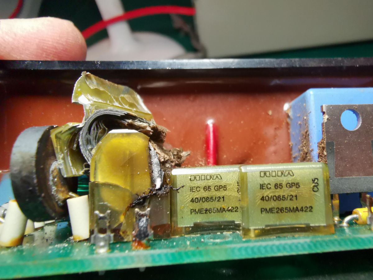

    The story is very similar with RIFA capacitors.
    Damaged RIFA paper capacitor on a PCB, partially blown open with foil exposed
    Some say that Surstromming is the worst thing the Swedes have given the world, but my poll winner is these paper capacitors. The EEV Blog forum community often jokes that an extension of the name RIFA is " replace if found, always! " The capacitor housing is simply a layer of resin that cracks after years and leakage occurs. I have repaired quite a lot of Tektronix brand measuring equipment by simply replacing the RIFs with good quality polypropylene capacitors WIMA or Wurth Electronics .

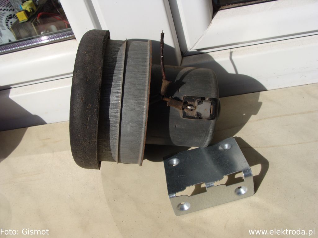

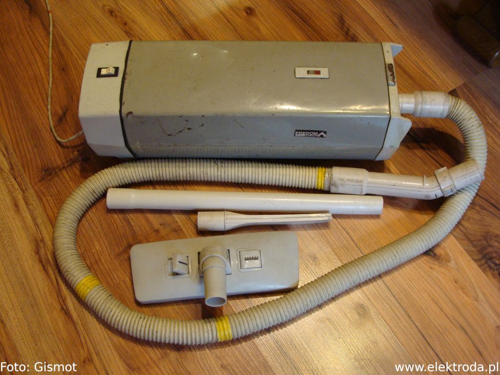

    #24 21780722
    Gismot
    Level 19  
    Posts: 283
    Help: 36
    Rate: 171
    filipcichowskidev wrote:
    an Zdziś, after many years, decided to start up a frequency meter on his retirement from ZURiT 30 years ago. You can forget about electric shock protection in his house - he has an old two-wire installation with neutral and solid fuses self-made from nails. So good, in fact, that there has never been a need to replace them. Unaware of the leakage of the capacitors, he connects the meter to the mains and, as it happened, the capacitor between the L and PE wires leaked - the current electrocuted Zdzis. Although he survived, he fell to the floor and was injured. Because of his old age, he now has to lie in bed wearing cat gloves and rubbing himself with badger fat.
    The frequency meter is probably of Polish manufacture so is made in protection class I and is fitted with a power cable with a 2P + PE plug. Therefore, a power socket with a protective pin (earthing) is required and this is described in the operating manual. However, many users disregard this.
    However, in many older houses I have seen hmmm bizarre solutions: the use of a 300 ohm flat cable in the wall (if you plugged in a hoover at such a person's house, you could feel with your hand where the cable runs), old-type sockets without pins, fuses on nails....
    Is this topic finally about noise filters or about domestic electrical installations that have been made not according to standards by a "pseudo electrician" ?
    I have also seen Polish devices built supposedly within protection class II, yet with protruding metal elements.
    E.g. Polish audio equipment, hoovers, frania spinning washing machine, etc. are made in protection class II.
    Take the ZELMER hoover type. 251, which is made in protection class II and has a metal housing.

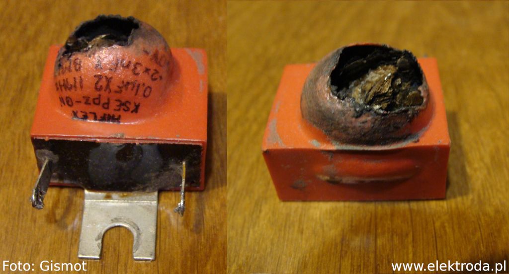

    It is equipped with an RH 5500 motor together with a MIFLEX KSEPpz - 011 anti-interference filter.
    Is this equipment safe? as much as possible, as the motor is isolated from the housing by rubber spacers.
    Old Zelmer type 251 vacuum cleaner with hose and nozzle on wooden floor Damaged MIFLEX KSEPpz-011 interference filter with burnt wire visible
    And this is how the faulty MIFLEX anti-interference filter KSEPpz - 011 looks like:
    Damaged MIFLEX KSEPpz-011 interference filter with burnt casing

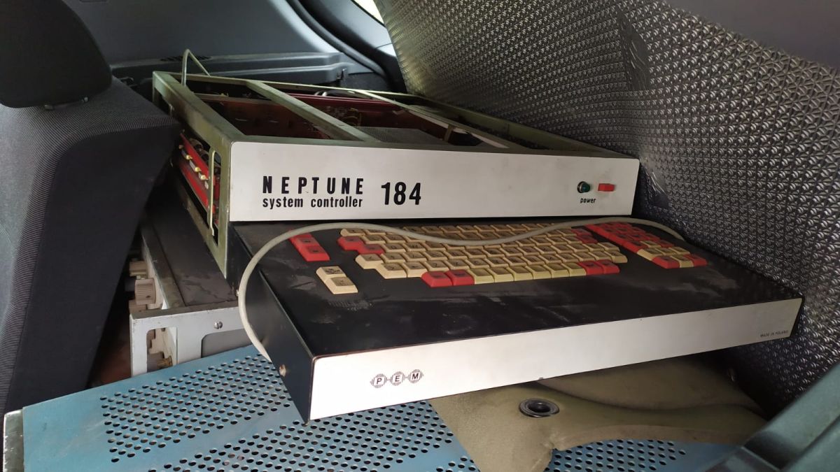

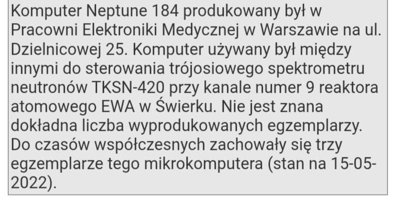

    Old Neptune 184 system controller and keyboard in a car trunk Text about Neptune 184 computer used at EWA nuclear reactor in Świerk
