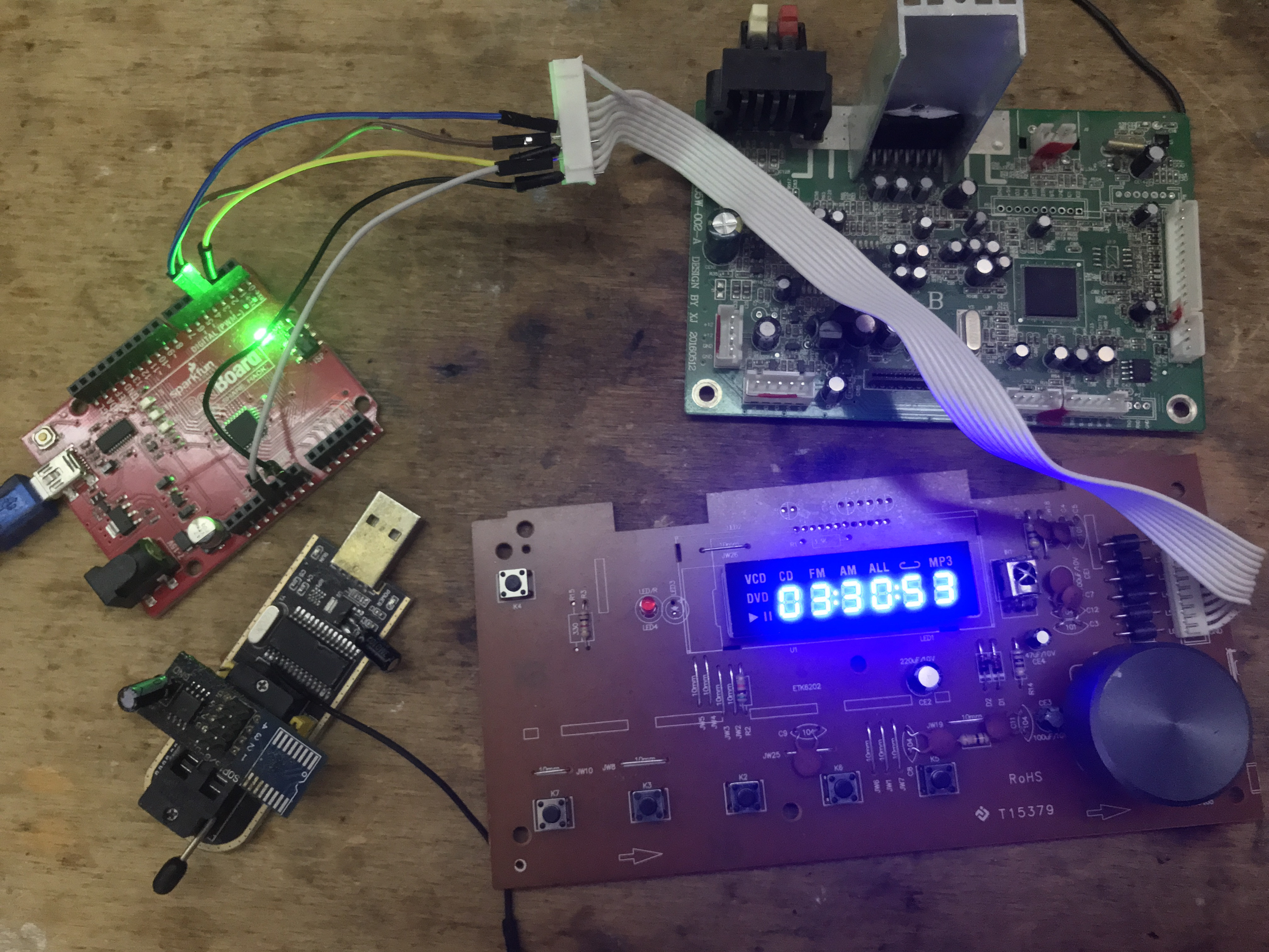

First step with the display
The display module is very attractive and useful - it doesn't require many pins to control, and it fits the watch just right. There are lots of digits, there are two colons, it will be worth the struggle.
You need to start with the CD1628 datasheet note. Fortunately, it is available:
Part of the CD1628 datasheet showing LED driver features and description
The CD1628 is controlled by three pins - DIO (data I/O), CLK (clock) and STB (strobe, chip select).

We are running the HD2015 display/button controller after reverse engineering, comparison with TM1637itd
7-segment displays on TM1637 - 4 and 6 digits - Arduino, protocol
The main difference is that instead of generating I2C-style start and stop conditions here, we operate the STB pin here.
It's time to put this into code - I've chosen Arduino for simplicity:
First pins - 0 and 1 are RX/TX, so I started with 2:
Code: C / C++

Result - first without setting the correct grid/segment configuration (0x03):
Blaupunkt MS8BK micro hi-fi display showing active icons and 7-segment clock
With correct configuration:
Blaupunkt micro hi-fi clock display with blue backlight and audio source icons

In this way you could make a functional clock or device controller with a display. You could still run an encoder and harness it too.
Summary
The equipment came to me incomplete, although I certainly know that the power supply was in working order and useful to the original owner.
In addition to the power supply there was the motherboard and front display PCB.
The motherboard turned out to be quite interesting, I was able to rip the Flash memory, determine the MCU architecture, analyse its firmware and even find its links to chips from DVD players. I also wanted to upload a simple "blink LED" to it, but unfortunately this one didn't start - I didn't experiment with it further, though, as I suspect something may have been corrupted earlier.
The front panel also caught my interest, and in this case managed to get it working easily from the Arduino. Almost all of it is realised using the CD1628 chip, a unified display and keyboard controller similar to the more popular TM1650, TM1637, TM1636, etc. Even the register addresses match.

How do I drive the MS8BK CD1628 display with Arduino?
Wire three pins: DIO to D2, CLK to D3, STB to D4. Send 0x03 (mode), 0x40 (write), then 0xC0 + 14 data bytes, and finish with 0x8F (display on, max brightness). Bits latch on CLK rising edge. Use provided writeBit/writeByte helpers for timing. [Elektroda, p.kaczmarek2, post #21783892]
Quick how-to: light all segments, then clear them?
  1. Initialize pins, set CLK/STB/DIO HIGH.
  2. Call writeDisplay(on[14]=0xFF each) to light all segments.
  3. After 1 s, call writeDisplay(off[14]=0x00 each) to clear. This validates your wiring and CD1628 mode selection. [Elektroda, p.kaczmarek2, post #21783892]
Which command controls brightness and how many control wires are needed?
Use command 0x8F for display ON at maximum brightness. You can reduce brightness with the lower nibble per CD1628 control scheme. The interface uses three wires total: DIO, CLK, and STB. “The main difference is STB instead of I2C start/stop.” [Elektroda, p.kaczmarek2, post #21783892]
Why don’t single bytes map to single digits on this display?
Digit segments are interleaved across alternating addresses. The author built segment masks and a drawText() that composes seven segment bits per digit into the 14‑byte frame. Expect to map each segment bit to its byte/bit position first. [Elektroda, p.kaczmarek2, post #21783892]
