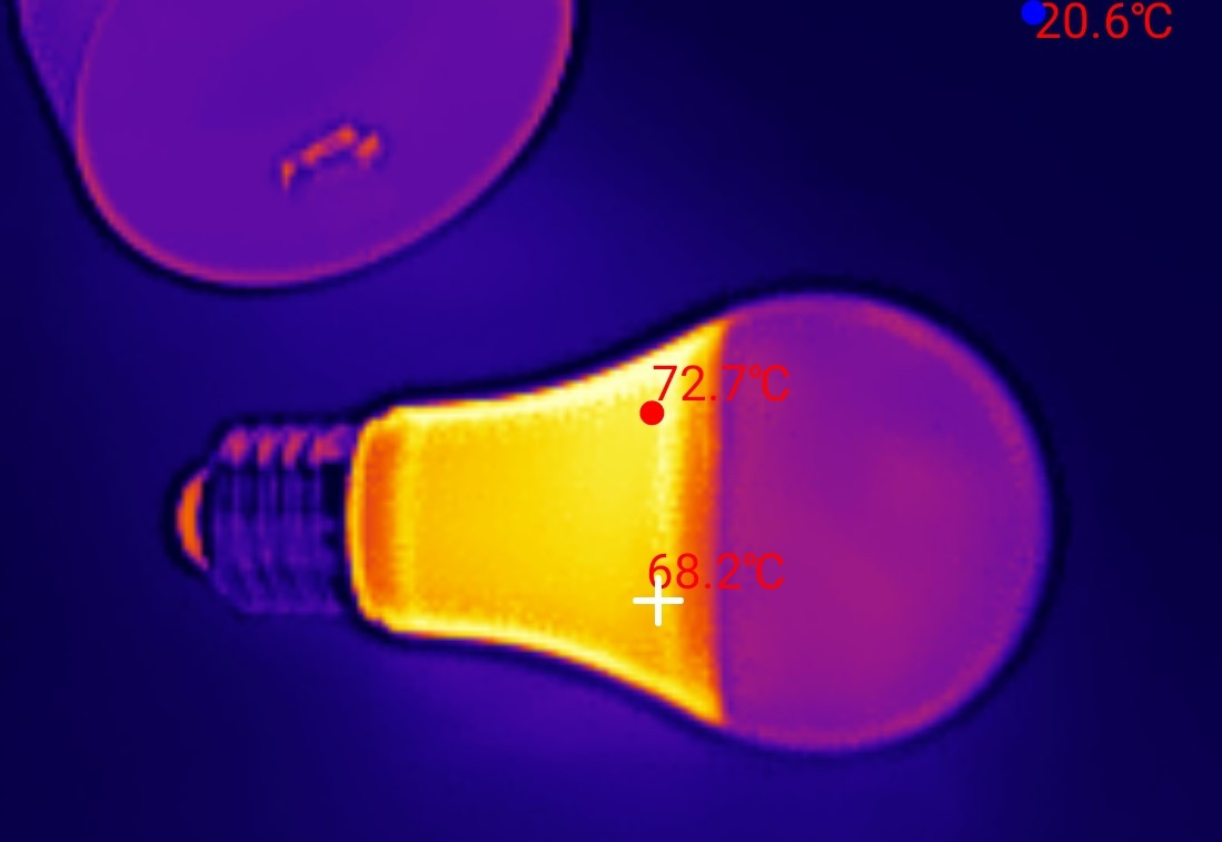

Heat-up test
The first thing I wanted to check was the heating of the product in the factory configuration. I waited fifteen minutes. The luminaire may not have been the best, as it's not ventilated, but that's what's used after all. You can see about 60°C before wringing it out:
Thermal image of LED bulb with surface temperature of 62.7°C
The housing is metal, only the outside is covered with plastic. The whole thing is hard to touch. It will be interesting to see what happens inside.
Thermal image of LED bulb showing 72.7°C and 68.2°C temperature readings
I couldn't delay as everything cools down quickly. Dome removed:

The 100°C barrier has been crossed, although the power supply and Wi-Fi module are probably the most heated, not the LED board itself. I still tried to take a picture with the macro lens:
Thermal image of LED lamp components, hottest point reaches 87.3°C
The LEDs are unlikely to be suitable for continuous operation in such conditions. Let's see if anything can be done.
