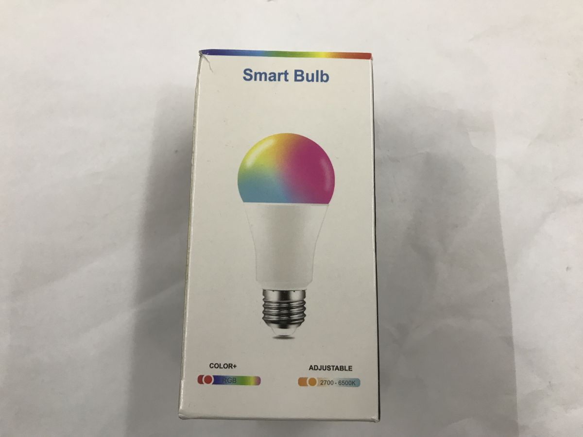

    Are 'smart' LED lights designed to overheat? What temperature will such a "led" light reach after a quarter of an hour of operation? Is it somehow possible to reduce its heating and prolong its life? I invite you to a presentation of the interior, measurements, and firmware changes of the SL20, a Wi-Fi controlled LED lamp offering control over brightness level and white temperature.

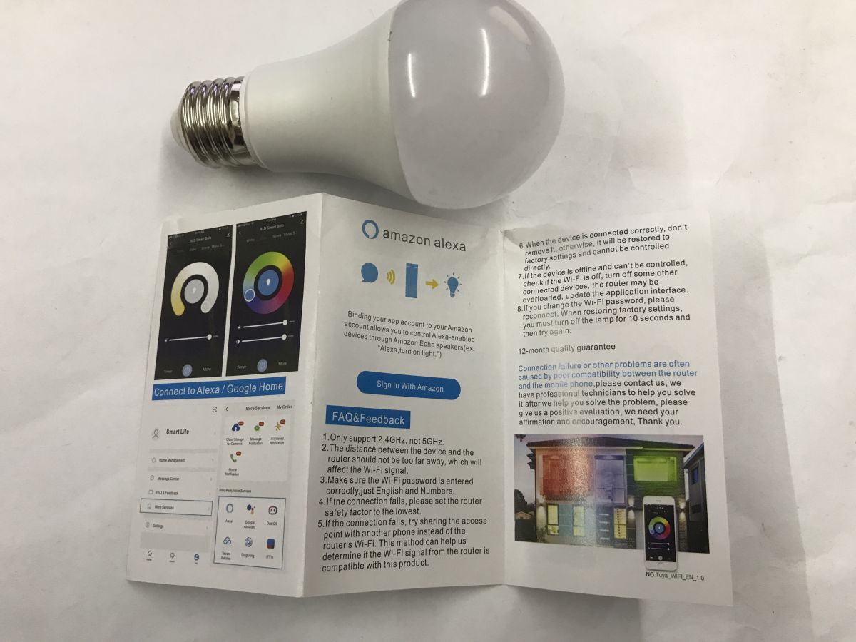

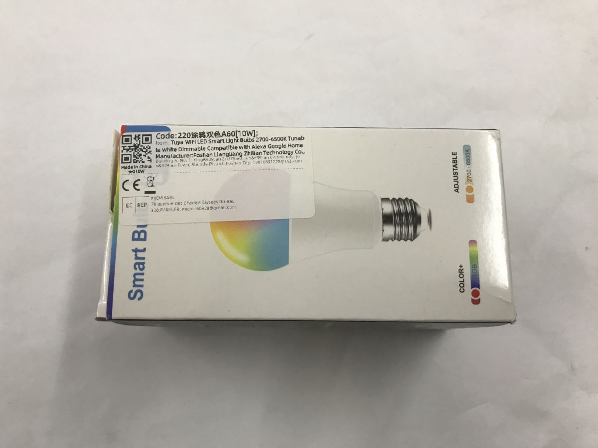

    Tuya WiFi LED bulb A60T 10W box with manufacturer label and CE markings Side of LED bulb box with RGB and 2700–6500K color temperature range Smart Bulb packaging with colorful light bulb illustration and RGB/CCT info

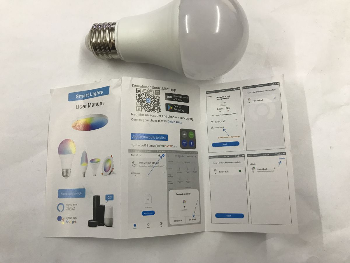

    Pairing with application
    The instructions describe the pairing process well - you need the Tuya app, a Wi-Fi network (necessarily 2.4GHz) and you also need to turn on Bluetooth, as the first scan for the device is over BT. We do three quick power on and off. The lamp should start flashing.
    Smart LED bulb with user manual showing pairing instructions and QR code Smart LED bulb and instruction leaflet showing Alexa integration setup

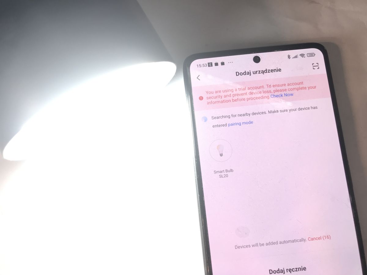

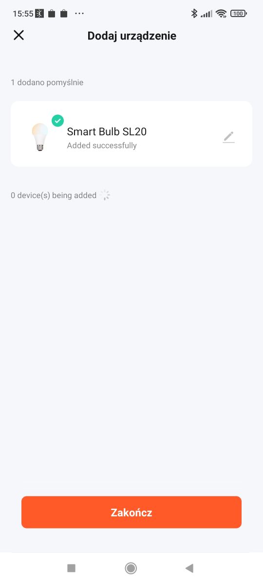

    Tuya sees it as SL20:
    Phone pairing with SL20 LED lamp using Tuya app in configuration mode

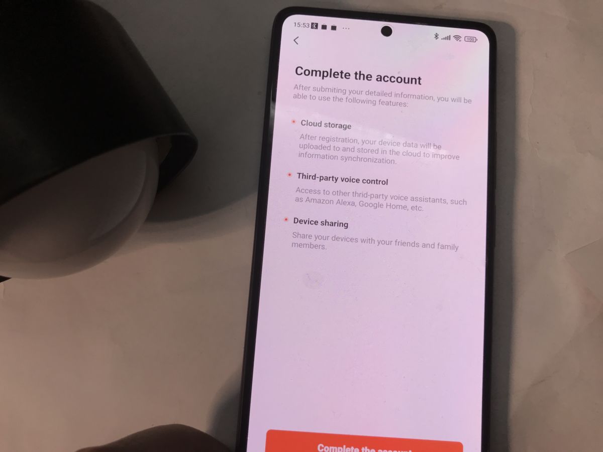

    It cannot be paired without logging in:
    Phone screen showing Tuya app account setup, with LED lamp housing nearby

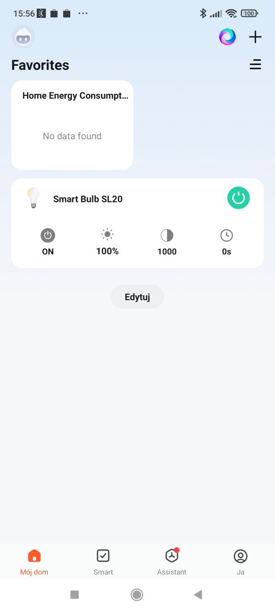

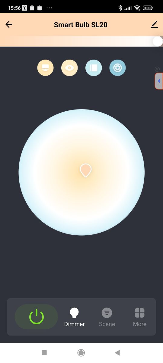

    Success:

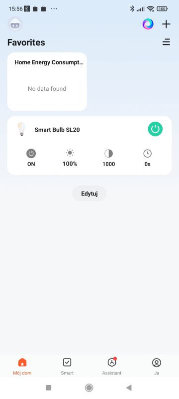

    Tuya app screen showing Smart Bulb SL20 added successfully Smart bulb SL20 control screen with color temperature and brightness slider Tuya app interface showing color and brightness controls for SL20 bulb

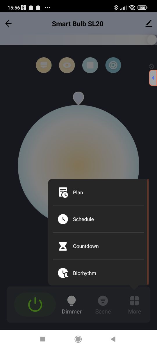

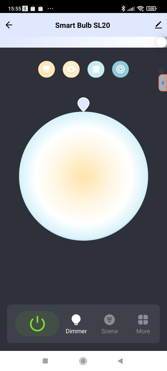

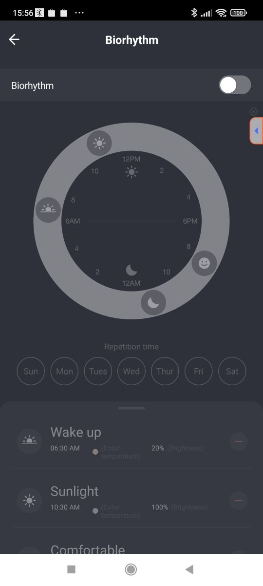

    With the app itself it's standard - we have control over the lighting temperature and over the brightness level. We have a countdown timer and automations. In addition, we have various animations and modes, including a 'biorhythm' mode that adjusts the light temperature according to the time.
    Smart Bulb SL20 app screen with planning menu expanded Biorhythm mode screen in Tuya app for controlling SL20 LED lighting Tuya app interface showing Smart Bulb SL20 at 100% brightness setting

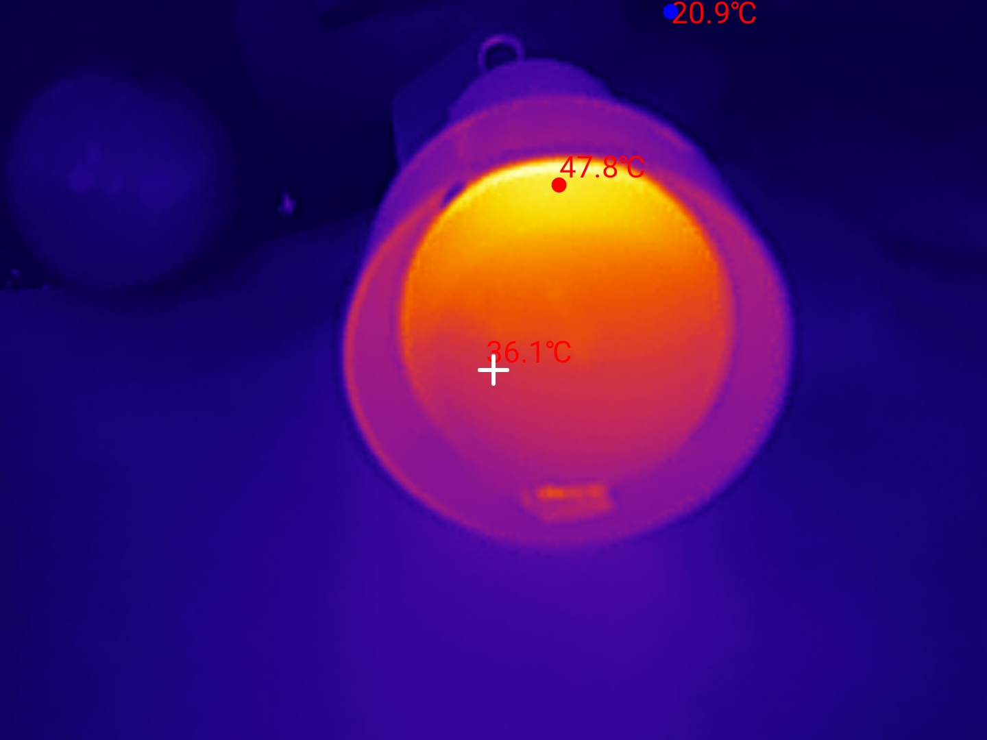

    Heat-up test

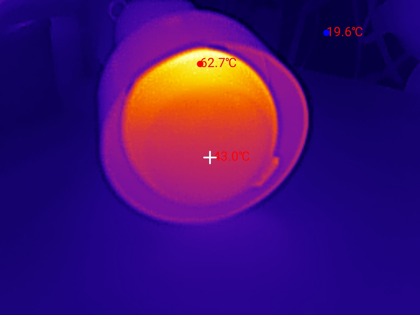

    The first thing I wanted to check was the heating of the product in the factory configuration. I waited fifteen minutes. The luminaire may not have been the best, as it's not ventilated, but that's what's used after all. You can see about 60°C before wringing it out:
    Thermal image of LED bulb with surface temperature of 62.7°C

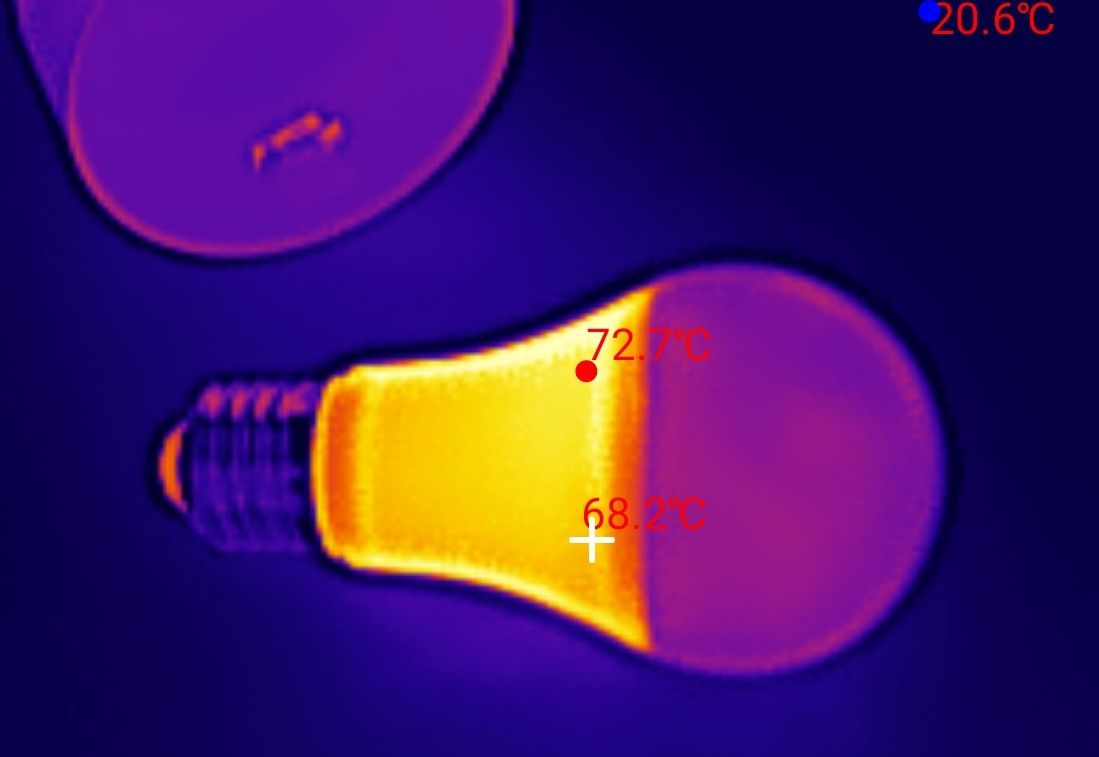

    The housing is metal, only the outside is covered with plastic. The whole thing is hard to touch. It will be interesting to see what happens inside.
    Thermal image of LED bulb showing 72.7°C and 68.2°C temperature readings

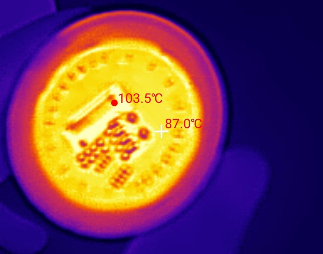

    I couldn't delay as everything cools down quickly. Dome removed:
    Thermal image of an LED bulb showing temperatures up to 103.5°C

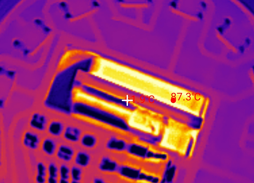

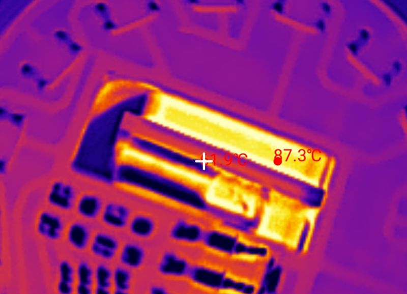

    The 100°C barrier has been crossed, although the power supply and Wi-Fi module are probably the most heated, not the LED board itself. I still tried to take a picture with the macro lens:
    Thermal image of LED lamp components, hottest point reaches 87.3°C
    The LEDs are unlikely to be suitable for continuous operation in such conditions. Let's see if anything can be done.

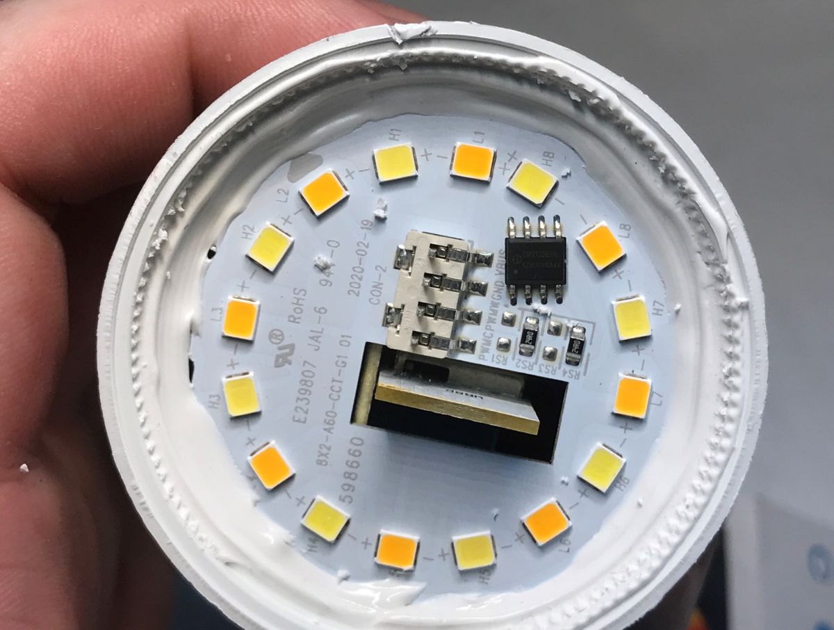

    Interior of product

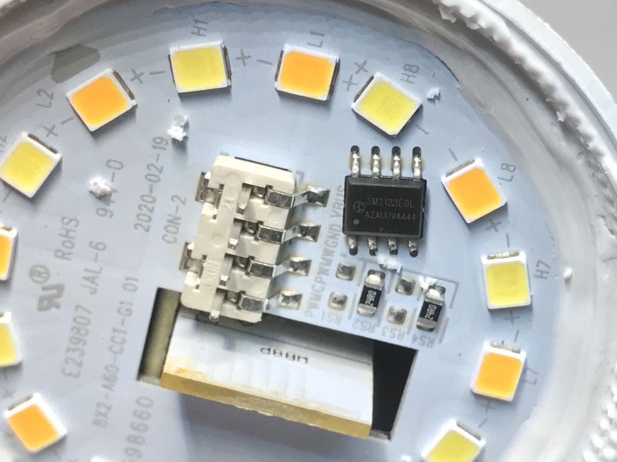

    The dome is glued, it can be peeled off, or possibly levered up, but you can't insert a screwdriver too deeply.
    LED lamp interior showing LEDs and SM2123EGL controller on a white PCB

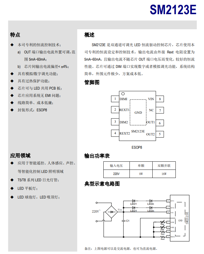

    The LEDs are controlled by the SM2123EGL:
    Close-up of SM2123EGL chip and LED lights on a circuit board of LED lamp
    Chinese datasheet for SM2123E LED current driver with pinout and application circuit

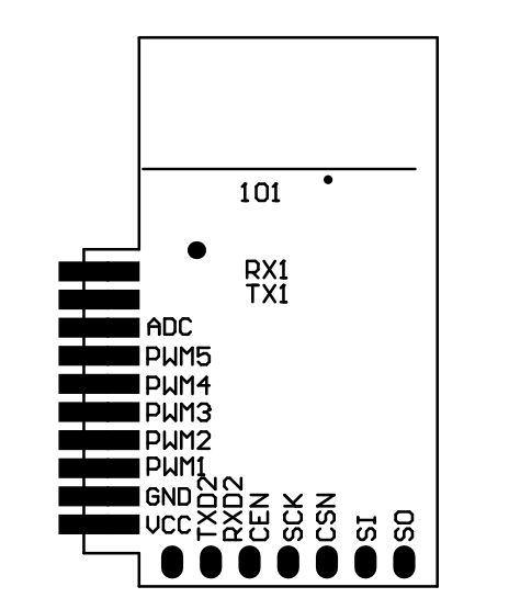

    The WB8P is based on the BK7231T. It can be uploaded OpenBeken via UART.
    Wi-Fi module pinout diagram showing ADC, PWM, UART, and SPI labels

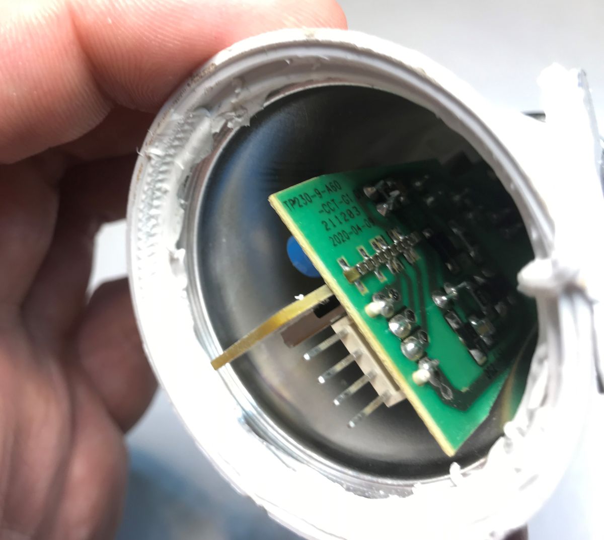

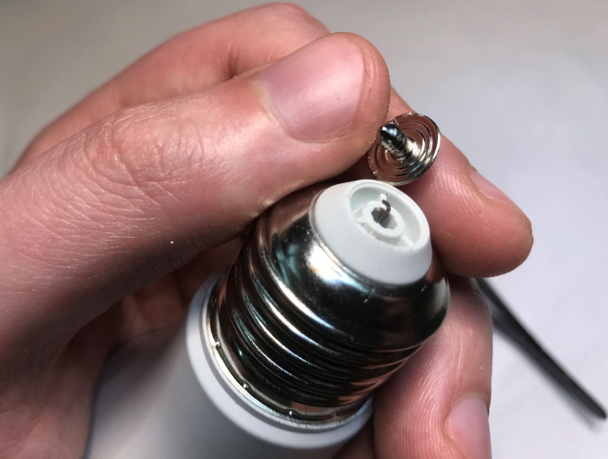

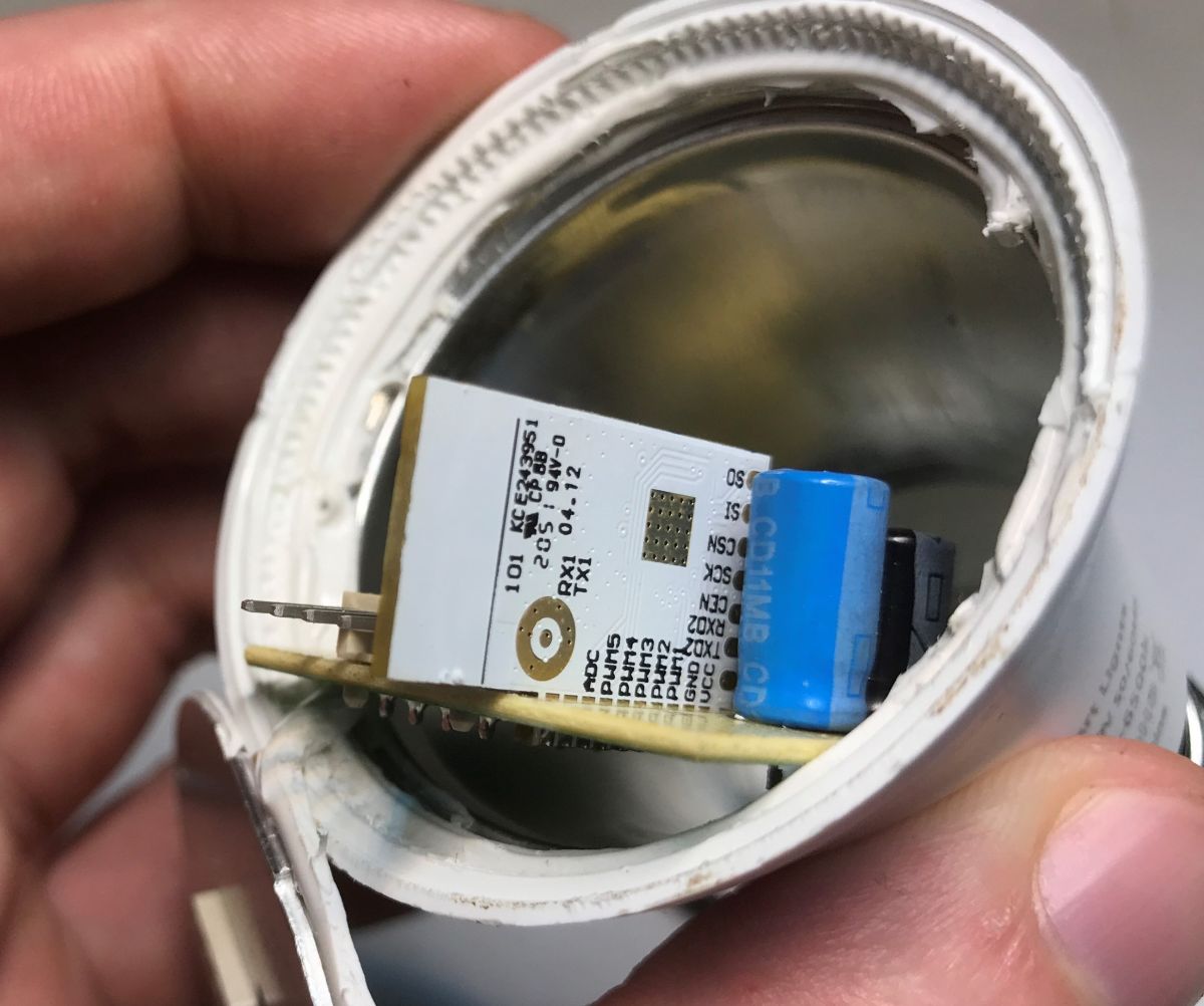

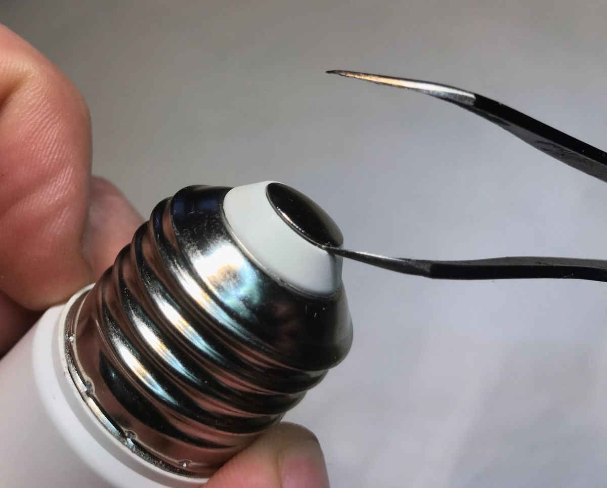

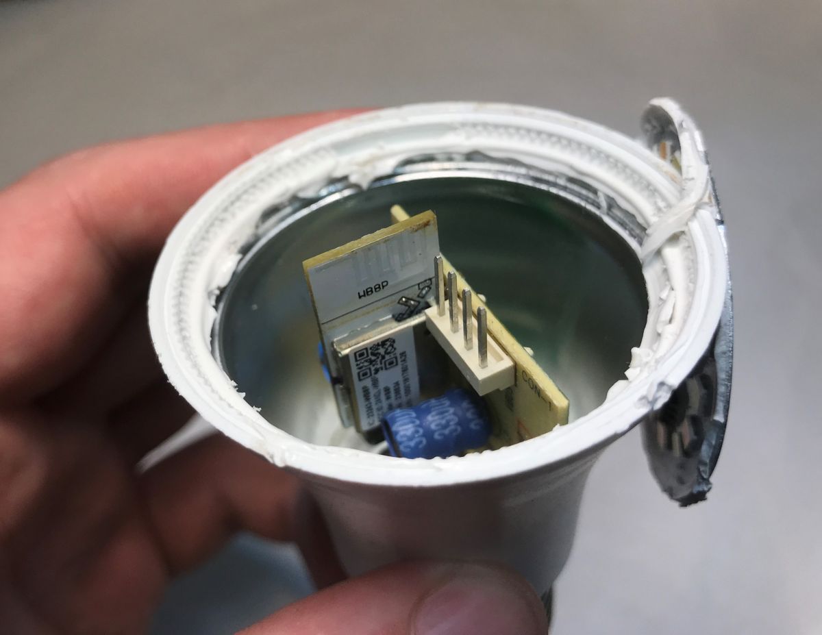

    You need to get to the power supply and RX/TX. To do this I slightly freed the PCB by removing the "button":
    Close-up of LED bulb base and tweezers lifting white plastic insulator Close-up of a disassembled LED bulb base with E27 thread held in a hand
    The plate can now be ejected:
    Close-up of the WB8P Wi-Fi module and capacitor inside an LED bulb housing
    I stripped the wires and soldered two directly to RX and TX, and two to the capacitor legs from 3.3V - you can see by the tracks that it is connected there.

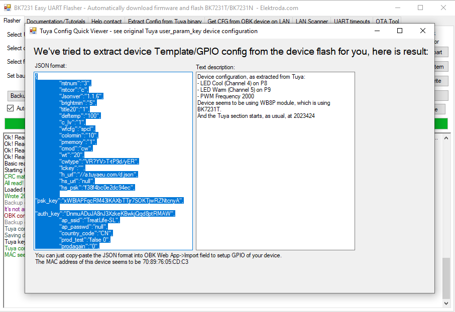

    We flash according to the instructions of the BK7231GUIFlashTool, a comprehensive UART tool, not only for Beken:
    You need a solid 3.3 V power supply and a USB to UART converter.

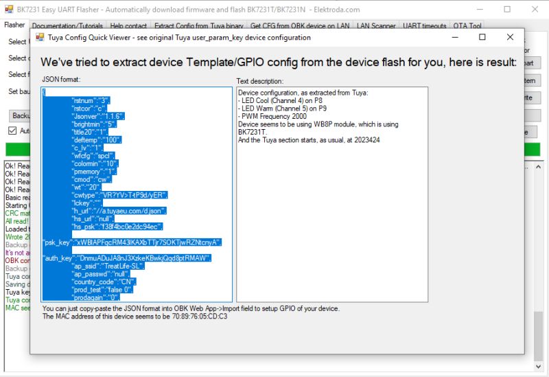

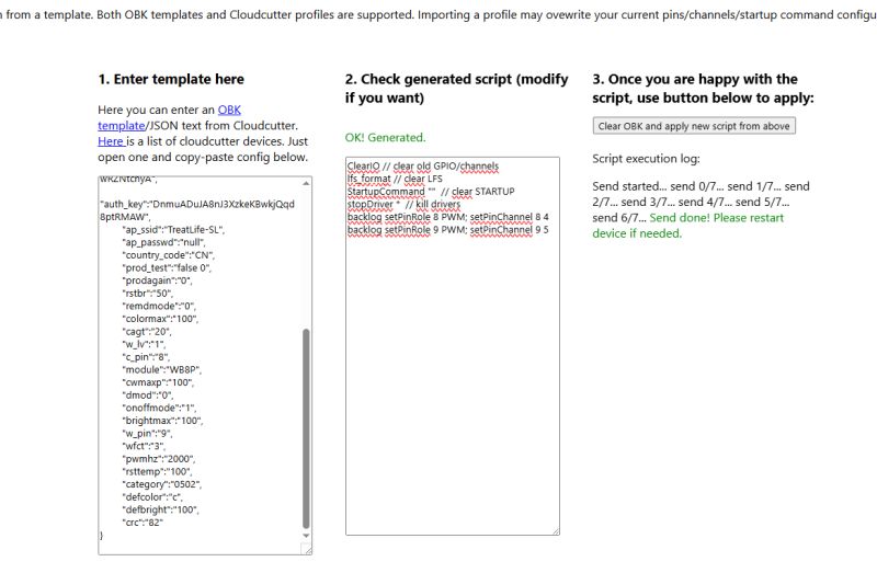

    Flasher correctly discovers the GPIO configuration:
    BK7231 tool window with extracted GPIO configuration in JSON format
    JSON Tuya:
    Even the PWM frequency was able to be extracted - 2 kHz. Template OpenBeken :

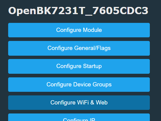

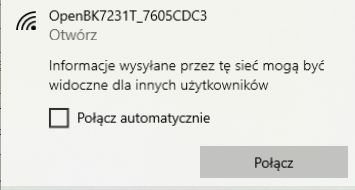

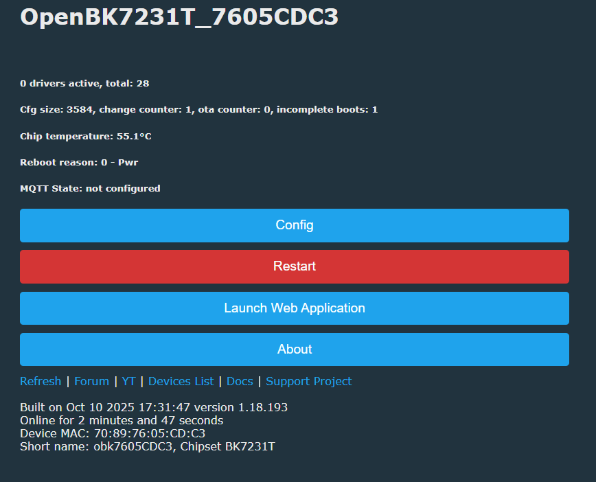

    Then you can quickly configure OpenBeken - we connect to the AP, the configuration IP is 192.168.4.1, we set a bearing to our network:
    Wi-Fi network OpenBK7231T_7605CDC3 visible with Connect option in Windows
    OpenBK7231T interface showing chip temperature of 55.1°C and Restart button
    OpenBeken interface showing LED module configuration options

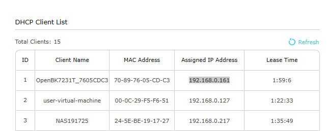

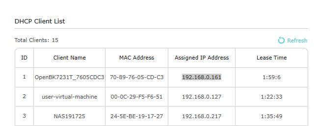

    The device joins our Wi-Fi:
    DHCP client list showing OpenBK7231T device with IP assigned as 192.168.0.161

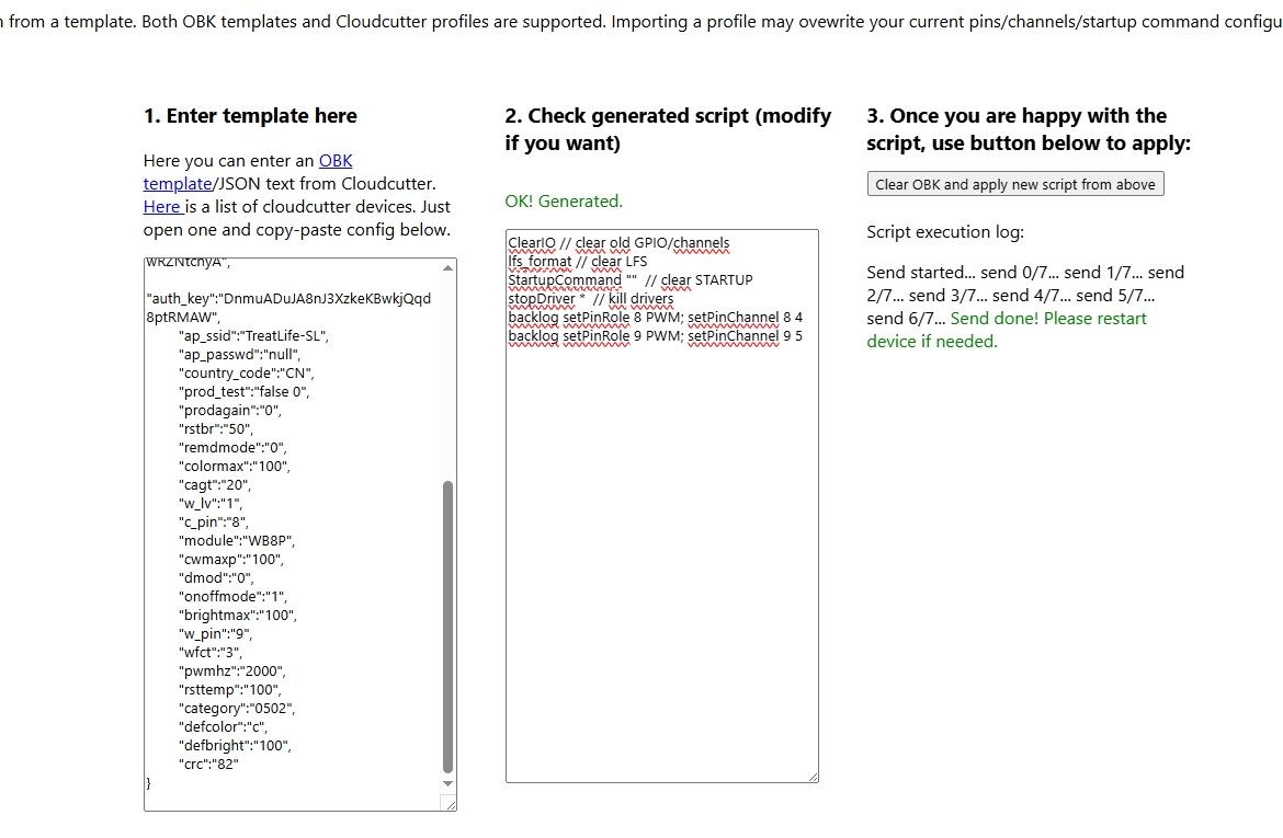

    We then import the template in the Web App - > Import:
    Screenshot showing SL20 LED bulb configuration in OpenBeken with initialization script.

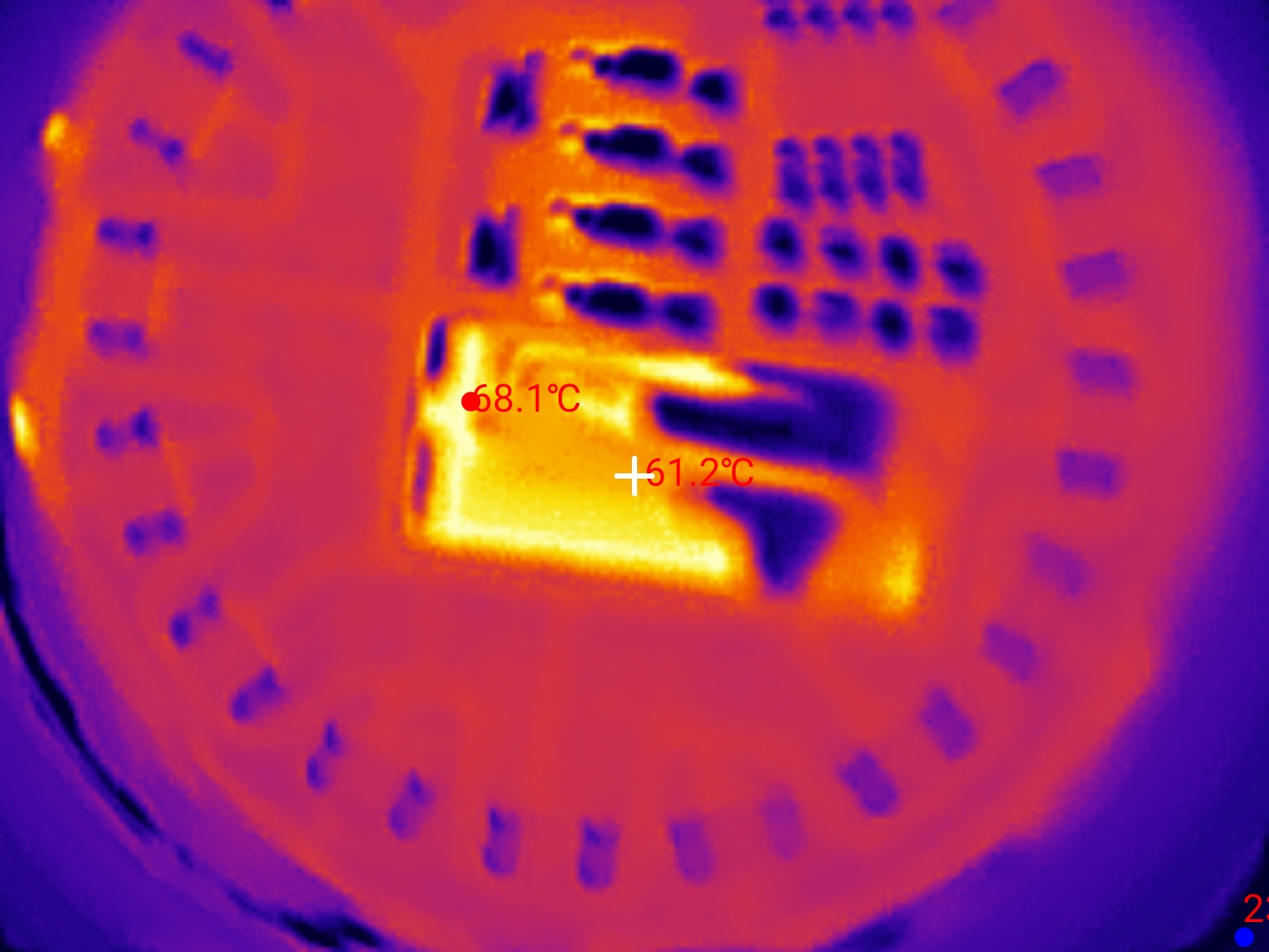

    Heat-up test - 80% PWM

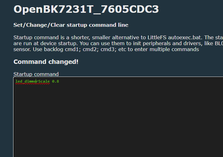

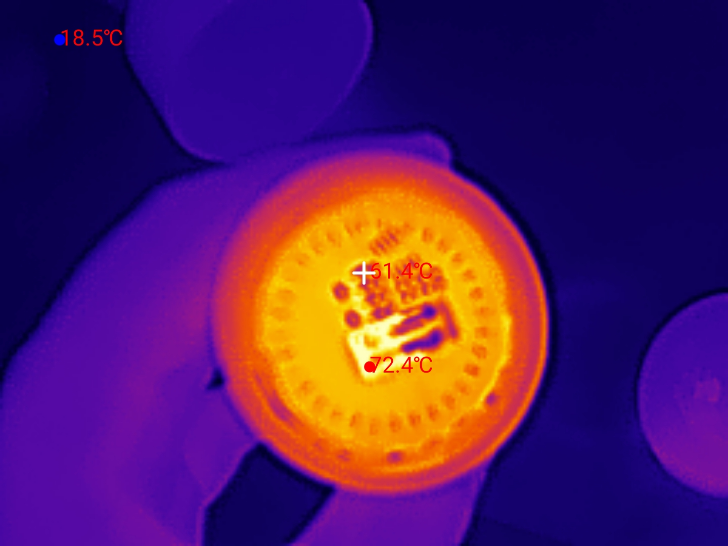

    OpenBeken allows you to artificially limit the PWM range so as to reduce power consumption and heating of the LEDs. This is not a primitive way on the principle of "remember to set 80% brightness", but an elegant method that hides everything in the firmware, and the UI and Home Assistant still operate on an apparent range of 0-100%, where the displayed 100% is actually the limit we set.
    OpenBeken screen with startup command “led_dimmerScale 0.8” applied
    It's time to check the effects:
    Thermal image of an LED bulb with visible temperature reading points
    Thermal image of LED bulb interior showing 72.4°C and 51.4°C hot spots
    Thermal image of LED lamp interior with marked temperature measurement points
