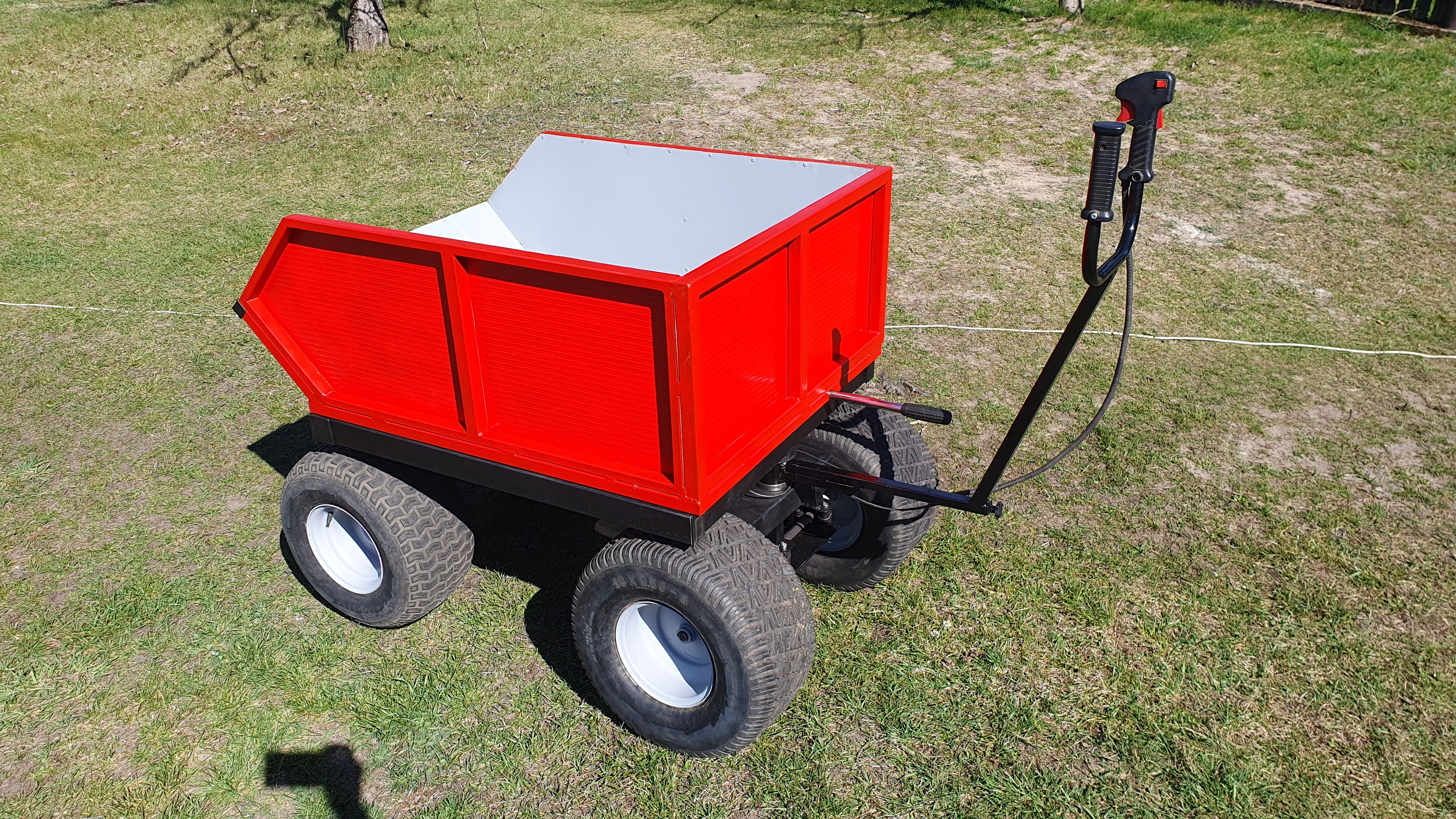

Good morning.
I would like to show you my mini hauler, which is powered by an engine from a petrol scythe.
Red mini dumper with four thick tires and a black control handle
The 3hp internal combustion engine comes from a NAC scythe and is connected to a 60:1 worm gearbox.
The gearbox drives the differential from the mower tractor, on which the 18-8.00x8 wheels are mounted.
Brushcutter engine connected to a blue gearbox and chain drive mechanism
Brushcutter engine connected to gear reducer and axle with large off-road wheels
The kipper is manual and the change of direction is achieved by turning the front axle 180 degrees.
The entire construction stage and a demonstration video of the principle of operation.

Oh lord, it smokes like a two-stroke. And when changing direction I can see the exhaust going straight into my face. [Read more]

What capacity does it have? What if there is a need to push the trolley by hand? The worm gear does not get in the way? [Read more]
E8600 25 Dec 2025 01:55
Then there is the gear ratio on the chain at an eye-watering 4:1 i.e. a total of about 240:1, and with this ratio a small electric motor would work well (the main problem is 2T motor noise and exhaust).... [Read more]

For continuous use, an electric motor is not justifiable from a practical point of view. For occasional use even more so. [Read more]
Staszek_Staszek 25 Dec 2025 11:26
I use DC motors and they meet my requirements. The ones I have are quiet, which is critically important to me. [Read more]
m2606 25 Dec 2025 14:29
This is not a priority for everyone. I use electric ones too, but they are not better for everything. [Read more]
E8600 25 Dec 2025 18:09
Let's not kid ourselves, YT-built equipment is mainly about views, while performance is secondary. An electric drive would be boring and less spectacular (clickable) than an internal combustion engine.... [Read more]
m2606 25 Dec 2025 18:15
The peasant built himself a cart out of rubbish. I don't understand what the whining is about. [Read more]
