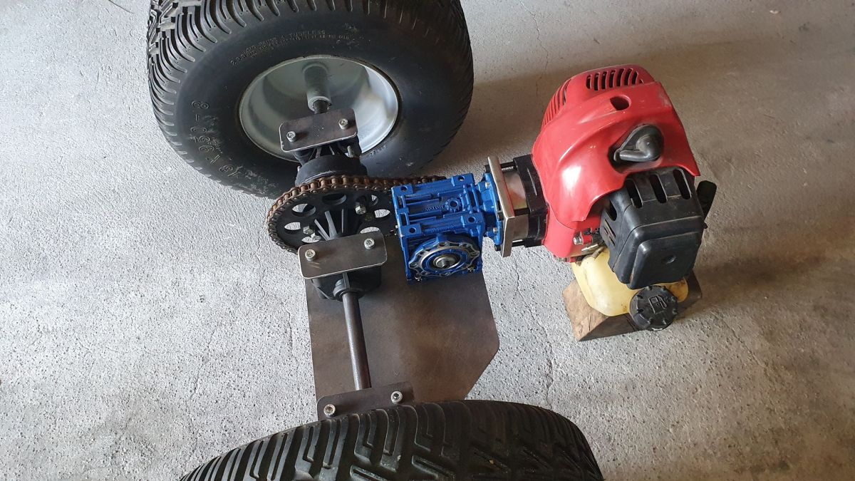

  • Good morning.
    I would like to show you my mini hauler, which is powered by an engine from a petrol scythe.
    Red mini dumper with four thick tires and a black control handle
    The 3hp internal combustion engine comes from a NAC scythe and is connected to a 60:1 worm gearbox.
    The gearbox drives the differential from the mower tractor, on which the 18-8.00x8 wheels are mounted.
    Brushcutter engine connected to a blue gearbox and chain drive mechanism
    Brushcutter engine connected to gear reducer and axle with large off-road wheels
    The kipper is manual and the change of direction is achieved by turning the front axle 180 degrees.

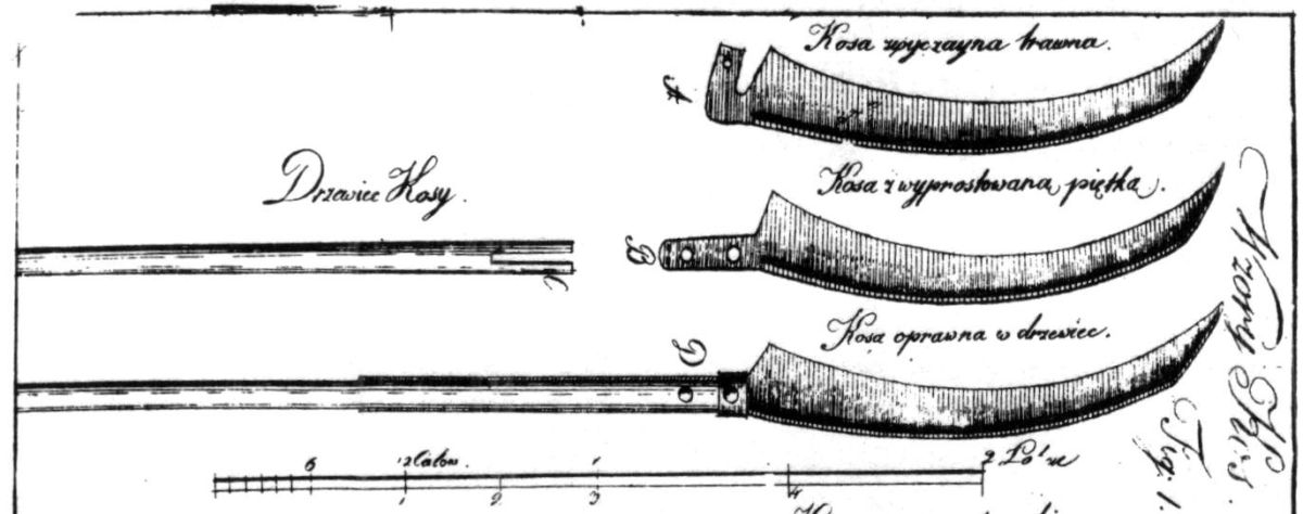

    LEDówki wrote:
    The scythes were not re-built, but rearranged. After combat action they could continue to be used by mowers to cut grass or grain
    You've probably never seen a real scythe - it can't be done as you say.
    Three types of war scythe blades and a schematic of the shaft with handwritten Polish labels
    Per Wikipedia :
    Typical treatments resulting in the adaptation of a utility scythe to function as a fighting weapon:
    forging the blade of the economy scythe by a 90-degree angle (upright) - so that the ribs form a single line with the long spar on which they are mounted;
    strengthening the handle that attaches the ribs to the spar (e.g. additional bushing, additional rivets);
    reinforcement of the spar of the scythe, especially in the area of the attachment of the ribs to the spar (in order to protect it from cuts by incisive weapons);

    I always thought a battery-powered mower was a no-go - after all, smaller petrol mowers stuck in taller grass. However, I have found that the power of the higher voltage electric mowers (36 volts) can cope even with a drive, although they cut a narrower strip. I thought an impact hammer was only for electricity. The assemblers when they were hanging PCs had a hammer on a battery and with an integrated hoover. These days it really pays to build battery-powered things. This hauler would also be much more convenient if it ran on electricity. Exhaust fumes aside - just changing direction is extremely easy.

    What capacity does it have? What if there is a need to push the trolley by hand? The worm gear does not get in the way?

    Then there is the gear ratio on the chain at an eye-watering 4:1 i.e. a total of about 240:1, and with this ratio a small electric motor would work well (the main problem is 2T motor noise and exhaust). The tapered roller bearings are unlikely to be secured with a seger? The frame gives the impression of being solid, but the plating is thin (a full load of stone would be unlikely to hold it).
    If the gear is going to be usable, I would change the muffler for more soundproofing and this taper roller bearing protection.

    Another error was suggested by another user, which could be a problem if the engine fails.
    acctr wrote:
    What if there is a need to manually push the truck? The worm gear does not get in the way?

    I can't find that bearing without the protection - where do you see it?
  • #26 21790539
    Staszek_Staszek
    Posts: 3900
    Help: 116
    Rate: 841
    I didn't know about this seger at the bearing and have now found out.
    I will select a different type of bearing - thank you for the information.
