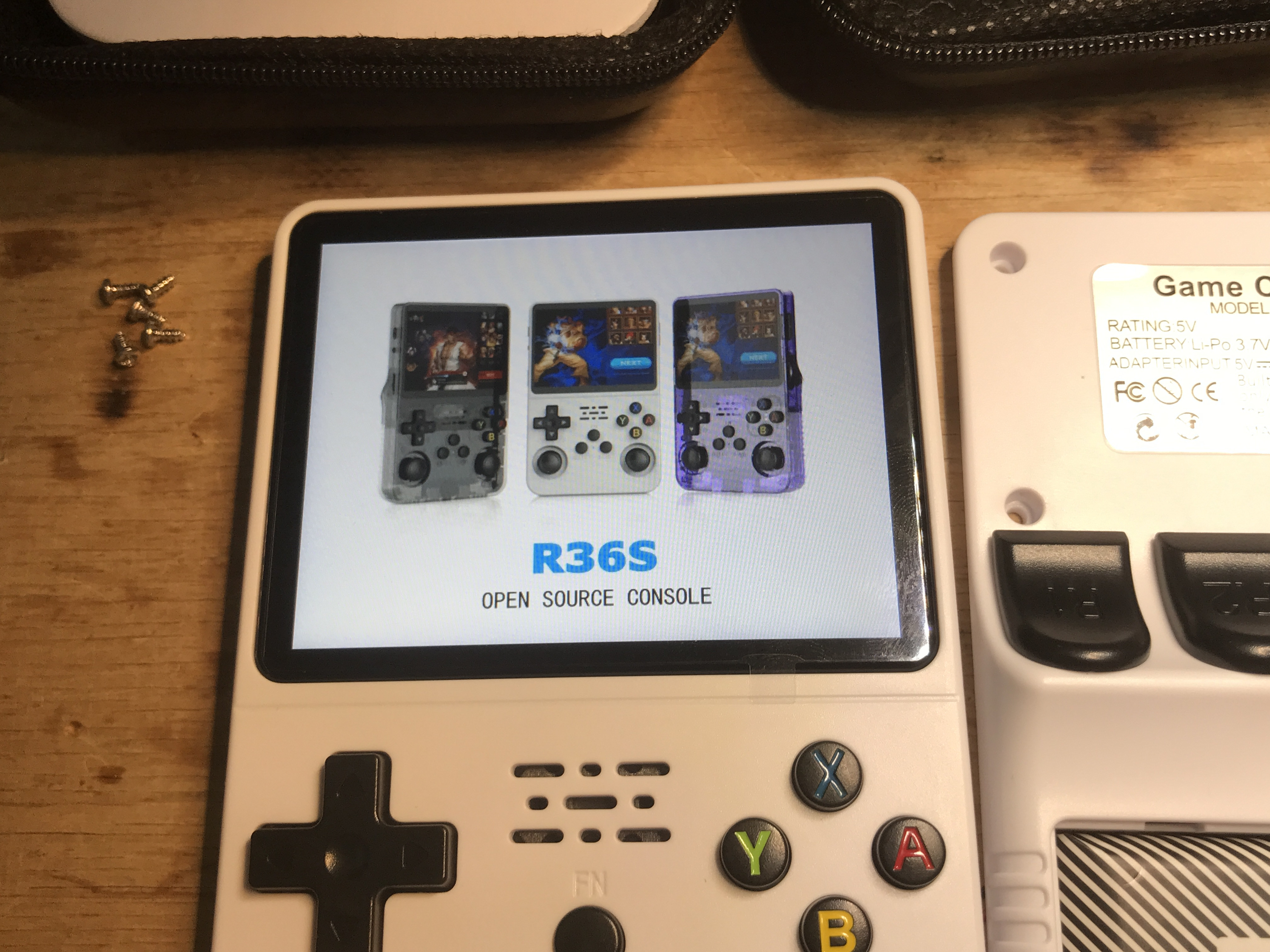

Interior of R36S
All you need to do is unscrew six screws. One was hidden under the QC sticker.
Opened R36S handheld console with visible battery and circuit board on wooden surface
The construction of the device is based on a single, at least two-layer PCB. Most components are surface mounted. At the heart of the console is a Rockchip RK3326 processor along with H9TQ32A4GTMC-URKUM memory.
Interestingly, the H9TQ32A4GTMC is a combination of eMMC memory (4 GB Flash) and LPDDR3 RAM (1 GB).

The Rockchip RK3326 is a quad-core ARM Cortex-A35 processor clocked at up to 1.5 GHz and features Mali-G31 graphics with support for OpenGL ES 3.2, Vulkan 1.0 and OpenCL 2.0, a dedicated 2D engine and hardware video decoding up to 1080p@60 fps (H.265, H.264, VC-1, MPEG-1/2/4, VP8) and H.264/VP8 encoding, supporting RGB/LVDS/MIPI-DSI displays up to 1920×1080, MIPI-CSI/DVP interfaces with embedded 8 MP ISP and a rich I/O set including I2S/TDM/PDM, SDIO 3.0, USB 2.0 OTG, I2C, UART and SPI.
Close-up of PCB with Rockchip RK3326 and RK817 chips in a handheld game console
All powered by inverters based on the same manufacturer's RK817 chip:
Application diagram for RK817 power management IC with connections to MCU and peripherals
The RK817 controls four synchronous step-down inverters and also handles battery charging. In addition, it contains nine LDO stabilisers and a built-in RTC (real-time clock). However, it should be noted here that I also see a 4057A charge controller on the PCB, at the battery connector:
ME4057 datasheet for 1A linear charger IC for single-cell lithium-ion batteries
In the centre of the board is a single, small speaker. For older games it is rather sufficient:
Close-up of R36S PCB with labeled LEFT and RIGHT connectors and SGM 4878QD component
There's also a 4:1 multiplexer on the board, which I suspect is used to operate the pads.
Out of curiosity I checked what was heating up inside. The main processor is the strongest:
Thermal image of R36S console interior showing hot spots at 50.1°C and 31.0°C
Second to heat up is the inverter controller:
Thermal image of console PCB with processor temperature marked at 43.8°C

Did you know that the console presented is a fake? The original version of the console has two memory bones and the current version of the board is V22 and it has an extra place to solder in the WiFi... [Read more]
p.kaczmarek2 27 Dec 2025 12:24
That's interesting, according to what you wrote, I got the EmuELEC version? https://obrazki.elektroda.pl/8988133000_1766834576_bigthumb.jpg https://obrazki.elektroda.pl/5103265100_1766834616_bigthumb.jpg... [Read more]
gulson 27 Dec 2025 12:32
And where do you buy the originals to be sure? [Read more]
@GUTEK@ 27 Dec 2025 13:01
The original is best bought on AliExpress from the Boyhom shop. When there are some promotions on ali you go get the console for that 70-80PLN. You can find a list of other shops that have originals at:... [Read more]
p.kaczmarek2 27 Dec 2025 13:11
Thanks for the substantive addendum. So that means that the world of these modern consoles is also intricate and complicated. Weaker processor and RAM... hm, I wonder if, in some cases after all, it's... [Read more]
@GUTEK@ 27 Dec 2025 13:46
Now there's a fashion for such portable consoles and retro in general, so they've made loads of models of this. With these clones is the biggest problem, that if you hit on a different proc, then you... [Read more]
