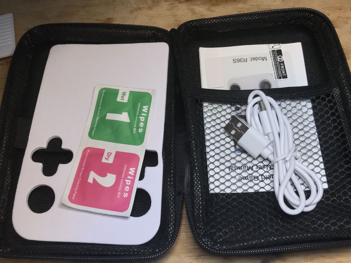

    - console with battery
    - memory cards: 32 GB and 128 GB
    - uSB cable (for charging)
    - case
    - manual
    - cleaning wipes for the screen and a protective film for the screen
    R36S console accessories in a case: USB cable, wipes, manual, and screen protector

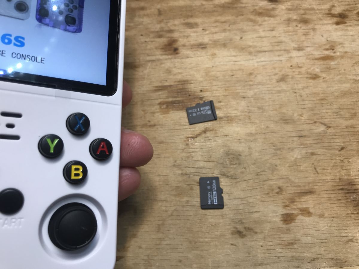

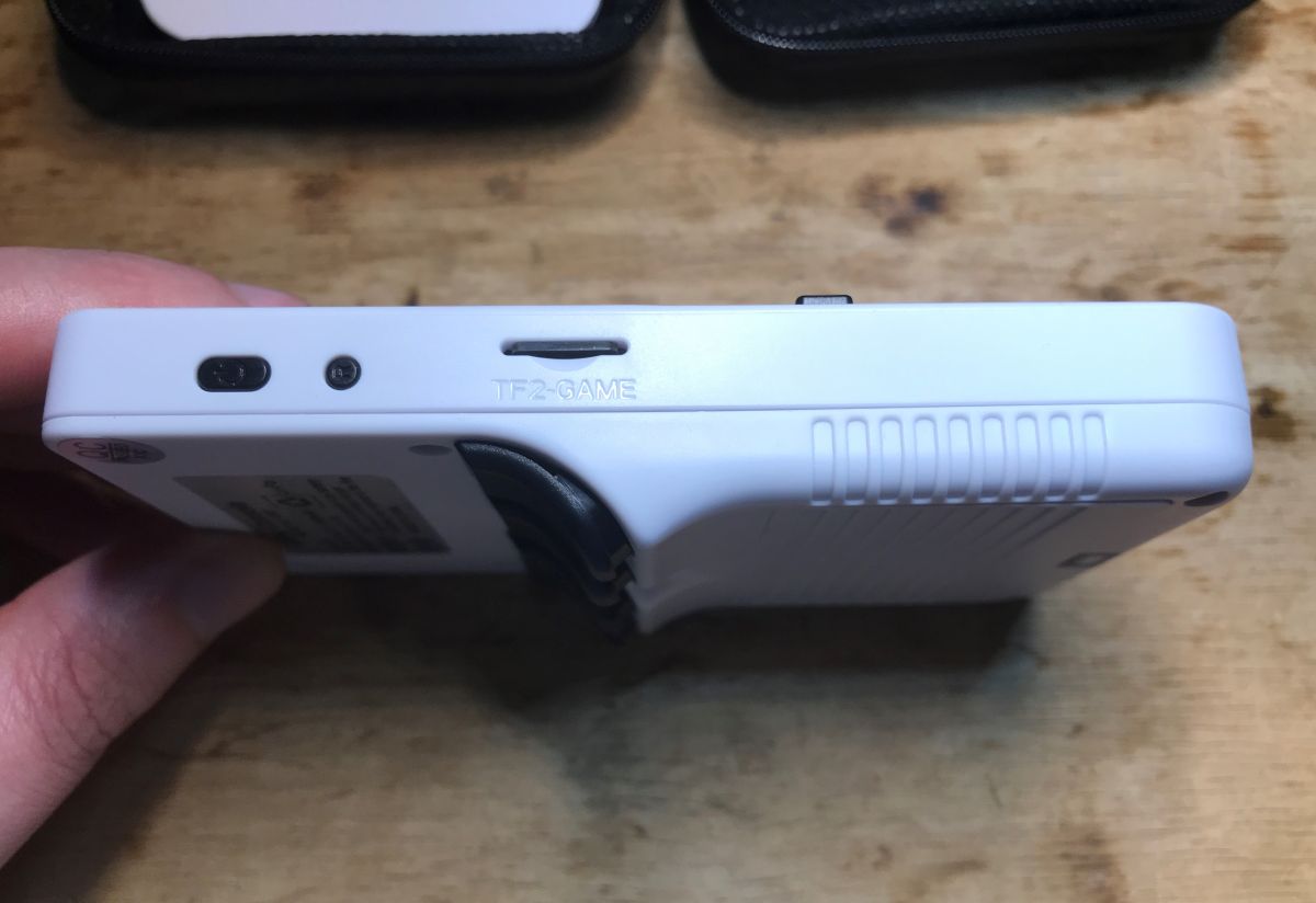

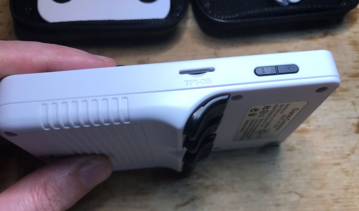

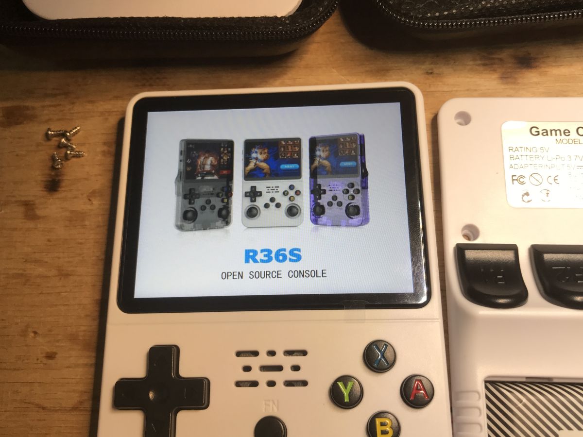

    Indeed, the console has two microSD card slots. One for the system, the other for games.
    Back of R36S console showing 3500 mAh battery and model label White side of R36S console with TF2-GAME card slot and small buttons visible White side of R36S console with TF1-OS slot and volume buttons
    Brief instructions:
    R36S handheld manual showing button diagrams and technical specification table Open retro console manual showing game folders list and key shortcut descriptions

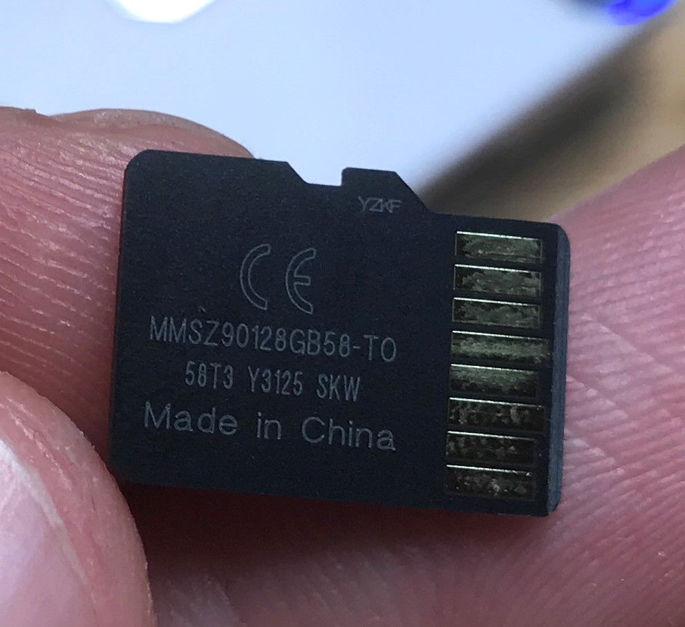

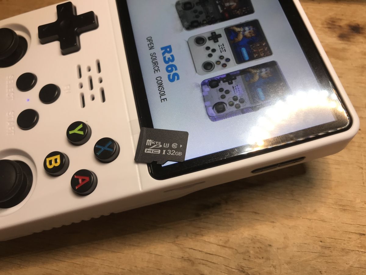

    I do not associate the brand of microSD card with the centre:
    White R36S console with 32 GB microSD card inserted and game menu on screen Close-up of a black microSD card with technical markings held between fingers Left side of R36S handheld console with buttons and two microSD cards on wooden surface

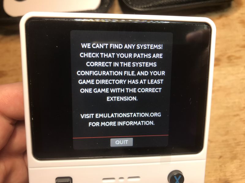

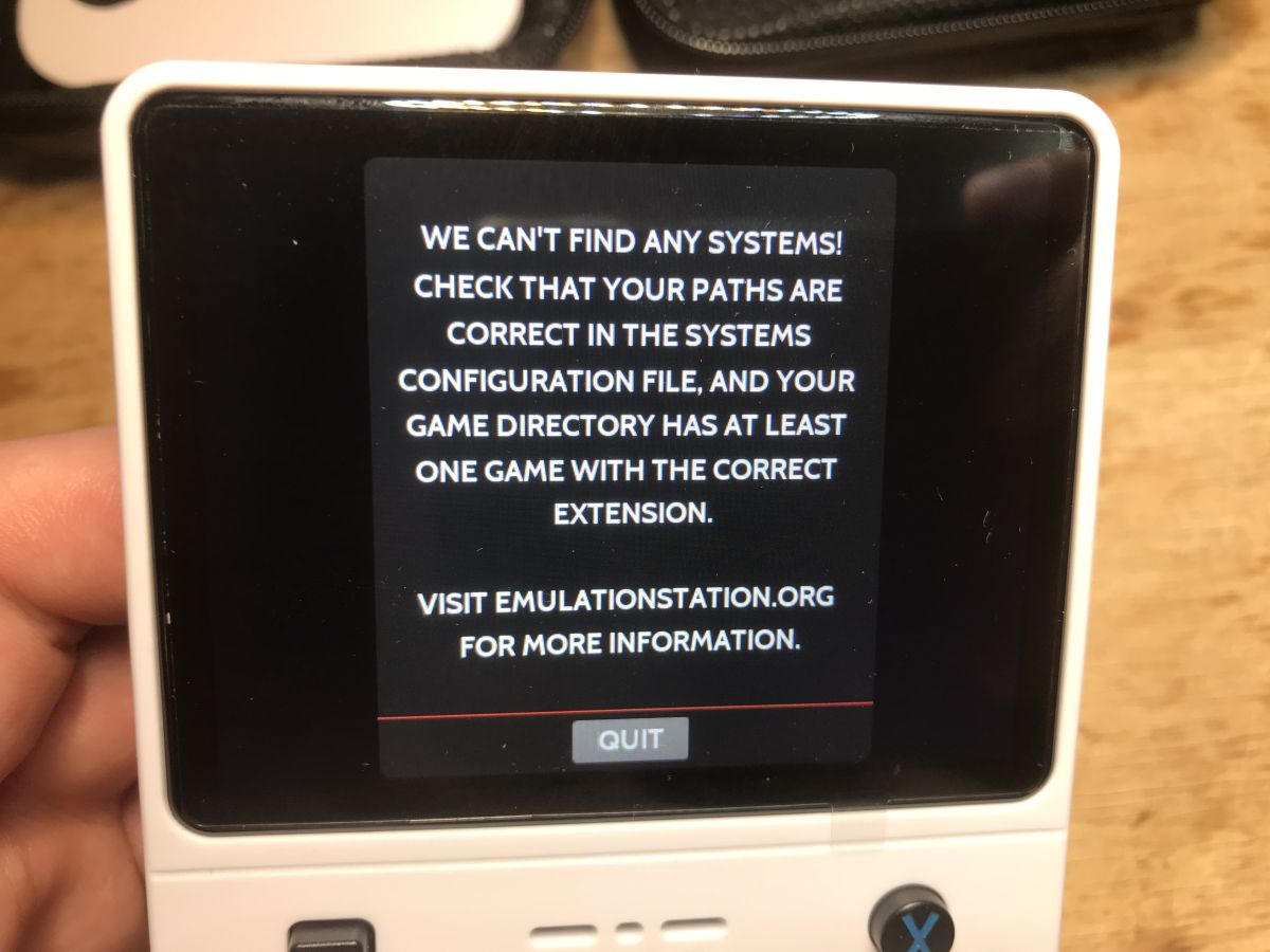

    When we boot the console without SD cards, the message refers us to emulationstation.org.
    Retro handheld screen with system not found message referring to emulationstation.org

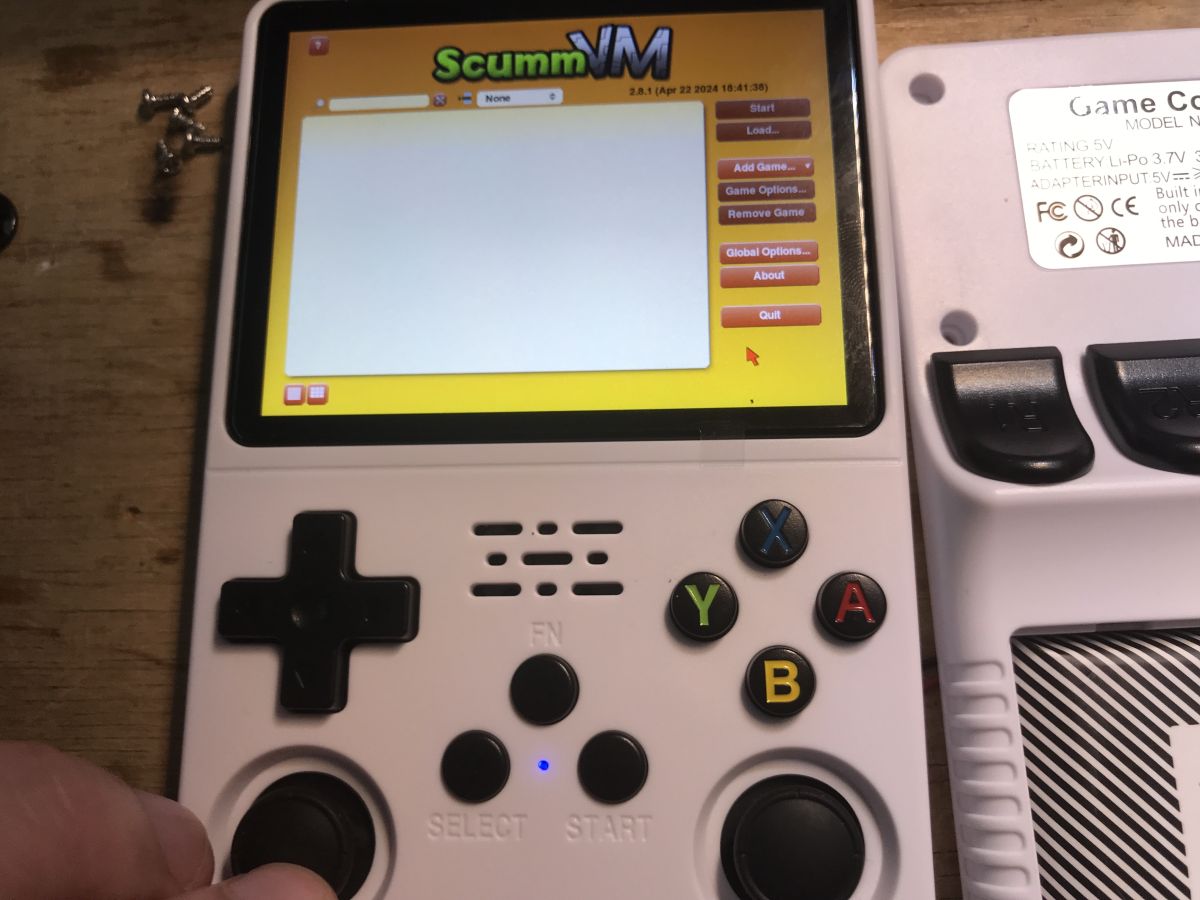

    The console also offers the ScummVM runtime environment. ScummVM is a program that does not emulate the original hardware, but interprets the games' scripting languages (SCUMM and others) to describe the game world, characters, dialogue and gameplay mechanics. This allows games to run on modern operating systems, retaining the original logic and graphics, while eliminating the bugs and limitations of the original software.
    Portable R36S console running ScummVM interface on screen

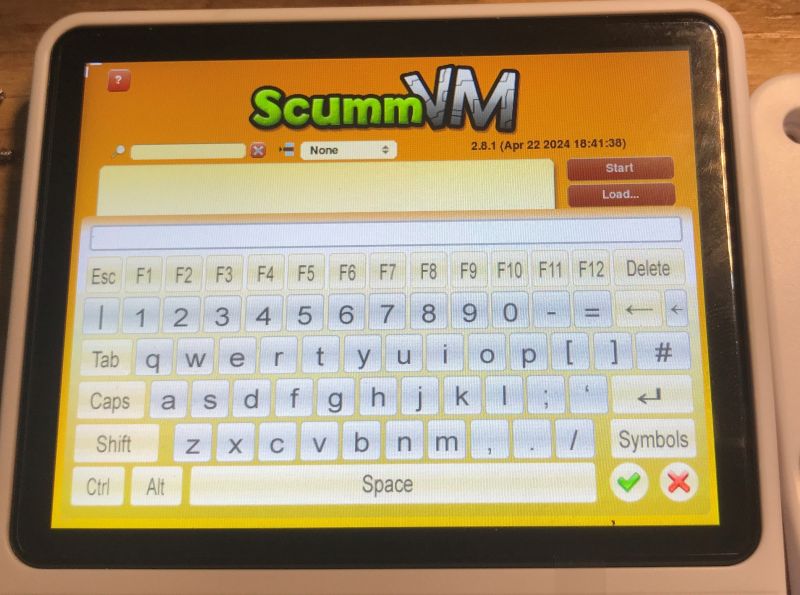

    Text can be entered if required, although it is not very convenient as you have to navigate with the pads. It is not a touchscreen!
    R36S console screen showing ScummVM with on-screen QWERTY keyboard
    You can navigate the cursor in a similar way:
    Handheld retro console with ScummVM interface open on screen, placed on wooden surface

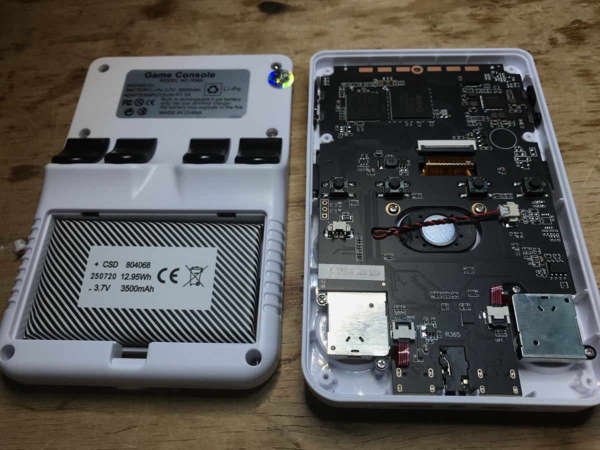

    Interior of R36S
    All you need to do is unscrew six screws. One was hidden under the QC sticker.
    Opened R36S handheld console with visible battery and circuit board on wooden surface

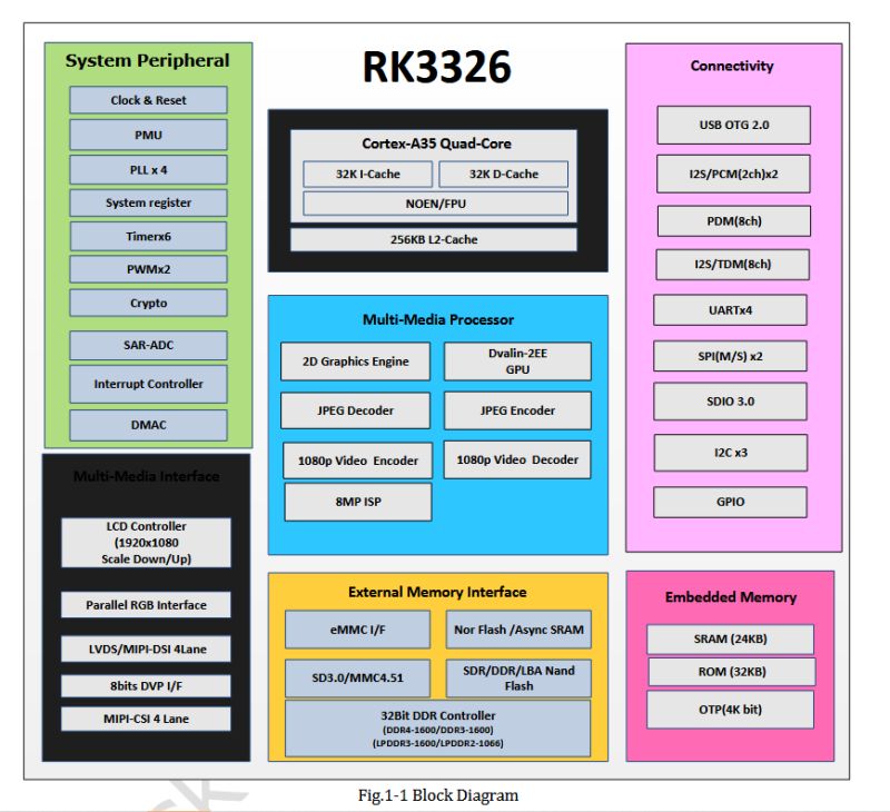

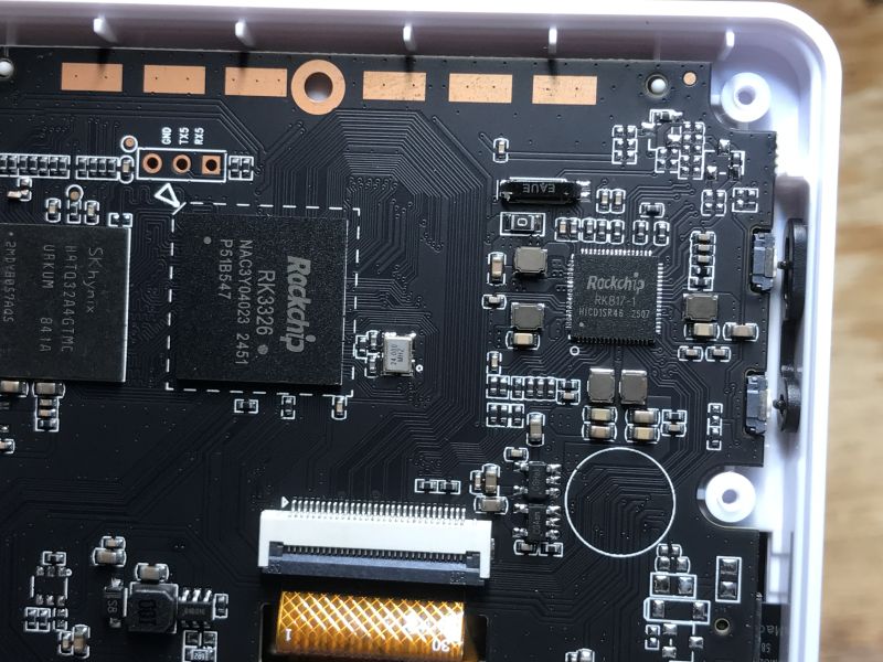

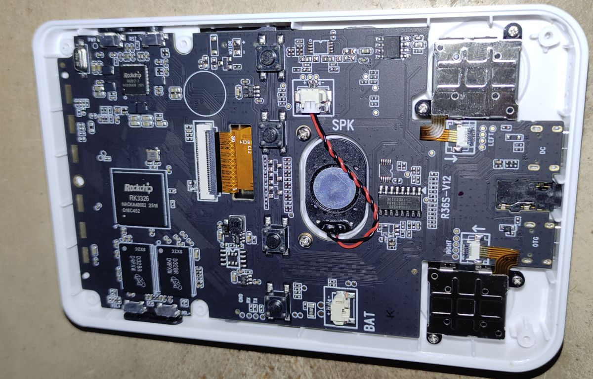

    The construction of the device is based on a single, at least two-layer PCB. Most components are surface mounted. At the heart of the console is a Rockchip RK3326 processor along with H9TQ32A4GTMC-URKUM memory.
    Interestingly, the H9TQ32A4GTMC is a combination of eMMC memory (4 GB Flash) and LPDDR3 RAM (1 GB).
    Block diagram of RK3326 processor showing cores, memory interfaces, and multimedia units.
    The Rockchip RK3326 is a quad-core ARM Cortex-A35 processor clocked at up to 1.5 GHz and features Mali-G31 graphics with support for OpenGL ES 3.2, Vulkan 1.0 and OpenCL 2.0, a dedicated 2D engine and hardware video decoding up to 1080p@60 fps (H.265, H.264, VC-1, MPEG-1/2/4, VP8) and H.264/VP8 encoding, supporting RGB/LVDS/MIPI-DSI displays up to 1920×1080, MIPI-CSI/DVP interfaces with embedded 8 MP ISP and a rich I/O set including I2S/TDM/PDM, SDIO 3.0, USB 2.0 OTG, I2C, UART and SPI.
    Close-up of PCB with Rockchip RK3326 and RK817 chips in a handheld game console

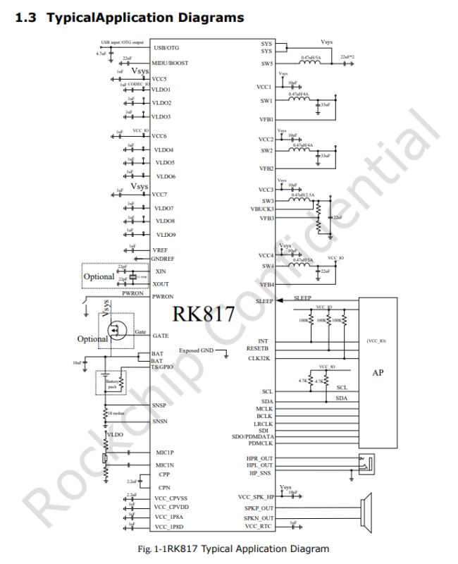

    All powered by inverters based on the same manufacturer's RK817 chip:
    Application diagram for RK817 power management IC with connections to MCU and peripherals

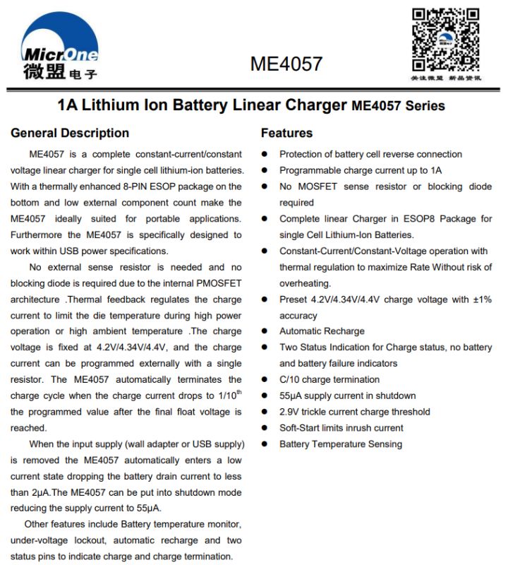

    The RK817 controls four synchronous step-down inverters and also handles battery charging. In addition, it contains nine LDO stabilisers and a built-in RTC (real-time clock). However, it should be noted here that I also see a 4057A charge controller on the PCB, at the battery connector:
    ME4057 datasheet for 1A linear charger IC for single-cell lithium-ion batteries

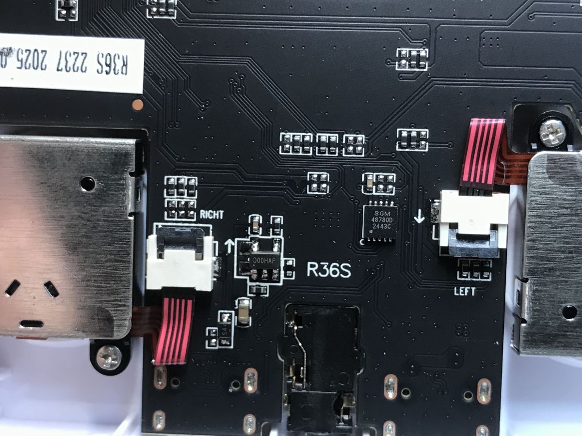

    In the centre of the board is a single, small speaker. For older games it is rather sufficient:
    Close-up of R36S PCB with labeled LEFT and RIGHT connectors and SGM 4878QD component
    There's also a 4:1 multiplexer on the board, which I suspect is used to operate the pads.

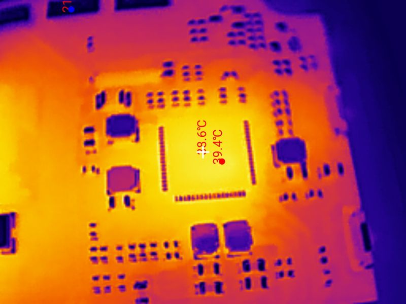

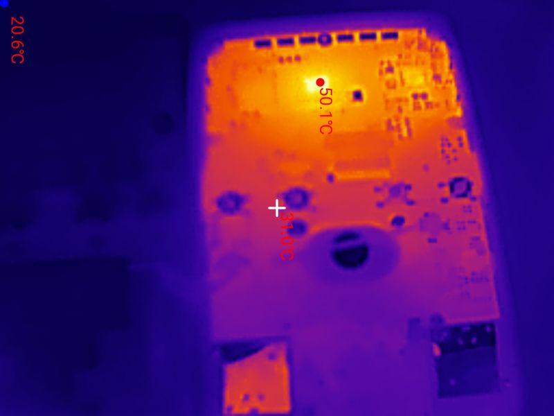

    Out of curiosity I checked what was heating up inside. The main processor is the strongest:
    Thermal image of R36S console interior showing hot spots at 50.1°C and 31.0°C
    Second to heat up is the inverter controller:
    Thermal image of console PCB with processor temperature marked at 43.8°C

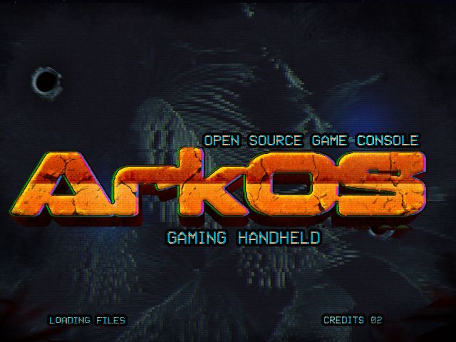

    The console is based on ArkOS 2.0 as of 08232024, i.e. August 2024. If necessary, you can upgrade to the latest version, i.e. 11072025 at the time of writing this topic.
    ArkOS is an operating system developed primarily for retro consoles based on Rockchip processors. The name "ArkOS" comes from "Another Rockchip Operating System" - meaning "another operating system for Rockchip".
    Promotional graphic of Rockchip RK3326 chip with Octa-Core 64-bit label
    The system was started as a modification of The Retro Arena project with the main goal of facilitating the ROMs folder on the NTFS partition - this made managing games from within Windows very simple (just insert the SD card into the reader and copy the files). Over time, the project evolved and diverged significantly from the original, leading to a name change to ArkOS as proposed by the community.
    Startup screen of retro handheld console with ArkOS logo and Open Source Game Console text
    The system is based on Ubuntu 19.10 and includes both 64-bit and 32-bit user spaces, allowing for maximum wide support for emulators and game ports of various versions. ArkOS offers emulation of more than 90 retro platforms, from classic consoles to older PCs and handhelds.

    - i am puzzled by the quality of these microSD cards, the ArkOS authors themselves suggest using good brands such as Sandisk, Samsung, or PNY

    I've come across the opinion that the first thing to do is copy the contents of the card to a branded one. These cards can give errors even in a freshly unboxed console.
  • Recommend using branded SD cards from trusted sellers
    #3 21790292
    Posts: 14791
    Rate: 12937
    Shortly after the launch at my place, it didn't fall apart, but it basically agrees, after all this is included in the original text. This information comes directly from the materials arkos , this excerpt:
    It is recommended that you use a good name brand SD card such as Sandisk, Samsung, or PNY. For a dependable list of good name brand cards, please check this link.
    Make sure to buy your SD cards from a trusted retail source. In the United States of America, Wal-Mart, Best Buy, and Target are good sources. Online, SD cards shipped and sold by Amazon are best. Example of such is in this link
    Equally, anyone who has experimented with single board computers using just such cards probably has similar experiences too.

    The manufacturer must have saved on something with good cards it would probably cost PLN150-180. You need a decent card to read a lot of small files.
  • #5 21790304
    Posts: 14791
    Rate: 12937
    It's also worth backing up these cards if you need to. Dumping to a computer is not a problem, the files are not large, and it will save you the trouble of doing this if you need to.

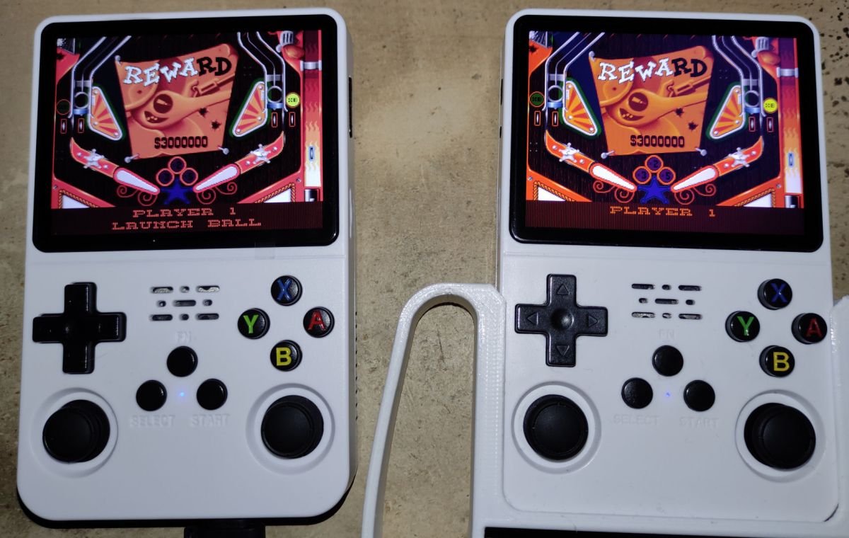

    #9 21790966
    @GUTEK@
    Posts: 1567
    Help: 163
    Rate: 421

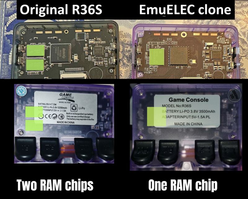

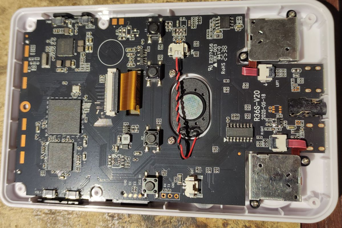

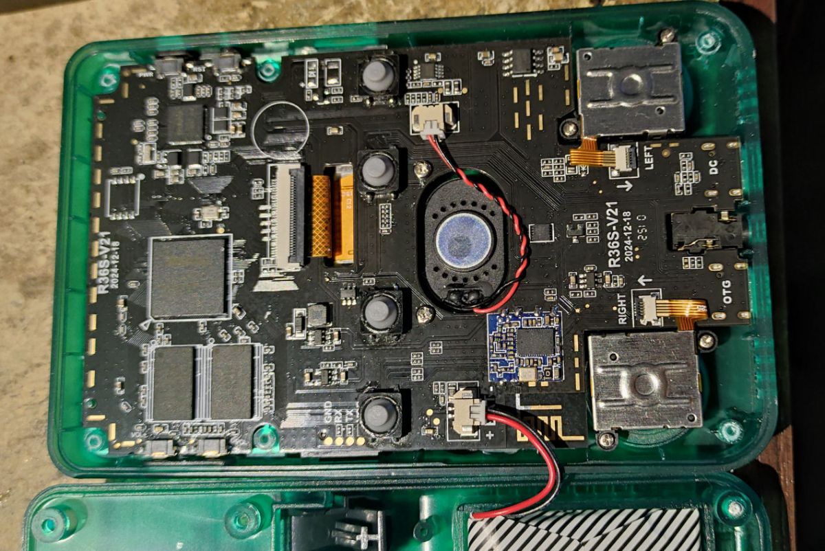

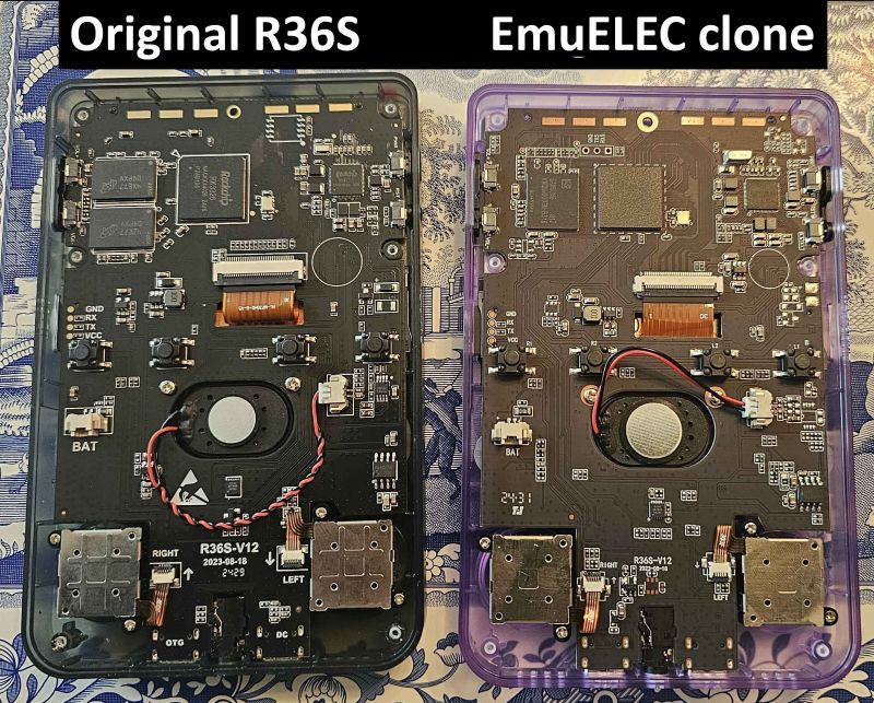

    Did you know that the console presented is a fake?
    The original version of the console has two memory bones and the current version of the board is V22 and it has an extra place to solder in the WiFi module.
    The plastic workmanship is a little better and the buttons are quieter and softer. In addition, it then runs the new ArkOS without having to modify the boot files, with the one on the topic best using the version from the arkos4clone repository on github.
    More about these consoles: https://handhelds.wiki/R36S_Clones
    There are also many modifications of this console: https://handhelds.wiki/R36S_Hardware_Modifications

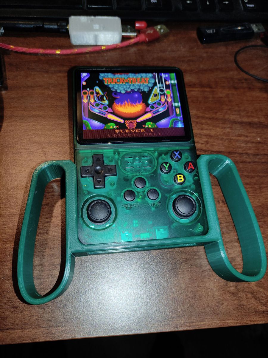

    I, for example, added a WiFi module, although mainly its usefulness comes down to downloading game covers and themes.
    I also replaced the back buttons with soft silicone ones like here, it's great for playing pinball: https://www.reddit.com/media?url=https%3A%2F%...6s%3Deb44a221816516c739992af9a394d99c672b9ab3
    As for the price of the console itself, these clones can be had for as little as 50zl, which is a ridiculous price, while the original version can be had for around 80zl - of course I'm talking about prices in Chinese shops.
    I would also like to add:
    - the console supports Portmaster, this is software for running some PC games, for example Max Payne, GTA3, GTAVC and many others. More here: https://portmaster.games/games.html
    - i recommend that you print out a holder for it, I use this one: https://www.thingiverse.com/thing:6879372
    Handheld green gaming console with handle, playing pinball game on screen

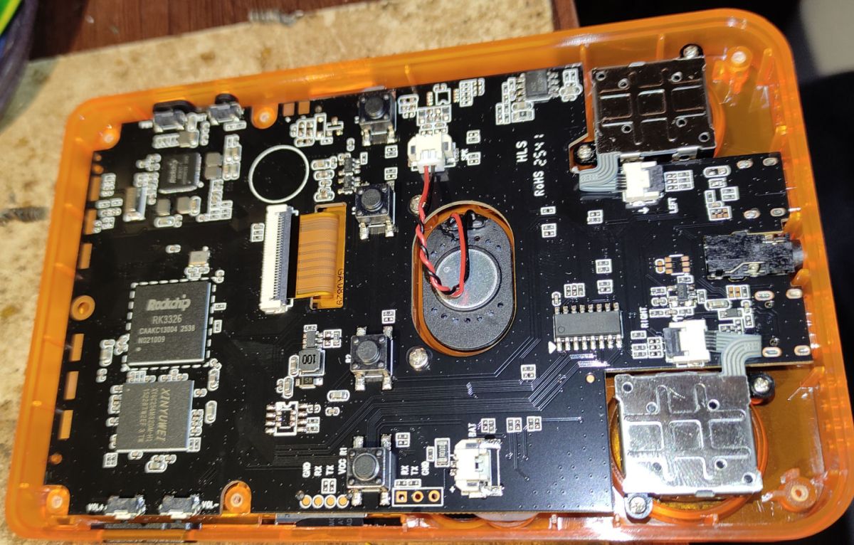

    That's interesting, according to what you wrote, I got the EmuELEC version?
    Comparison of R36S console internals: original vs. EmuELEC clone, no visible WiFi module
    Comparison of internal boards and labels of original R36S and EmuELEC clone consoles
    Can you present how and where you added which WiFi module? Is it more cost effective to add it yourself or buy a pre-made version?

    The original is best bought on AliExpress from the Boyhom shop. When there are some promotions on ali you go get the console for that 70-80PLN. You can find a list of other shops that have originals at: https://handhelds.wiki/R36S_Clones
    And in Poland, well, it's probably to look for ads from people who sell for example, I saw on fb group are proven sellers (probably even with fv). Otherwise, you can currently recognise an original by the fact that it has a green led instead of a blue one - but this is changing and soon clones will probably also have a green one.
    It's interesting, according to what you wrote, I got the EmuELEC version?.
    So yes:
    - generally from what I understand these clones described as EmuELEC were characterised by the fact that they had inferior performance - a weaker different processor, less RAM, well, and inferior performance. As a result, they did not run on ArkOS (Another Rockchip OS) but on EmuELEC or something else
    - It seems to me that the current clones, despite the differences in design and configuration, are practically always already on RK3326 and 1GB RAM (whether in 2 or 1 bone) and have some version of ArkOS, and after modifications can run the one from github
    - as for the WiFi module, I have the RTL8188ETV soldered in and I bought it on Ali of course: https://pl.aliexpress.com/item/1005008793030768.html
    - in consoles that do not have space on the board, you can connect the WiFi to the USB to the USB-C OTG port, which is there at the bottom, it works the same way
    - there is no version of the console with the module soldered on from the factory - there are other versions, such as Plus, Pro, XX - some of which, indeed .... are clones
    - in general, if you want something more complex, e.g. with WiFi, BT or video output, I would suggest the Anbernica instead of some weird variants of the R36S, for which you will not be able to find a software later on
    My console currently looks like this, with the WiFi module added and the buttons changed to silicone:
    R36S-V21 game console PCB with visible speaker and added WiFi module
    A few of these consoles I bought, because at work they wanted as they saw, and most took their own cheapest what were with some coupon at about 50zł. And I'll say that I ended up with the widest variety, but all in accordance with the specifications, ie ArkOS, RK3326 and 1GB RAM. Once I even found an original one, only with an older version of the board. I have a few pictures of what came across:
    Mainboard of handheld console with Rockchip RK3326 chip and speaker visible
    Interior of R36S handheld console showing the exposed motherboard and electronic components
    Inside of handheld console with Rockchip RK3326 and soldered speaker visible.
    Interestingly once it hit with an inferior display, paler colours - mainly faint yellow. I tweaked it a bit with the gamma configuration, but the difference is there:
    Two white handheld consoles showing differences in display quality
    I also throw in an interesting comparison, someone has really tinkered with probably all the currently available portable consoles: https://docs.google.com/spreadsheets/d/1irg60...QeyusEUzTNQzhoTYTU/edit?pli=1&gid=0#gid=0
  • Cheaper clone may suit low-demand retro games

    Thanks for the substantive addendum. So that means that the world of these modern consoles is also intricate and complicated.
    Weaker processor and RAM... hm, I wonder if, in some cases after all, it's not the case that it's sometimes worth buying a cheaper clone, as long as the price is indeed more attractive than the more powerful version? Personally, I prefer to aim for less demanding games, e.g. from the NES or older games, from my childhood I remember classics such as Super Mario Bros, Castle Excellent, etc. Once an older friend showed me a console where you could read games from cassettes, but I don't even remember what type it was, as a kid you don't pay attention to that. I know there was some version of Dizzy.

    Now there's a fashion for such portable consoles and retro in general, so they've made loads of models of this.
    With these clones is the biggest problem, that if you hit on a different proc, then you will not find anything to it. And yet this ArkOS is evolving and emulator updates are improving performance. A few days ago I came across information about the release of a test version of ArkOS based on the new Debian ("original" ArkOs is on Ubuntu 19.09), supposedly a lot of performance improvements: https://github.com/christianhaitian/dArkOS/wiki
    I'll also mention, because there was no information about it here and not much about it on the internet either, but on this console you can also run games from Amiga, Atari, Commodore or MS-DOS . The only thing is that most of these games were played on keyboards, so you may need to map the buttons to the game in the emulator settings (accessed via FN or SELECT+X depending on the ArkOS version, while in the game).

    The console supports USB-OTG, so you can plug in a keyboard or mouse with a USB-C OTG adapter.
    Even a WiFi dongle (as long as it is based on RTL8188FTV and the like) at least on some versions of ArkOS and EmuElec.
    The BT module failed to work for me, possibly just a lack of drivers on the system.
    On the lower UART pins (3pin) there is access to the shell, depending on the system.
    On the upper 4pin there is some data, but nothing meaningful I got there, despite various transmission settings.
    You can also add a vibration motor, there are pads and a place to the right of the LCD strip, but it's art for art's sake, as I think 3 games know how to use it.
    I recommend replacing the SD card as much as possible, I have a Samsung Evo Plus and the difference in system and game loading speed is significant.
    I put a speaker from an old laptop and the sound is much better ;)

    At my place there is one card. Strangely, the console starts even without it, but there are only a couple of games. Strange that there isn't some kind of mouse over to the factory settings without going into the menu....
