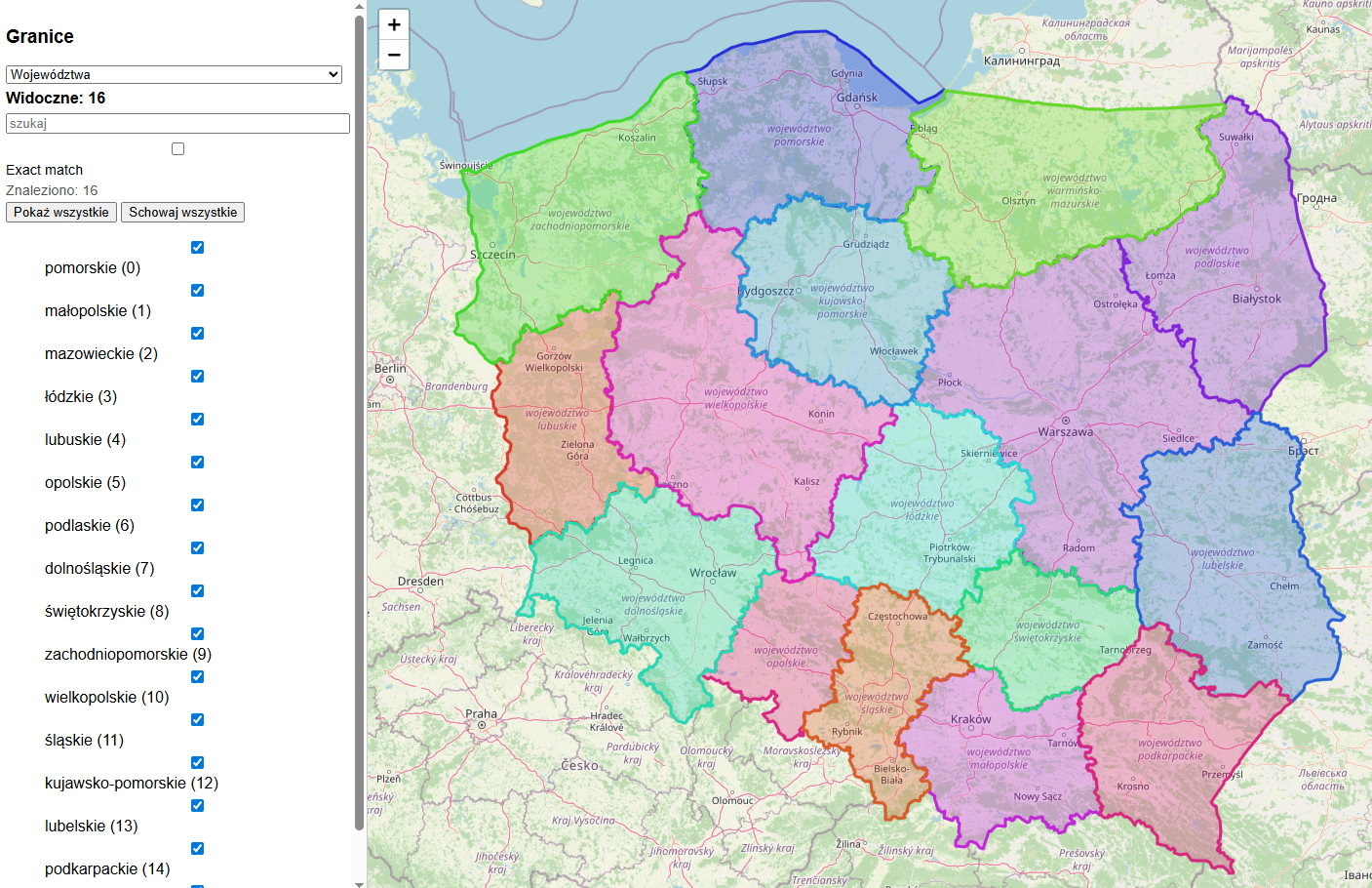

The page is a simple interface for viewing PRG boundaries in a browser. On the left we have a panel: layer selection, search engine, checkboxes and "Show all / Hide all" buttons. On the right, the Leaflet map with OSM underlay.
Just please don't confuse PRG with OSM here - OSM is just a pad/background, the borders go from PRG, from files on disk. The backend does not use OSM at all!
Clicking on an entity in the list or on the map turns its border on/off, which is drawn in a random colour. The number of visible objects updates dynamically and the map adapts the view to the polygons displayed, so up to several thousand shapes can be displayed at once.
Screenshots - Poland:
Map interface showing Poland's border with control panel on the left
Provinces (16 polygons):
Web interface showing a map of Poland with boundaries of 16 voivodeships displayed Counties (380 polygons)
