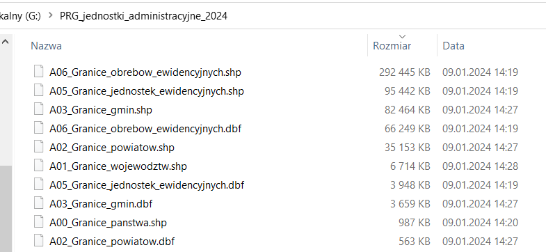

    The source data for the experiment can be downloaded on the Geoportal . There we have a choice of data for each year separately - also the historical ones, 2004 - 2024.

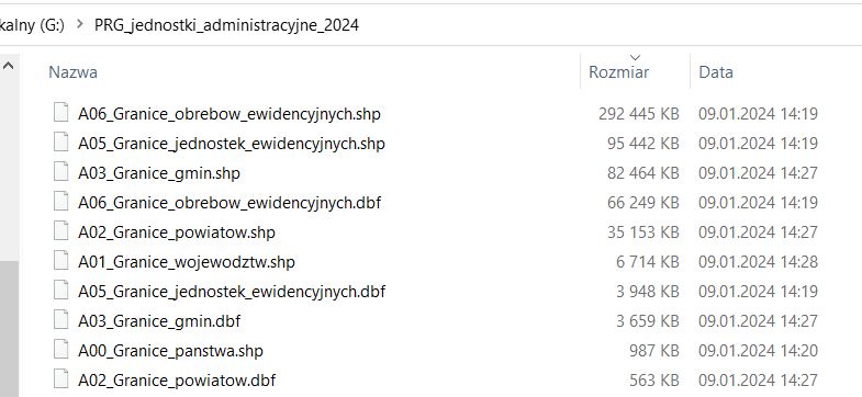

    Format of data provided

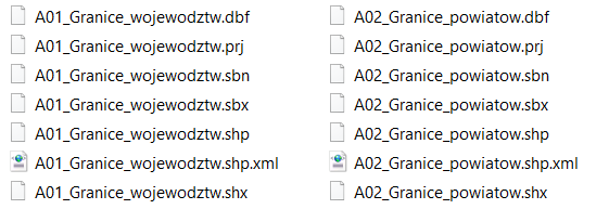

    PRG data are provided in ESRI Shapefile format, i.e. for a single layer you get a set of several files (including .shp, .dbf, .shx, .prj) that together describe the geometry and attributes of objects.
    These files contain vector data, mainly polygons of administrative boundaries.
    Shapefile packages for voivodeships and counties in Windows file explorer

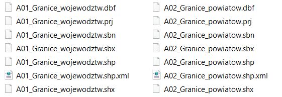

    The files are not that large at all and have the potential to run even on a single-board computer. The situation is further simplified when we dispense with the smallest administrative unit - the precincts, something that is unlikely to be of practical use to us. The precincts take up 300 MB and the next layer (units) only 100 MB. Units are, to simplify, already villages or thereabouts, although towns often consist of several units. I will show this later in the screenshots.
    Screenshot of PRG folder with 2024 Shapefile administrative boundary data

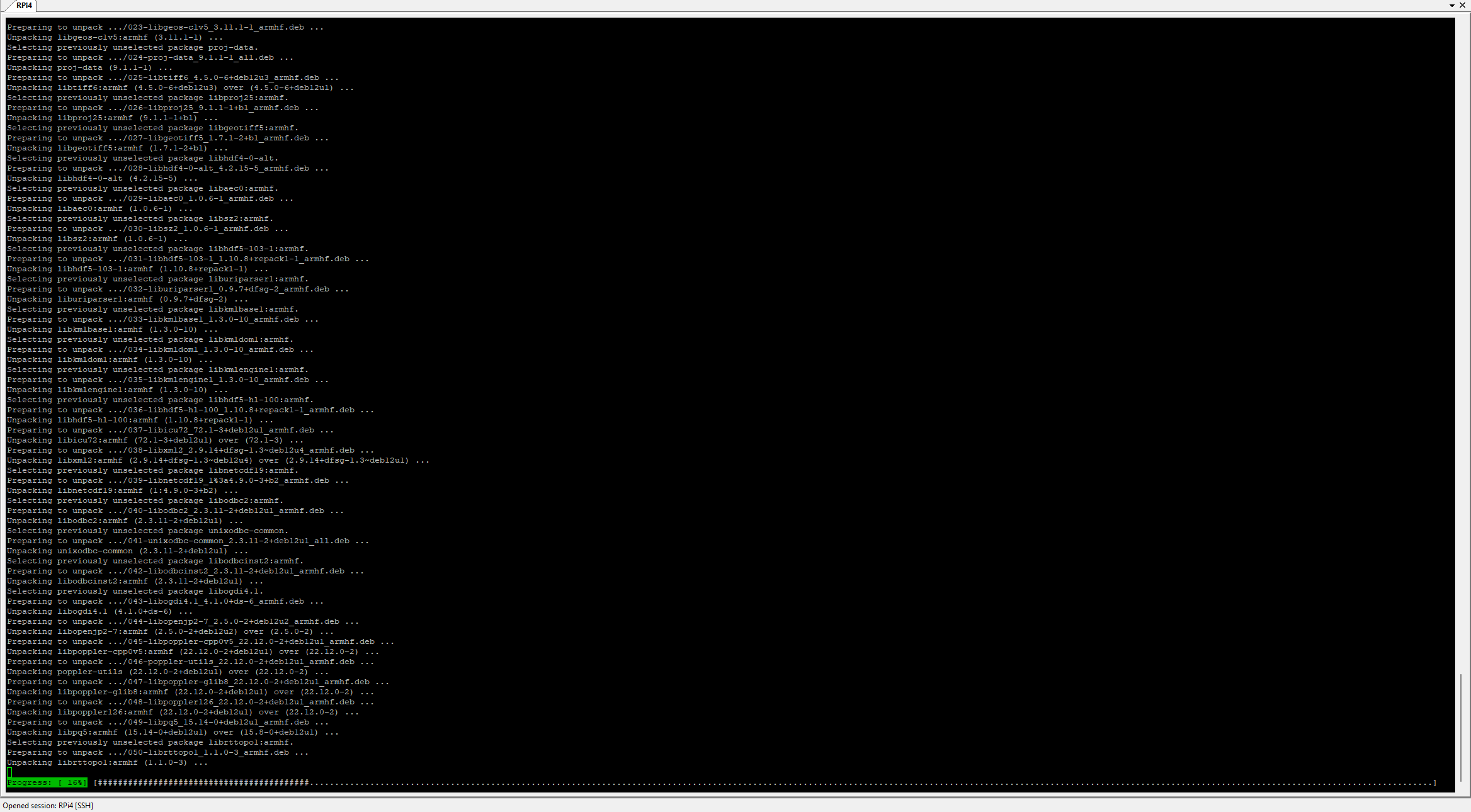

    The simplest and also most cross-platform method of handling ESRI Shapefiles is the GeoPandas library available in Python. It is an overlay for Pandas, extended to support geometry (Shapely) and GIS formats.
    GeoPandas runs easily on Linux (also ARM - Raspberry Pi), Windows and macOS. In practice, all you need is Python 3.x and a few system dependencies (gdal, proj), which on the Raspberry Pi are available in repositories.
    The command that installs the dependencies on the Raspberry Pi 4:
    apt update
    apt install -y \
      python3-pip \
      python3-dev \
      python3-geopandas \
      gdal-bin \
      libgdal-dev \
      libgeos-dev \
      libproj-dev
    Example screenshot of the installation:
    Installing GIS and Python packages on Raspberry Pi 4 in a terminal window

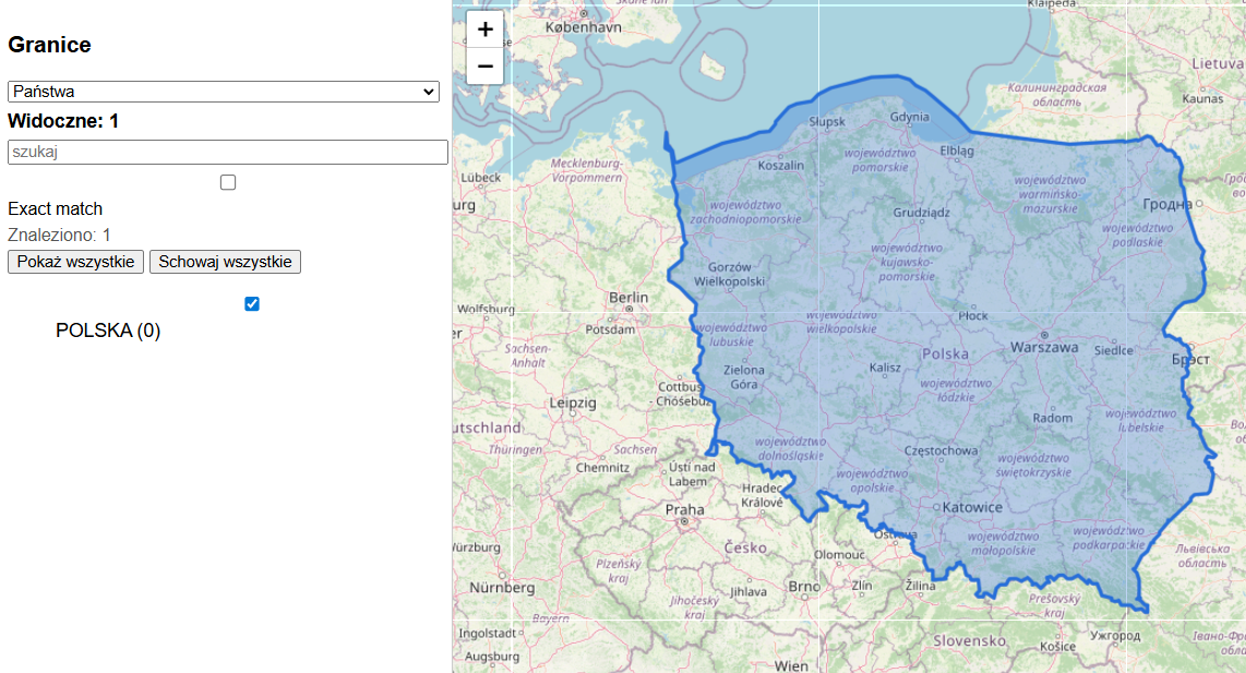

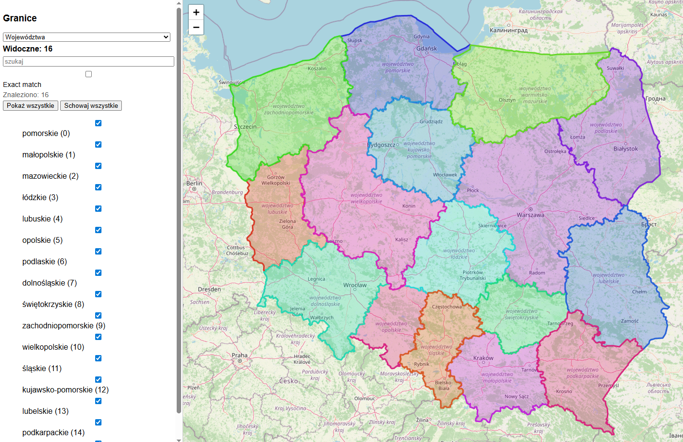

    The page is a simple interface for viewing PRG boundaries in a browser. On the left we have a panel: layer selection, search engine, checkboxes and "Show all / Hide all" buttons. On the right, the Leaflet map with OSM underlay.
    Just please don't confuse PRG with OSM here - OSM is just a pad/background, the borders go from PRG, from files on disk. The backend does not use OSM at all!
    Clicking on an entity in the list or on the map turns its border on/off, which is drawn in a random colour. The number of visible objects updates dynamically and the map adapts the view to the polygons displayed, so up to several thousand shapes can be displayed at once.
    Screenshots - Poland:
    Map interface showing Poland's border with control panel on the left

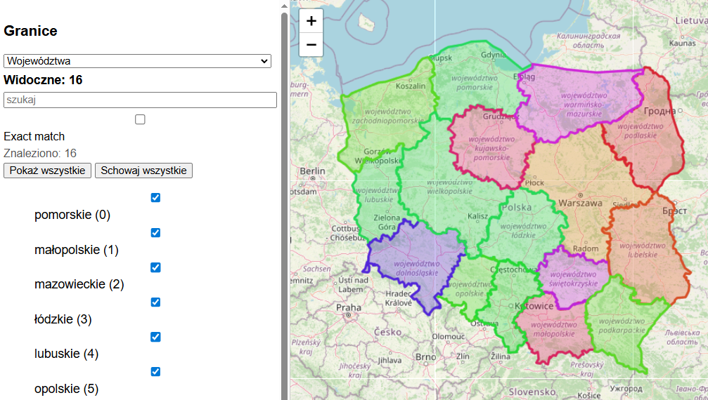

    Provinces (16 polygons):
    Web interface showing a map of Poland with boundaries of 16 voivodeships displayed Counties (380 polygons)

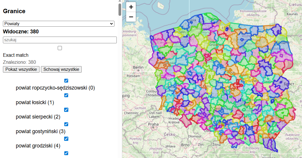

    Counties (380 polygons):
    Map interface with Poland's county borders, 380 colored polygons over OSM background

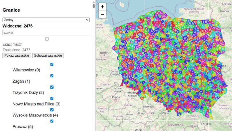

    Municipalities (2476 polygons):
    Poland map interface with 2476 municipality boundaries in random colors

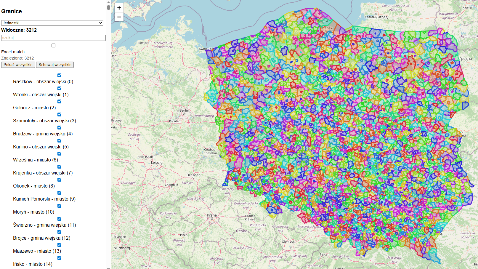

    Units (3212 polygons):
    Map of Polish cadastral units with colorful administrative boundary outlines Units

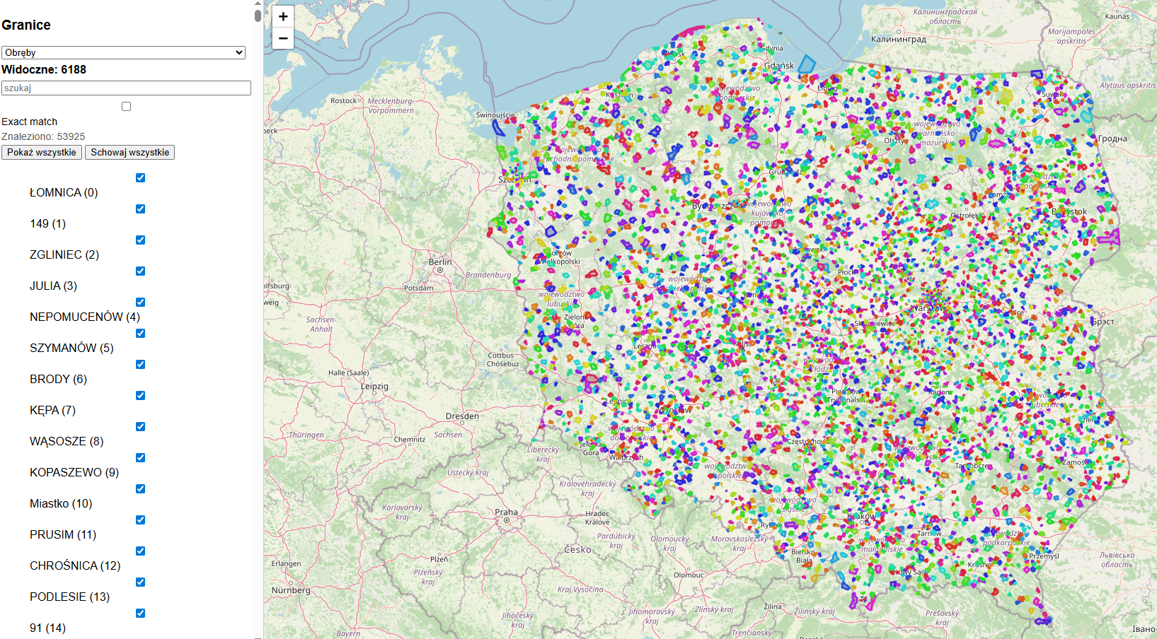

    Circles (53925 polygons):
    Map of Poland with colorful boundary polygons and a control panel on the left
    There are already too many of these to show everything....
    Browser error message indicating Out of Memory

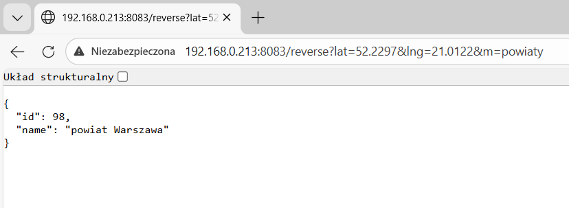

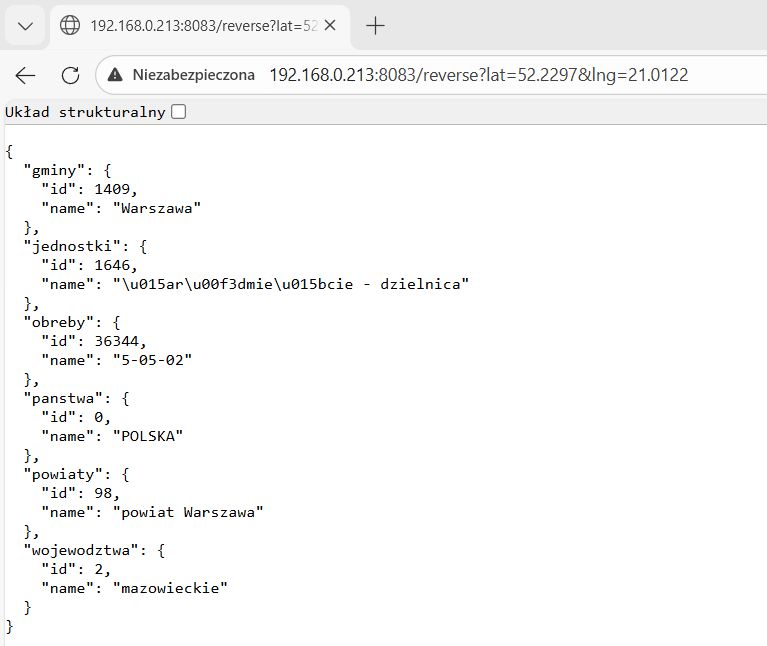

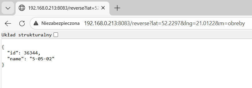

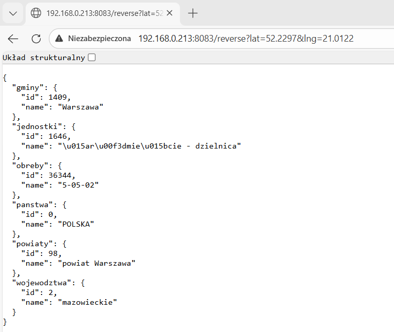

    Presentation of the API

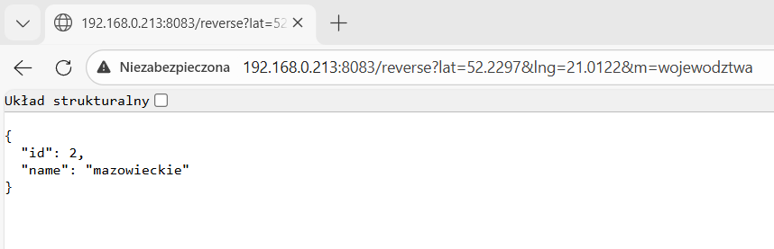

    We already have Flask to handle HTTP, and we have already loaded data from Shapefile into separate layers. Now it's easy to add support for simple queries for information about what's at a given latitude and longitude. For the sake of clarity, I have opted for a GET query format, because then the arguments can be seen in the URL itself. Optionally, you can provide the name of the layer to be queried. Example endpoint:
    Code: Python
    JSON response from local reverse geocoding for Warsaw coordinates
    Browser screenshot showing reverse geocoding API response for Mazowieckie voivodeship. Browser interface showing reverse geocoding response for Warsaw coordinates Reverse geocoding query result from local Flask server using cadastral units layer

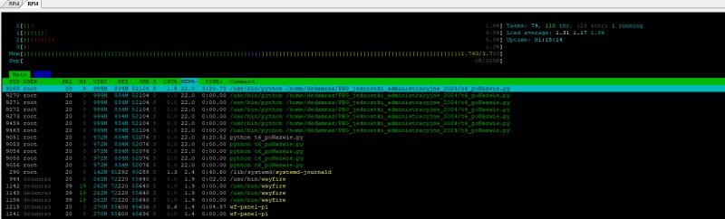

    Demonstration code
    For review and commissioning:
    Code: Python

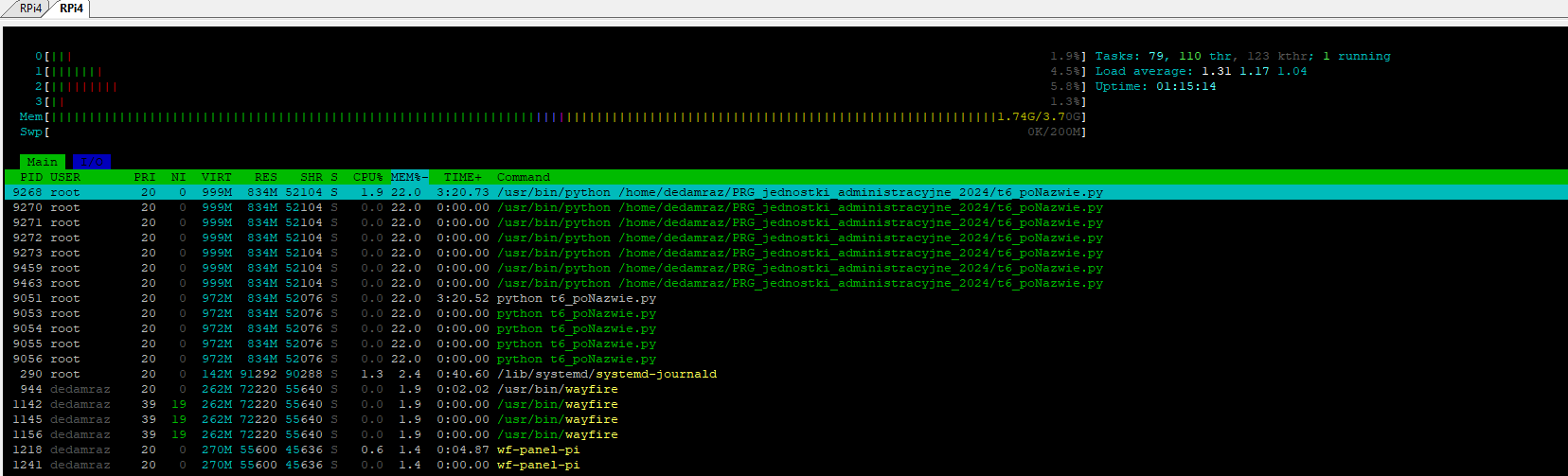

    Screenshot of the tests (but without the hoops) on the Raspberry:
    System monitor htop on Raspberry Pi with PRG Python script running
