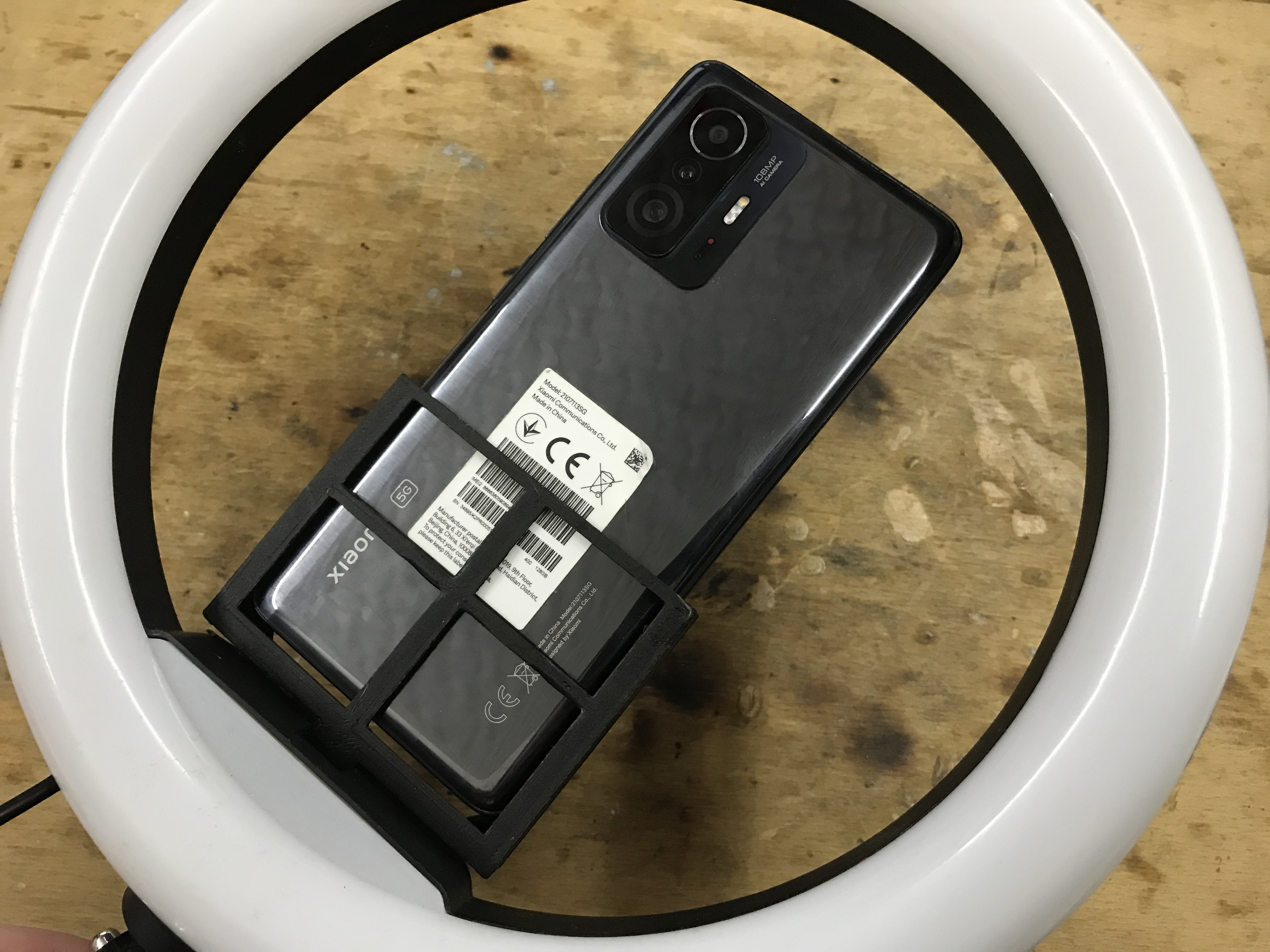

It was time for another print and fitting:
Xiaomi smartphone in a black 3D-printed holder mounted to a ring light
At this stage I have already made a "pocket" for the phone. It has to hold it at least a little on both sides, on the front it can be built in, on the back no longer - because it would obscure the screen.

The item fits, but does it hold the phone?
Black 3D-printed phone holder mounted on a ring light frame
The phone is held well, everything is fitted for the model I am using. You could do a gripper with an adjustment (based on a screw for example), but given the ease of adding a new model as I change phones I decided it wasn't worth the complication.
Phone held vertically in a 3D-printed mount attached inside a ring light
