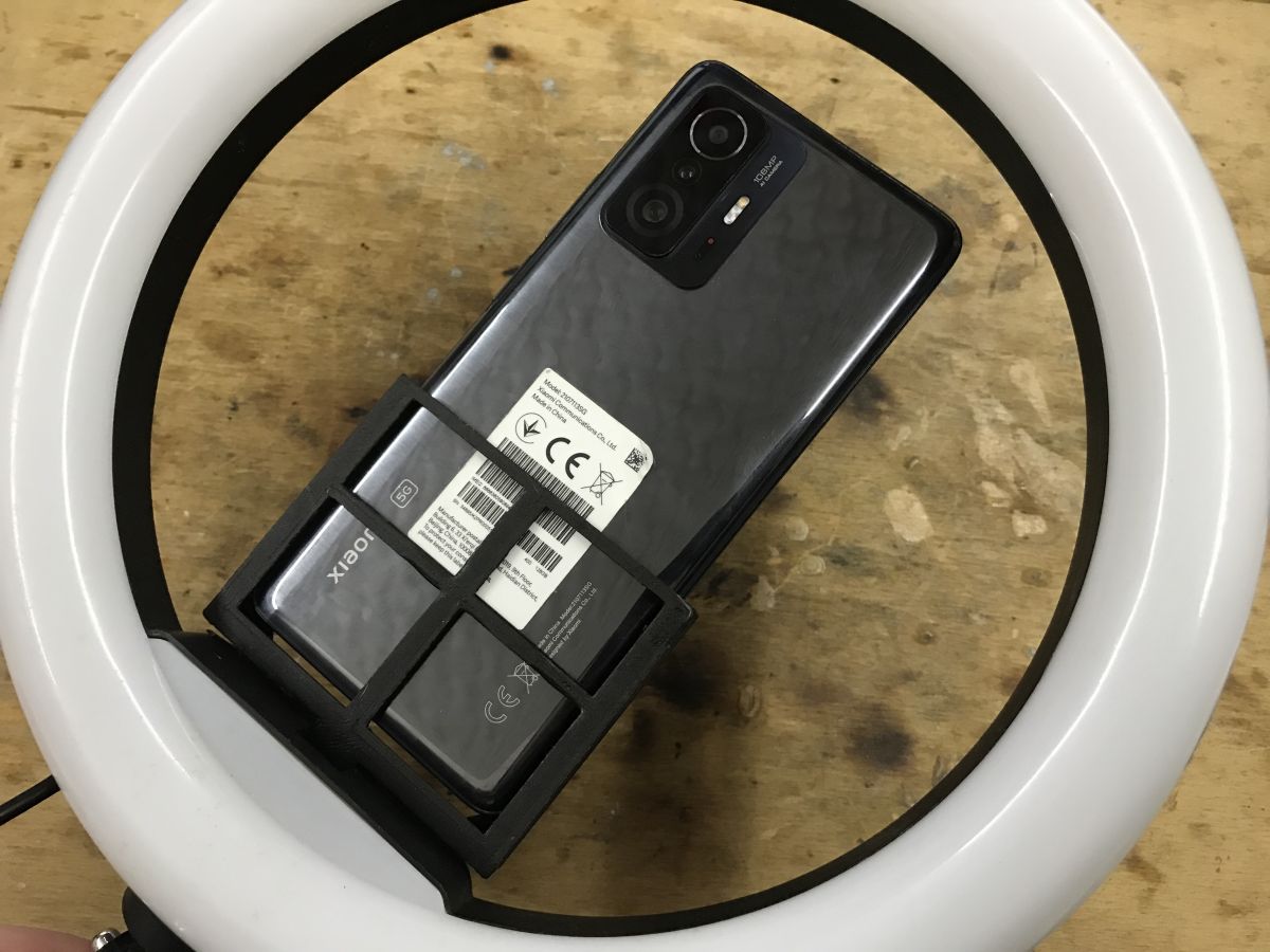

    I invite you to a short presentation showing the process of creating a simple 3D printable item. I will design and print a lamp-mounted phone holder that allows you to use your phone vertically. I will show the step by step design process along with test prints.
    In a way, this topic will be a continuation of the "phone as microscope" presentation:
    Phone as "microscope" and TQFP soldering - step by step video presentation
    I simply needed the option to rotate the phone 90 degrees, and the factory kit with the lamp does not offer this.
    I'll do the design in Blender, although it's not directly designed for this type of application - I'm just familiar with that program. This can be taken as a curiosity, or as an encouragement for people who already know Blender and would like to print something quickly. I won't describe the keyboard shortcuts etc. here, because that wouldn't be practical, I'll focus on the general methodology.
    I will print the target piece from PLA filament on an Ender 3 Pro printer.

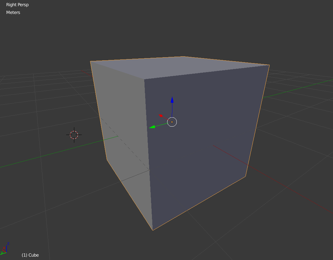

    In the beginning there was a cube...
    3D cube view in Blender with colored axes and transformation arrows

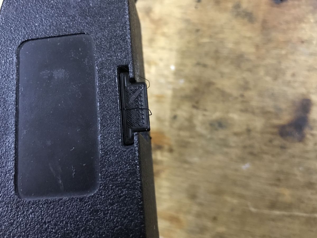

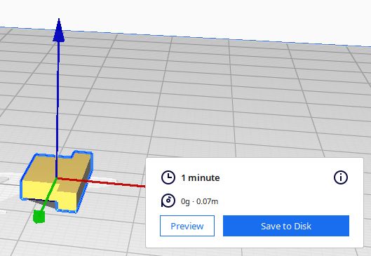

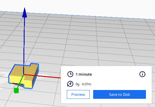

    At this stage it was time for a test print. Such a tiny piece will print in a few minutes, and will allow you to check tolerances and actual dimensions.
    Test 3D model in Cura software with 1-minute estimated print time.
    See how quickly it prints. It also matched up with me straight away:
    Close-up of a 3D-printed test piece fitted into a black enclosure on a wooden surface

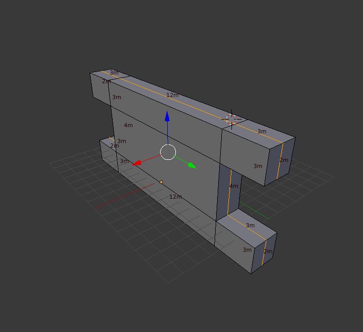

    It fits, it's fine - just in time for the squeeze. You can move on, i.e. make the "protruding" part:
    3D model of a phone holder with dimensions marked in Blender

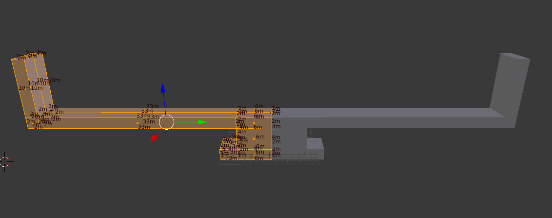

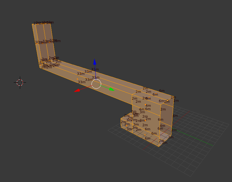

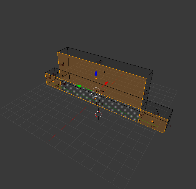

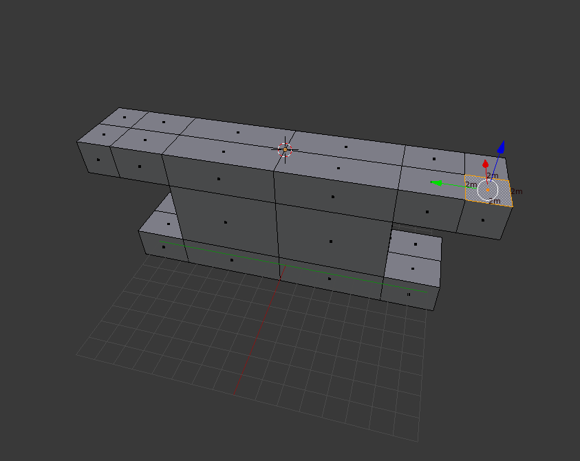

    In addition, I partitioned the element separately to have further fields to "extrude". I used "loop cut and slide" for the parting.
    3D phone mount model in Blender edit mode with mirror symmetry and visible grid.
    At some point, however, I realised I was adding work to myself and flipped the model into mirror mode. I made sure its centre ('origin') was in the expected location and removed half of it, then added a 'mirror modifier' to recreate that side.
    3D phone holder model in Blender with visible mesh dimensions
    This way I can only edit one page and the other will follow.
    Side view of phone holder model with dimensions displayed in Blender
    It was time for another print and fitting:
    Xiaomi smartphone in a black 3D-printed holder mounted to a ring light

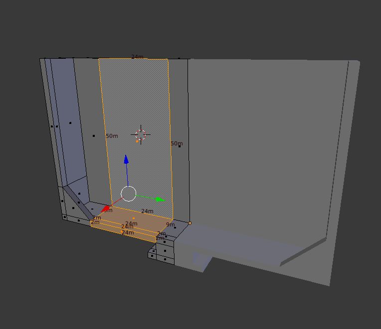

    At this stage I have already made a "pocket" for the phone. It has to hold it at least a little on both sides, on the front it can be built in, on the back no longer - because it would obscure the screen.
    Phone holder model in Blender with highlighted geometry and displayed dimensions

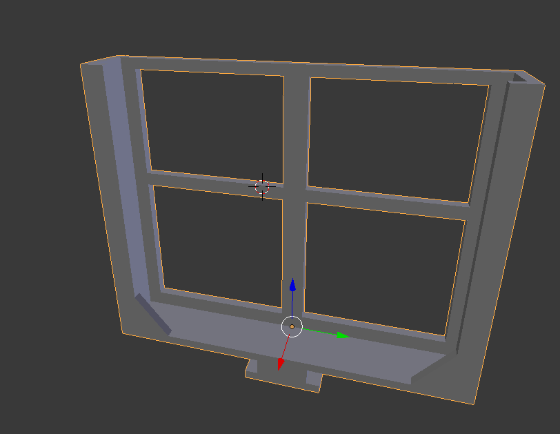

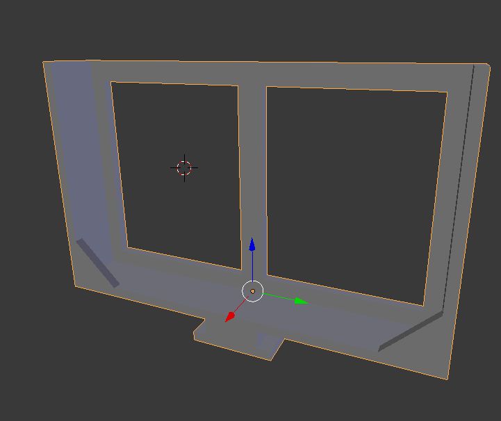

    However, enclosing the pocket at the front can significantly increase the print time and weight of the component. The element is not filled 100%, there is a setting for this in Cura, but it is still worth optimising this manually too. For this reason, I added a separate object - a suitably sized cube - and clipped it using the 'boolean' operation from the created element, or more precisely, set its clipping and did not accept the 'modifier'. In this way, it will be clipped dynamically and will respect the changes I will later implement in the shape.
    3D view of a phone mount model with two rectangular cutouts
    Finally, I duplicated the cube and made minor adjustments:
    3D model of a rectangular phone holder with inner grid and bottom clip.

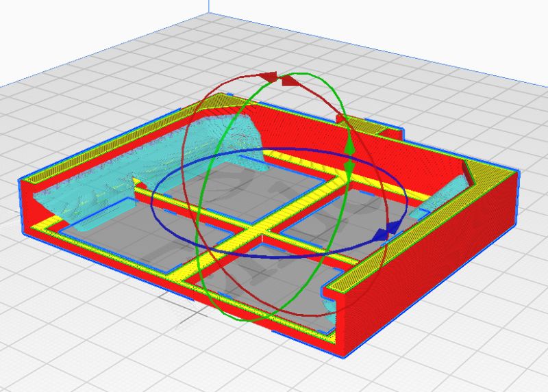

    Because of the added "hooks", the piece had to be printed with so-called "supports", or supports. I used "tree supports":
    Phone holder 3D model sliced in Cura with visible print paths and rotation axes

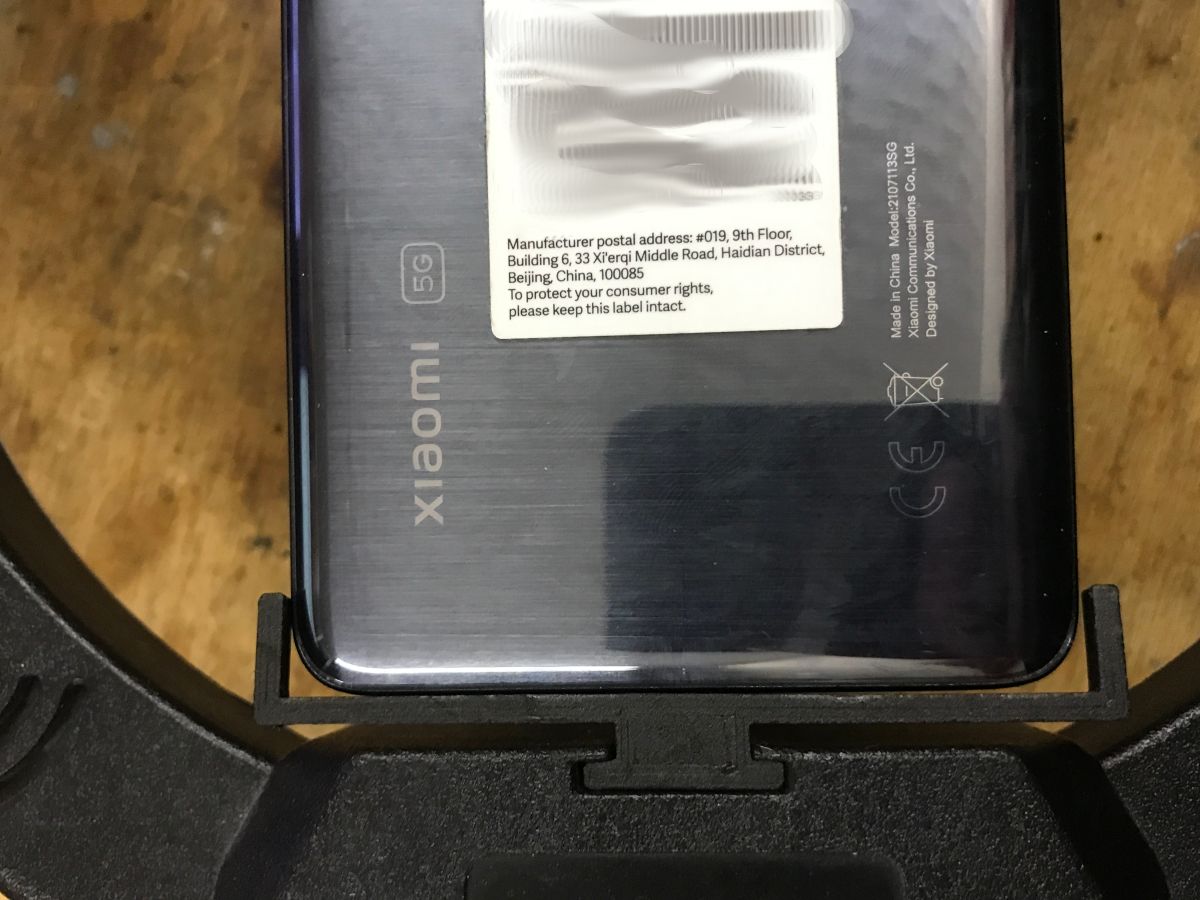

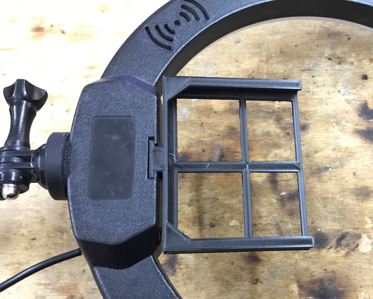

    The item fits, but does it hold the phone?
    Black 3D-printed phone holder mounted on a ring light frame
    The phone is held well, everything is fitted for the model I am using. You could do a gripper with an adjustment (based on a screw for example), but given the ease of adding a new model as I change phones I decided it wasn't worth the complication.
    Phone held vertically in a 3D-printed mount attached inside a ring light
    In summary , this was a brief demonstration of designing a vertical phone holder for the light. From now on, I can shoot videos in vertical format. It remains to be seen how much it cost me:

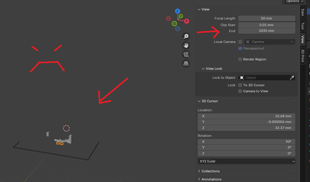

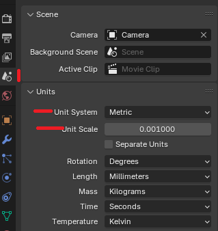

    I will do the design in Blender, although it is not directly intended for this type of application
    "Good morning to you in the new year. Actually, you're right, but I've made absolutely every 3D printable model in Blender. If you are stubborn, you can even (with the help of external websites that generate SVG files) model gears.
    In any case, I see that you have the units set most probably to "Blender Units". It's worth setting it as in the image attached below - you then have everything beautifully in mm (millimetre parts also work, of course). "Scene properties" section.
    Blender unit settings with metric system and scale set to 0.001
    Unfortunately Blender may not be thrilled with such large values when you zoom out of the view.
    Then part of the object may not be drawn. Just like in the image below:
    Blender screenshot with Clip End set to 1035 mm and red arrows marking the area

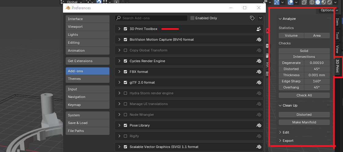

    To make sure that the designer is full and the application whole (or whatever the saying goes), all you need to do is set the "Clip End" parameter to something larger in the View section of the secondary panel (under the N key). There may even be absurd values :) . On top of that (I don't actually have a way to replicate this graphic artefact), sometimes when zooming in on a model in Solid mode, the textures start to look weird (as if they were cut out with scissors). Then you have to play with the "Clip Start" parameter.
    Finally, I'll give you a hint - check out the 3D print Toolbox add-on. (image below)
    Blender add-ons panel with active 3D Print Toolbox and analysis settings visible
    It makes working with print models very easy. It has an option to check if the model is "full". We do the "Solid" check in model editing mode, it can then nicely show edges that don't match. Sometimes Blender also misaligns its planes and after exporting to STL, the cutting software (e.g. Prusa Slicer) does not see one of the holes even though the model looks ok in Blender. Then we click "Make manifold" and usually the model is already correct after the next export. AAA, (you probably know) but it's always a good idea to "apply dimensions" after making modifications. On a model in manipulation mode (not edit mode) shortcut Ctrl + A and "Apply All transforms". BLender can sometimes get lost with the scale of the units and then there are flowers when printing.
