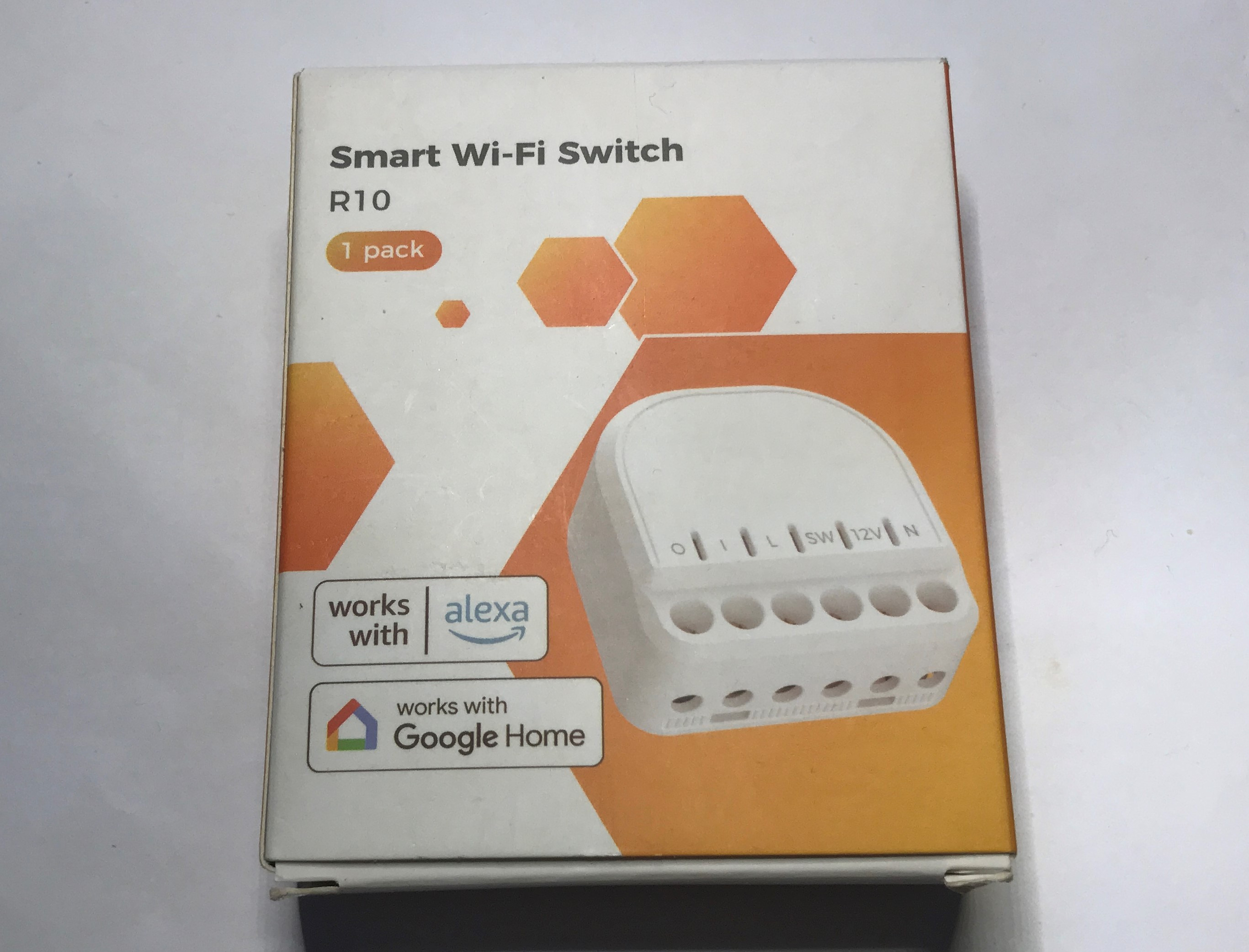

Refoss R10 relay packaging with Alexa and Google Home logos
Do IoT manufacturers want to help us change firmware? The Refoss Switch R10 is a single relay module capable of controlling both a classic switch and from the Refoss mobile app. The device is based on the ESP8266 chip and is distinguished by an easily accessible programming connector that allows the firmware to be changed without soldering. What's more, this connector is even externally accessible, although here you have to be careful - the device has no galvanic separation, so you ABSOLUTELY cannot plug anything in there when it is connected to the mains. I will show here the whole process of changing the firmware and give its template for the Tasmota software.
Let's start with the packaging. Nothing here stands out about this product, maybe possibly that warranty. Two years? Anyone respect that?
Box of Smart Wi-Fi Switch R10 featuring device image and Alexa and Google Home logos Side of Wi-Fi switch box showing product name in 12 languages Back of Refoss R10 switch box with technical specs and certification labels
