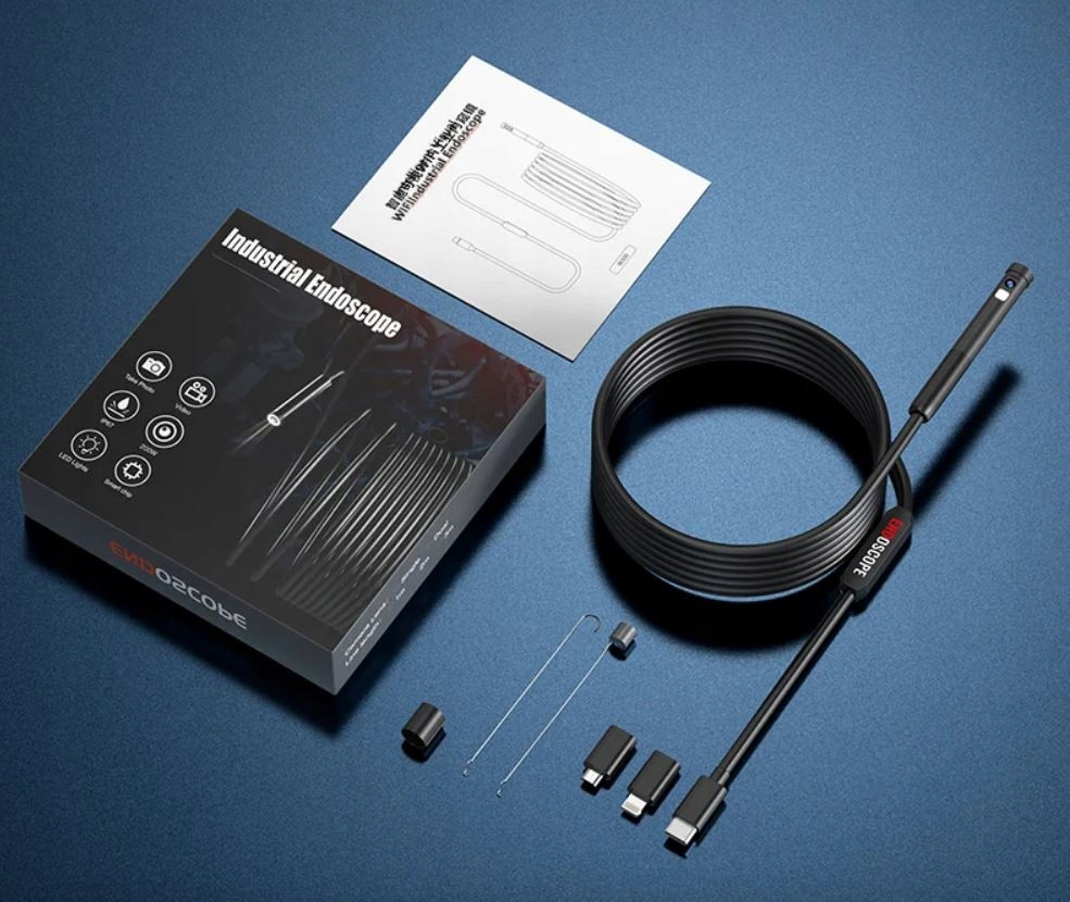

Today we're testing the W300 dual inspection camera/endoscope offering an IP67 rating, a two-metre cable, two viewing angles (side/front) and Wi-Fi connectivity. I'll also be checking to see if it can actually record video in the promised 1080p full HD quality.
Let's start with the contents of the kit. Today's devices have USB C connectors, and it's similar here, although this connector is only for power.
However, we also include converters for other connectors, all things considered. In addition, there is a hook:
The dedicated app can be found by scanning the QR code.

Both cameras have backlighting:
