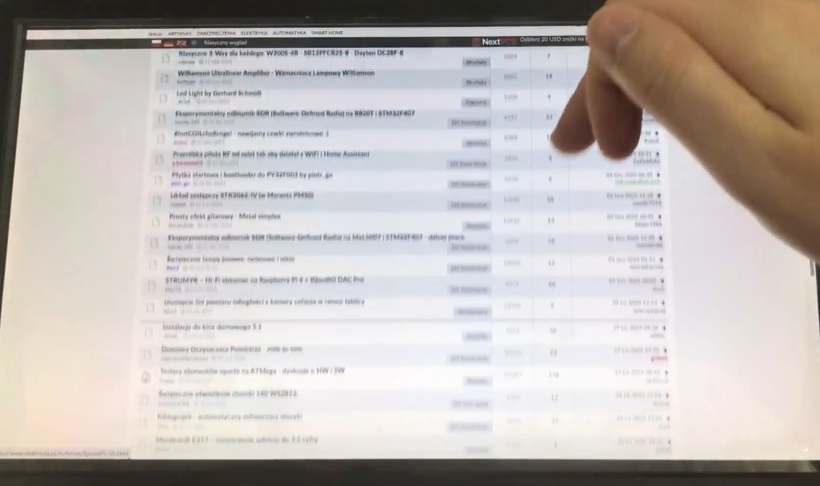

The image is sharp and clear, even at an angle (178° according to the manufacturer). The touch responds well to gestures.
You can also zoom in and out of the view. The 'pinch to zoom' gesture, as shown in the video, is used for this:

The monitor introduces no perceptible lag to the main laptop screen:
