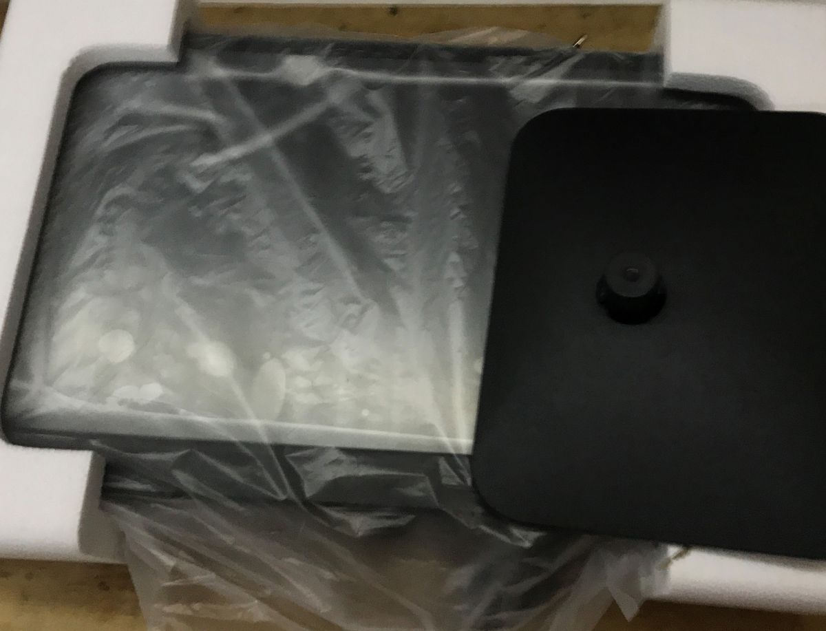

    Let's start with the contents of the kit and packaging. The product is well protected for travel. We include a stand and HDMI and VGA cables. The monitor also has a USB cable, this is what it uses to transmit touch information.

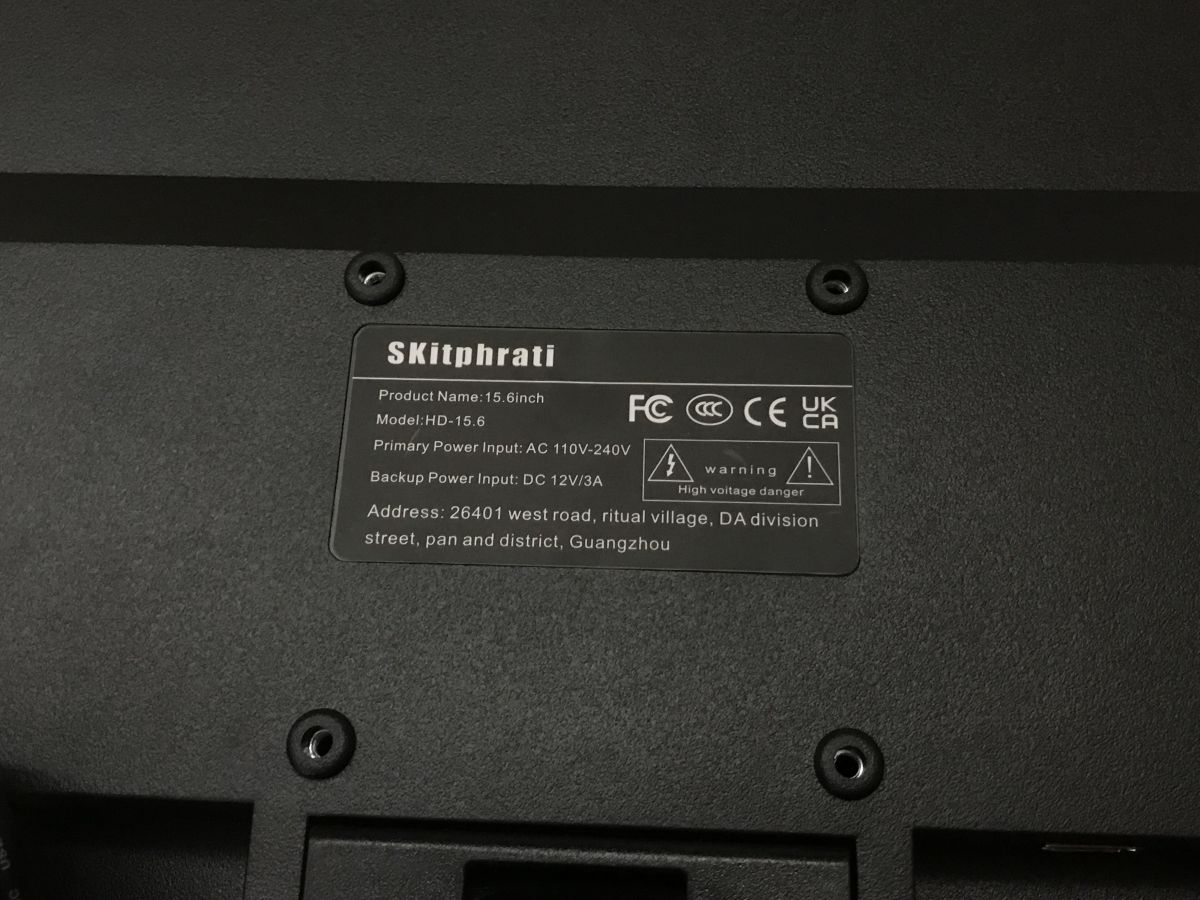

    The monitor can operate on mains voltage or from 12 V, up to 3 A is required.

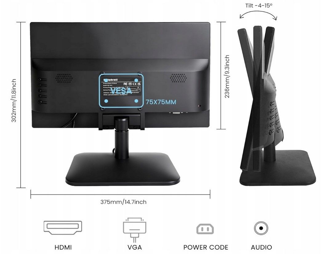

    HDMI and VGA connectors are available on the bottom, so connecting a computer is unlikely to be a problem. We also have an audio jack, as the monitor has built-in speakers.

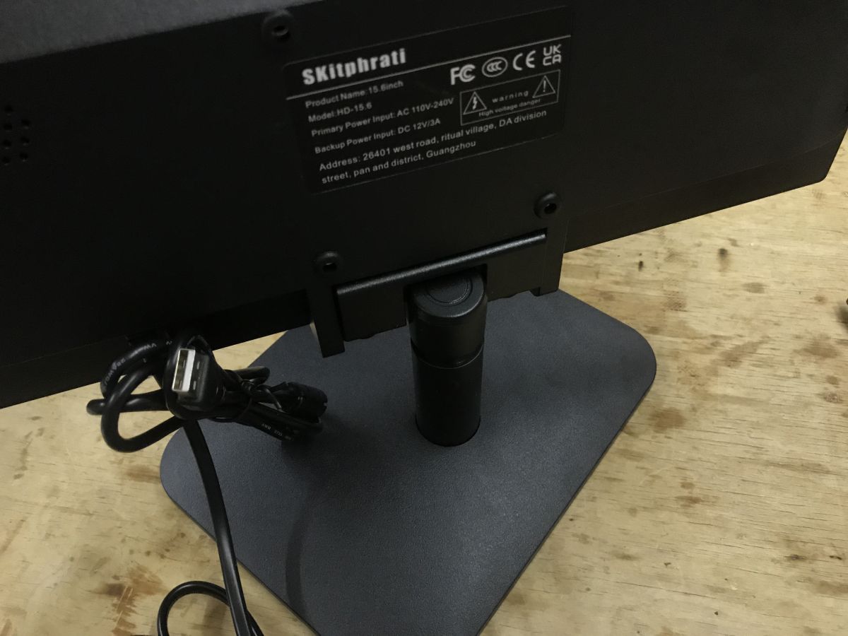

    The monitor has a very simple but surprisingly stable footprint:
    Touchscreen monitor for the workshop? Minitest SKitphrati 15.6 " 1080P HD-15.6 Back of a 15.6 touchscreen monitor on a stand with USB cables attached
    It is also compatible with the VESA 75x75 mm connector.
    Back of 15.6 touchscreen monitor with VESA 75x75 mm mount and tilt stand

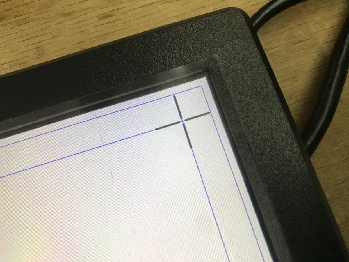

    I thought I was going to install the drivers - but no. Everything moved right along. The only thing worth knowing here is the process of calibrating the touchscreen, this is done in Windows, in Control Panel -> Hardware & Sound -> Tablet PC Settings, where the calibration option is available. The whole procedure boils down to pressing the markers shown on the screen:
    SKitphrati touchscreen monitor during screen calibration in Windows
    Close-up of a touchscreen monitor during touch calibration in Windows

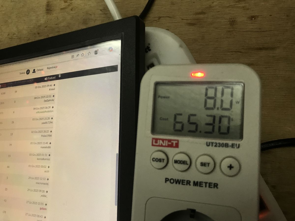

    The monitor draws only 8 watts from the mains. In standby the consumption is less than 0.5 W, so my meter cannot note it at all.
    Power meter shows 8.0 W energy consumption by the touch monitor. Power meter showing 0.0 W next to a black monitor corner

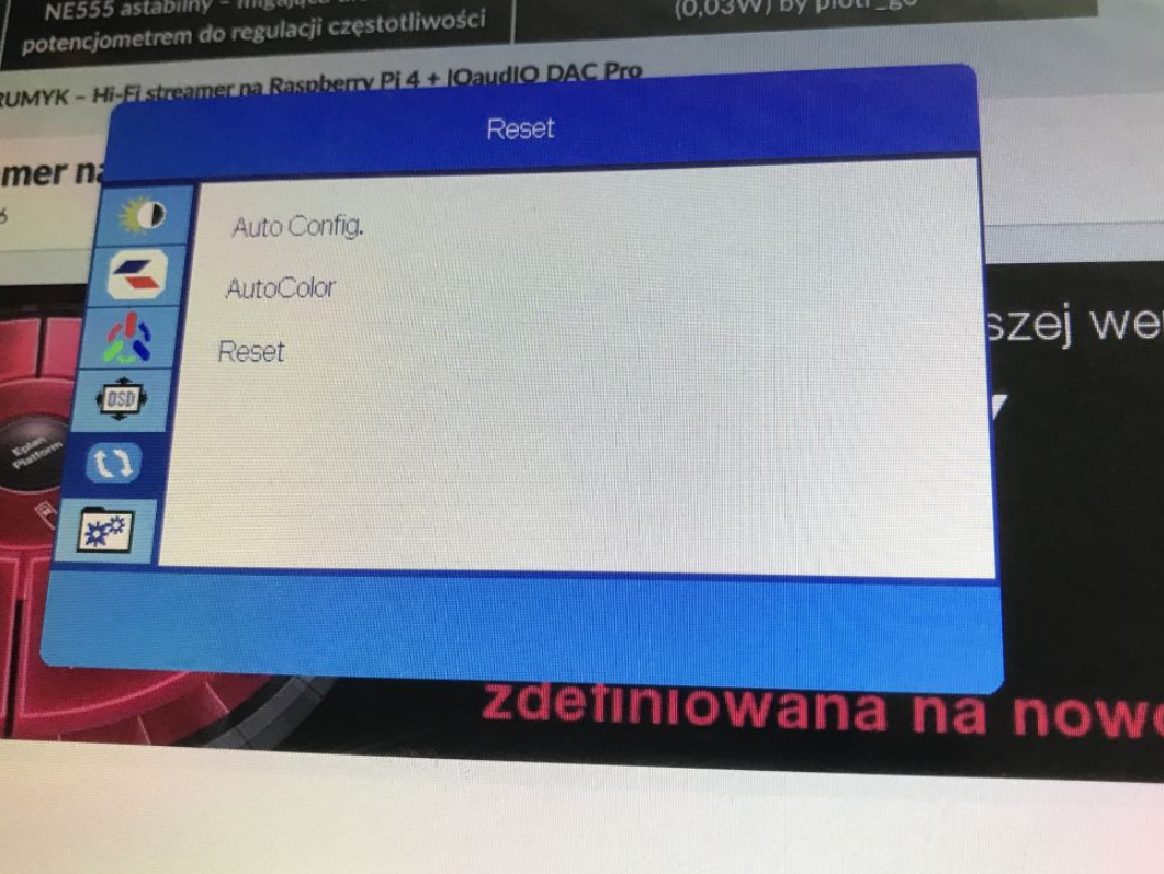

    I also tested the OSD menu. Interestingly, changing the brightness does not affect power consumption, even though HDR is switched off.
    Monitor OSD menu showing color settings and LowBlue Mode toggle Monitor OSD menu with Auto Config, AutoColor, and Reset options Monitor OSD menu showing input, mute, volume and FreeSync options
