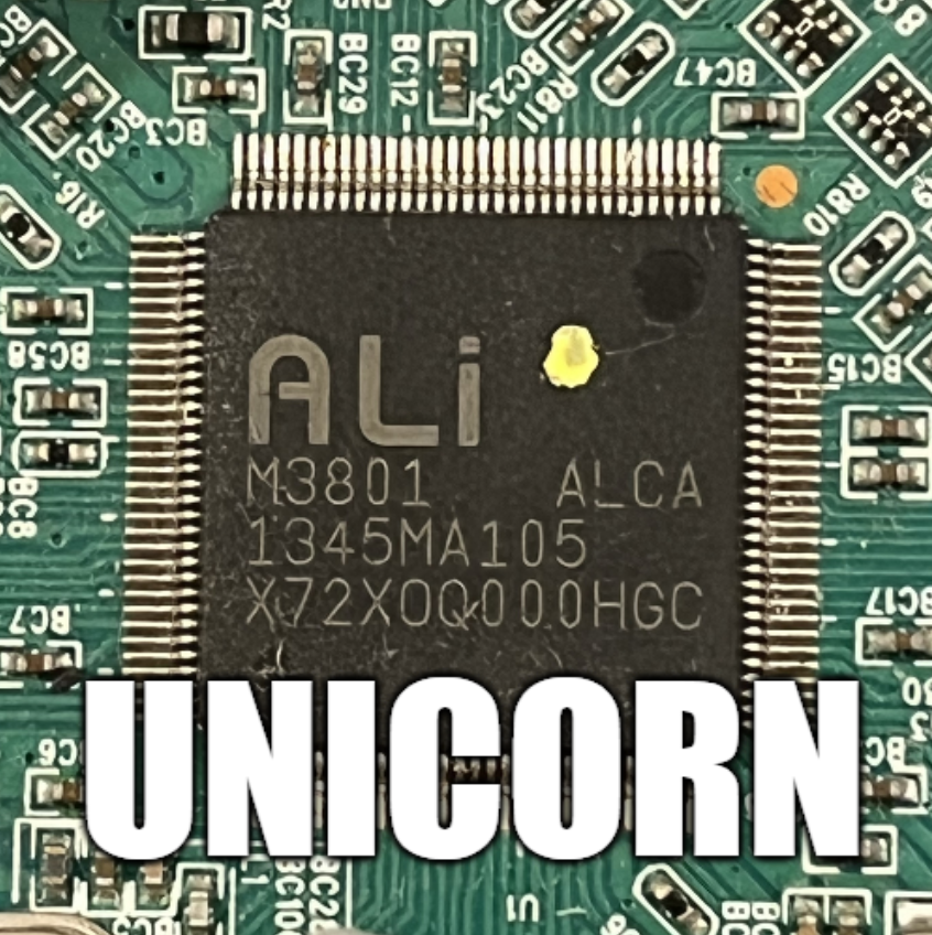

Here I will show my first attempt at building an emulator for the ALI M3801 microprocessor based on off-the-shelf Unicorn and Capstone modules. The developed program will load the contents of the Flash memory and execute it similarly to a real physical CPU, although it will not be without modifications and fixes, as Unicorn/Capstone do not implement the full logic of a particular SoC or its peripherals. In addition, the whole thing will be able to correctly handle sending data over the UART, i.e. it will emulate the register responsible for transmitting bytes over the hardware serial bus. In this way, we will get the same messages in the console that running a programme on a real ALI chip would show.
