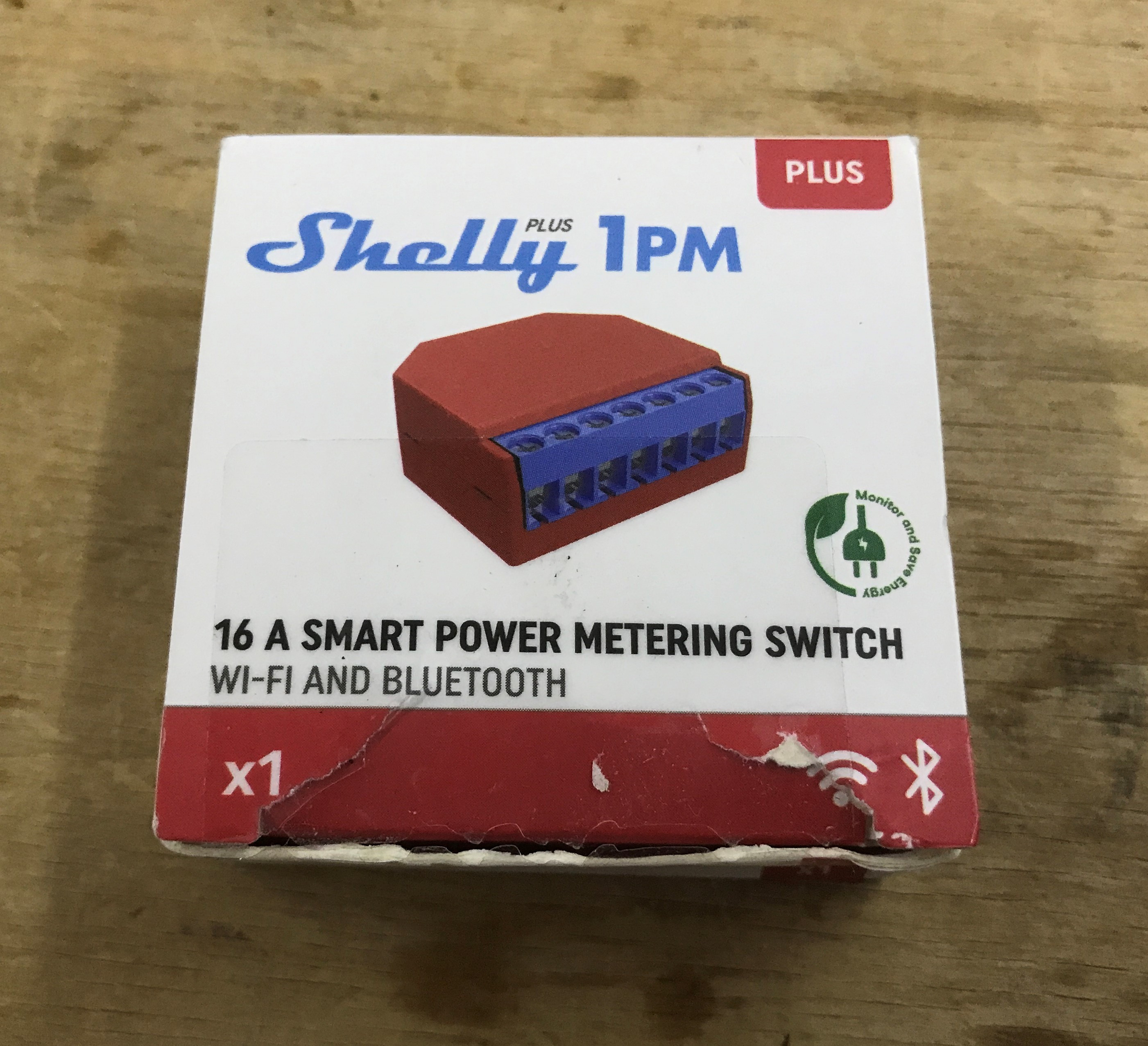

Shelly Plus 1PM product box on a wooden surface, showing the module graphic and Wi‑Fi and Bluetooth text
This relay with Wi-Fi control does not need to be programmed - everything can be connected to Home Assistant from the factory, and even additional sensors are supported. I invite you to a short test of the Shelly Plus 1PM, which offers single-receiver control, one-button operation, energy measurement and convenient configuration even without a mobile app.
The gadget itself is quite cheap, you can buy it for around PLN50, admittedly Tuya is cheaper, but maybe it's worth it? Let's check.
Let's start with the packaging and contents of the kit.
