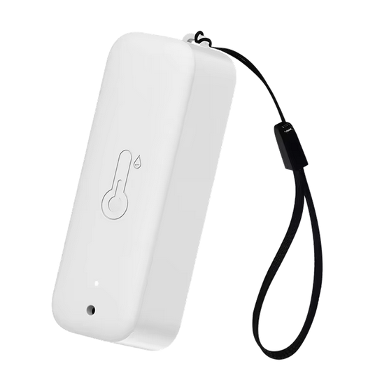

[BK7231N / CB3S] TH11 Temperature and humidity sensor (IP65/WiFi)
tplewa  7 1722 Cool? (+1)
White temperature and humidity sensor with strap and thermometer icon
This is another WiFi temperature sensor that works with the Tuya/Smart Life system as standard. It is an IP65-rated version for outdoor placement. The sensor is powered by two AAA batteries and is based on the CB3S module and the TuyaMCU microcontroller - here, as usual, the sensor was purchased to convert to OpenBK, i.e. to work with Home Assistant bypassing the Tuya cloud.
What we get in the box
Here, without much surprise, a short instruction manual, the sensor itself + pendant and the mounting tape and magnetic tape.
TH11 temperature and humidity sensor with manual and mounting accessories Close-up of the back of a TH11 temperature and humidity sensor with technical details Opened housing of a sensor showing dual AAA battery slots
User manual for TH11 temperature and humidity sensor, showing specifications and instructions Tuya temperature and humidity sensor manual with installation and feature guide
