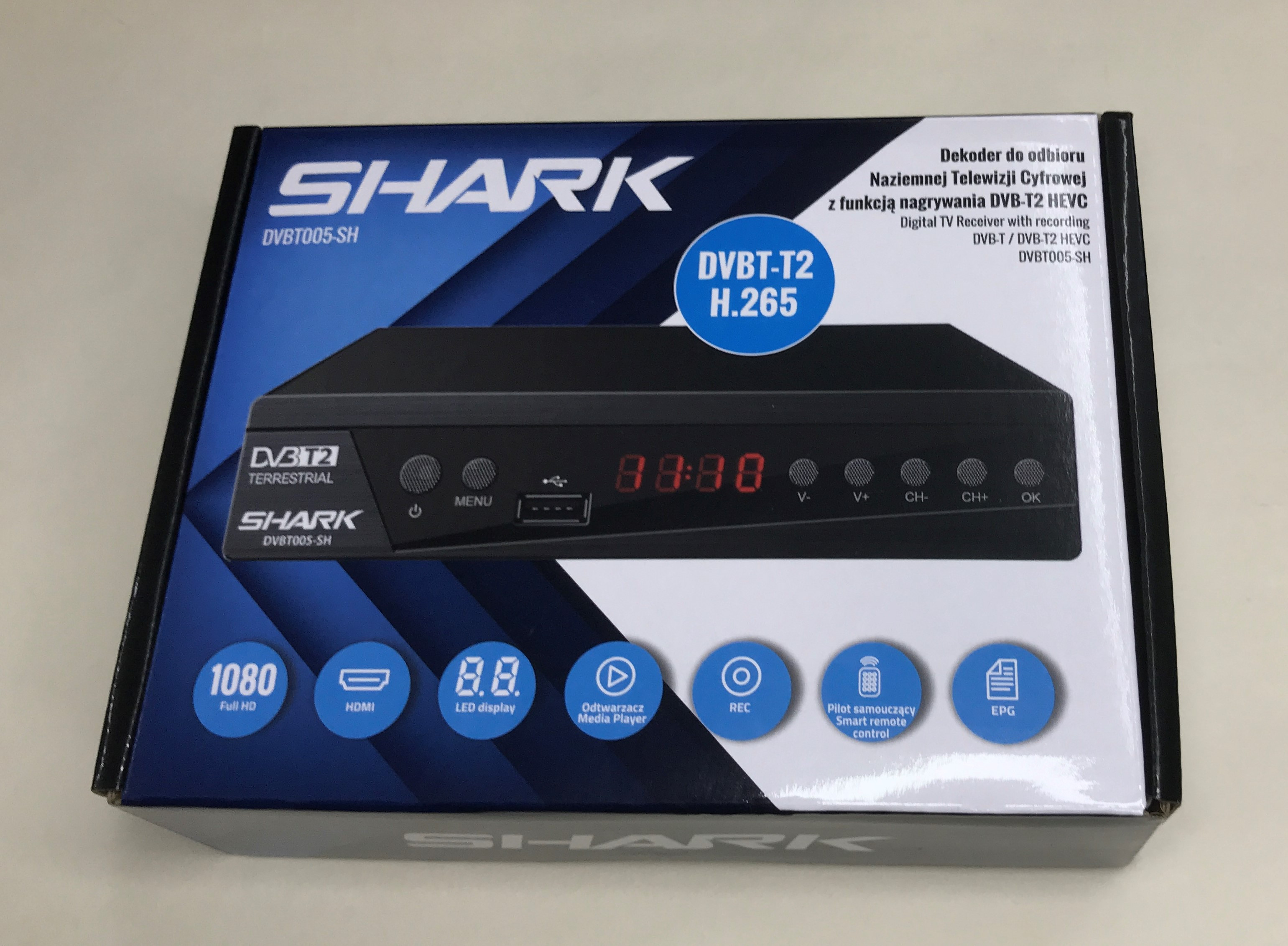

SHARK DVB-T2 H.265 digital TV receiver box with USB and LED display
Something contemporary this time. I've already shown some old tuners, so it's time for a change. As standard, first a presentation of the interior and then an analysis of the Flash memory along with a Linux file system extract. Maybe we can also find a program to change the batch?
SHARK DVB-T2 set-top box with user manual inside open packaging
The object of the presentation is a contemporary DVB-T2 / HEVC / H265 decoder characterised by a programmable remote control, which can also be controlled by the TV proper. Just right for the elderly. It was for such a person that I ordered this decoder. I paid all 60 PLN and decided to take a look inside.
