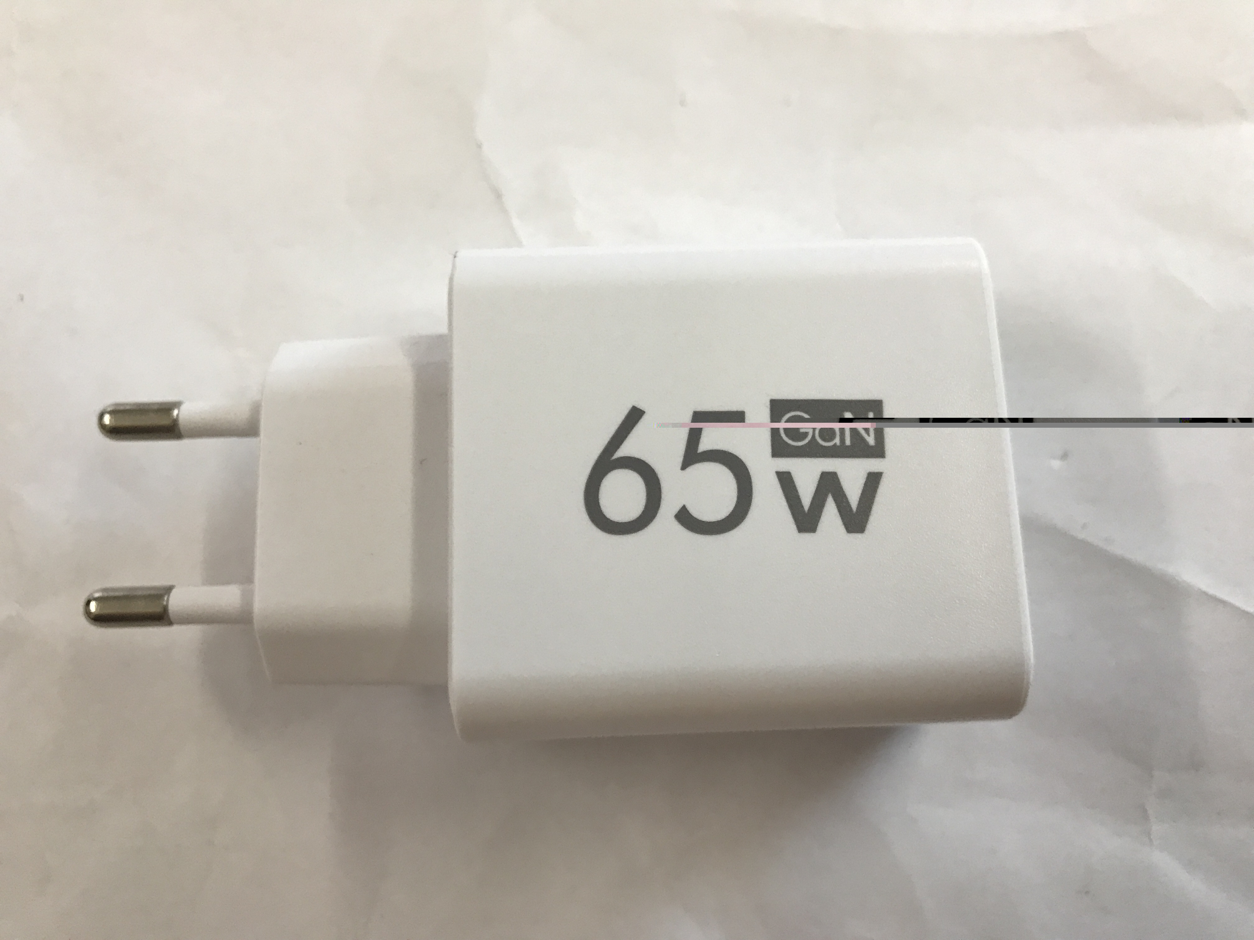

I invite you to test the boisterously advertised welcome gadget offered to us by AliExpress for just 1$ with free shipping. Here I will check what performance this power supply has in practice, whether it really supports QC and reaches 65 watts, and whether the voltage at its output is safe for our mobile devices. In addition, I will also look at its PCB under thermal imaging to determine what heats up the most.

I waited a long time for the package to arrive, but here it is - there's no mistaking it, it says 65W on the packaging and case too:
Plastic packaging with 65W USB C charger label and visible EU plug Close-up of product label on Chinese electronic device packaging
On the device we have its performance (?) - up to 7.2 A at 9 V, up to 5.4 A at 12 V and up to 3.25 A at 20 V:
USB-C wall power supply labeled 65 W, model TRG-185 White charger labeled 65W GaN with European plug White charger with USB-A and two USB-C ports, labeled PD 33W.
All nice, but QC trigger can't even switch on 7V - what's up?

Summary
This product is outright misleading and does not deliver what is promised. What's more, the whole thing is of poor quality, and after a load of about 3 A the voltage starts to jump in a strange way, up to 7 V, and the overcurrent protection does not always immediately engage.
In addition, the construction is flimsy, I would be afraid that at some time of pulling out of contact a part of the device will be left in my hands.
I wonder what the construction of the transformer is like, but I didn't want to destroy it to find out.
All in all, it is hardly surprising that I would totally advise against buying this product. If this is what a "welcome deal" or a "welcome gift" is supposed to look like, then I dread to think what the actual "cooperation" will look like. The shop is still promoting it and non-technical people are ordering and getting fooled.
