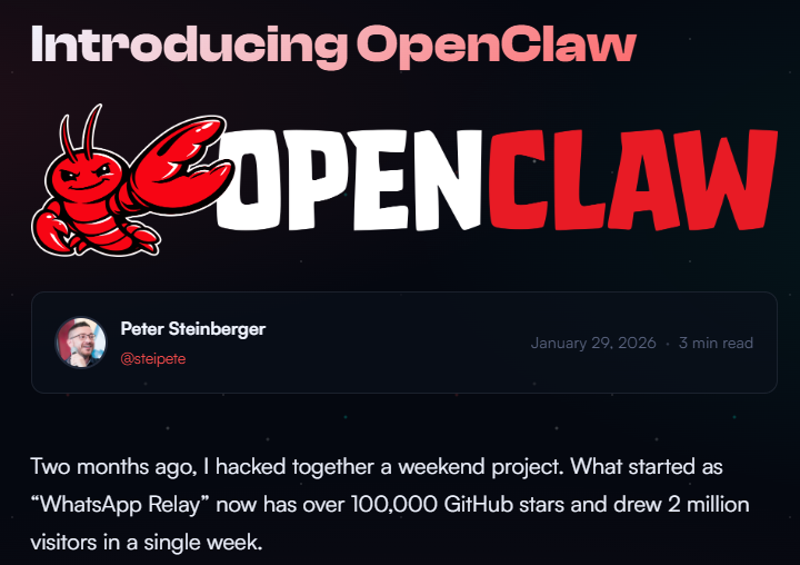

Screenshot of “Introducing OpenClaw” article header with large OpenClaw logo and author info
How do you install the intelligent (?) OpenClaw/Moltbot/Clawdbot helper on your own computer? Does running the helper really come down to a single command in the console, as the project's homepage promises? What can OpenClaw do, what difficulties can be encountered during installation?
This is where I will try to present it. I will show here my authentic story of configuration and testing of one of the first versions of OpenClaw, more precisely the version as of 01.02.2026. I will check if the project is already suitable for the "grey user" or if it still needs improvements.
What is OpenClaw ? Basically it's a runtime environment for various LLMs (large language models), it gives them access to our PC and to all sorts of tools. Information about OpenClaw has already been presented, related topics:
