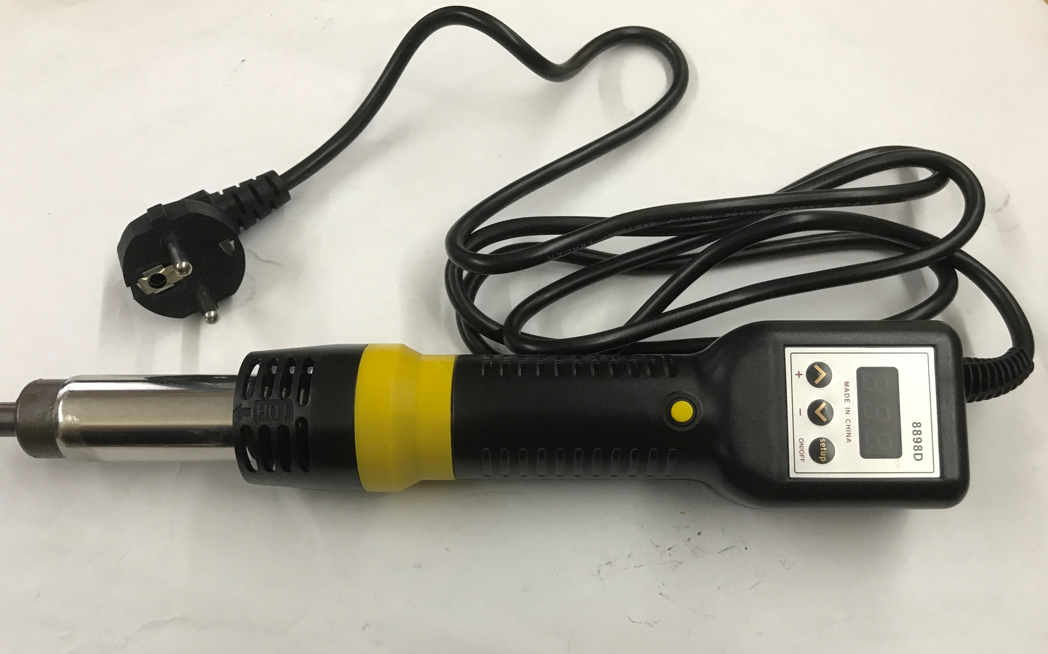

  • The 8898D portable hot air rework station offers up to 700 W, 100 °C–480 °C temperature control, up to 120 l/m airflow, and a three-digit LED display.
  • The set includes up to three nozzles, and the manual also lists 600 W, heater error codes, calibration steps, and °C/°F switching.
  • On junk PCBs, it removed small SMD parts in 30–40 seconds, SOICs in under two minutes, and a TQFP part in 1:40.
  • Heat delivery weakens on copper-heavy boards, and 450 °C often measured below 300 °C on the sensor unless airflow was reduced.
  • It feels similar to the 8858, slightly better, but still far behind the classic stationary 858 for raw heating performance.
Portable 8898D hot air tool with metal nozzle and power cord on a white surface.
the 8898D is a portable hot air offering up to 700 W and adjustable temperature(100 °C - 480 °C) and blowing (up to 120 l/m). Current settings and measurements are displayed on an easy-to-read three-digit LED display. The whole thing is available to buy for just PLN80 and we get up to three nozzles in the set. The question is, is it worth it? Let's find out!

the 8898 seems to be quite similar to, although slightly better than, the 8858. Especially the 450 °C target temperature is better, with less than 300 °C achieved in practice. Unfortunately, the classic 858 is still a long way off - it reaches a good 75 °C more. The results correspond to the power measurements - the 8898 heats with slightly more power than the 8858, but less than the 858.
Summary
Given a choice between the 8898 and the 8858, I prefer to choose the 8898. Nevertheless, both of these stations are trumped by the classic stationary 858, only that it is a different type of device. If you have problems with heating, you can, of course, reduce the blowing, which I also managed to illustrate, but then you heat in spots and more slowly, it is also easier to "bulge" the PCB. Everyone has to test a new station on junk PCBs themselves and judge how they work better. I am most comfortable with fast heating of a large area, as I don't use a heater, but it still depends on what we are doing. That's what we have different sized nozzles for.
Overall, it's not bad, although with the size and weight of the classic 858, I don't know if there's any point in combining with the 8898D.
