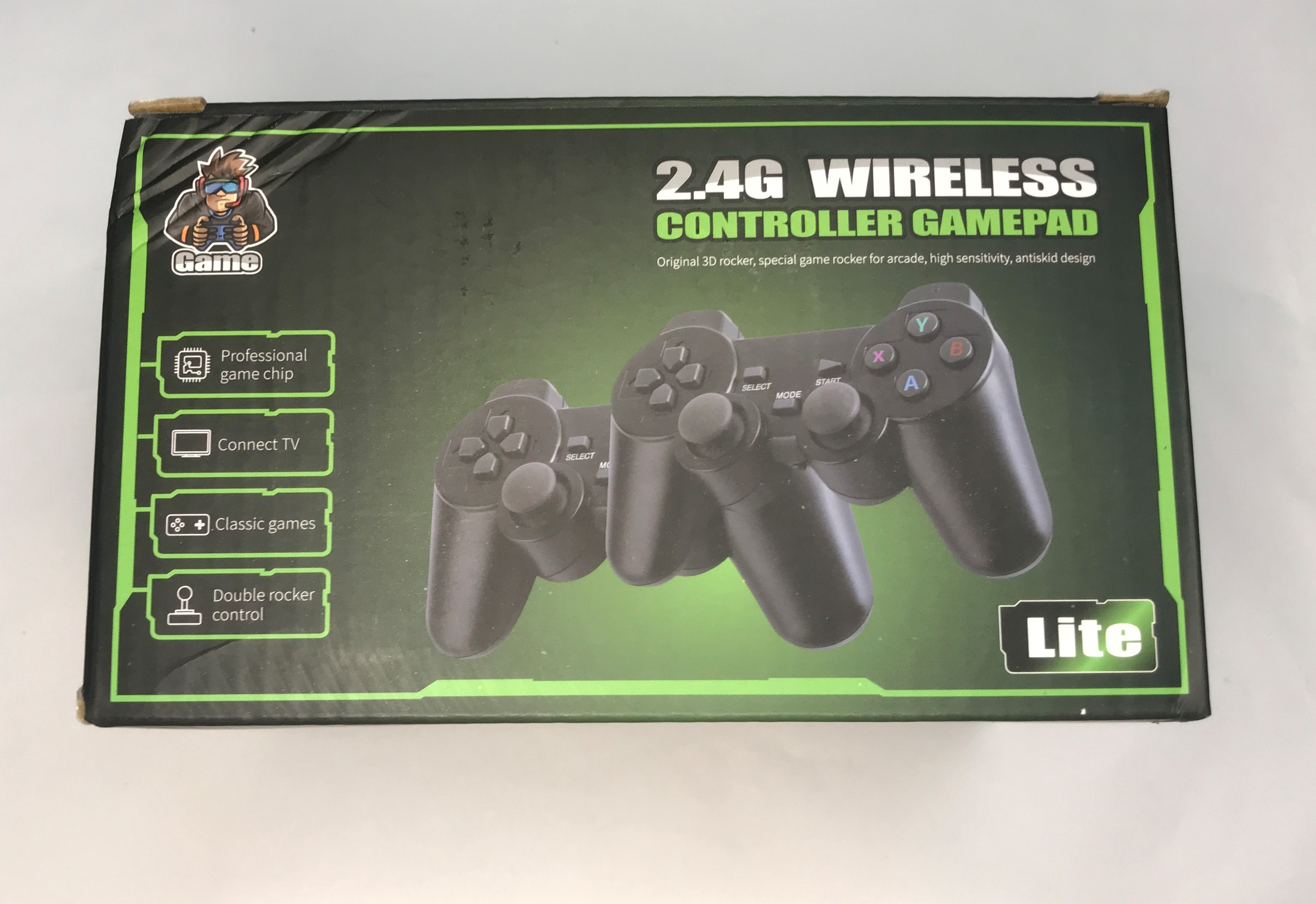

I'd like to invite you to a short presentation of a video game console bought for PLN80. The device shown here is based on the RetroArch system and allows you to run games from platforms such as Atari, Nintendo, PlayStation, GameBoy, Sega, etc. The product has around 20,000 games preloaded, and there is also the option to upload your own ROMs. The console is in HDMI plug-in form and the pads communicate with it wirelessly.
Box labeled “2.4G Wireless Controller Gamepad” with game stick image and feature panels. HDMI game console set: black box with device inside and two controllers wrapped in bubble wrap Black “GAME STICK LITE” 4K in packaging, with a small USB receiver labeled “S2-H”. Box labeled “2.4G Wireless Controller Gamepad” with artwork of two black controllers Box labeled “2.4G Wireless Controller Gamepad” with artwork of two black controllers
Model: N00031125K50, Flash size - 128 MB, RAM - DDR3 256 MB
The whole thing came to me from China, the package got a bit battered on the way, but you can't see the damage on the product itself. The pads were protected by bubble wrap. Also included is a USB cable (for power) and an optional short HDMI extender, this is in case you are short on space behind your TV.
