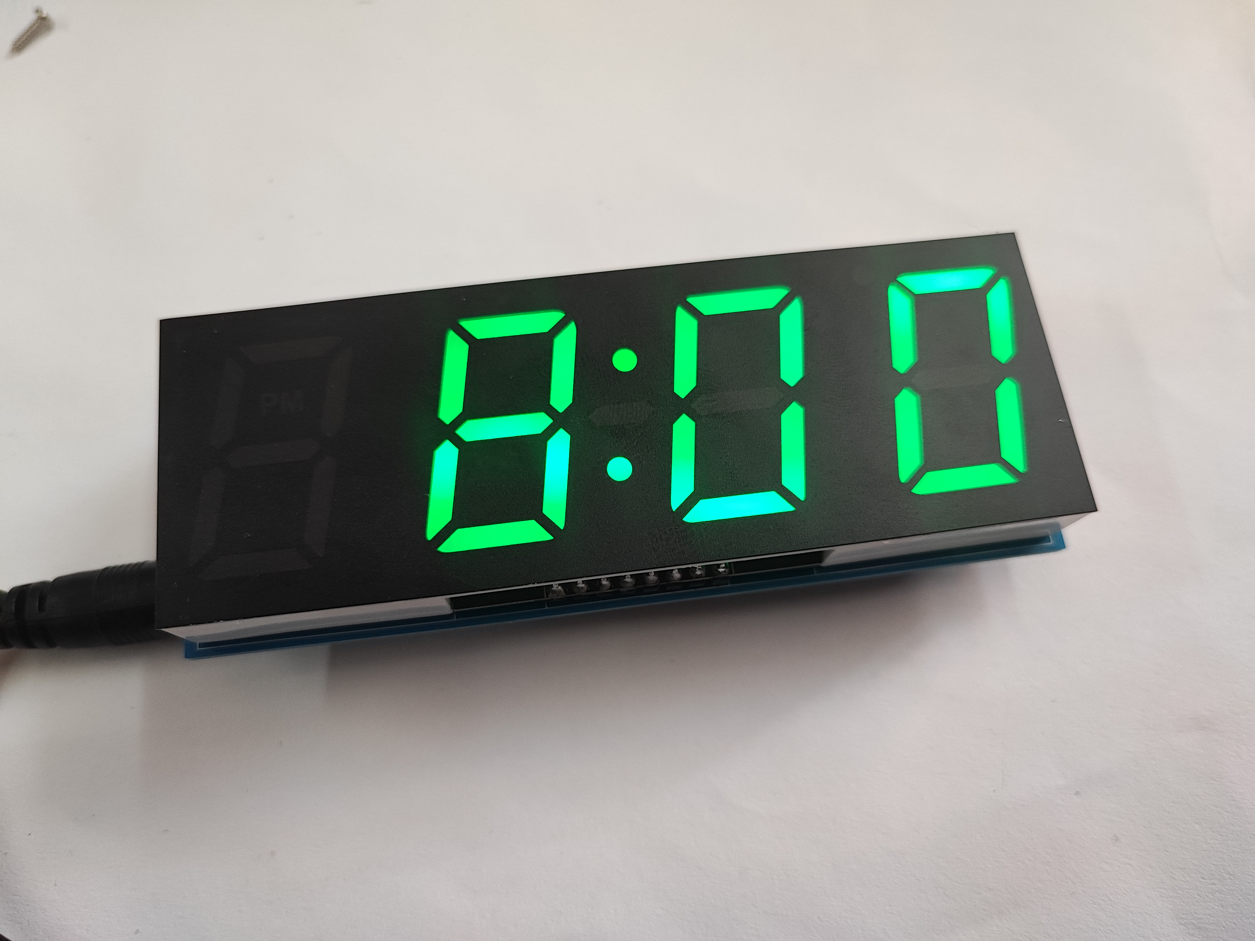

Green 7-segment clock display showing “8:00” on a white surface
What kit for a beginner to learn soldering? Here is another simple and enjoyable kit - a clock with alarm and temperature measurement based on a large 7-segment display, all realised on a double-sided board based on through-hole assembly and available to buy for just under a dozen zloty.
DIY clock kit parts: PCB, large 7‑segment display, bag of components, and clear acrylic case pieces
The kit includes the board, a set of components, the display, as well as a neat acrylic case. You will additionally need a 5 V power supply, but such probably everyone, as well as of course a soldering iron with accessories. The cheapest one will suffice:

Clock in action:
Green 7-segment display in a clear case showing “1845” Green 7‑segment display in an acrylic case showing “17°C”
Basically, everything works, although you have to make sure you turn off the alarm, as it is quite loud and can wake you up in the middle of the night if you click blindly.
Plus, the whole thing can be unplugged and the battery from the DS1302 will still hold the time, so you don't need to re-set it when you move the clock to a different location.
In summary , this was a simple to run DIY for a beginner. Basically, it rather exercises only the soldering, as the whole thing starts immediately after assembly and it's hard to run into a problem to solve here. The microcontroller in the kit is of course already programmed and the board is well labelled, so you know what to solder. Resistor values are also unlikely to be confused here, as there is essentially one - 10 kΩ. But is that a bad thing? Just in time to encourage electronics.
