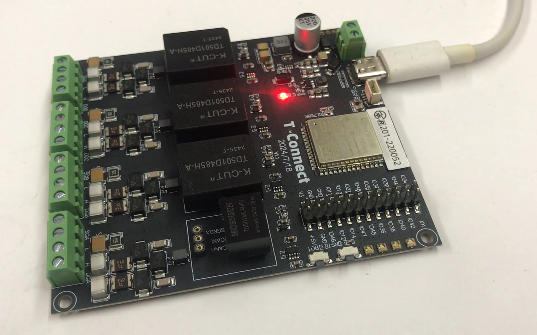

Here I will introduce the Lilygo T-Connect industrial board distinguished by its simultaneous support of up to three RS485 buses and one CAN line. I ordered it from China for around PLN200.

We open the distinctive box and pull out the plate. What strikes you immediately is the ESP32-S3-WROOM-1 module which is the heart of the T-Connect, here in the N16R8 version, i.e. with 16 MB Flash and 8 MB RAM.
LilyGO T-Connect board with ESP32 module, three RS485 modules, and green screw terminal blocks
In the corner we have a power section with a voltage-reducing inverter, allowing the whole thing to run on 7-12 V DC, a USB C connector and a QWIIC with UART. There is no USB to UART converter, as the ESP32-S3 supports hardware USB. In addition, we have two rows of goldpins with GPIO, ground, 3.3 V and 5 V pinout, and four APA102 LEDs.
