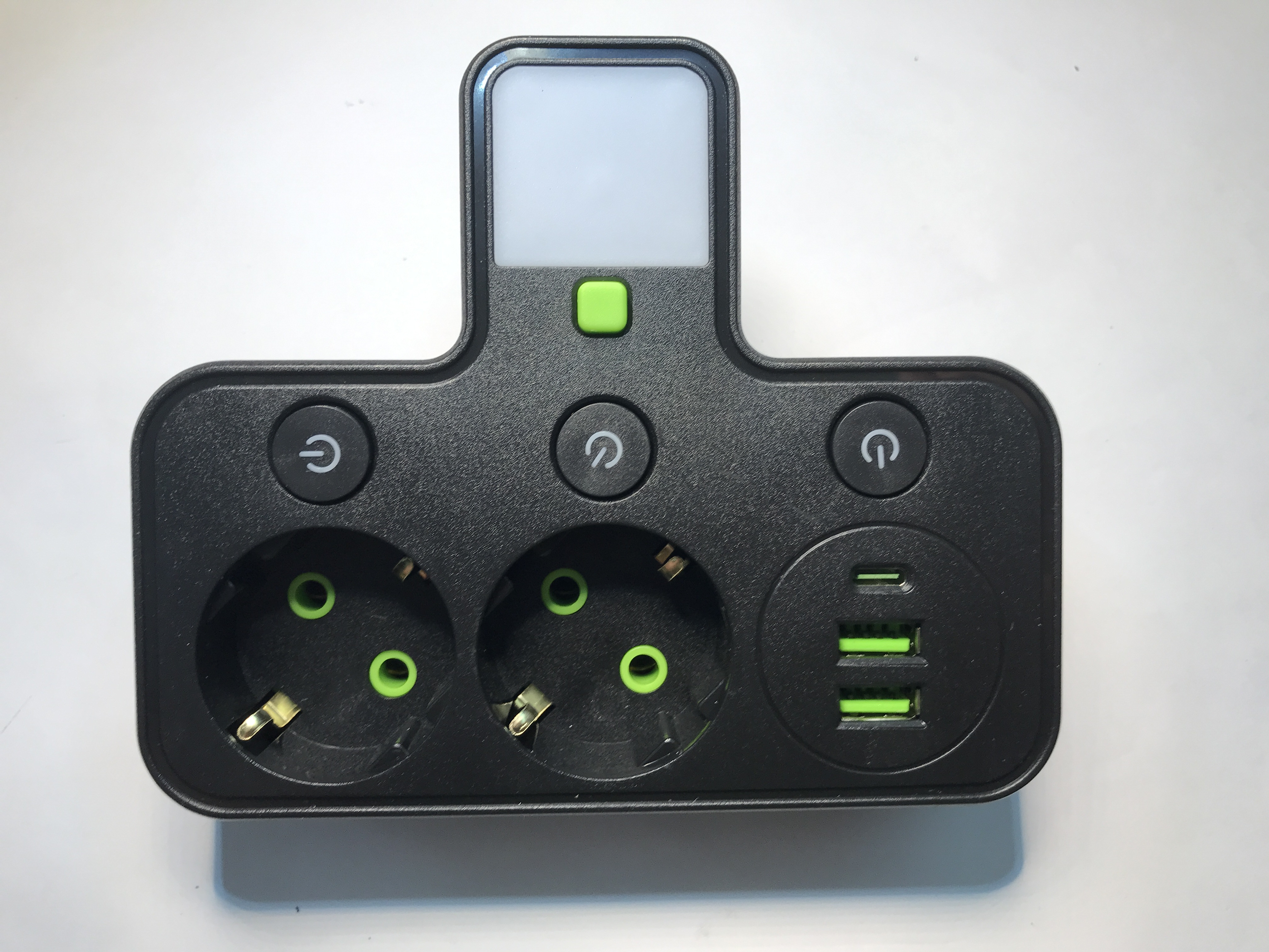

  • A SmartLED 8150 socket splitter from Smart/Tomic promises two 230 V sockets, three USB ports, and a lamp for PLN25.
  • Inside, the Schuko earth path is missing: continuity testing found no PE wiring, and the ground plate seems disconnected from the plug.
  • The USB supply uses a simple PSR flyback on a PL3378 IC with integrated switch, while the USB-C output stays at 5 V and 2.1 A.
  • The unit drew 2 A in testing, but the grounding is only for show, so it is judged a dangerous product.
Black power splitter with two Schuko outlets, three USB ports, and a top LED light
The distinctive orange and black box immediately caught my eye, but I was only convinced by the manufacturer information - Smart from Tomic (according to the packaging). The price isn't so bad either, just PLN25, so it's probably worth a try. It would be a pity if it turned out again that this product does not have a ground connection....

Black power splitter with 2 Schuko sockets, 3 USB ports, and a small LED light with a green button
The sockets are Schuko standard, but as long as the plugs have matching earthing then there is no problem.... Exactly, grounding?
Hand tests a power splitter with Schuko outlets, three USB ports and an LED light using a multimeter.
The continuity test shows no earth! Time to look inside and see what's going on there.

Deadly product - no earthing, earthing is just for show. You can't see the option of how it could have been pulled.

In summary , here we have another deadly product. Plus this USB power supply isn't of much use these days, I don't know what the USB C socket is there for, probably just for show. I probably do not even need to mention the origin of the product itself, it is a pity that the manufacturer from Tomic did not ensure that it complies with basic safety requirements. In short - made in China.
