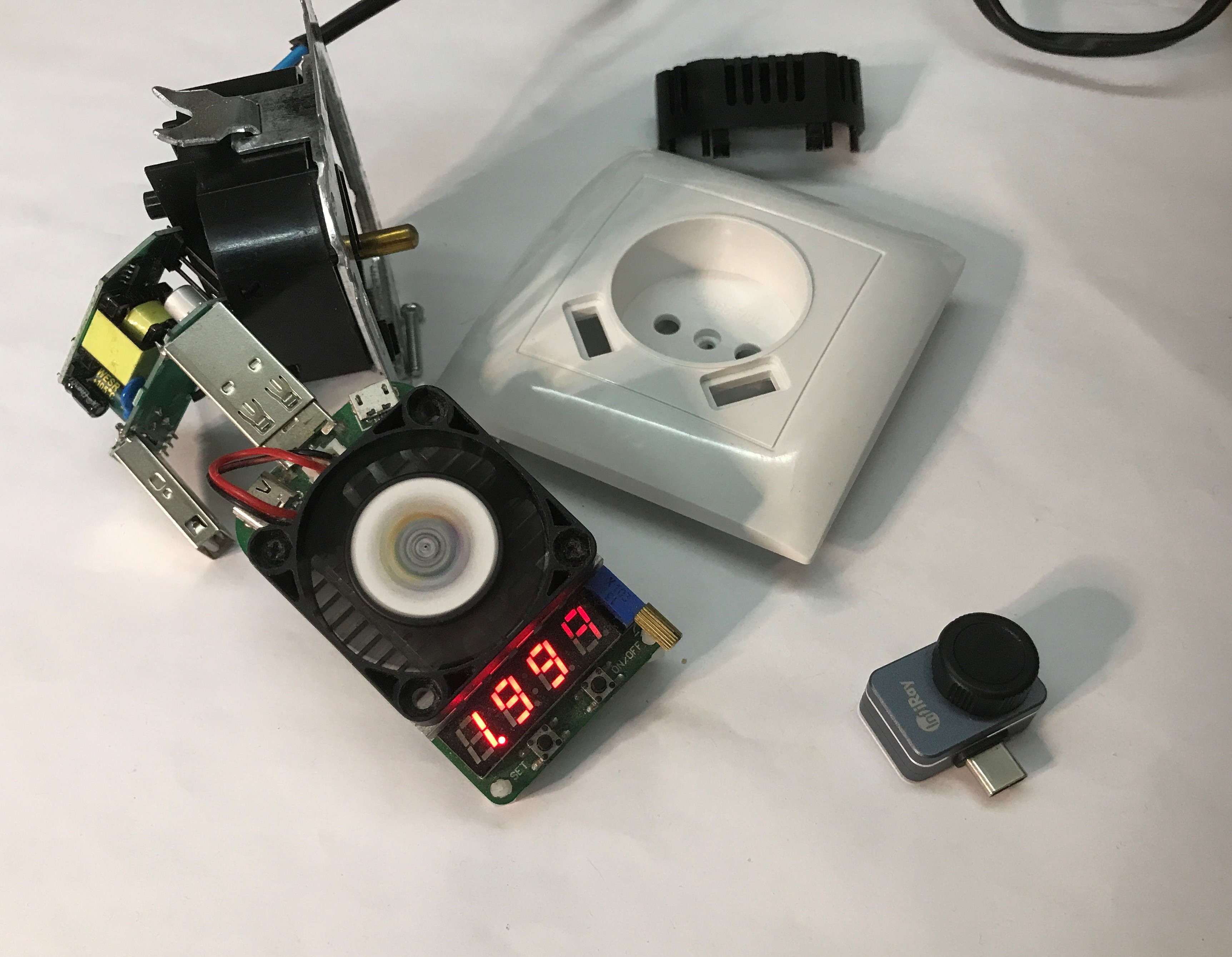

  • The LC-13-A flush-mounted single socket adds earthing and two USB charging ports in an 8.4×8.4 cm body that fits most fi 60 mm boxes.
  • Inside, two compact boards implement a flyback power supply with deep USB ports, a PL3368 inverter controller, and a 45R25P synchronous rectifier.
  • The USB output delivered up to 2.3 A at 5.1 V, while the transformer reached 70 °C and the controller hit 80 °C under load.
  • The socket works, but it gets quite hot, lacks QC support, and may run hotter in a real box than in the open test setup.
  • Its construction leaves only a few millimeters between the mains side and the low-voltage side, which raises concerns about cost-driven design.

The LC-13-A is a flush-mounted, single electrical socket with earthing and two additional USB ports for powering/charging mobile devices. Its dimensions (width 8.4x8.4 cm, depth 4 cm) allow it to be easily installed in most fi 60 mm boxes. In this topic, I will test how it is built and investigate how hot it will get when operating under full load. I'll show the results in the form of thermal imaging camera images, so we'll also see which components heat up the most.

The whole thing is cleverly built with two boards and deep USB ports. The manufacturer has made an effort to pack this efficiently into the available space.
Disassembled in-wall socket: white faceplate, module and PCB with transformer, plus loose screws on a table Disassembled power outlet module with a green PCB and two USB-A ports, held in a hand. Inside a USB wall outlet: two PCB boards and a yellow transformer in a black housing Inside a USB wall socket: two PCB boards with a transformer and capacitor, with a white faceplate in back
Inside is a small power supply in flyback topology. The PCB is signed LB1223-BDUSB, but you can't see the chip markings. This will need to be unsoldered.

Time for a load test. Up to 2.3 A at 5.1 V can be drawn:
Disassembled wall socket with USB ports and an electronic load module with fan and LED display
The thermal imaging shows nicely how even the warm air from the LD35 artificial load warms the table top:
Thermal image of an electronic PCB with a hot spot around 69.7°C and background around 20.5°C
Thermal camera view of electronics on a table; hotspot labeled about 70.0°C and a 19.2°C reading
Now the most interesting thing - the transformer heats up quite a bit, up to 70 °C, the inverter controller tops it, reaching 80 °C.
Thermal image of an electrical device with hotspots at 68.7°C and 52.8°C and a 21.9°C background Thermal image of device internals; hottest spot 77.2°C, background about 21.4°C. Thermal image of an electronic component with temperature readings 69.2°C, 25.8°C, and 24.3°C
In summary , the socket does its job, although the USB does not offer the QC standard support required by most modern devices and in addition it gets quite hot, potentially even hotter than my tests showed, as I tested with the case removed and outside the box. The construction inside is quite economical, I was a little concerned by the small distance between the mains voltage side and the low-voltage secondary. It was also interesting to see how the transformer is built, but I didn't want to dismantle it.

What is the claimed maximum current that can be drawn and is there any restriction on using both USB ports at the same time? [Read more]
p.kaczmarek2 13 Mar 2026 16:28
The product description mentioned 2.1 A at 5 V, so the USB power supply meets these parameters. Both USB sockets are connected together, so this current counts together. Once 2.3 A is exceeded, the voltage... [Read more]

I assume that infrared measurements are taken under load, but I am also curious about the power lost in idle operation. In these times of global "electro-saving", such sockets with an inverter operating... [Read more]
CosteC 16 Mar 2026 05:59
Is the USB connected to PE? GND or the connector housing? It doesn't look like it, and it affects the evaluation of the distance between the secondary and primary side. Is the mounting frame connected... [Read more]

Ok will be tested. If you have any other suggestions please let me know. What do you think is wrong there? [Read more]
CosteC 16 Mar 2026 19:49
Drawn as if in painter by a beginner: Each coil different Primary ground symbols are different Ground after secondary Capacitors with connected covers Capacitors unpolarised but polarised. Missing... [Read more]
Jacdiag 16 Mar 2026 20:42
Complementing the above post.... e.g. missing the most important element - the USB socket & some "loose" dots [Read more]
p.kaczmarek2 16 Mar 2026 20:55
"Loose" dots mark the start of the windings - it matters, you can't reverse wind. And the USB isn't there, because it's from the inverter controller's datasheet. As for the rest of the criticism, I'll... [Read more]
