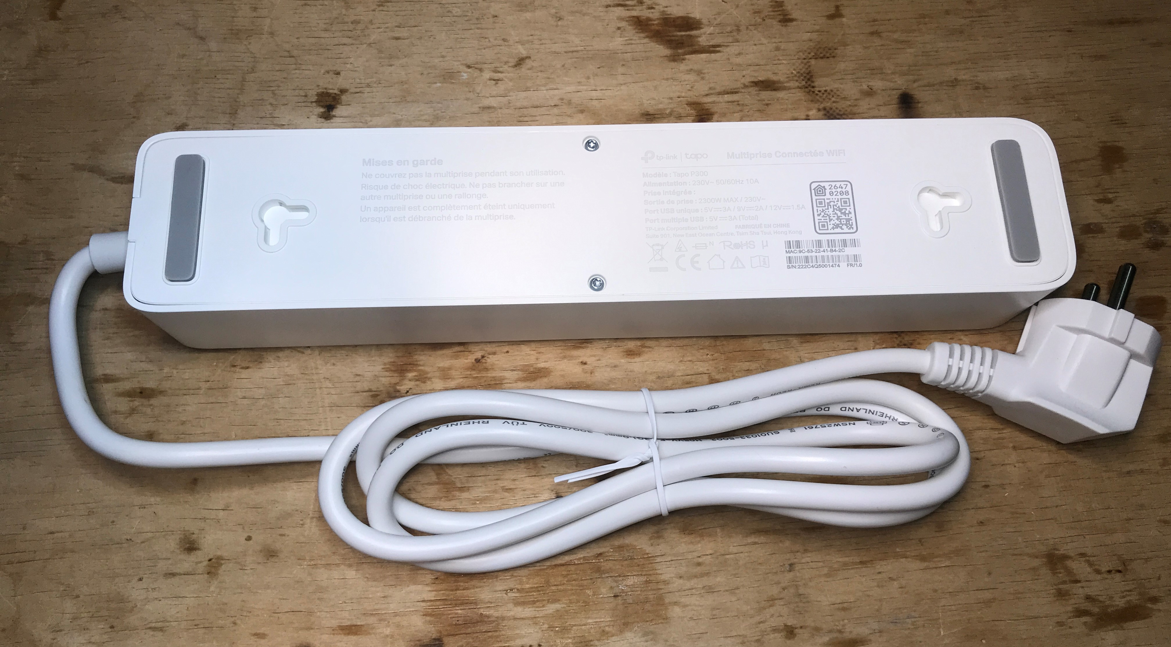

Did you know that TP-Link also has its own smart products? Here's the Tapo P300, a power strip offering three individually controllable 230-volt sockets and three USB sockets (with QC support), all together with an app and support for Apple Home, Amazon Alexa and Google Home. All bought for just PLN140....

The first impression is positive. The equipment looks solid. It has the option of hanging - horizontally or vertically. Access to the inside is protected by torx screws.
Bottom of a white smart power strip with QR code, screw, and keyhole mount on a wooden surface
Indeed, there is overcurrent protection on the side:
