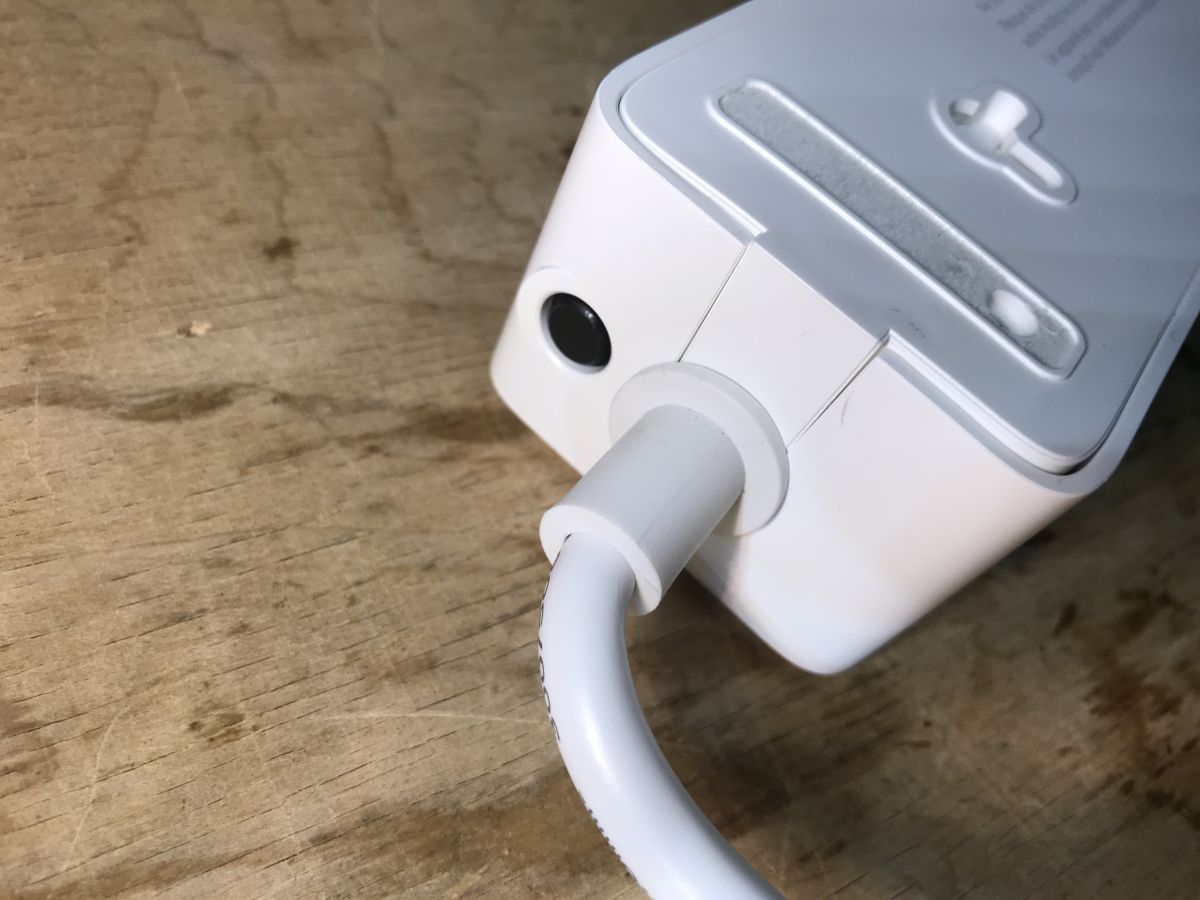

  • Bottom of a white TP-Link Tapo power strip with cord and plug on a wooden tabletop

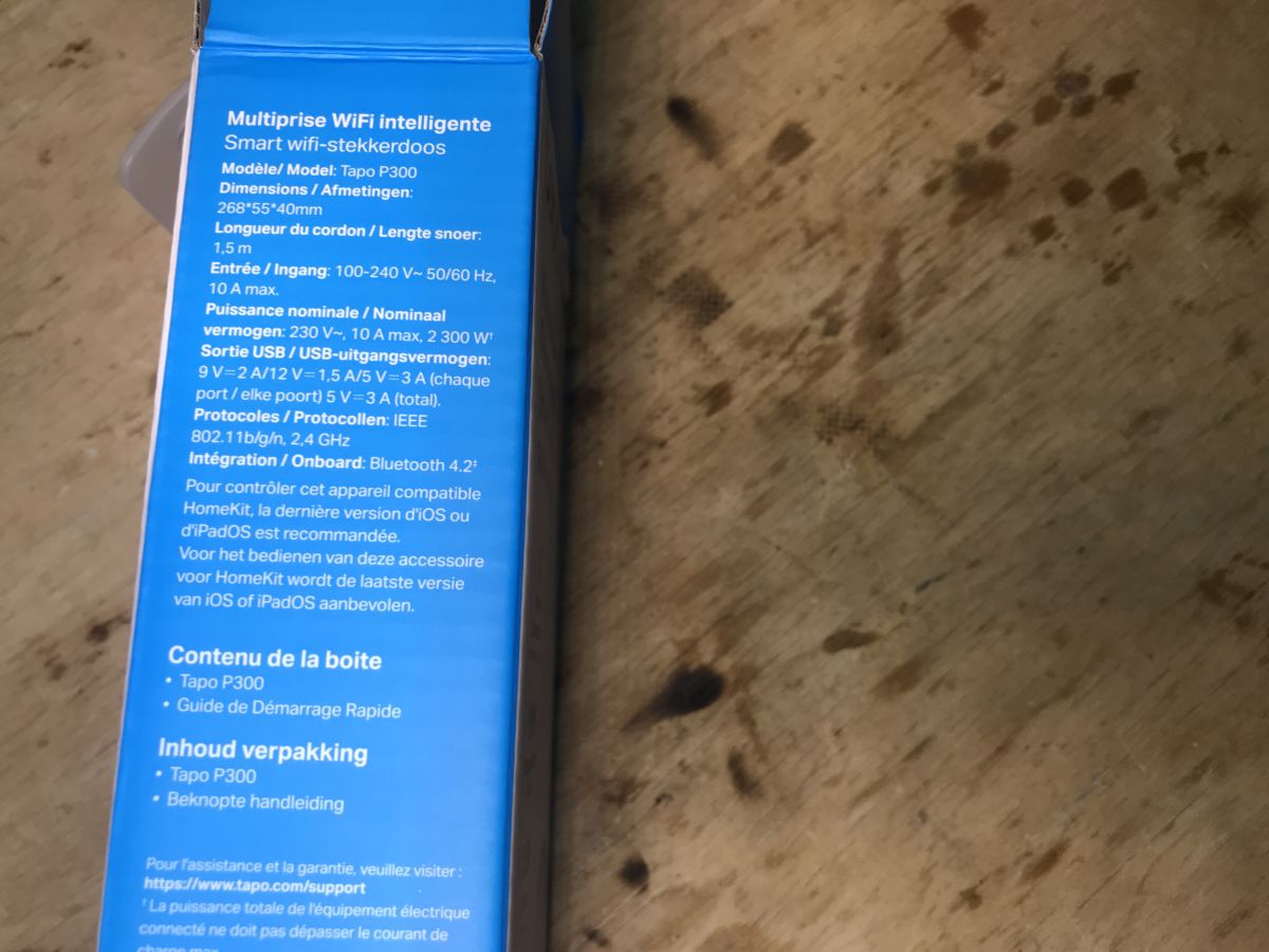

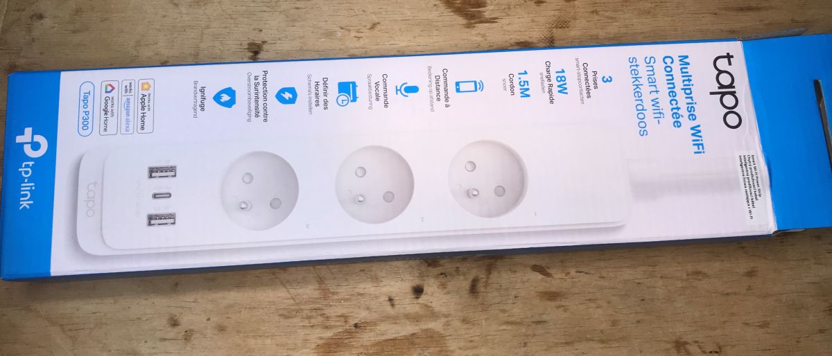

    Did you know that TP-Link also has its own smart products? Here's the Tapo P300, a power strip offering three individually controllable 230-volt sockets and three USB sockets (with QC support), all together with an app and support for Apple Home, Amazon Alexa and Google Home. All bought for just PLN140....
    TP-Link Tapo P300 smart Wi‑Fi power strip packaging with three sockets and USB ports on a wooden surface
    Side panel of the TP-Link Tapo P300 box with feature text, a QR code, and App Store and Google Play icons White power strip with three sockets and three USB ports on a wooden surface White TP-Link Tapo power strip seen from the bottom, with cable and plug on a wooden surface White TP-Link Tapo power strip seen from the bottom, with cable and plug on a wooden surface
    Side panel of a blue TP-Link Tapo P300 box showing specs text on a wooden tabletop
    Tapo power strip with three 230V sockets plus USB-A and USB-C ports, with labeled feature callouts.

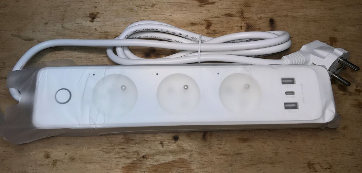

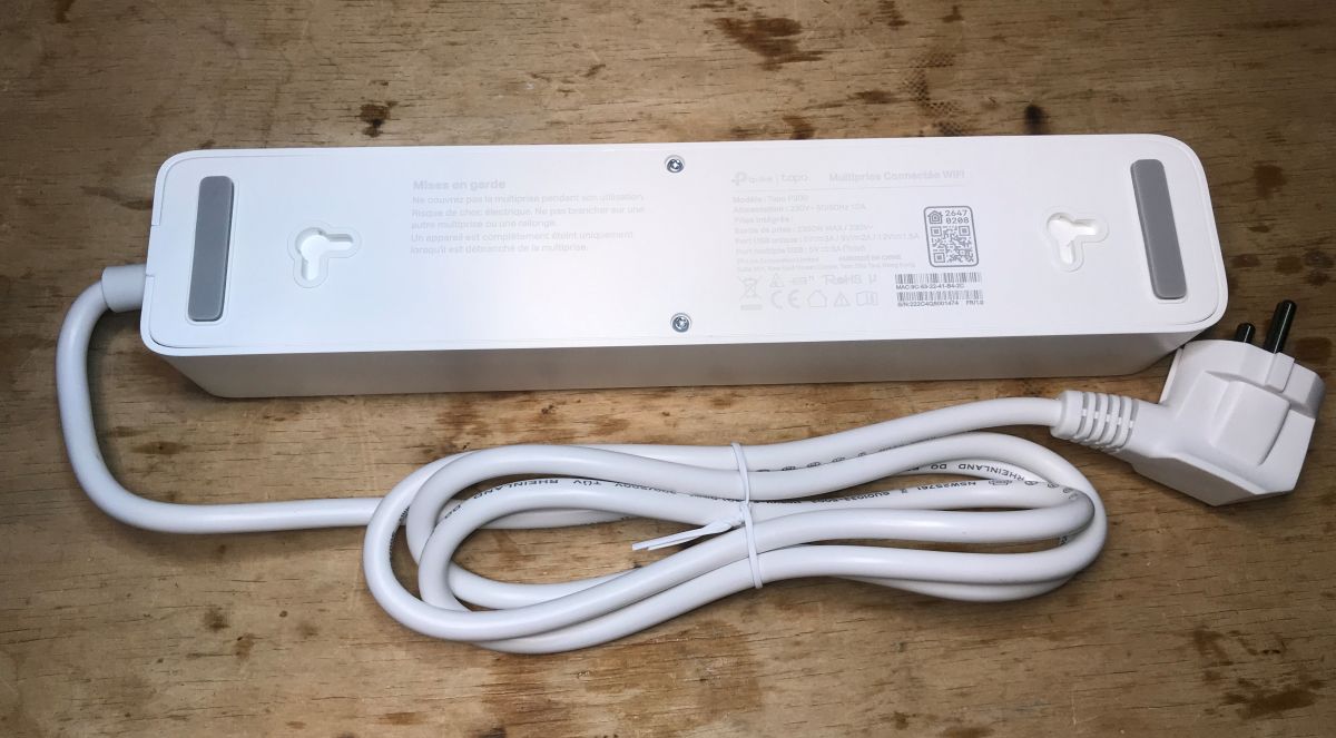

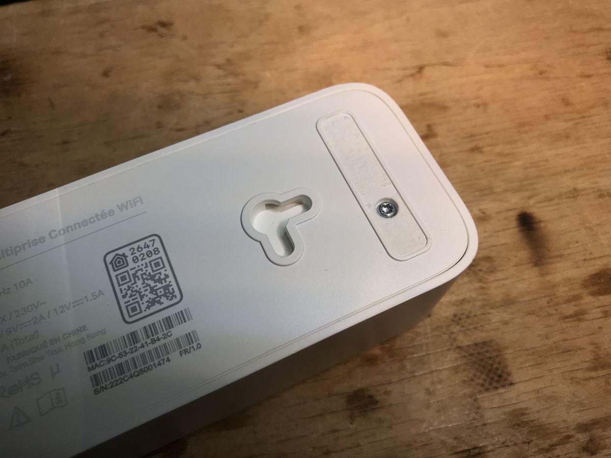

    The first impression is positive. The equipment looks solid. It has the option of hanging - horizontally or vertically. Access to the inside is protected by torx screws.
    Bottom of a white smart power strip with QR code, screw, and keyhole mount on a wooden surface
    Indeed, there is overcurrent protection on the side:

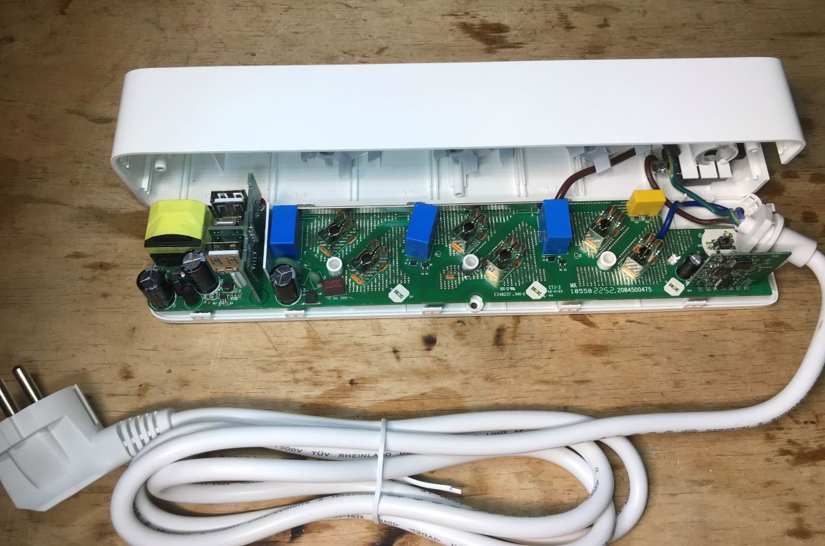

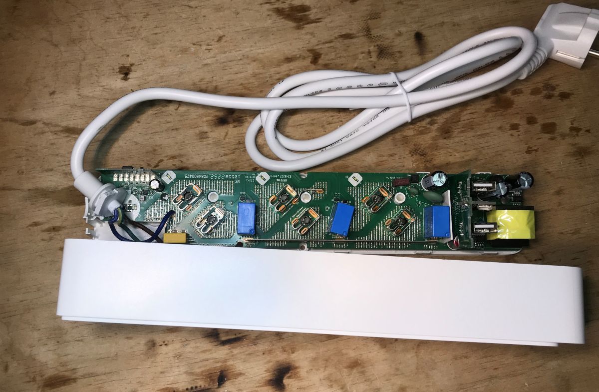

    The whole is based on one large PCB. From a distance you can see the relays and separately the section with the USB and Wi-Fi module.
    Inside a power strip: green PCB with relays, USB ports, and a coiled white power cord on a wooden surface Opened power strip showing PCB and attached power cord with plug on a wooden work surface

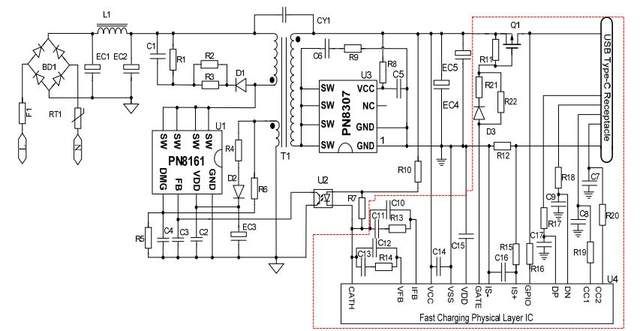

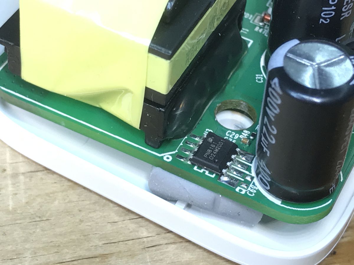

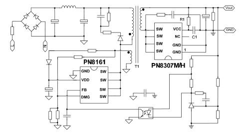

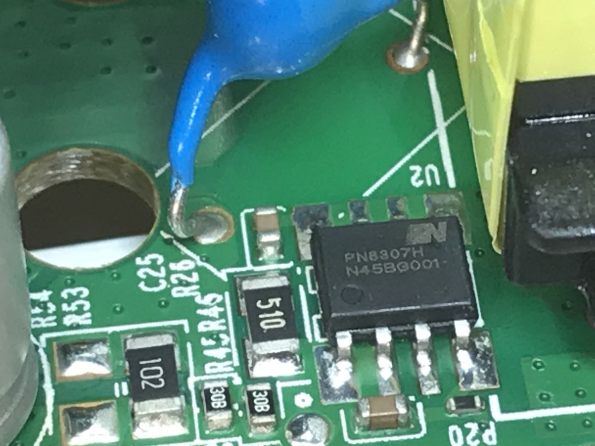

    The power supply section is based on the PN8161 and PN8307.
    Close-up of a PCB with a transformer, PN8161 IC, and a 400 V electrolytic capacitor Close-up of a PCB showing PN8307H IC, SMD parts, and a blue wire soldered to the board.

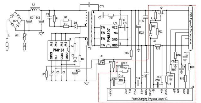

    The PN8161 is a flyback inverter controller with an integrated keying transistor. It requires a small number of components to operate. Feedback can be taken from the secondary side via an optocoupler. The PN8307 is a synchronous rectifier, it replaces the Schottky diode. It is based on a MOSFET transistor, so there are lower losses on it.
    Block diagram of a flyback power supply using PN8161 and PN8307MH ICs
    However, the above schematic does not take into account the QC standard, because it still allows the powered device to negotiate a higher voltage. Let's look at another diagram:
    Circuit diagram of a power supply and QC fast-charging section, with the “USB port & regulate” block highlighted.
    This already illustrates the situation a little better. Here we have a circuit plugged in behind the power supply, which communicates via USB with the device and controls the voltage via an optocoupler. The increased voltage cannot be switched on all the time, as it may damage some devices that do not support it.

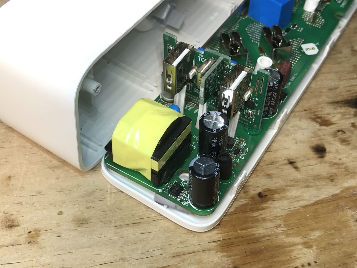

    There are additional circuits on the board with the USB ports, probably just for this:
    Inside a power strip: PCB with yellow transformer, capacitors, and USB ports in a white housing
    This explains my oft-verified observation - when powering one device via QC and connecting another at the same time, the voltage drops to 5 V. This is also the case in powerbanks.

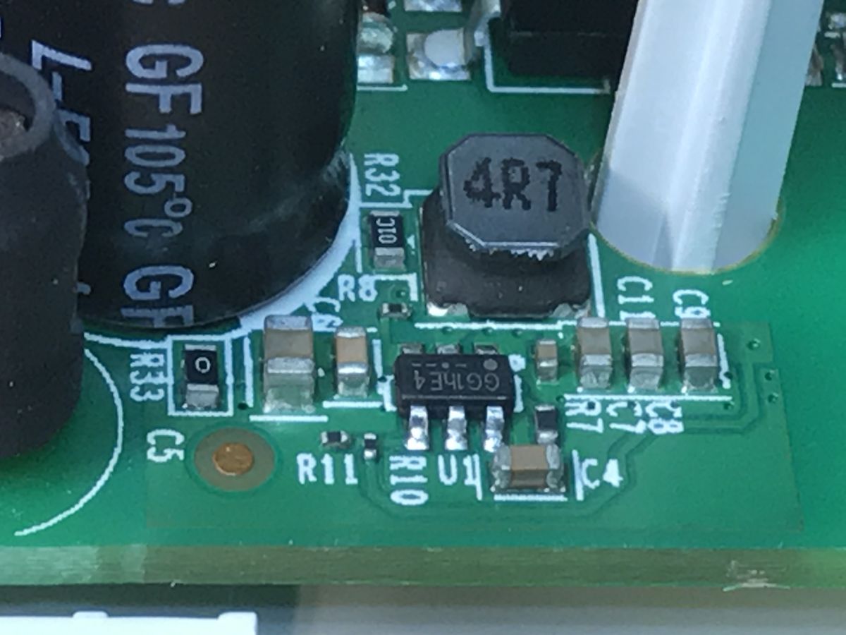

    In addition, I see a small inverter in the same section separately:
    Close-up of a PCB section with a 4R7 inductor, a 6-pin IC, and electrolytic capacitors
    This could be the power supply for the Wi-Fi module.

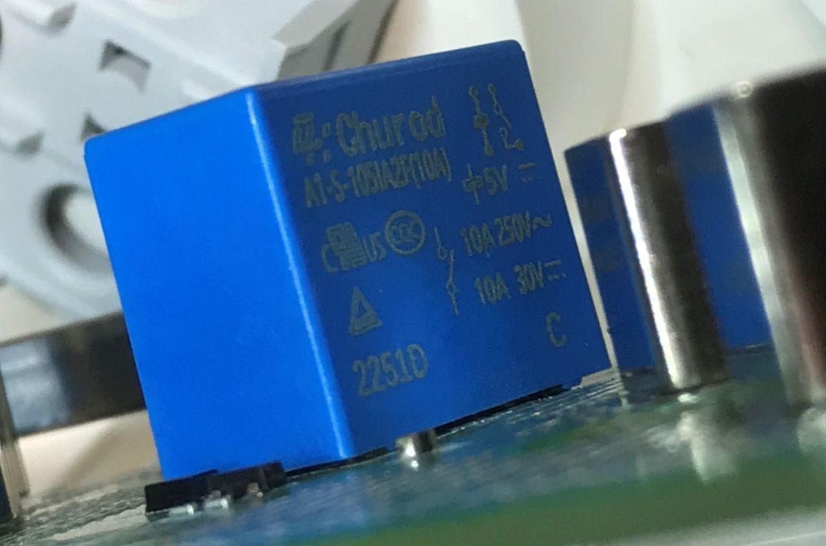

    Executive section - relays for 5V, A1-S-105IA2F(10A).
    Close-up of a blue “Churod” relay on a PCB next to a silver metal shield. Close-up of a green power strip PCB with three blue relays and metal socket contacts in a white housing Inside a power strip: green PCB with wires, metal contacts, and a small daughterboard with chips

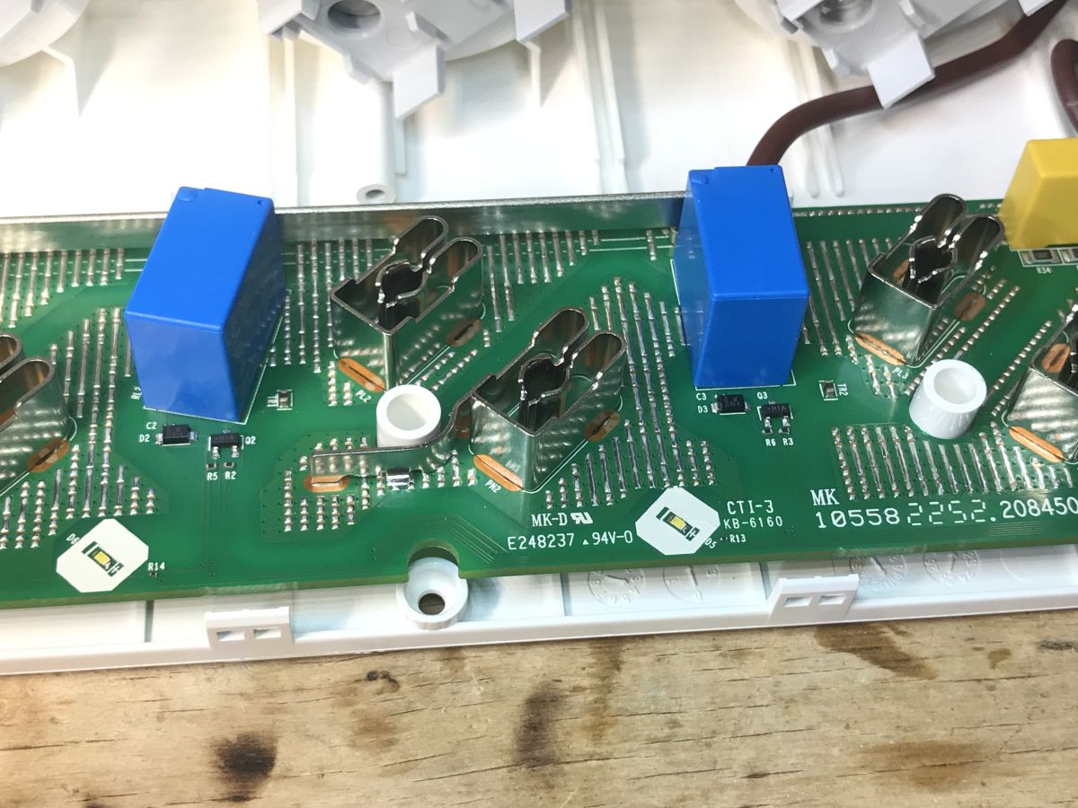

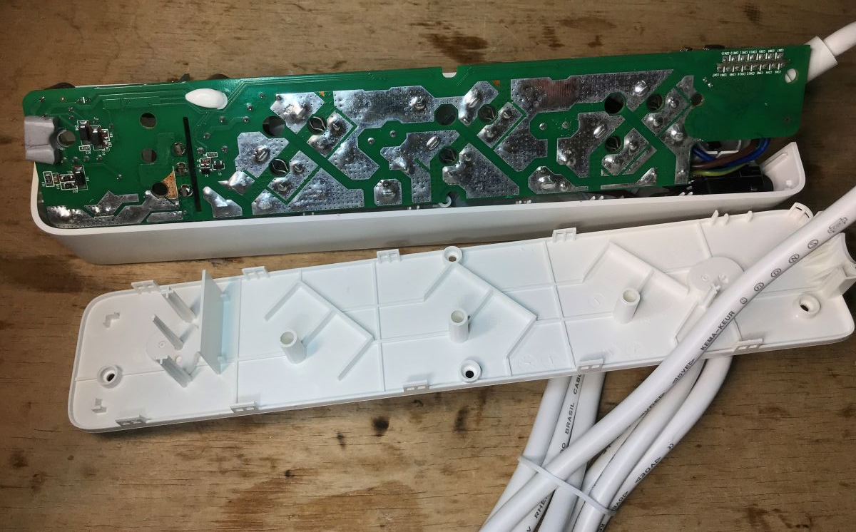

    The tracks on the underside are tinned, so they can carry more current:
    Opened power strip with a long green PCB and white housing on a wooden workbench

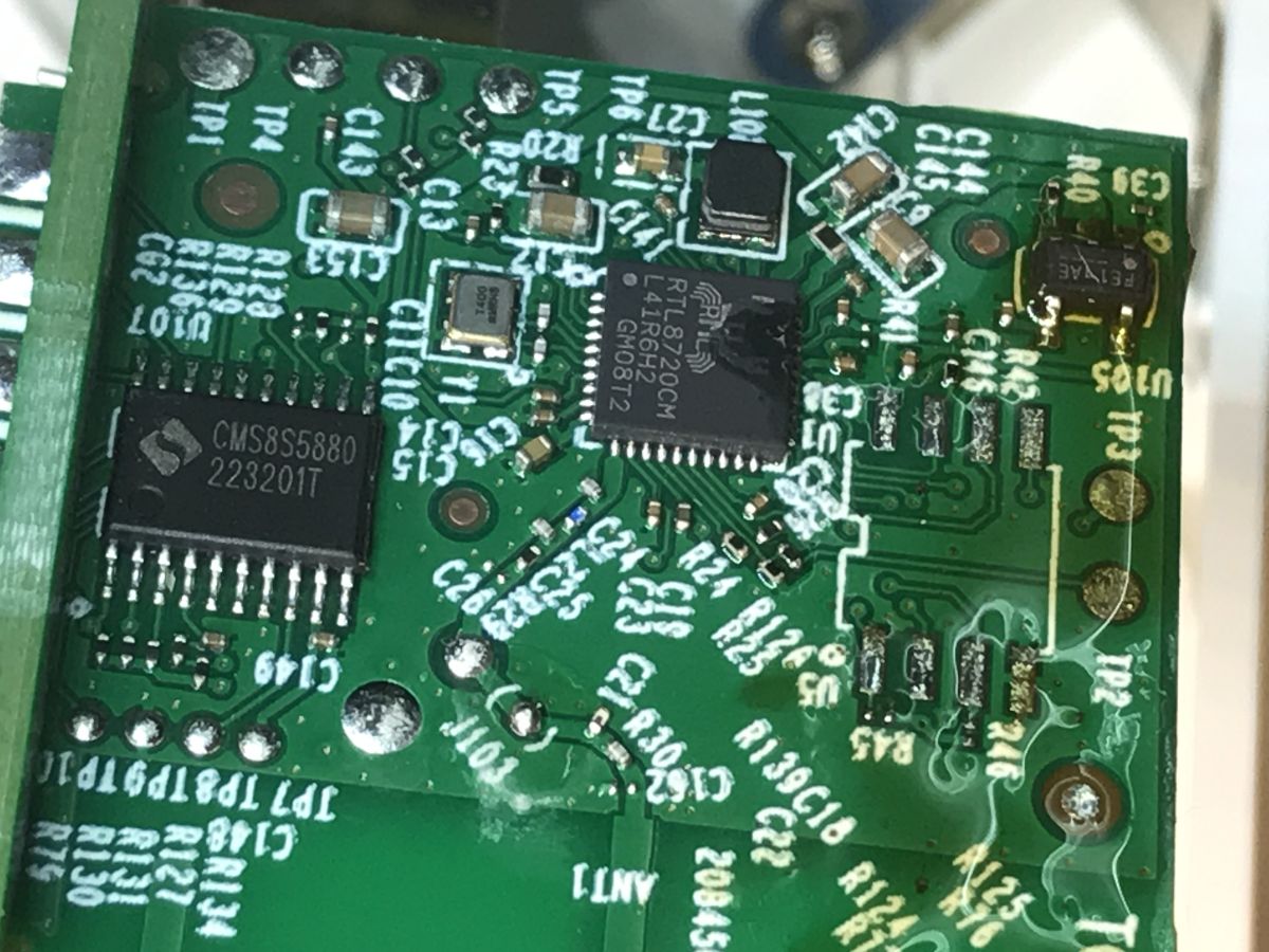

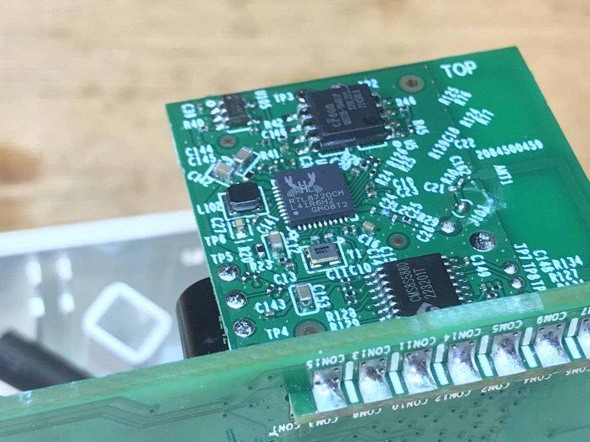

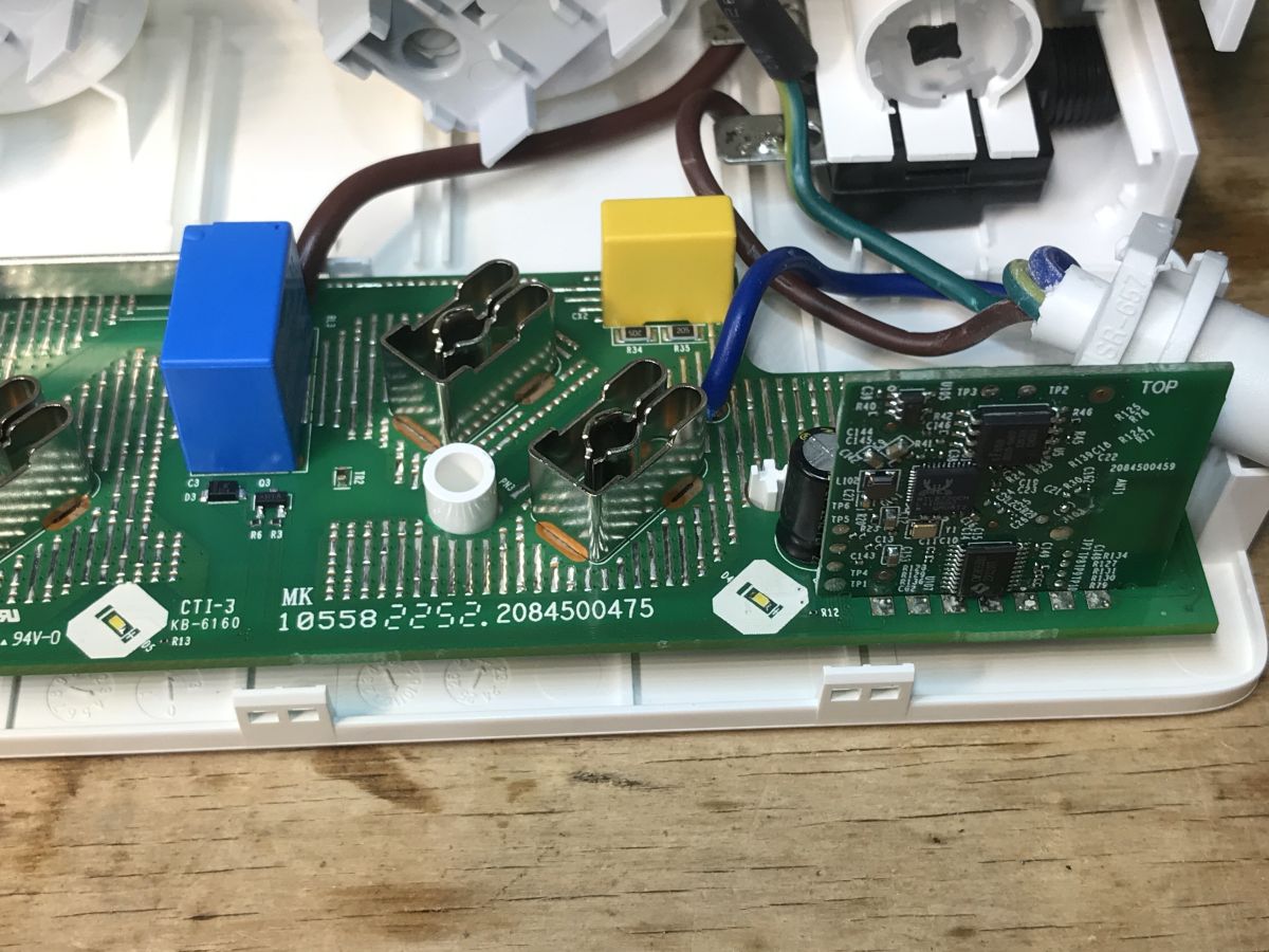

    The section with the Wi-Fi module remains.
    Close-up of a green PCB with a Realtek RTL8720CM chip and SMD components
    Here we have an RTL8720CM SoC, an external Flash memory connected to it via SPI and a small CMS8S5880 microcontroller.
    The RTL8720CM is supported by OBK , but this microcontroller complicates things.

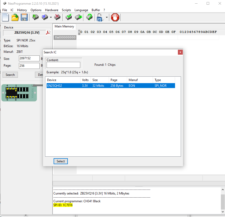

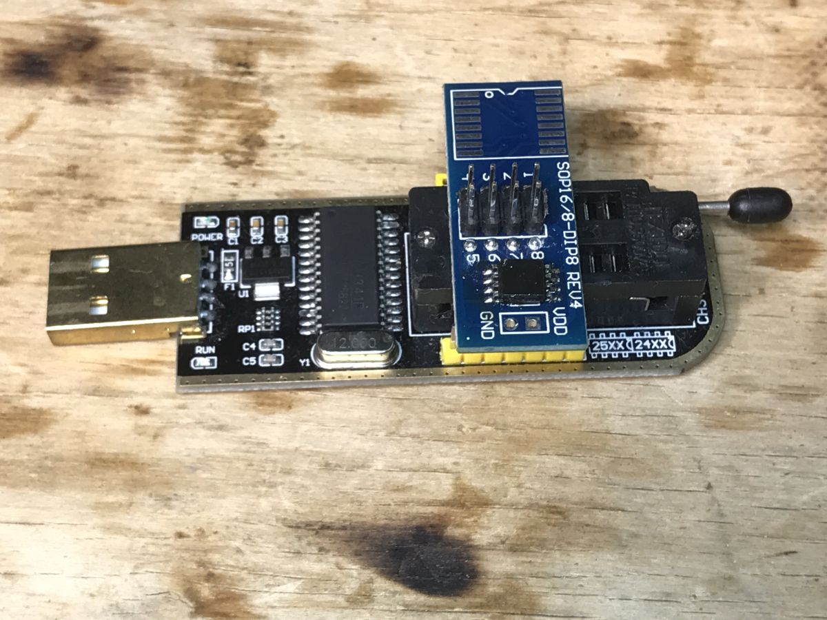

    I decided to rip the flash memory:
    Close-up of a green PCB with RTL8720CM and CMS8S5880 chips and various SMD components
    I use the CH341 and the NeoProgrammer for this:
    USB programmer with SOP16/8-DIP8 adapter board on a wooden surface
    NeoProgrammer screenshot with “Search IC” window showing detected EN25QH32 memory chip
    Memory is EN25QH32, 32 megabits.
    Backup:
    https://github.com/openshwprojects/FlashDumps/commit/06ed33f56a389ae71ad3d41bdb4736b5fa980b51
    An interesting subtitle from Flash:

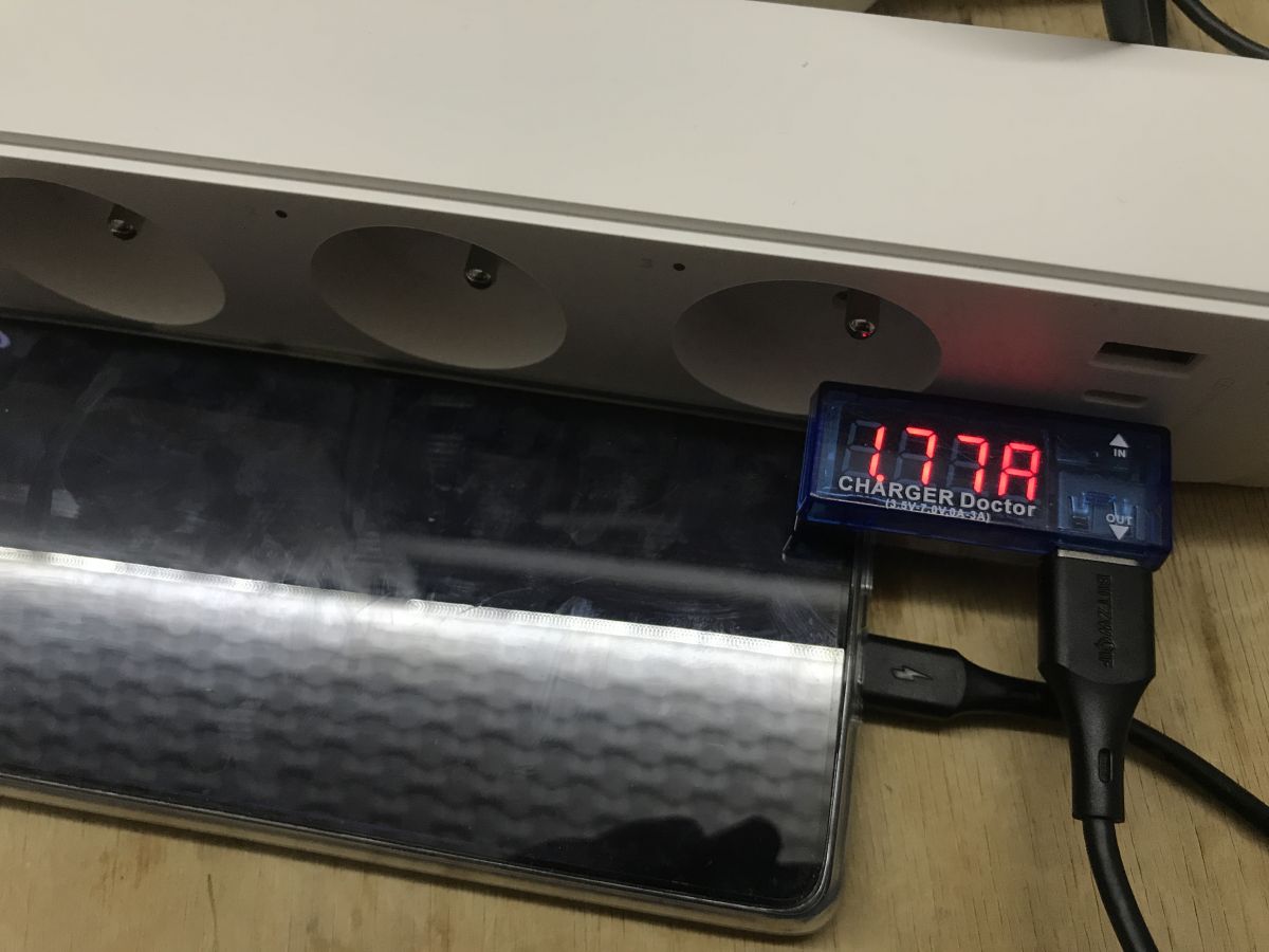

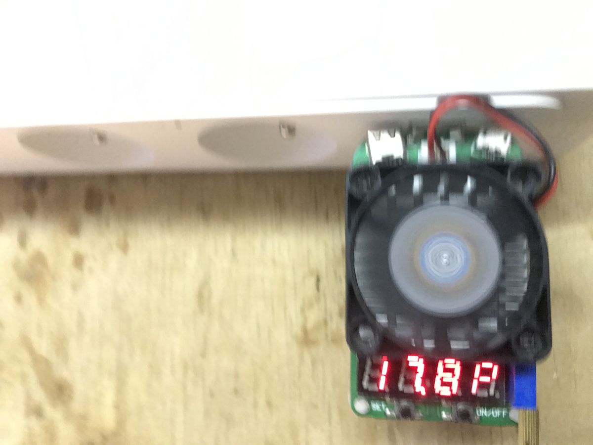

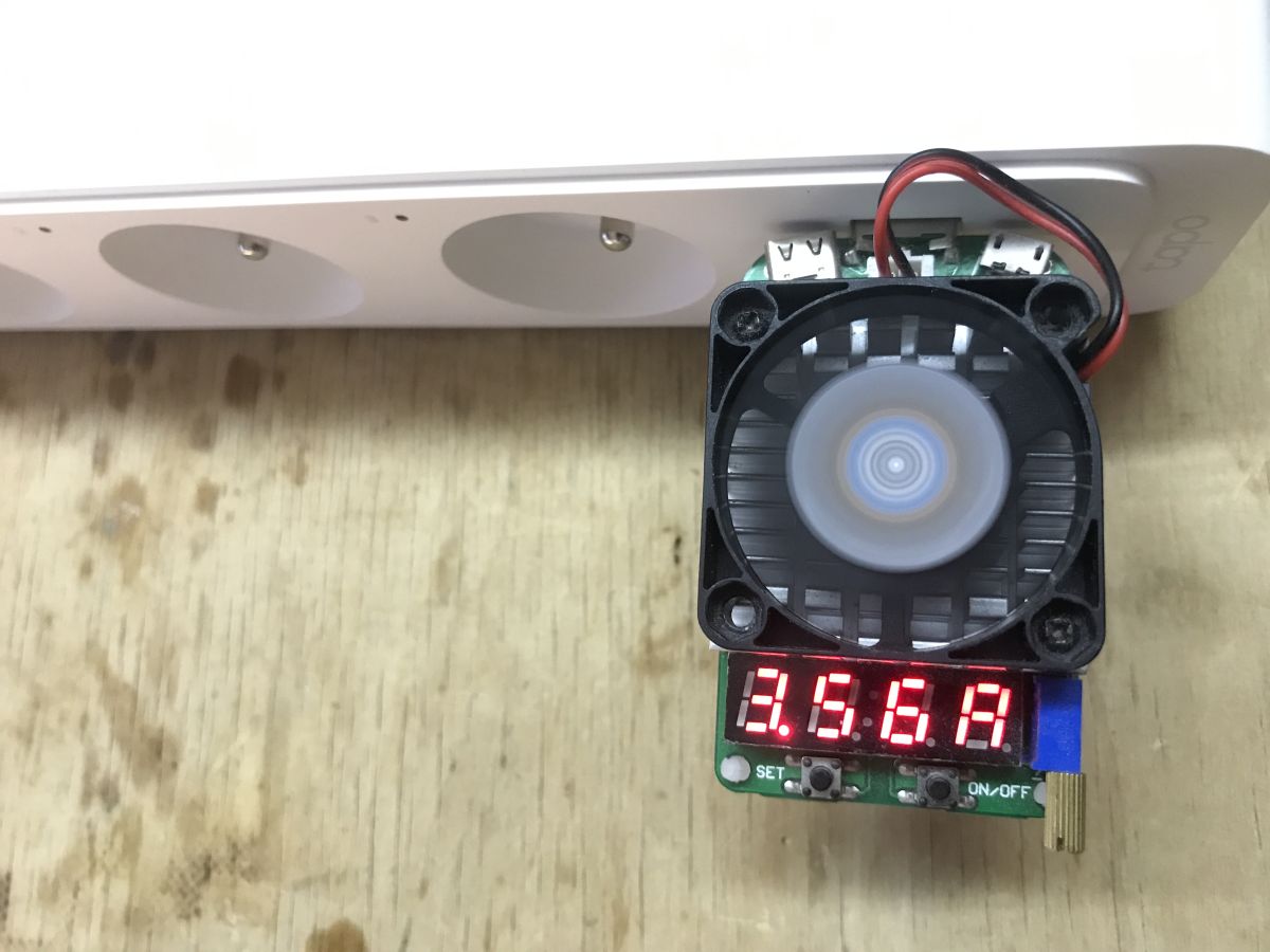

    It remains to check the performance of the ports.
    At 5 volts it is possible to draw more than 3.5 amps:
    Inside a power strip: small fan on a PCB and a red LED segment display Small fan on a PCB module with a red LED display and connected wires
    Xiaomi draws less than 2 A at 9 V:
    Power strip with a “CHARGER Doctor” USB meter plugged in, showing 1.77 A
    Undoubtedly, the QC works and the product meets the promised performance.
