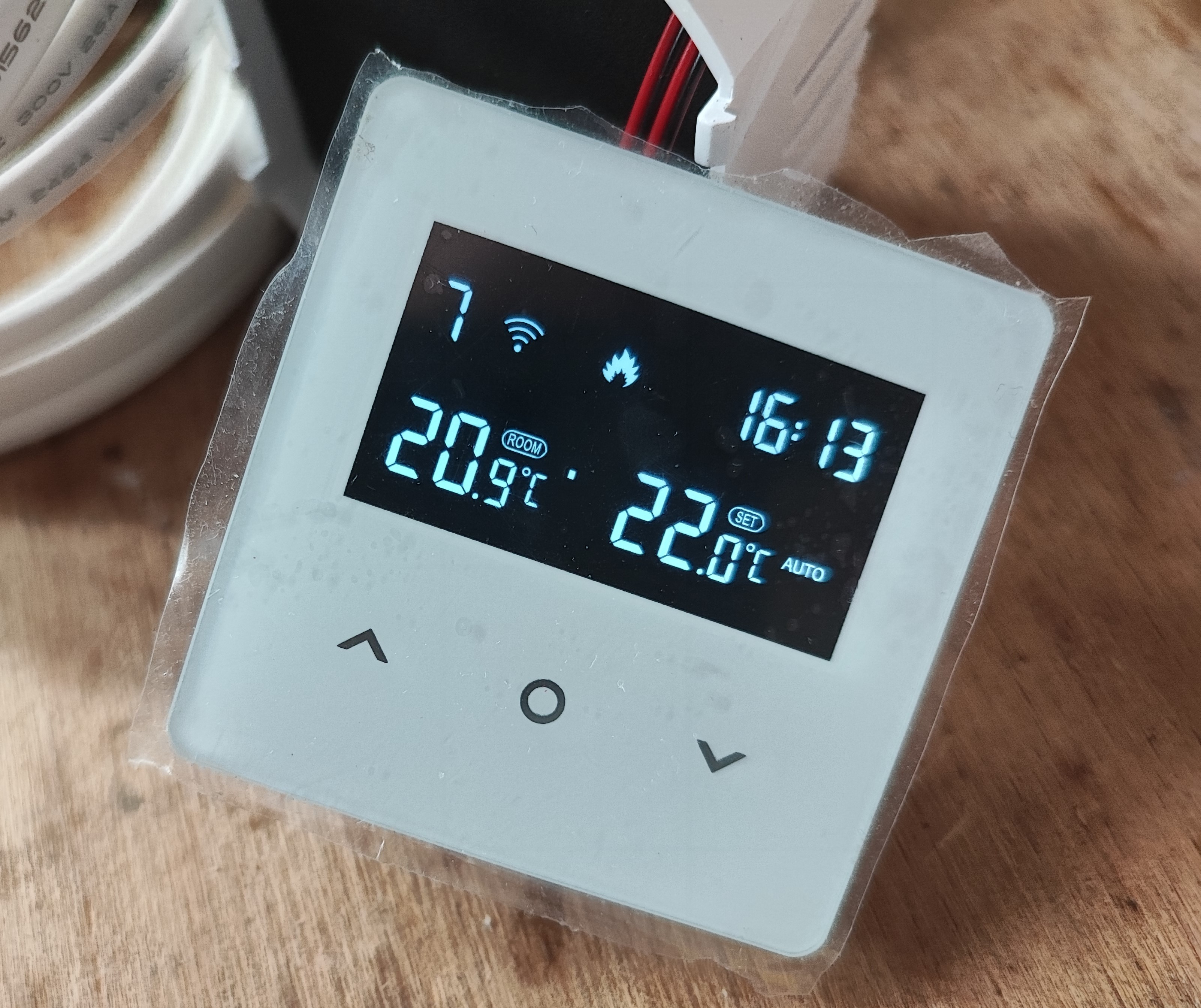

  • WT200-16A-W is a Tuya-compatible WiFi thermostat with manual control, 5+2/6+1/7-day schedules, six daily periods, and an optional external temperature probe.
  • Inside, it uses a TuyaMCU design: a separate WBR3 WiFi module and MCU talk over UART, with an RTCC chip, quartz, and battery preserving time during power loss.
  • Captured packets mapped key dpIDs: 1 on/off, 2 target temperature, 3 current temperature, 4 operating mode, 105 weekly schedule, and 107 workday pattern.
  • Tuya pairing worked easily over Bluetooth, and the thermostat looks suitable for future local firmware flashing and Home Assistant integration.
Thermostat with black display showing 20.9°C and 22.0°C plus a Wi‑Fi icon
I would like to invite you to a presentation and a detailed analysis of the interior of the WT200-16A-W thermostat compatible with the Tuya app. The WT200-16A-W offers manual control via WiFi and schedule operation in 5+2, 6+1 or 7-day modes, with 6 time modes per day. The WT200-16A-W is available to buy for around 150PLN and works with an external probe. Let's take a look at what we get in the kit.
