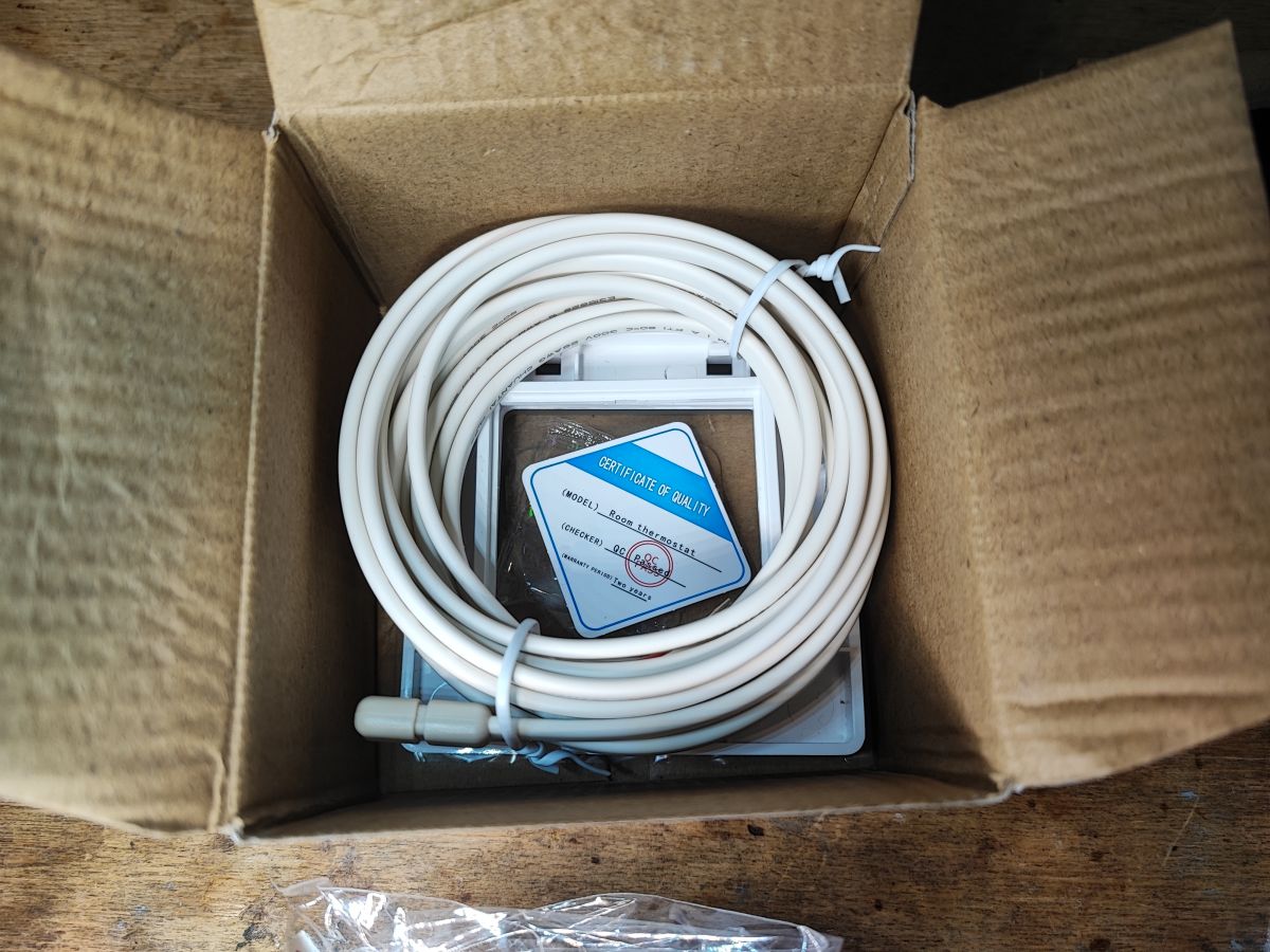

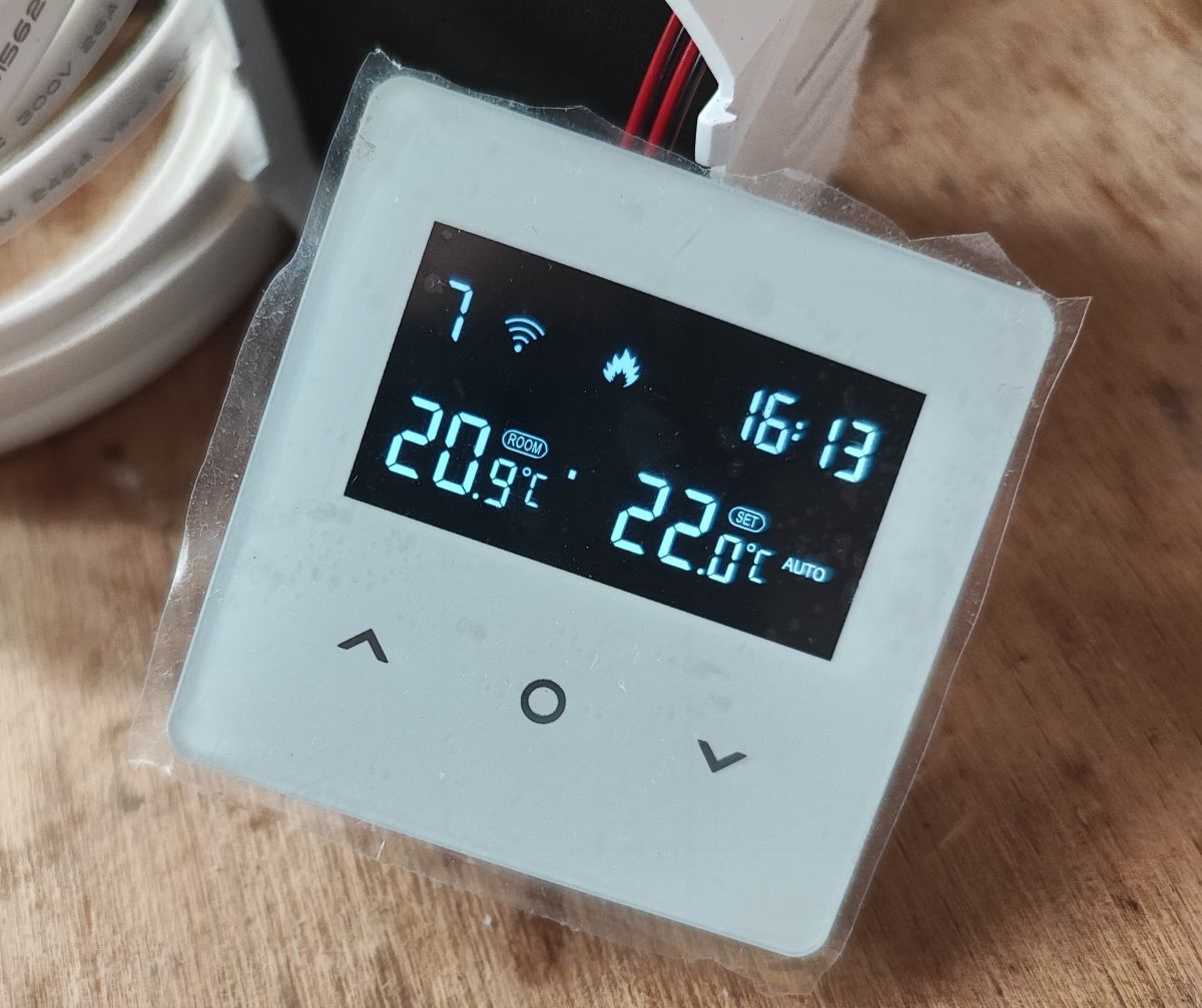

    I would like to invite you to a presentation and a detailed analysis of the interior of the WT200-16A-W thermostat compatible with the Tuya app. The WT200-16A-W offers manual control via WiFi and schedule operation in 5+2, 6+1 or 7-day modes, with 6 time modes per day. The WT200-16A-W is available to buy for around 150PLN and works with an external probe. Let's take a look at what we get in the kit.

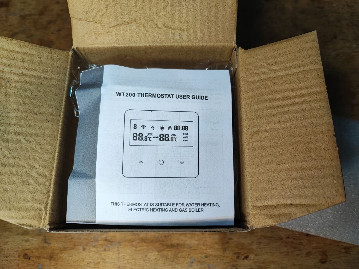

    White AVATTO product box with a thermostat LCD display graphic on a wooden surface “WT200 Thermostat User Guide” booklet inside an open cardboard box White mounting part in a cardboard box; plastic bag with two blue screws and a piece of metal mesh Open box with a coiled white cable and a device in plastic marked “Certificate of Quality” Open box with a coiled white cable and a device in plastic marked “Certificate of Quality”

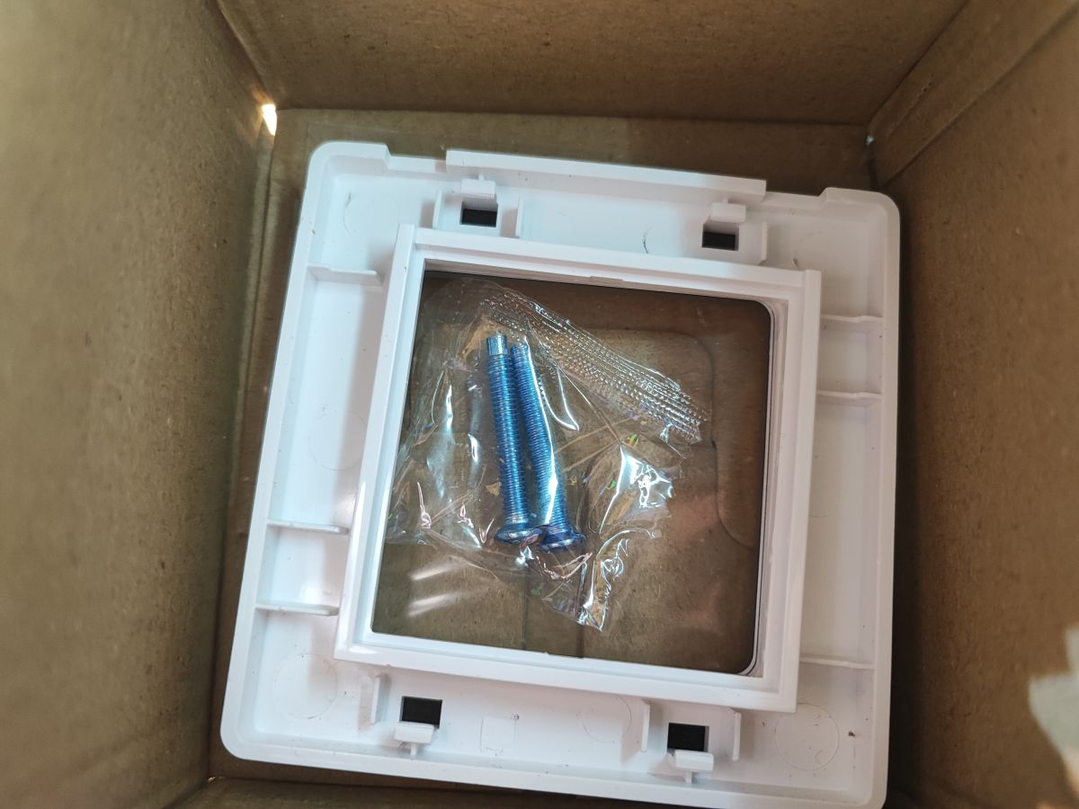

    In this case, the front of the product is fully removable. You can get it in a variety of colours - I've seen copies in black and white. An external sensor is also included, although its use is optional.

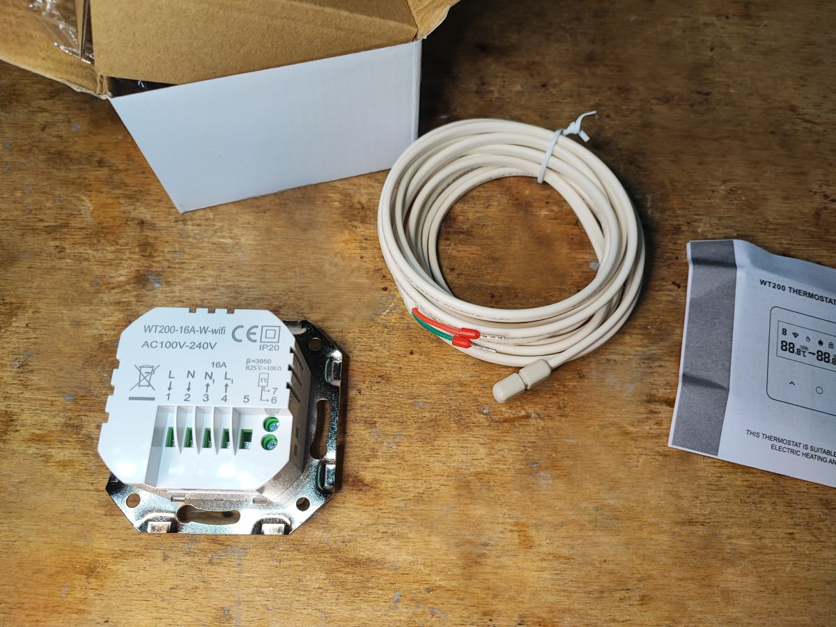

    WT200-16A-W-wifi thermostat base with terminals, coiled wired sensor, and manual on a wooden table
    Included in the kit is an English-language manual for pairing and operating the thermostat. Below are clear pictures of it - I won't repeat the information contained therein too closely.
    Unfolded English “WT200 Thermostat User Guide” photographed from above on a wooden surface Photo of a folded “THERMOSTAT USER GUIDE” sheet with a QR code and app setup phone screenshots

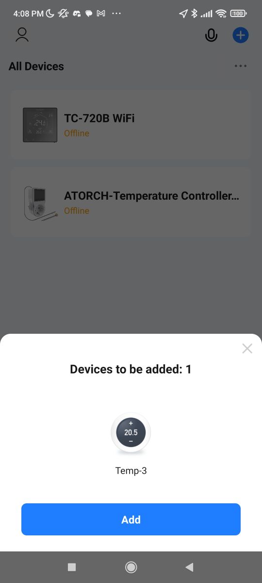

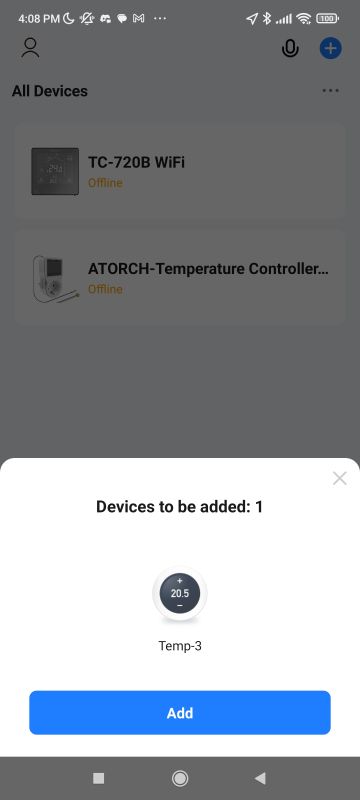

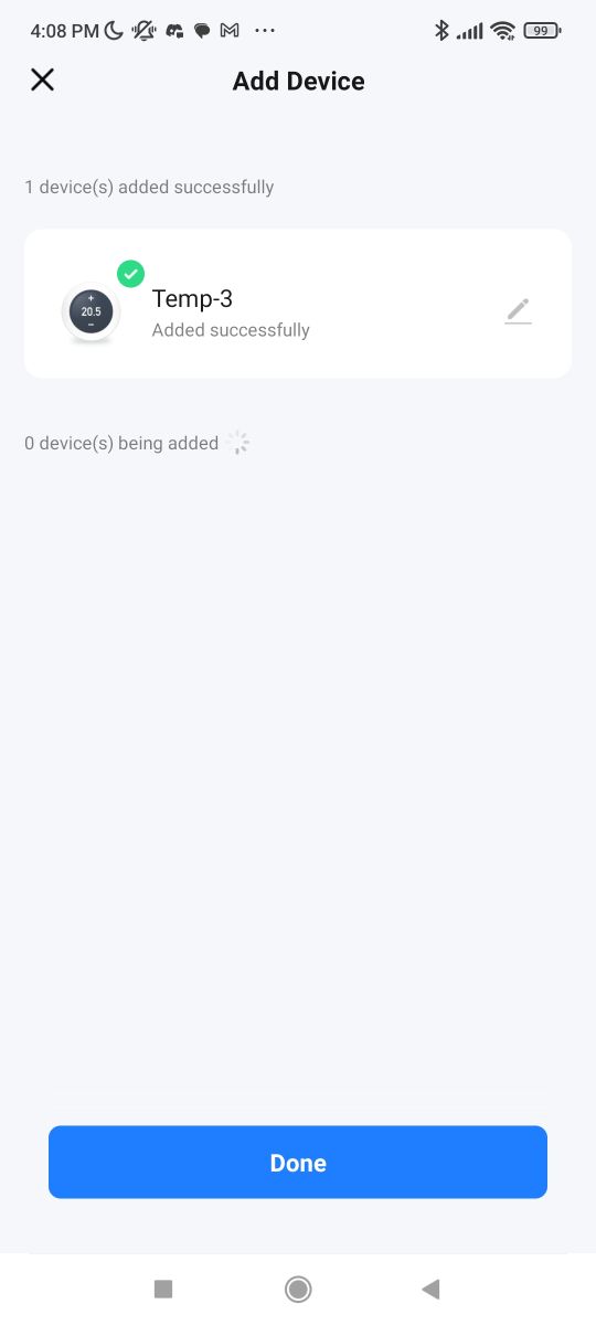

    Test with Tuya app
    For many IoT products I often change the firmware straight away and don't even pair it with Tuya, but here I was curious to see what it all looks like. Additionally, I need this to analyse the communication protocol, which I will include in the following paragraphs.
    Pairing was very straightforward - the phone sees these devices by Bluetooth alone:

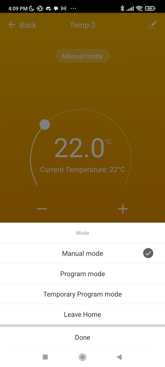

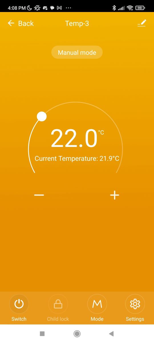

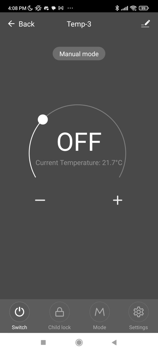

    Once paired, we are greeted by the manual mode, or so-called 'manual mode'. It simply allows us to manually set the target temperature we want the thermostat to aim for. The thermostat also gives us a live view of the current temperature from the sensor.
    Tuya app screen in manual mode showing OFF and current temperature 21.7°C Tuya thermostat app screen: Manual mode, setpoint 22.0°C and current temperature 21.9°C
    Of course, there are many more options. The mode button, or 'mode', is used for this. There, we have the aforementioned manual mode, program mode, temporary program mode and leaving the house (in which case heating is switched off or heavily reduced - antifreeze).
    Tuya app screenshot: 22.0°C temperature screen with mode menu (Manual, Program, Temporary, Leave Home)

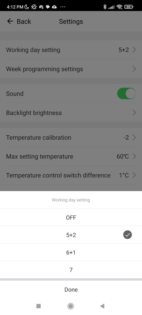

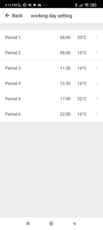

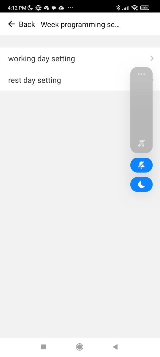

    The weekly format (6+1, 5+2, etc.) is selectable in the options - this is where you create the programmes.
    App settings screen with thermostat options like 5+2 schedule, calibration, temperature limits, and external sensor selection App screen for week programming settings with “working day setting” and “rest day setting” options.

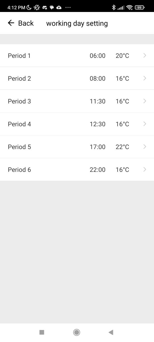

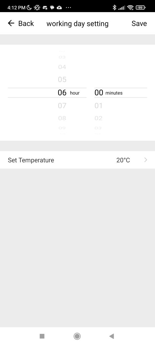

    The screenshot below shows the aforementioned heating periods. We select an hour and set the temperature that will be implemented at that hour.
    App screen “working day setting” showing six periods with times and temperatures App screen for schedule settings: 06 hours, 00 minutes, and “Set Temperature” 20°C
    Available weekly modes are 5+2, 6+1, 7 or none:
    App settings screen showing “Working day setting” with 5+2 selected

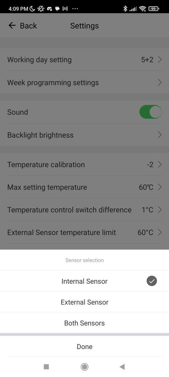

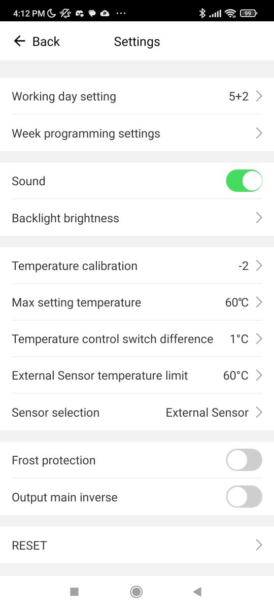

    The options also include calibration and probe selection (external, internal):
    “Settings” screen in an app with thermostat options and sensor selection: internal, external, or both

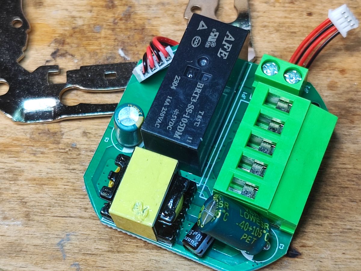

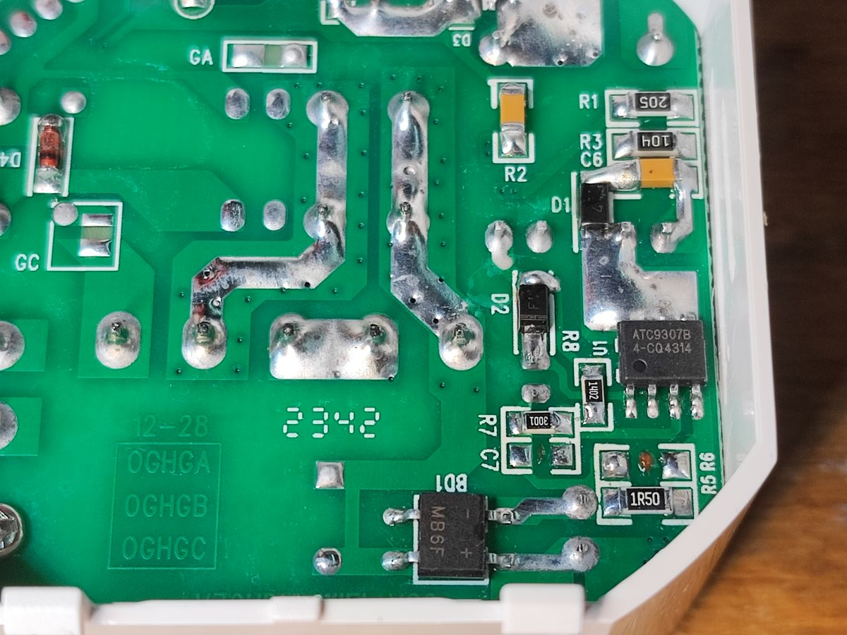

    The ATC9307B and ATC9200DF can be seen on the power supply board. Just by the positions of the components I am betting that the first component is a flyback converter controller with an integrated keying transistor and the second is either an LDO or a synchronous rectifier. Perhaps someone can find more information?
    Close-up of a power PCB showing ATC9307B IC, wide soldered traces, and SMD components
    On the other side of the board you can see the pulse transformer from the inverter and the relay - BRT3-SS-105DM:
    Close-up of a circuit board with a relay and green screw terminal block on a wooden surface

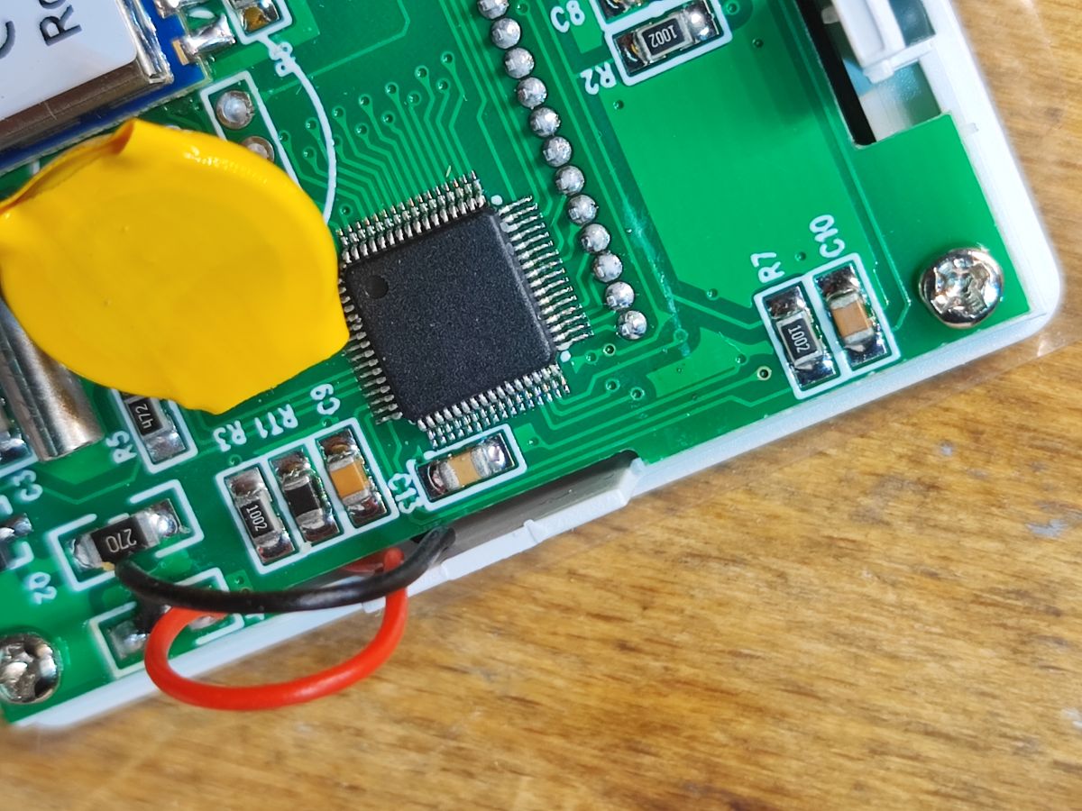

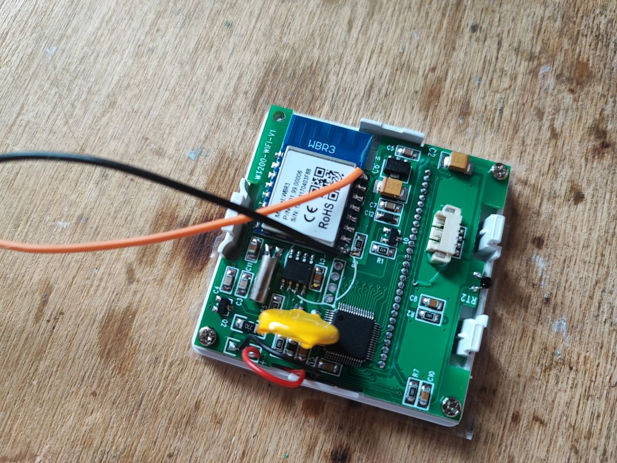

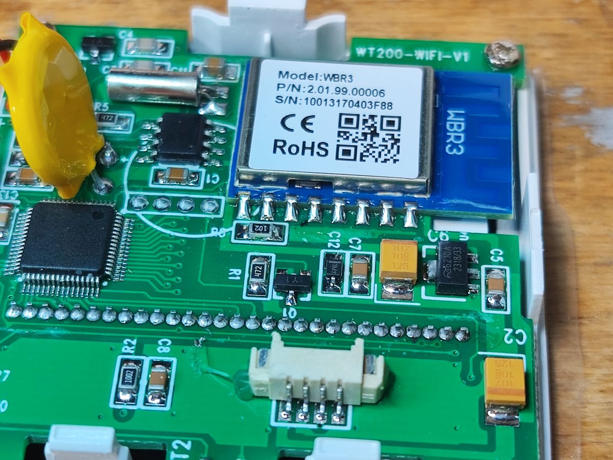

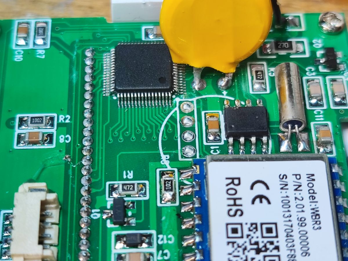

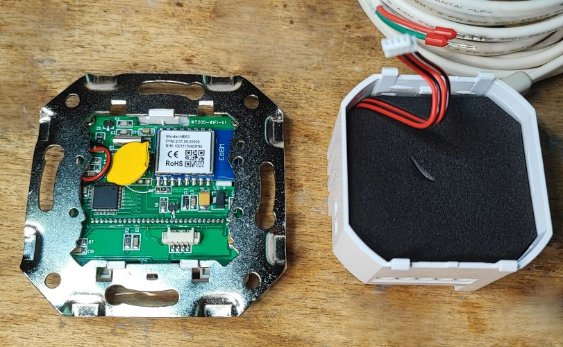

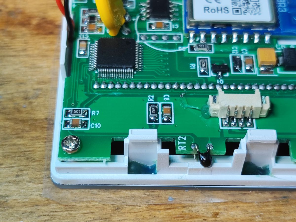

    On the second board we have the MCU and separately the WBR3 WiFi module for communication.
    Close-up of thermostat PCB showing WBR3 Wi‑Fi module, MCU chip, and SMD components Close-up of a PCB with an IC chip, yellow battery cover, and red/black wires inside a casing Close-up of a thermostat PCB with an IC, shielded module, and white connector inside a plastic housing
    You can also see the distinctive RTCC (RealTime Clock Calendar) chip in the SO8 housing, along with the watch quartz and battery from the sustainer.
    Close-up of a PCB with WBR3 Wi‑Fi module, IC chip, and a yellow disc capacitor

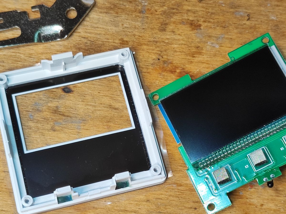

    On the other side of the board is just the soldered-on LCD with buttons:
    Disassembled thermostat panel: white bezel with window and a PCB with an LCD on a wooden table
    PCB designation: WT200-WiFi-V1
    Thermostat PCB with WBR3 Wi‑Fi module and connected wires on a wooden surface
    A few words about the internal structure
    The WBR3 module is based on the RTL8720CF chip - its batch can be changed to an open source solution.

Key insight: The WT200-16A-W is not a monolithic Wi‑Fi thermostat. It uses a separate WBR3 Wi‑Fi module and a main MCU that exchange settings over UART, so successful local control depends on decoding dpIDs correctly.
  • Approximate price is £150, and the thermostat supports an external probe in addition to its built-in sensing options. [#21877759]
  • Scheduling supports 5+2, 6+1, 7-day, or no schedule, with 6 time modes per day. [#21877759]
  • The target temperature uses scaled values in Tuya packets, so 21.0°C = 210 and 42.5°C = 425. [#21877759]
  • The hardware is split into two boards: a power board with a BRT3-SS-105DM relay and a front board with LCD, MCU, WBR3 Wi‑Fi, RTCC, watch crystal, and backup battery. [#21877759]
  • Captured UART traffic used an isolated USB-to-UART adapter with ADUM1201 isolation modules, and RX→TX plus TX→RX were logged separately from the Wi‑Fi module side. [#21877759]
How do you pair the WT200-16A-W thermostat with the Tuya app over Bluetooth and Wi‑Fi?
You pair it by putting the thermostat in pairing mode and letting the phone discover it over Bluetooth first. The thread says pairing was very straightforward, and the phone saw the device by Bluetooth alone before app control became available. After pairing, the Tuya app exposed manual mode, program mode, temporary program mode, and leave-home functions over Wi‑Fi-linked control. [#21877759]
What operating modes does the WT200-16A-W support in the Tuya app, including manual, program, temporary program, and leave-home mode?
The WT200-16A-W supports four app modes: manual, program, temporary program, and leave-home. Manual mode lets you set the target temperature directly while viewing live sensor temperature. Program mode follows the weekly schedule, temporary program mode applies a temporary override, and leave-home reduces or switches off heating for antifreeze protection. [#21877759]
How do the 5+2, 6+1, 7-day, and no-schedule weekly modes work on the WT200-16A-W thermostat?
These weekly modes define how the thermostat groups days for scheduled heating. In the app, you can select 5+2, 6+1, 7-day, or none, then assign up to 6 time periods per day with a start time and target temperature. “None” means you do not use a repeating weekly program and rely on direct control instead. [#21877759]
What is TuyaMCU, and how does UART communication work between the WBR3 WiFi module and the main MCU in this thermostat?
"TuyaMCU" is a device architecture that separates cloud or app communication from hardware control, using a Wi‑Fi module and a main microcontroller linked by UART. In this thermostat, the WBR3 handles connectivity and sends SetDP packets over UART, while the main MCU controls sensors, LCD, relay logic, and reports state back, such as dpID 3 temperature updates and heartbeat frames. [#21877759]

What is the RTCC chip doing inside the WT200-16A-W thermostat, and how does its backup battery help preserve schedules after a power loss?
The RTCC keeps time running when main power is lost, so scheduled heating can resume correctly after power returns. The board includes an SO8 RTCC, a watch crystal, and a backup battery. The thread notes that schedule data itself is not the issue because it sits in non-volatile memory; maintaining the current time is the critical function. [#21877759]
How does the WBR3 module based on RTL8720CF compare with keeping the stock Tuya firmware when you want local control and Home Assistant integration?
Keeping the stock firmware gives you quick Tuya app setup, while replacing firmware on the WBR3 opens a path to local control and Home Assistant. The thread states that the WBR3 is based on RTL8720CF and can be switched to an open-source solution. The trade-off is effort: after flashing, you still must configure TuyaMCU correctly, or the thermostat functions will not map properly. [#21877759]
What should you check inside the WT200-16A-W hardware, including the power board, relay BRT3-SS-105DM, and external probe support, before attempting firmware changes?
Check the board split, relay section, probe support, and module access before flashing anything. 1. Confirm the device has a separate front board and power board. 2. Identify the BRT3-SS-105DM relay and the WBR3 module on PCB WT200-WiFi-V1. 3. Verify whether the thermostat uses the internal sensor or external probe, because that affects later testing after firmware changes. [#21877759]
