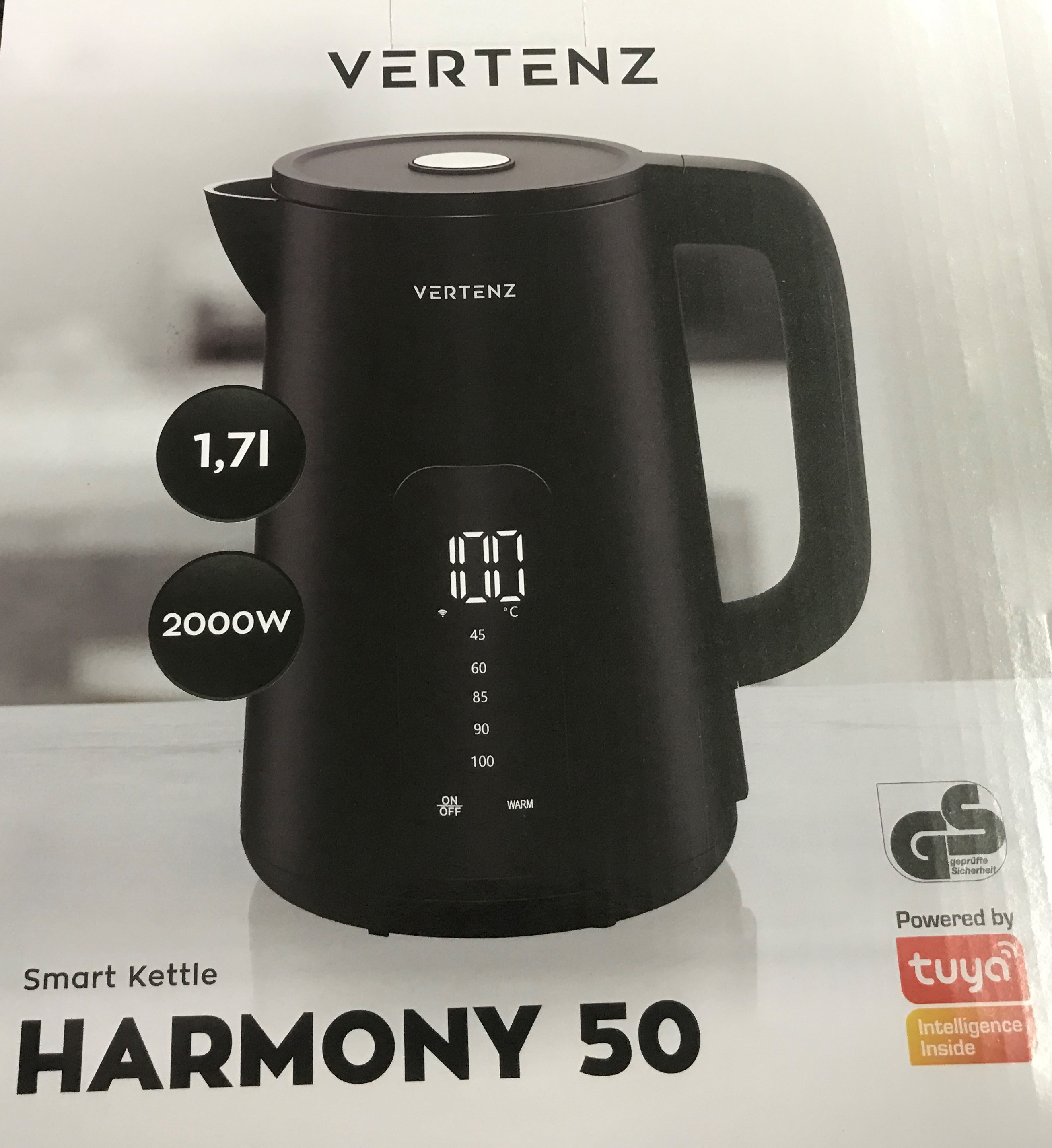

I invite you to a demonstration of a Wi-Fi enabled electric kettle. Here I'll show how it pairs, what its mobile app offers, how it's built inside, and see if it can be altered with firmware to free it from the manufacturer's servers and connect it locally to Home Assistant. This will be the second kettle I've presented on the forum, as I already showed some time ago Changing the firmware of the SMART06B , but the Wi-Fi + kettle connection is so curios and interesting to me that I couldn't deny myself the pleasure for Christmas.
The kettle itself is not expensive, you can buy one for as little as £120, it also depends on which shop. The equipment can be controlled by touch buttons on the casing or from the app. However, let us perhaps start with the instructions.
The first thing that catches the eye is the two modes of operation - boiling water and heating. That's what all the supposed 'intelligence' (the 'smart' of the title) is here for. This kettle allows you to set the temperature and then it can also maintain it - for up to 12 hours. The second curiosity is the error codes - someone has made an effort and even in such a cheap product there is a basic fault diagnosis mechanism. We can find out whether the NTC circuit is open or perhaps shorted. There is also a warning about too little water! Convenient.
