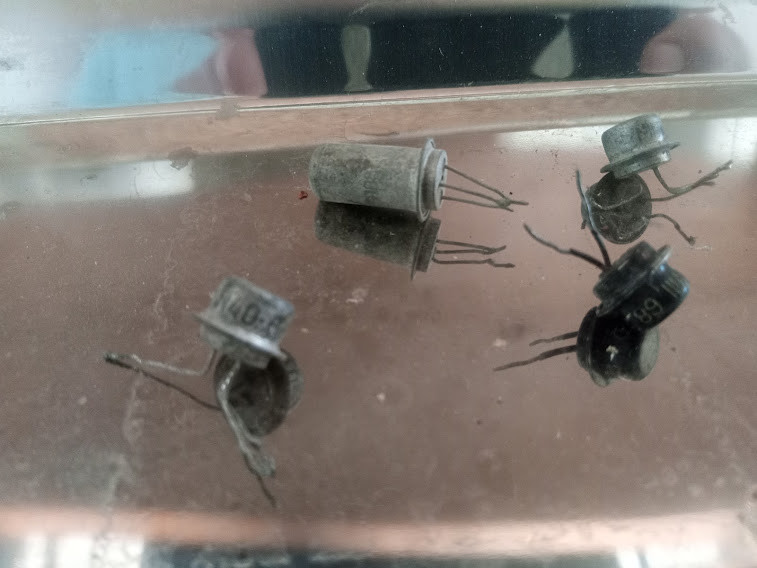

Germanium was the first semiconductor material used on a large scale to manufacture transistors, diodes and other electronic components. Germanium transistors, whose production began in the 1950s, revolutionised electronics and ushered in the decline of the vacuum tube era, at least in some areas. Unlike tubes, transistors do not require heating of the cathode or the use of a high anode voltage. They are also much smaller, which has enabled the development of truly portable devices.
However, germanium transistors also have their disadvantages, especially when compared to the silicon transistors that soon followed. Firstly, they are expensive because germanium is a relatively rare and difficult element to mine. It is estimated that the germanium content of the Earth's crust is around 0.0007%, while silicon is around 20%. The latter is found almost everywhere, literally even under our feet.
Even leaving aside the high price, we have to contend with a number of limitations when it comes to germanium semiconductor components:
High temperature sensitivity. Germanium is characterised by a much smaller energy gap compared to silicon. This makes germanium components thermally unstable and easily damaged at higher temperatures, and their performance changes drastically with increasing temperature. Even when soldering germanium elements, they had to be protected from crystal heating - the temperature should not exceed 75-85°C.
High reverse current. Germanium transistors and diodes have a high reverse current, which increases with increasing temperature.
Low frequency of operation. Low frequency of operation
Small transistor gain factor.
Germanium is also very sensitive to external influences. Therefore, germanium components require a hermetic enclosure.
