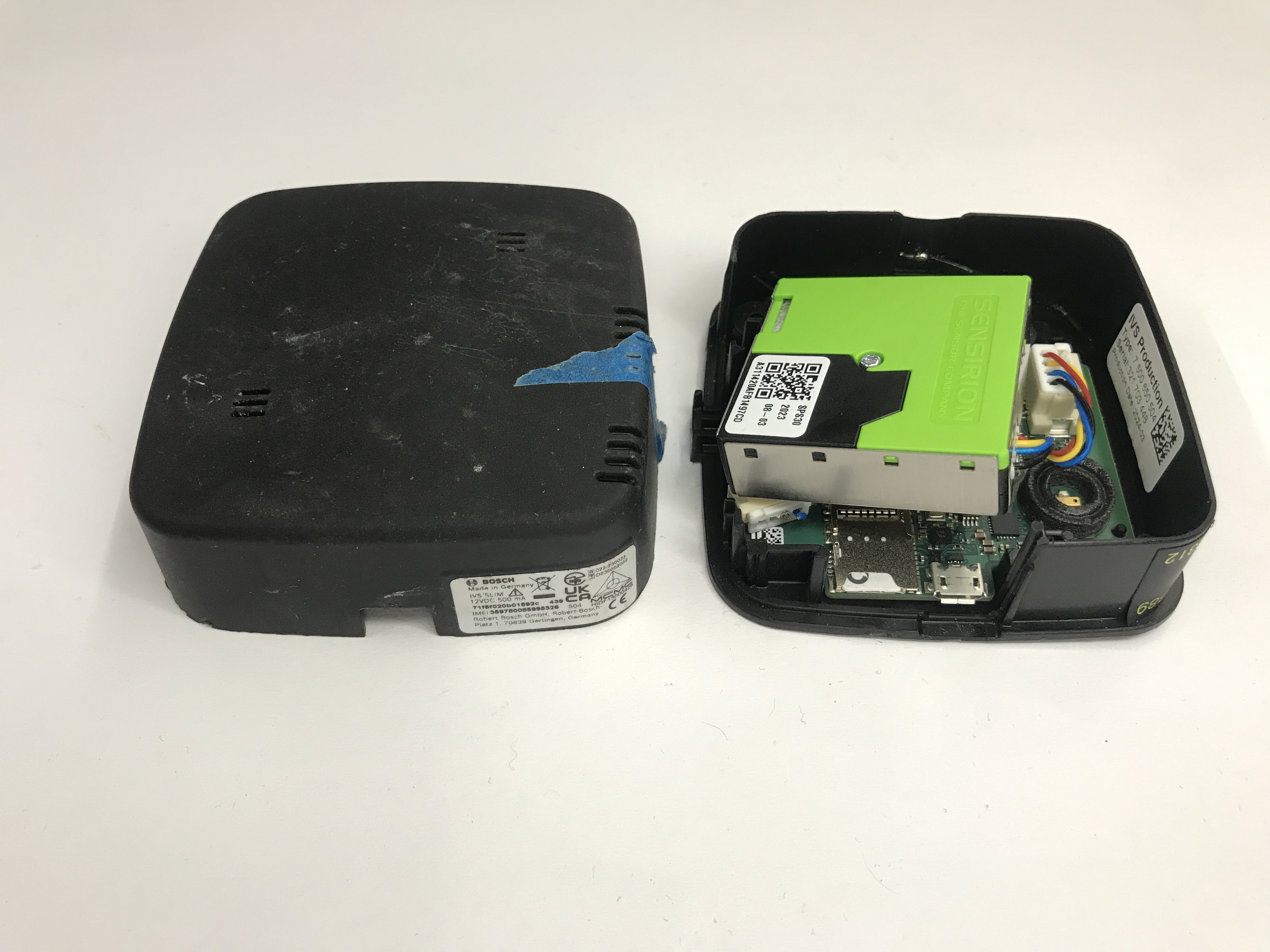

That's how much information I was able to find about this device on the web, now we look inside. The box was inconspicuous and I almost overlooked it in the scrap. One side of it was covered in dirt, presumably the area that adhered to the glass. It wasn't encouraging, but I looked inside nonetheless....
Made in Germany - inside you can also see some sort of module, a SIM card, a micro USB connector and a damaged power plug, probably 12 volts. I did not connect it to the power supply, I immediately decided to dismantle it.
The distinctive Sensirion module is immediately recognisable as the SPS30, which is a dust/air pollution sensor/PM1, PM2.5, PM4, PM10 with UART+I2C communication. Not a bad deal for scrap hardware. Polish shops sell it for 150-300 PLN, although it can be imported from China several times cheaper.
We look further afield. The two seals are from the microphones - according to the specification. The IPEX connector is from the antenna.
The antenna is a Taoglas FXUB89 2312 in flex format, it is glued around the case, 700 MHz to 8 GHz.
The board is glued with its underside to the case. There are no components on there, although you can see the test pads. I guess the manufacturer of this product likes glue, it was hard to peel off.
At the heart of the product is the Sierra Wireless WP7607 module, a Linux platform with secure 4G cellular communications (with 3G/2G support), based on an ARM® Cortex™- A7 core (1.3GHz) with rich peripherals including 1 USB, 2 UART, 1 I2C, 4 ADC ports, 189 GPIOs, one SPI and a SIM card interface.
SIM card slot, USB connector:
I see an ADC3142 chip here, which is probably the TLV320ADC3140. An external ADC module for microphones, that would fit. Application: monitoring.
This is what the microphone itself looks like:
I then examined the section under one of the screens. I removed it with hot air:
The LM73606R is the controller for the voltage step-down converter. You can tell by the fact that it's right next to the power connector, and by this inductor and capacitors. It converts the 12 V input into (I'm betting) 3.3 V for the communication module.
I wasn't planning on running this, so in the end I removed the screen of the module itself - the heart of the device:
Qualcomm MDM9207 LTE modem. JSFCBB3YH3FBG from Jeju Semiconductor is an LPDDR2+NAND MCP (4Gb SLC NAND + 2Gb LPDDR2 DRAM). 77661-11 is a multiband GSM/LTE/itd repeater from SkyWorks. PMD9607
This was supposed to be a destructive teardown, I assumed that since the hardware was scrap, it was for disposal anyway, but out of curiosity I plugged the unit into the power supply, removing the SIM card beforehand. At 12 volts, about 20 mA is drawn. Behind the inverter it is 3.7 V. The device is seen via USB:
    InstanceId: USB\VID_05C6&PID_9008\5&16BDD27B&0&2
    Class:      USBDevice
    Status:     OK
A web search suggests that there should be a virtual COM port driver for this, but I have not been able to get this to work. The matter remains open.
