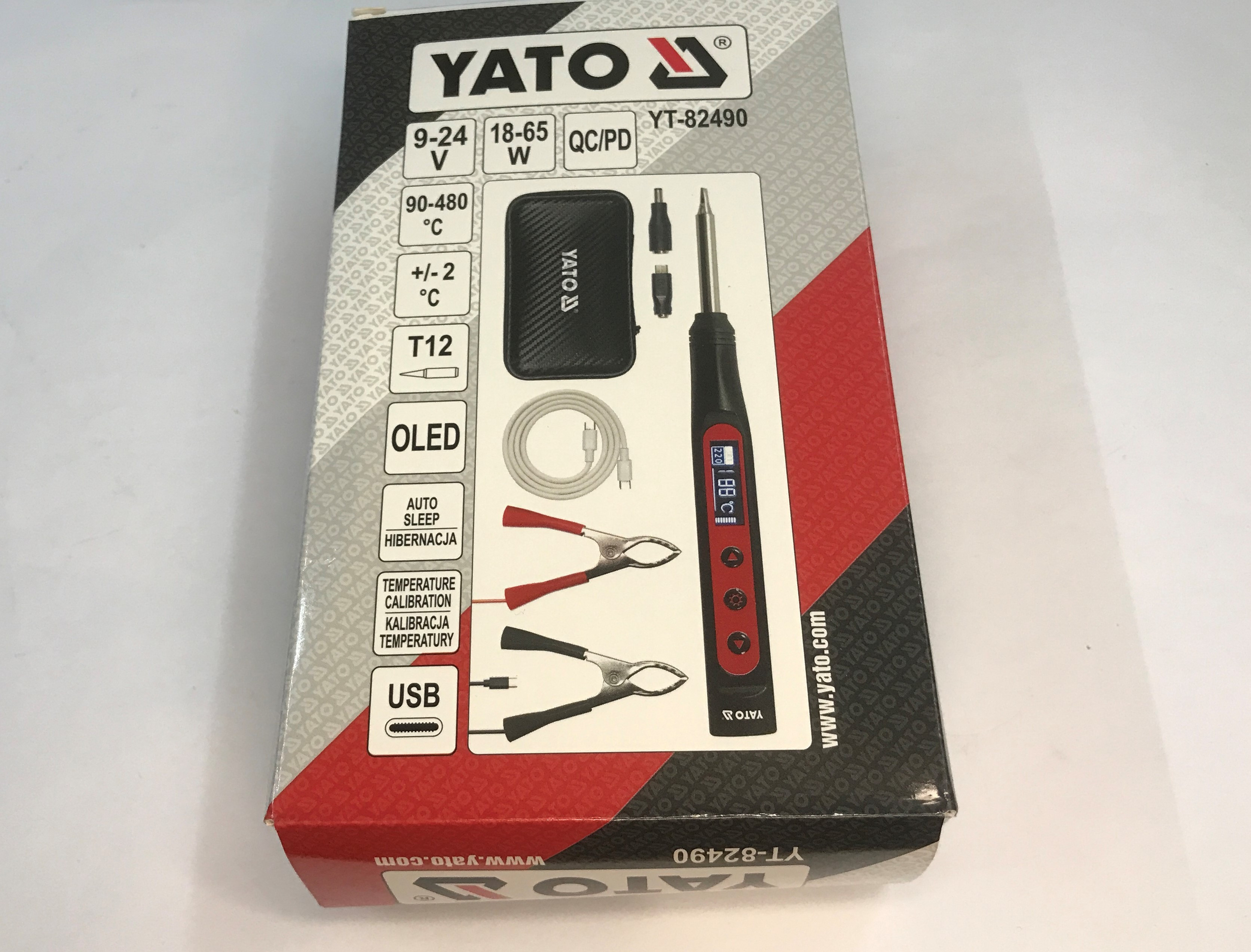

Yato YT-82490 USB-C soldering iron tests whether a QC/PD-powered T12-compatible tool can replace a traditional mains iron for everyday electronics work.
The iron runs from 9 to 24 volts, claims up to 65 watts, and adds an OLED display, autohibernation, temperature calibration, and hot-swappable T12 tips.
The kit cost 130 PLN and includes a sturdy case, three power leads, and one T12-D24 tip.
It soldered Sn60Pb40, lead-free joints, large pads, and even a connector and transistor with ground pad successfully, while measured heating power came out at 40 W.
It worked well even from an old Xiaomi 11T 20 V supply, and it may also run from a power bank, making it better than expected for portable use.
USB-C connectors, along with the QC/PD higher voltage negotiation standard, have made their way into our homes for good - but should they also make their way into soldering irons?
I invite you to test the Yato YT-82490, a soldering iron compatible with the popular T12 soldering tips, bought for just 130 PLN in a Polish mail order shop. Was it worth it? How will it cope with lead and lead-free solder and a massive motherboard? Let's find out!
Let's start with the basics. The YT-82490 operates from 9 to 24 volts, with a claimed power output of up to 65 watts. It complies with the QC/PD standard and uses T12 blades. It offers an easy-to-read OLED display, autohibernation and calibration to adjust the displayed temperature to the actual temperature. The kit is really extensive, plus everything comes in a sturdy case.
With three leads, including one with crocodile clips, this soldering iron could even be fired from the battery. It promises to be promising. One T12 tip for testing is also included - T12-D24.
Instructions:
The soldering iron is slim and handy. It fits well in the hand. The tips are not additionally fixed, so they can be hot-swapped, although they did not give a gripper for this.
The display is clear and easy to read, looking better in person than in the photos. Even the input voltage is shown, and you can also change the language in the options.
The whole thing is indeed capable of switching on 20 V with a suitable QC/PD-compatible power supply. What's more, I used a really old unit for testing, still from a 2021 Xiaomi 11T. The five-year-old hardware is fully capable.
