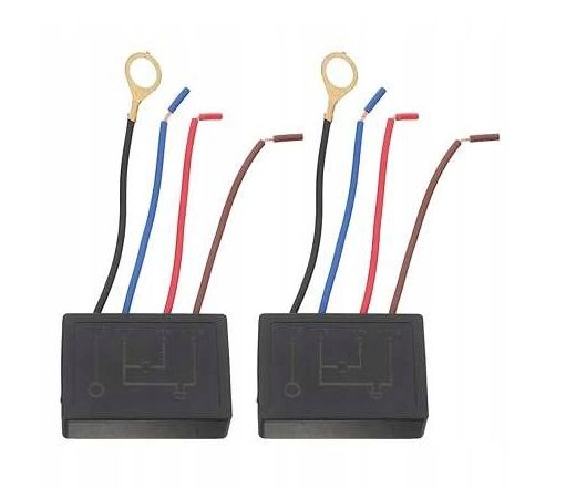

Let's start with the price. I was able to buy two of these modules from a Polish online shop for £25, but you still had to add shipping.

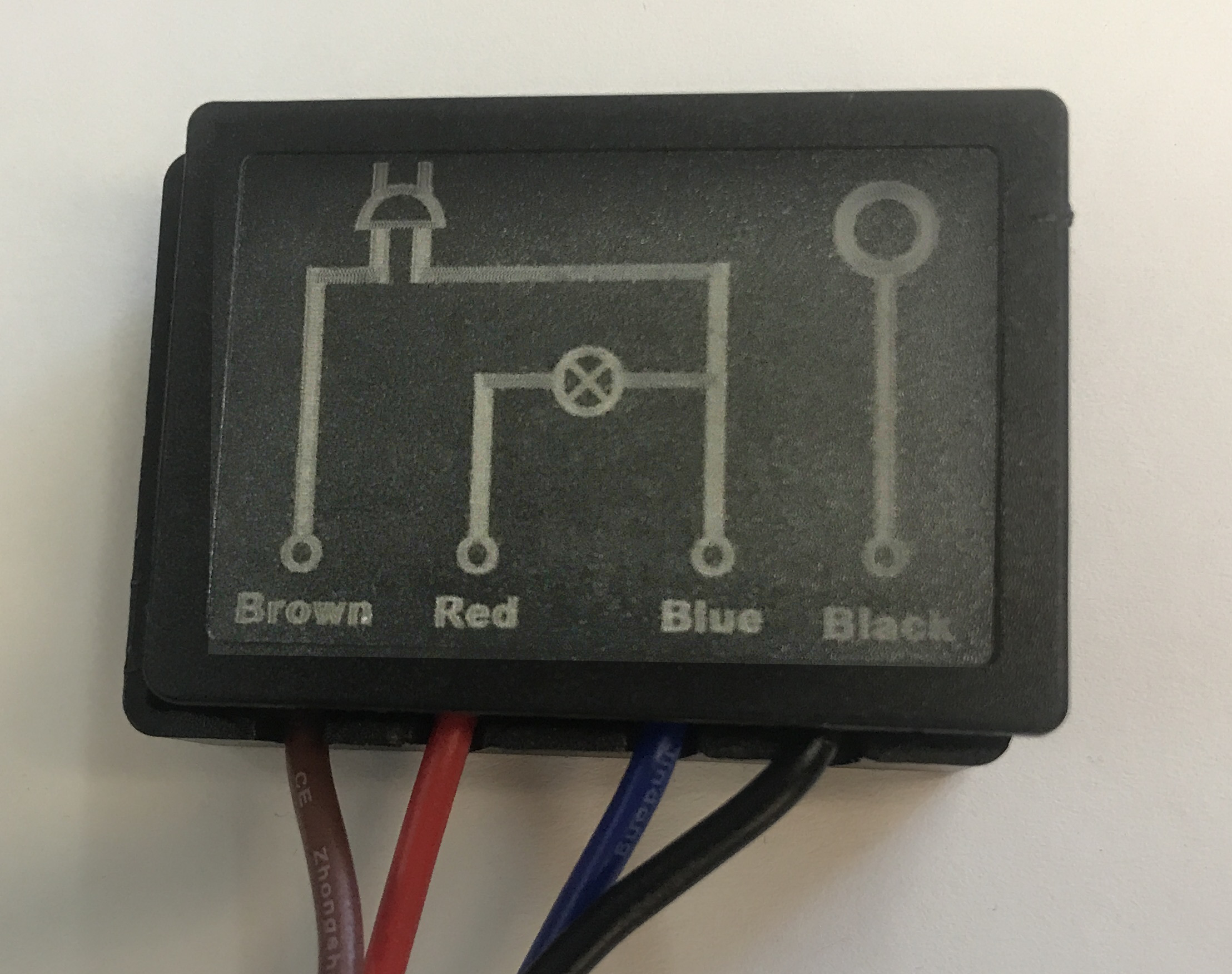

Assembly of the unit is very simple. It is illustrated by the diagram on the housing.

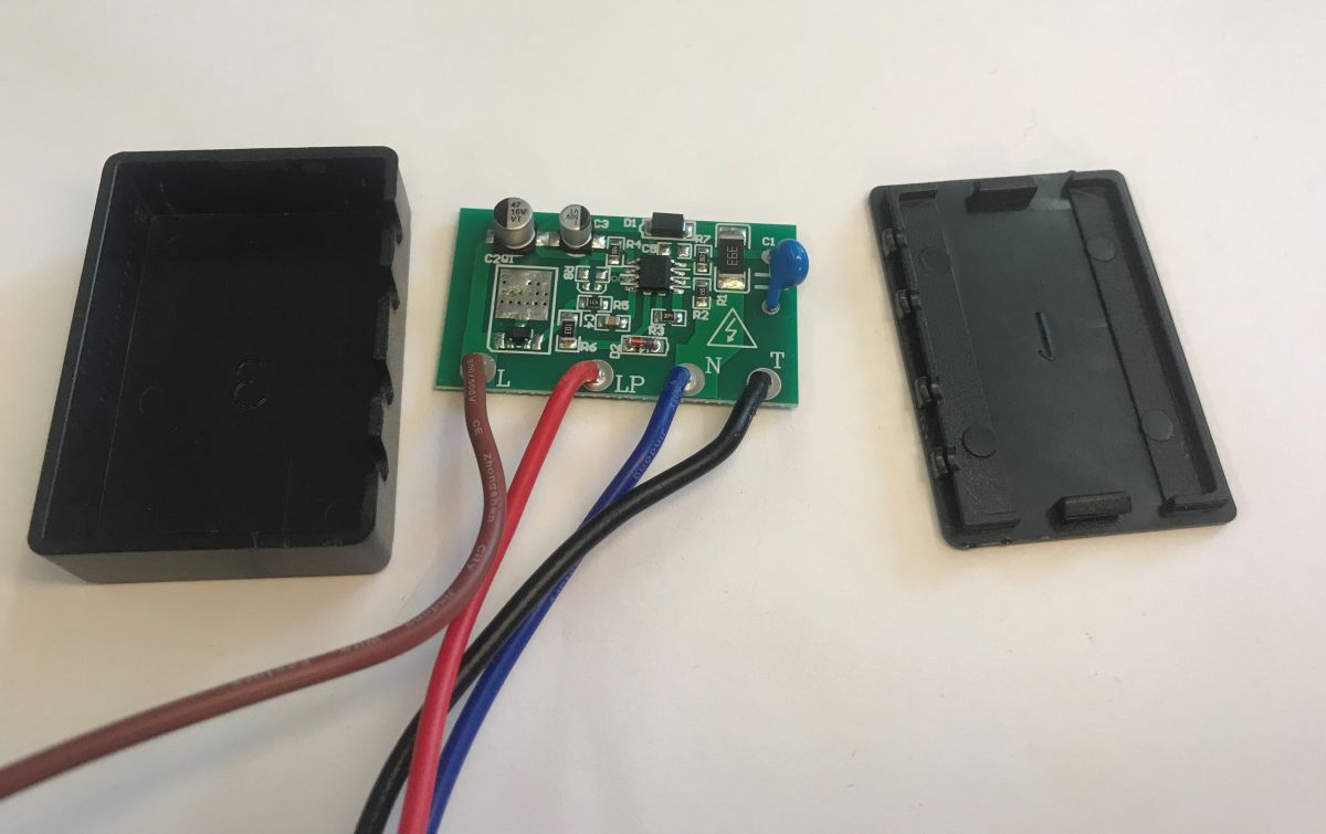

The black cable connects to the lamp housing, which is the touch button. However, it is time to look inside:

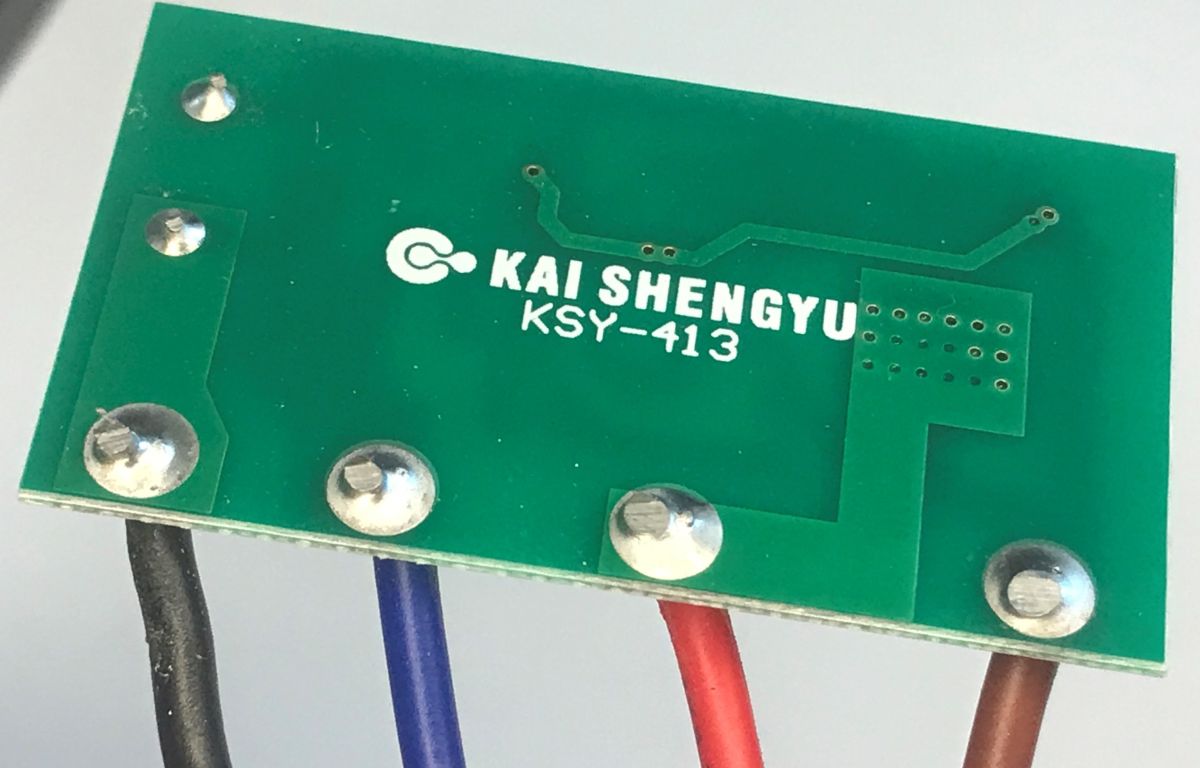

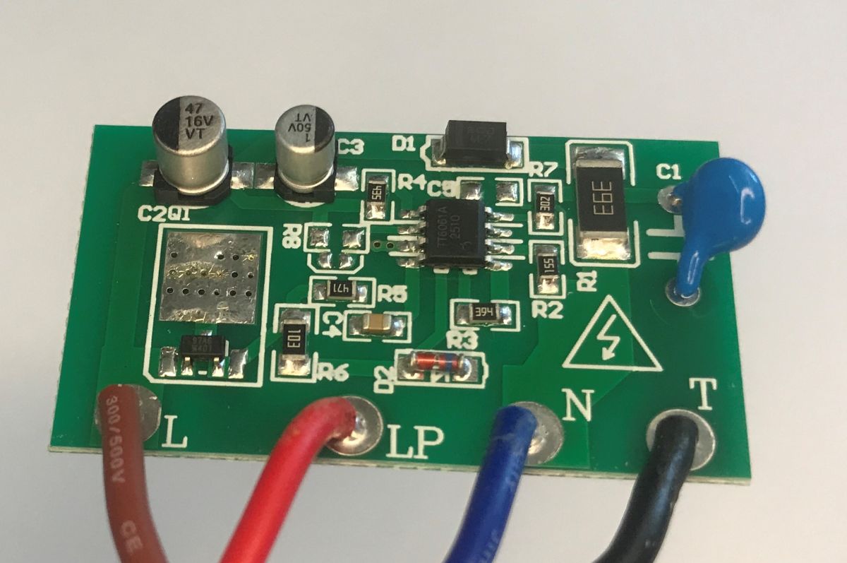

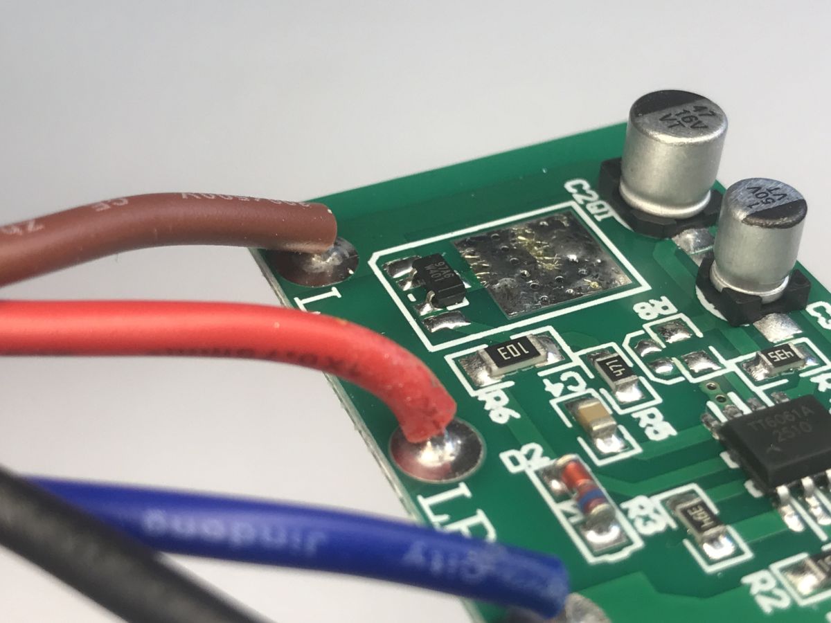

Inside is a single double-sided board, almost entirely based on surface mount - only the CY capacitor is mounted in a through-hole manner.
The module is based on the TT6061 chip:
A 97A6 W401 triac, here very tiny and surface mounted, is used to cut the 230 V line. The board was also designed with a larger triac in mind, as you can see the manufacturer is optimising costs:
Could it be a MAC97A6 or similar? 600 mA, 400 V.

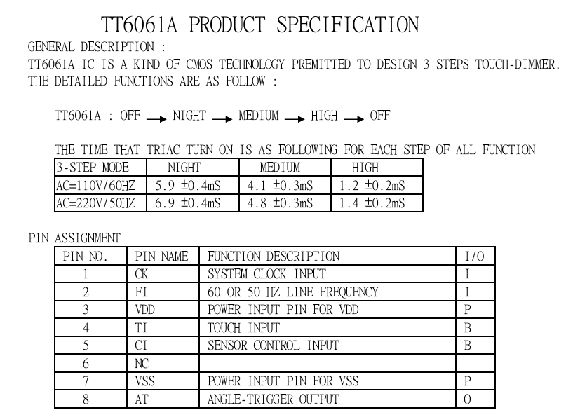

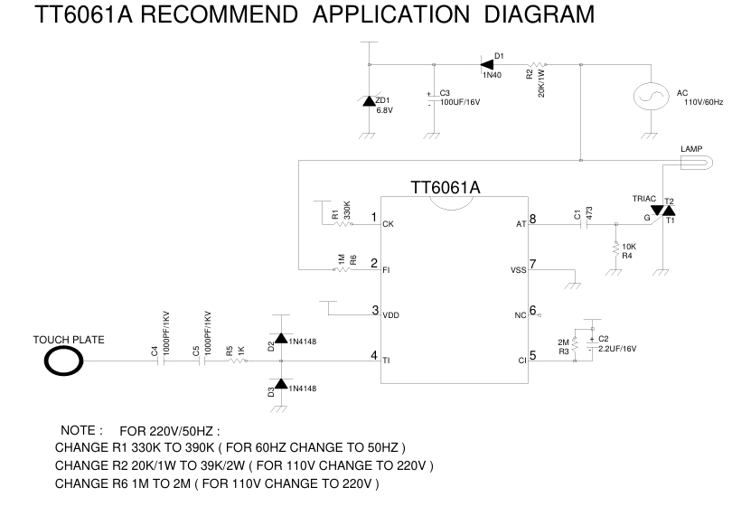

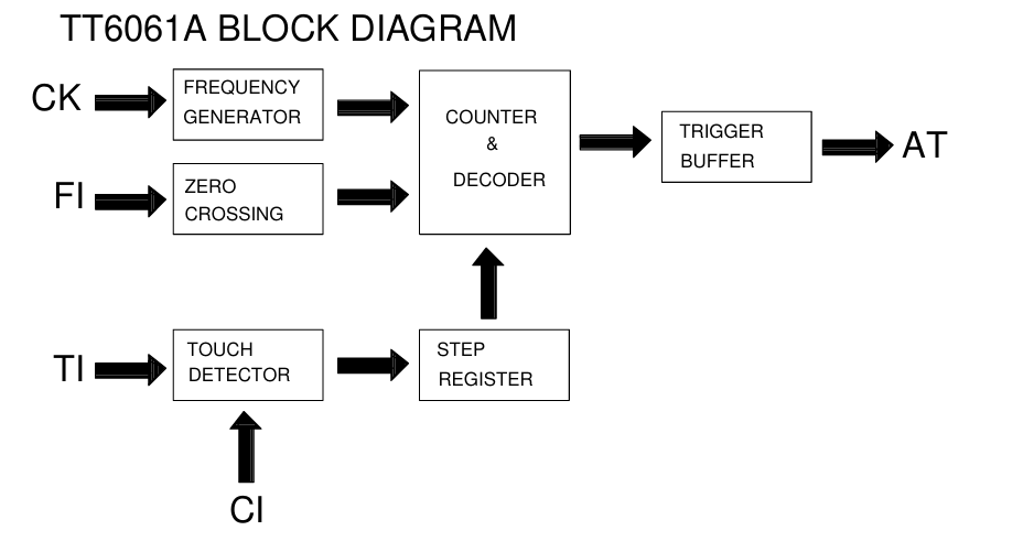

Finally, most importantly, the TT6061 documentation and application note:
The circuit in this version dates from 2009. It requires a small number of components to work. It can operate on 110 and 220 V, although each voltage needs separate resistor values R1, R2 and R6. Switching is realised with an external triac; the manufacturer was not tempted to integrate the triac in the housing together with the controller. Block diagram:

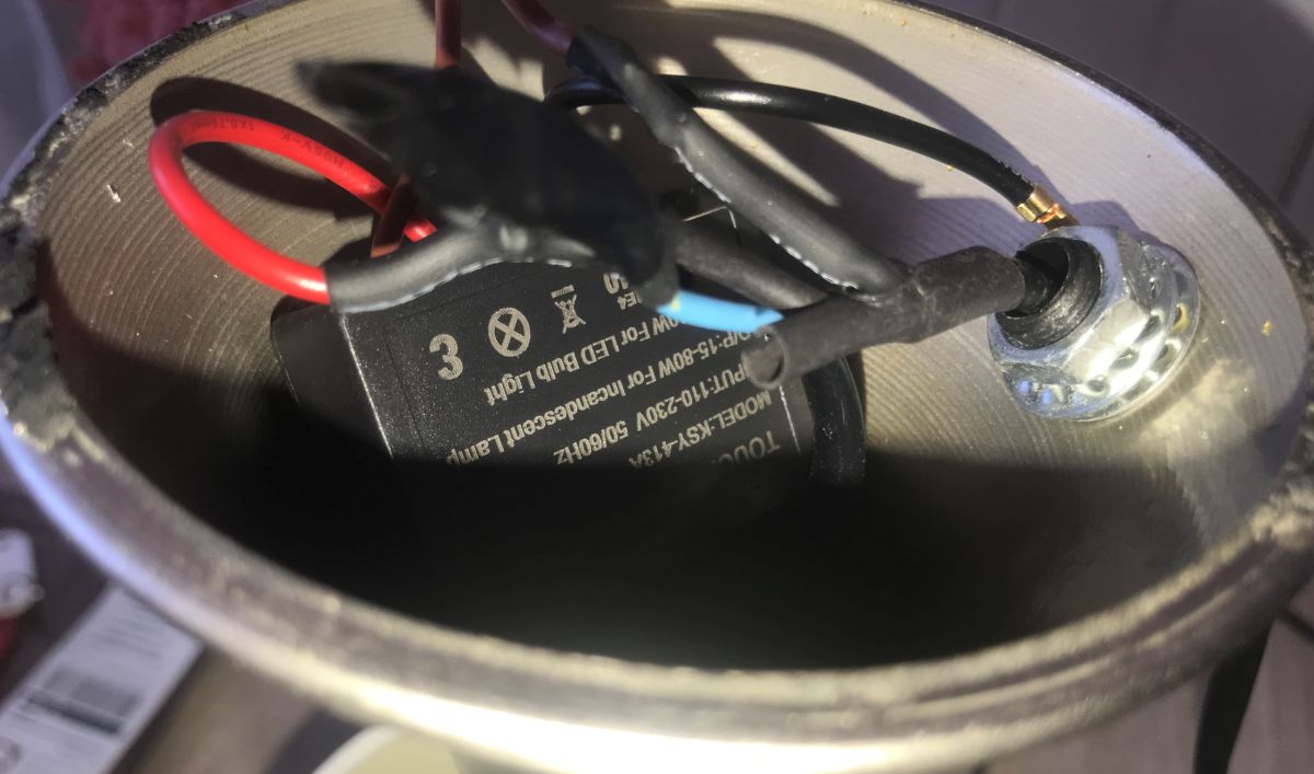

The module is already mounted in the lamp and fits well there.

Another issue is the question of the safety of such a gadget - we are protected here by a capacitor (there are two in the diagram) of the appropriate (I hope) class, similar to those connecting the primary to the secondary in a switching power supply.

All operator safety is based on capacitor C1. The application note clearly indicates that there should be 2 capacitors in series. Here they have saved money and given 1. I would rather not rely on such... [Read more]

I see a different situation here: this is a universal board and allows at least two different power triacs to be mounted and in two different resulting housings. [Read more]
