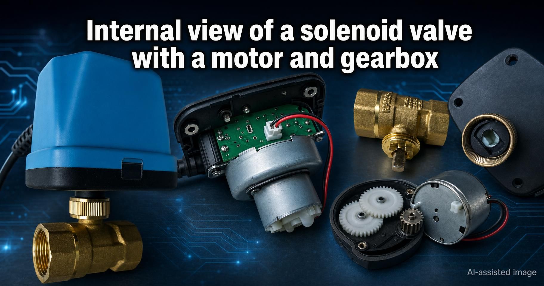

  • A teardown reveals a water shutoff valve built from a 12V DC brush motor, gearbox, cams, and a ball valve.
  • Three leads control it: GND plus +12V on either of the other two wires opens or closes the valve.
  • The 12V DC motor draws about 60–100mA, and power disconnects automatically once the valve reaches its end position.
  • Applying power to both control wires makes the valve oscillate open, while the housing only offers limited protection against water and dust ingress.

A water leak can cause surprisingly extensive damage in a short space of time. We can minimise the impact of a fault by installing a solenoid valve to shut off the water supply should a fault occur whilst we are away. To detect flooding, we can use a water leak sensor . Solenoid valves are typically associated with devices fitted with electromagnets, such as the standard solenoid valves found in automatic washing machines. The device shown in the photograph uses a ball valve connected to a gearbox and a motor. The 12V DC motor draws a current of approximately 60–100mA during operation.

Inside, we can see a 12V DC brush motor, a gearbox and a set of cams. The motor power supply is controlled via two momentary-action buttons and a relay.
The housing is not hermetically sealed, but it does provide some protection against the ingress of water and dust.
