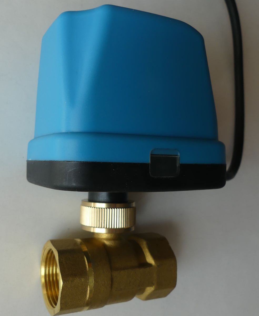

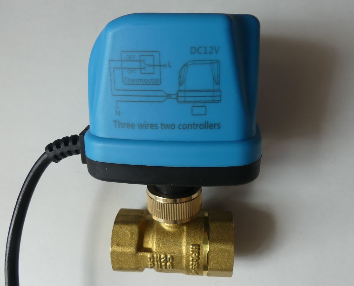

  • A teardown reveals a water shutoff valve built from a 12V DC brush motor, gearbox, cams, and a ball valve.
  • Three leads control it: GND plus +12V on either of the other two wires opens or closes the valve.
  • The 12V DC motor draws about 60–100mA, and power disconnects automatically once the valve reaches its end position.
  • Applying power to both control wires makes the valve oscillate open, while the housing only offers limited protection against water and dust ingress.
  • Blue DC12V actuator on a brass valve with a cable, on a light background
    A water leak can cause surprisingly extensive damage in a short space of time. We can minimise the impact of a fault by installing a solenoid valve to shut off the water supply should a fault occur whilst we are away. To detect flooding, we can use a water leak sensor . Solenoid valves are typically associated with devices fitted with electromagnets, such as the standard solenoid valves found in automatic washing machines. The device shown in the photograph uses a ball valve connected to a gearbox and a motor. The 12V DC motor draws a current of approximately 60–100mA during operation.

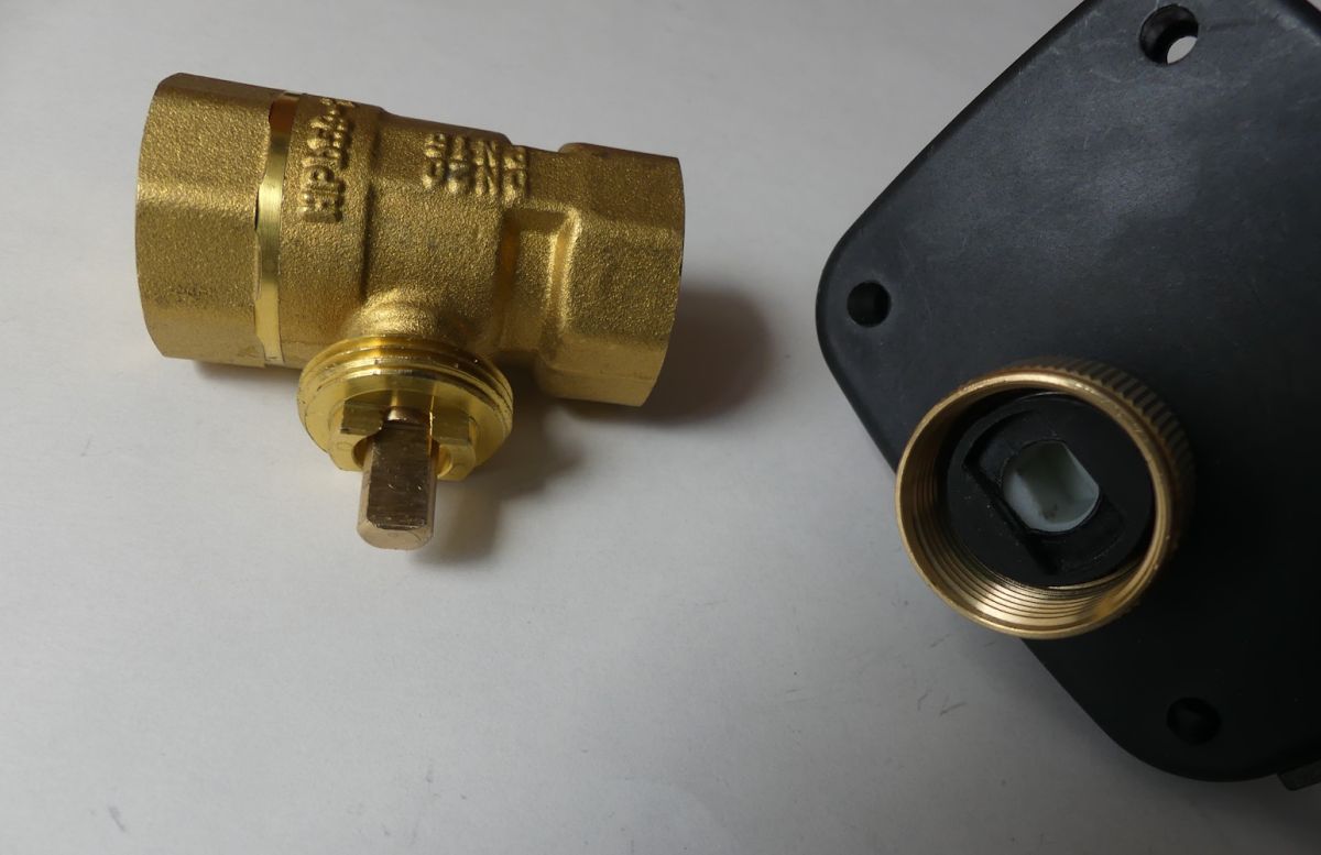

    Brass valve with a square stem and threads next to a black housing with a brass threaded ring
    The solenoid valve has three leads; one is connected to GND, whilst applying +12V to one of the other two causes the valve to close or open.
    Inside an electronic device with a green PCB, red and black wires, and a metal DC motor attached

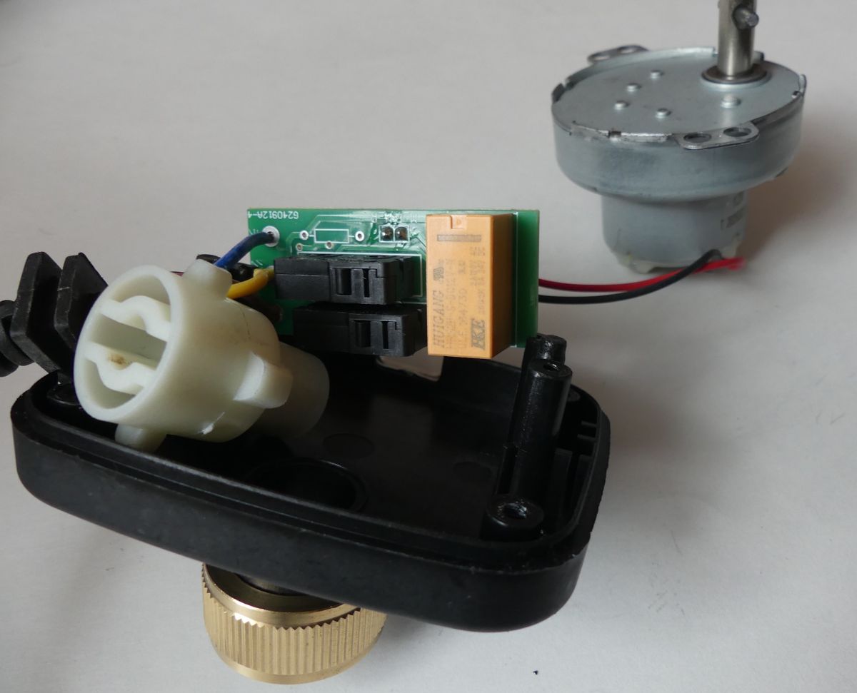

    Once the valve reaches its end position, the motor power supply is disconnected. Applying power to both wires simultaneously causes the valve to oscillate in the open position.
    Electronics module with PCB, relay and wires, plus a separate electric motor on a light surface

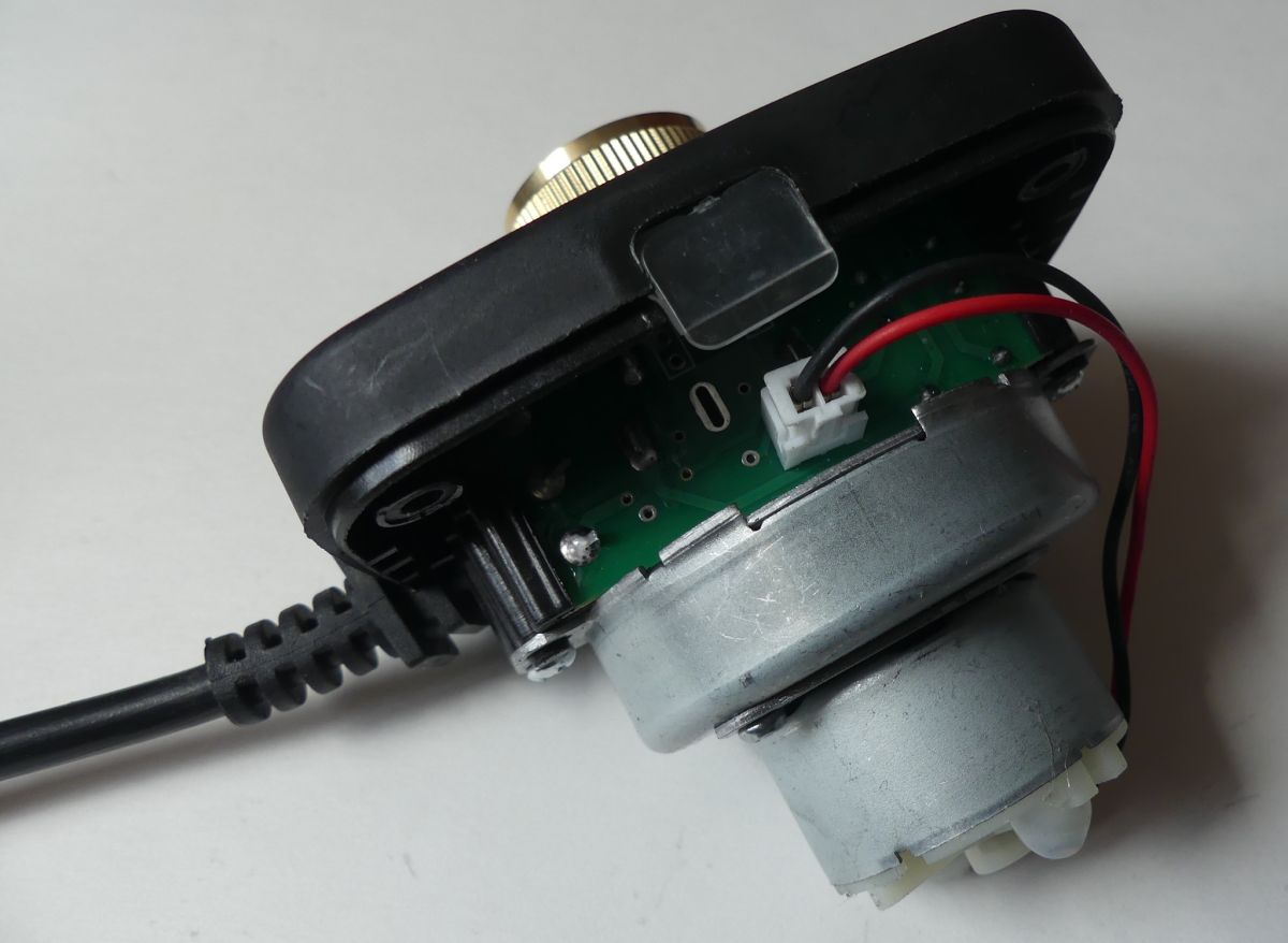

    Inside, we can see a 12V DC brush motor, a gearbox and a set of cams. The motor power supply is controlled via two momentary-action buttons and a relay.
    The housing is not hermetically sealed, but it does provide some protection against the ingress of water and dust.
    This is what the device looks like in operation and the valve’s closing speed.
    Do you know of any similar electromechanical valves that can cut off the water supply upon detecting a fault?

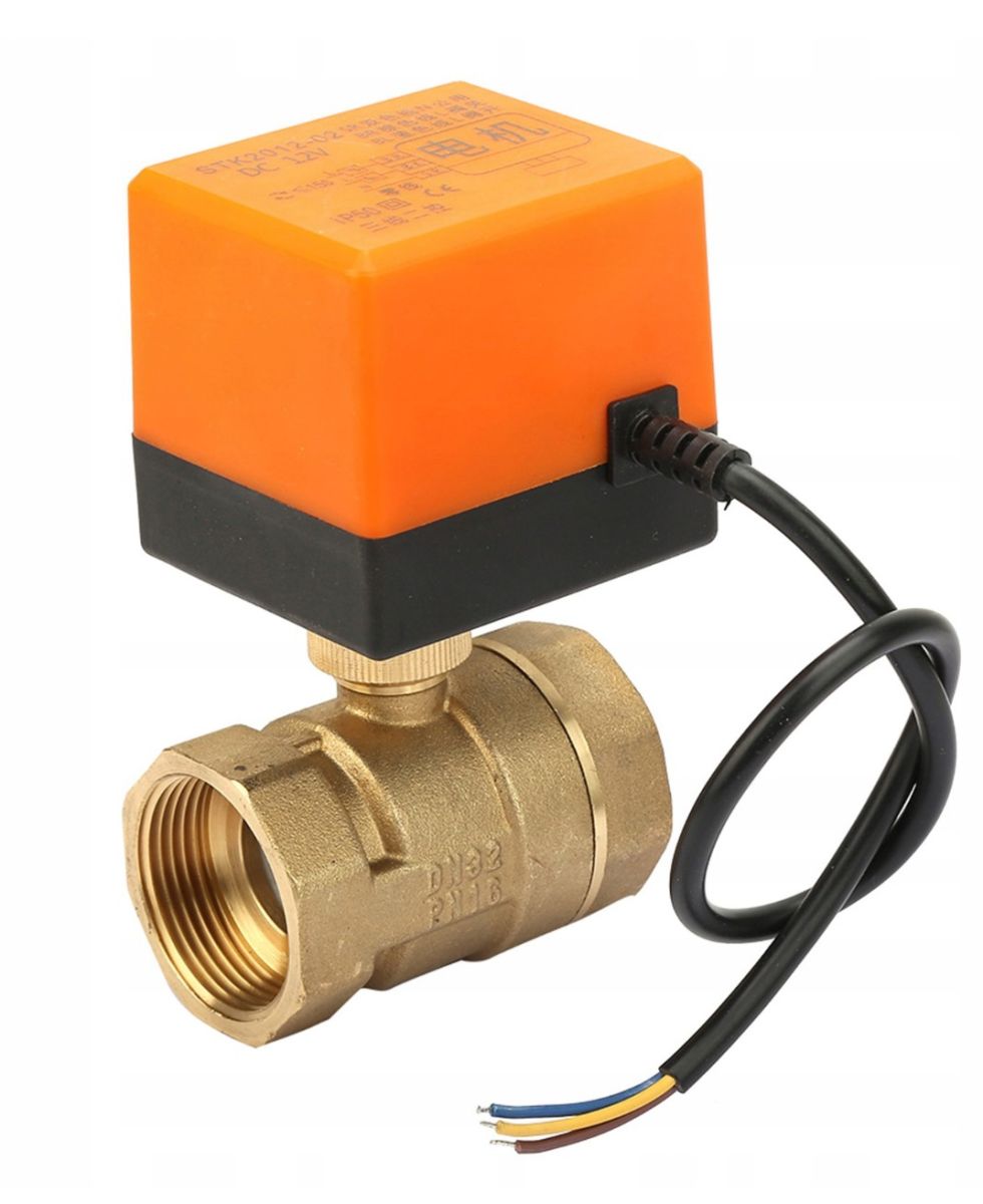

    Brass motorized ball valve with an orange-black actuator and a three-wire cable
    I use one like this. My unit is powered and controlled via a three-wire 12V DC connection (one wire is negative, the other two are positive – open or closed; just like the valve in the title, it is fitted with limit switches, and the circuit board in the title looks identical to mine. There are also versions for 24V DC and 230V AC) . However, presenting it solely as an emergency valve limits its applications. In my case, for example, it functions as a water supply for drip irrigation. Due to the low pressure in the system (the water is supplied by gravity from a cistern positioned at a height of 1 m, meaning the pressure is just over 1 bar), standard garden watering timers didn’t work – the diaphragm valves integrated into them require at least 2–3 bar to operate. The ball valve mentioned above (and the modification of a Lidl timer to operate on 12V DC) proved to be a lifesaver.
    Now for the downside – the valve has stopped working twice this year already – it turned out to be flooded with water inside. Fortunately, apart from the limit switches and the relay, and of course the motor, there’s no electronics in there, so bringing it back to life proved straightforward. The first time, I put the fault down to the valve being exposed to rainwater – the housing isn’t very well sealed and the valve would occasionally get a few drops of rain on it. After the first failure, I sealed the valve housing properly and tucked the whole valve away under the tank so that it wouldn’t come into contact with rainwater. And six months later, it was the same story all over again – it was splashing inside.
    It seems that water seeps through the poorly sealed ball valve shaft and continues on through the equally poor O-ring on the drive shaft. As the ball valve itself on my unit is identical to the one in the thread, this problem may also affect the kit mentioned in the title (unless the drive has a better O-ring than mine).
    Tightening the gland on the valve shaft might help, although here it looks as though it’s permanently pressed in – I didn’t try to move it, replacing the O-ring with a decent machine-grade one, or getting round the issue by drilling a drain hole at the bottom of the housing – which is what I did. We’ll see if it helps (the hole in the bottom of the housing certainly will... ;) )
    Due to the aforementioned issue, I’d advise against using the 230V version of the valve unless you’re not afraid of getting electrocuted....
    The risk of flooding does not apply to the version of the actuator described by the previous speaker – the one fitted over an existing ball valve. Even if the valve itself is leaking, the water has no chance of getting inside the actuator; however, the actuator is noticeably more expensive than the aforementioned integrated valves from the PRC.

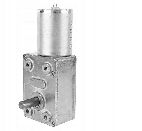

    Everything would be great if plastic gears weren’t used so widely in the gearbox. They’re not suitable for use in hot environments or for frequent operation. After the dedicated one wore out quickly – I made one myself based on that model (it has brass gears).

    Could it be condensation forming inside the casing?
    But not a hundred… because that’s how much spilled out.
    . Surely there are limit switches for opening and closing?
    Definitely – have a look at the photos in the author’s first post.
    Such integrated valves are really just auxiliary – for shutting off the toilet or the dishwasher/washing machine… or, as in my case – for watering.
    On the main supply line, however, I’d recommend a proper ball valve with a lever (although I’ve seen even those – brass ones – crack due to vibrations from steel pipes; the most reliable and, incidentally, repairable option is a sturdy cast-iron globe valve) mounted on threaded fittings, with the automation fitted as an add-on – as in posts #2 or #4 – a leak won’t cause any harm, virtually every component can be replaced, and manual control is also possible
    And whilst you’re at it, extend the spindle so you can turn it manually.
    – it’s not possible to add manual operation to the model mentioned in the title or to mine in any way – you can’t make the spindle extend all the way out, there’s no clutch, just a non-disassemblable gear mechanism.

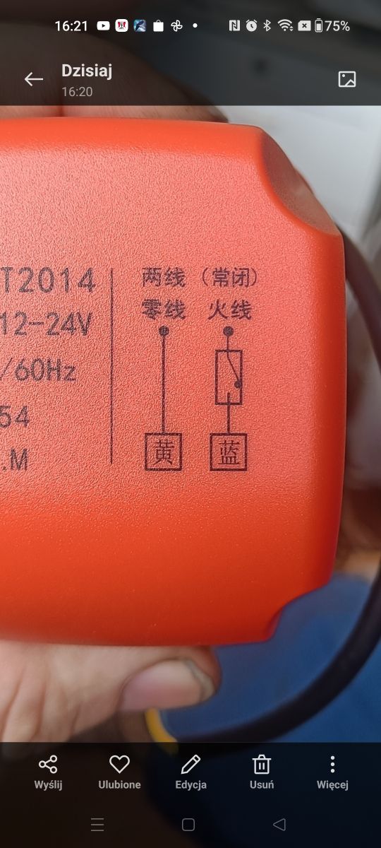

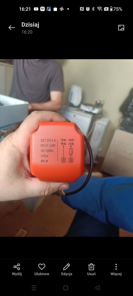

    Orange actuator labeled “SKT2014” held in a hand, with a cable visible Close-up of an orange device housing with a printed wiring diagram and Chinese characters.
    Two-wire control: when voltage is applied, the valve opens and remains in the open position; when the voltage is cut off, it closes. There is a spring mechanism inside.

    This two-wire system is interesting, but no electricity means no water.
