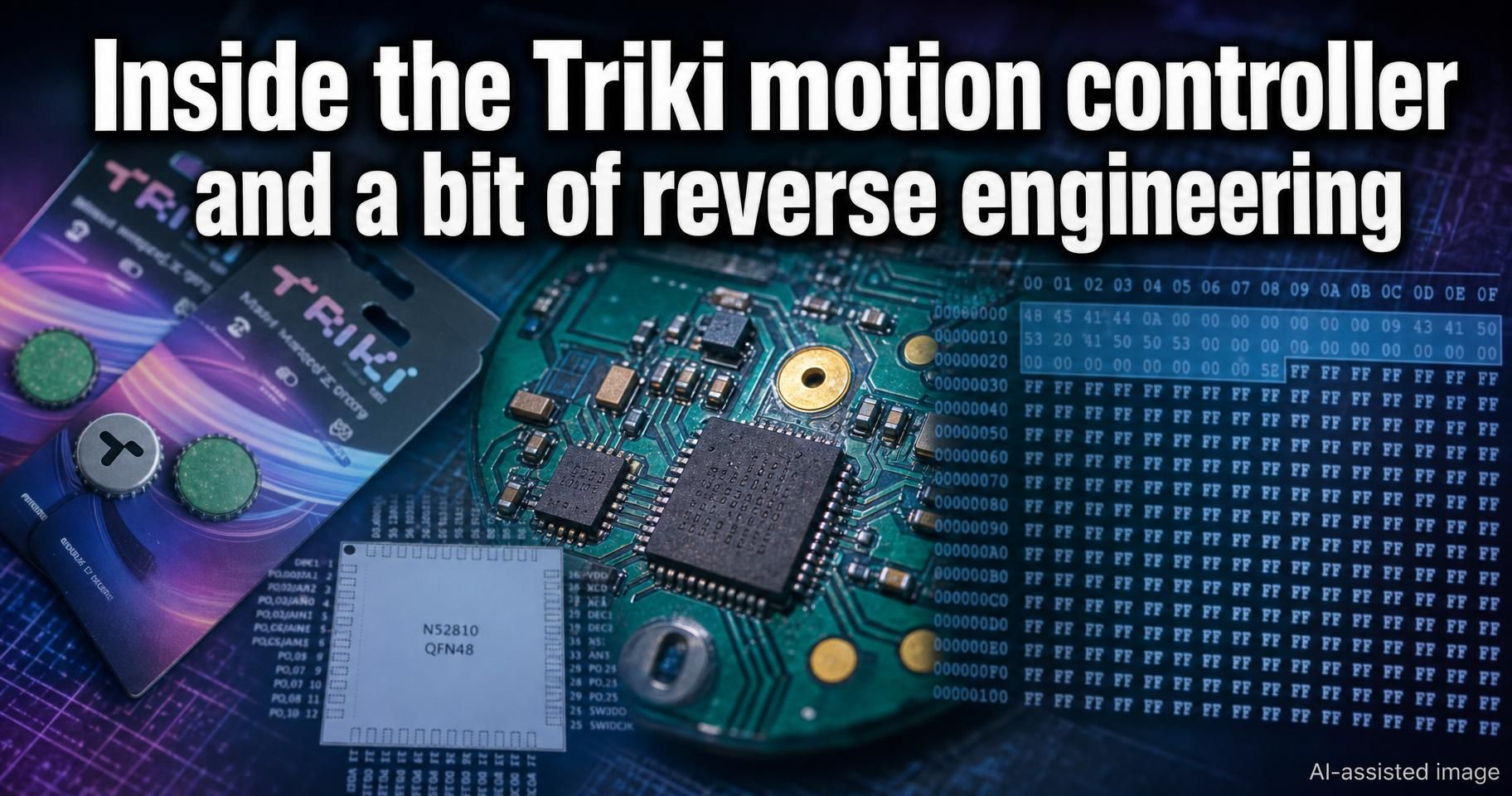

  • The Triki motion controller uses a Nordic nRF52810 BLE SoC and a mysterious SF 248 MEMS sensor.
  • The PCB also carries exposed programming pads and a 1MB Macronix MX25R8035F flash chip that appears mostly filled with FFs.

Hi everyone, today I’d like to show you the inside of the controller Tricks , which has become the flagship product of the green amphibian retail chain. It allows you to play games via the chain’s dedicated app.
As we can see in the photo above, at the heart of the device is the SoC chip nRF52810 from Nordic Semiconductor, an energy-efficient Bluetooth Low Energy (BLE) microcontroller based on the ARM Cortex-M4. It is very popular in small IoT devices and wireless accessories. The chip is locked, and to unlock it, you need to erase its contents.

The MEMS sensor is the SF 248 (probably LSM6DSL)  , unfortunately, I haven’t been able to find any datasheet or even a mention of it online.
On the PCB, there are exposed programming pads, Unfortunately, I don’t yet have a J-LINK programmer to confirm my speculations regarding the pinout, so please take this with a pinch of salt.
Interestingly, the board also features a FLASH memory chip, according to a dump from the user’s GitHub Piwencjusz R80B..... R80X..... ( 1MB Macronix MX25R8035F ) with some very interesting content; apart from the header shown below, the rest is filled with nothing but ‘FFs’, which might give us plenty of scope for DIY projects.
